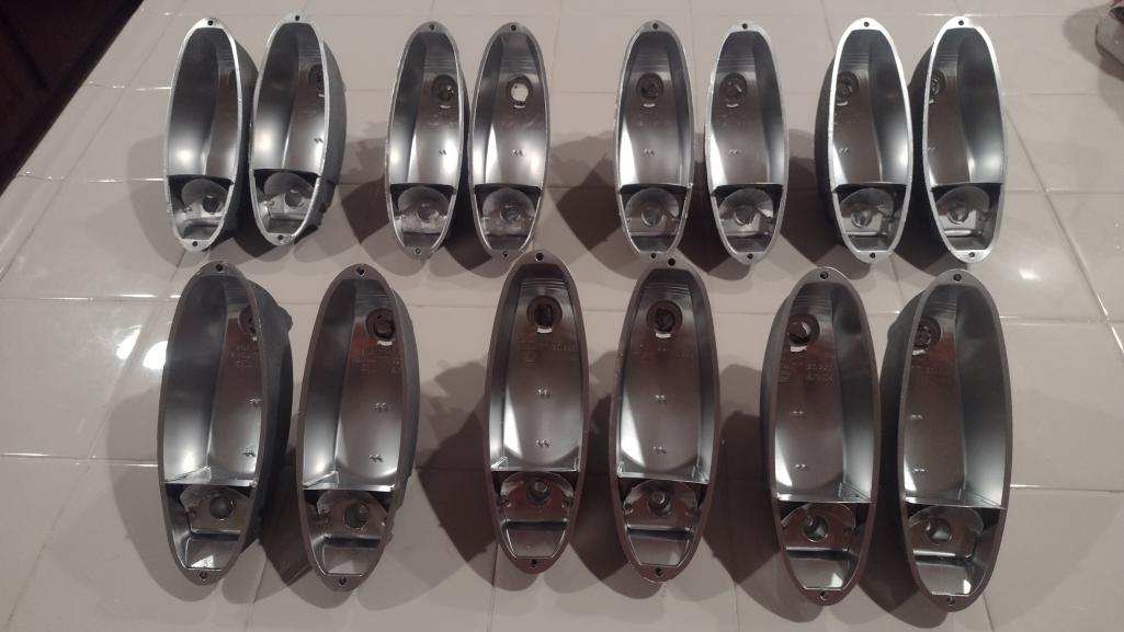

First row are all sold, the back four pairs are available. These should ship Tues, I will wire them tomorrow night, get them out Tues, unless an unforseen event occurs, life is unpredictable as we all know!
MB
