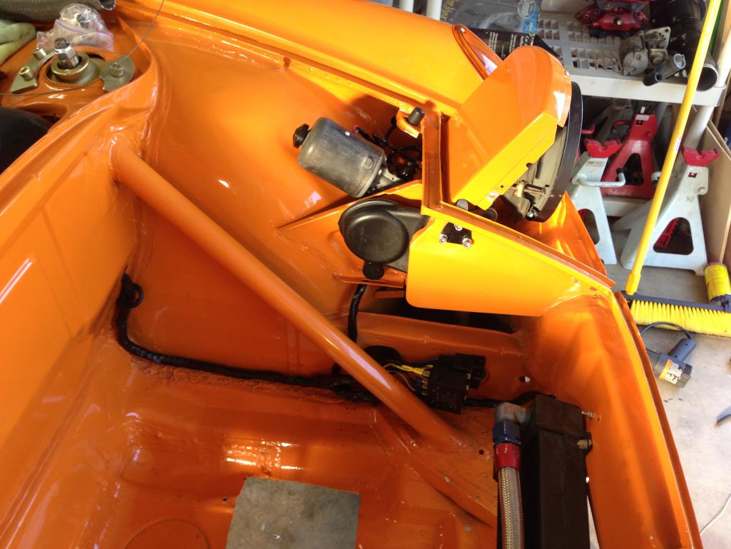

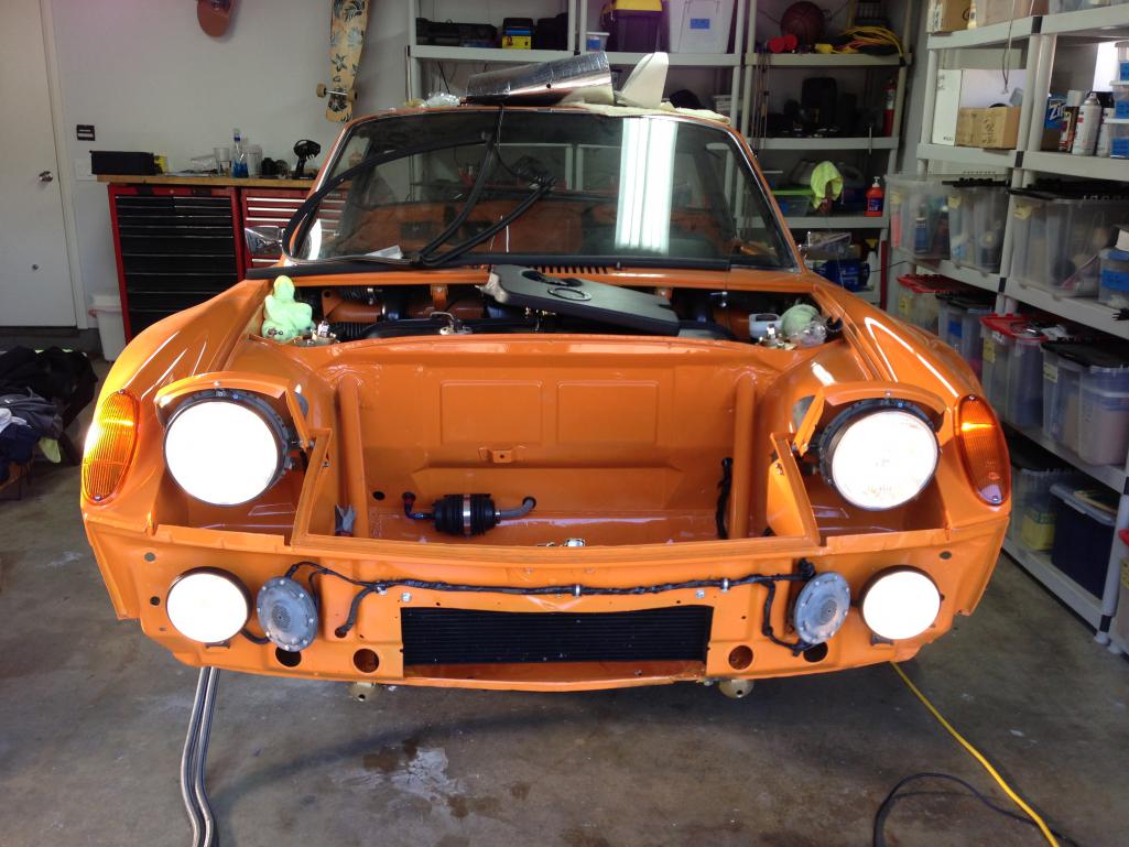

Thanks. I got this working yesterday. Saab relay for switch, plus 8 gauge wire from battery to front trunk, and 3 more standard relays in the front trunk for low beam, high beam, and driving lights.
-Steve
