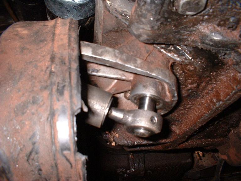

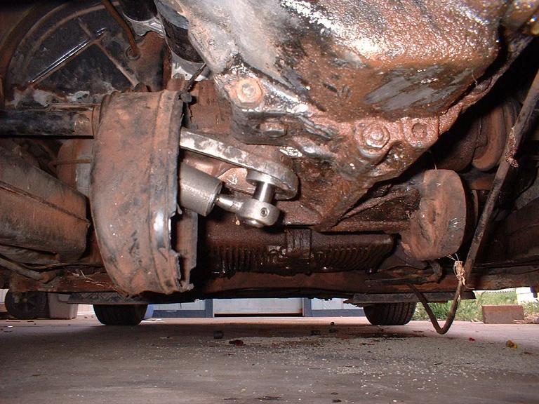

IF you can't tell from the picture its pulled all the way down and towards the rear of the car.
anther pics of second gear
Im not sure how to get to the adjust part between the seats I have everything pulled away but its being covered and theres just a little hole little hole I can't even see the part I need to adjust there. I can only adjust it by the shifter.
At the tranny, it should be in the middle position and towards the back of the car.

Put it in second at the trans.
If the lever inside the car is not in the middle position and towards the front of the car, then:
Go into the car, pull the cover off the access whole in the tunnel right behind the shift lever. Loosen the clamp, remove the bolt. Get the lever loose from the front shift bar. You will need move it to different splines and change the difference of the rod in and out of the clamp in order to get it to adjust properly. Clamp it down and test the rest of the gears. Adjust as necessary.

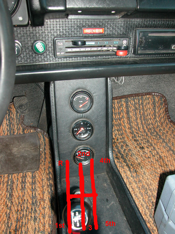

Haha well then my car is going into 5th gear not second. So when you say second is mid forward is it all the way in or out or half way.
Half way out.
sm
If you get Eric's Transmission, on the 22nd of this month, I'm driving SLC to Vegas, and I can drop it off for you Kris.
I would be going through in the afternoon on Thursday, PM me if you decide on getting it.
I don't think I need a transmission I still can't get it adjust right to go into third gear but I can go from 1st to 3rd so its drive able now.
Just to confirm since you haven't driven a 914 before and it may not have the original shift knob:
R 2 4
-s---
1 3 5

This is my car and the shifter is in 1st gear. See where the pattern is and goes. Its sooo easy to shift into 4th if things are mis adjusted.
