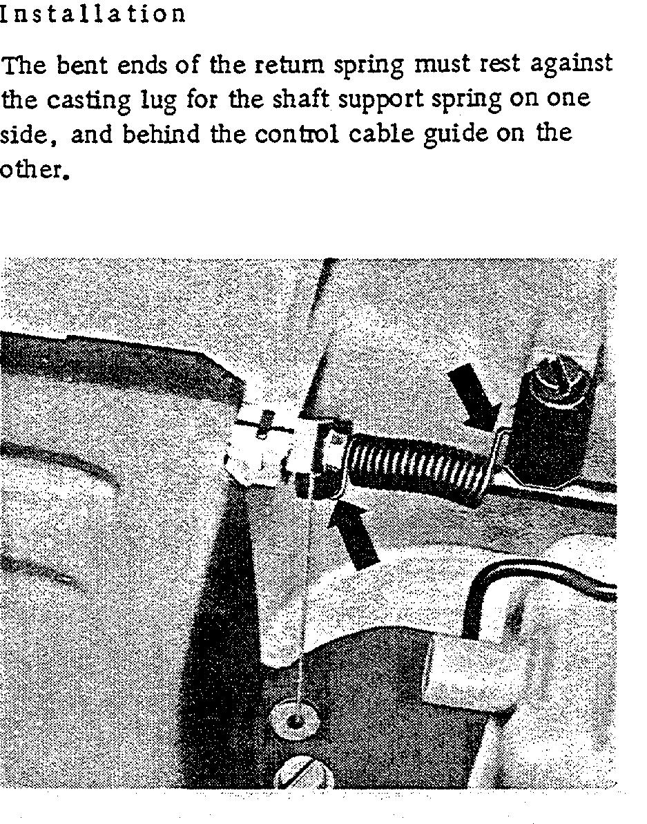

I noticed that the wire from the bellows to the flaps came loose, did not break, but it is pointing up from the port through the engine tin.
Does anyone have a picture of what position the bellows wire attaches to the flap spring clamp?
I just cannot find a pic, but the wire is intact. Not sheared or frayed. Just damn came out when I finally got the car warmed up on Friday. I am still paying for getting stuck in traffic, but the car DID NOT overheat. It got to absolutely normal operating temp, but I am not sure how the flaps worked loose. I have other problems that will be fixed this weekend, but the flaps thing surprised me.
I loosened the bolt and it is ready to reinsert, but how tilted should the flaps be?

Hey John - all materials expand with heat, so the bellows expanding should push or pull the wire/cable to open the flaps & allow cooling air into the engine cooling airflow as ducted by the tins.
Here's a pic & text from the factory manual #1 - but not much details on "how to"!
Maybe the Pelican tech section has a better step by step?
Cooling flaps fail in the fully warmed up position so it doesn't overheat. The cable is installed with the flaps against the spring tension (hard to explain), that is, with the engine cold, you rotate the flaps against the spring tension then install the cable under a clamping nut and yes, it does take 3 hands; one to hold the flaps against the tension, one to hold the cable in position and one to tighten the nut with a wrench!

The flaps should be spring loaded and if there is a failure (cable breaking, etc) they should snap to the fully open position which is the correct position for hot engine driving. In this position the motor will take a bit longer to warm up, but won't overheat. Some people lock the flaps into the open position and toss the thermostat, but the flaps should never be omitted.
The thermostat isn't really a thermostat. It doesn't cycle on and off, open and closed. It simply warms up slowly, and then doesn't cool off again until the motor stops and sits for awhile.
To make the flaps operate correctly, first check your thermostat cold. It should be compressed tight. If it's not compressed when it's cold, then following this procedure will cause problems. Once you've checked that your thermostat bellows are functional, you need to route the cable around the small wheel under cylinder #2, then up through the tin near the dipstick. There is a hole there, and from the factory there is a small fiber washer, but that part isn't really critical. It's just another air seal that most people are missing. To attach the cable, you need to simultaneously press the mounting tab on the flapper rod down, while threading the cable into place and then tightening the nut. Not easy.
If you attach the cable as mentioned above, but your thermostat is failed (expanded all the time) then your cable will never get longer and the flaps will never open, and you will overheat your motor since the flaps block all the cooling air from getting to the cylinders and the oil cooler.

The cable did snap about 1/2 inch from the end. I was fixing all kinds of things I have screwed up tonight and there was a little piece stuck in the plate behind the tightening bolt.
Yes, the remaining wire is just a little too short.
I ordered 2 from Pelican tonight. The bellows looks tight, so it is just getting under the car and snaking my hand into the bellows area to remove the broken wire and install a new one, build a grommet and reconnect it.

Which direction does the shaft for the flaps rotate to be full open? Towards the front of the car or towards the rear?
[The shaft that holds the flaps rotates about 100 degrees forward to the compartment,
The wire holds it toward the enginer
Heat makes it lengthen toward the cabin, and more cool air comes into the engine.
When applying the new cable, tilt the vane back to the engine and lock the wire down!

quote name='KaptKaos' date='Jun 5 2010, 11:29 PM' post='1328694']
[/quote]
Toward the front is fully open.
