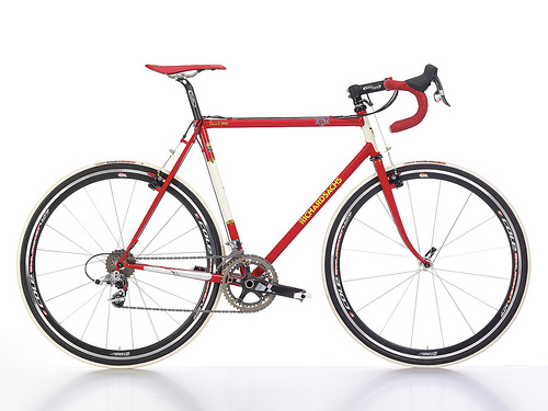

Brass and silver brazing for handmade bike frames. This guy gets ~5K for just the frame. www.RichardSachs.com
That's a hell of a torch for brazing!
