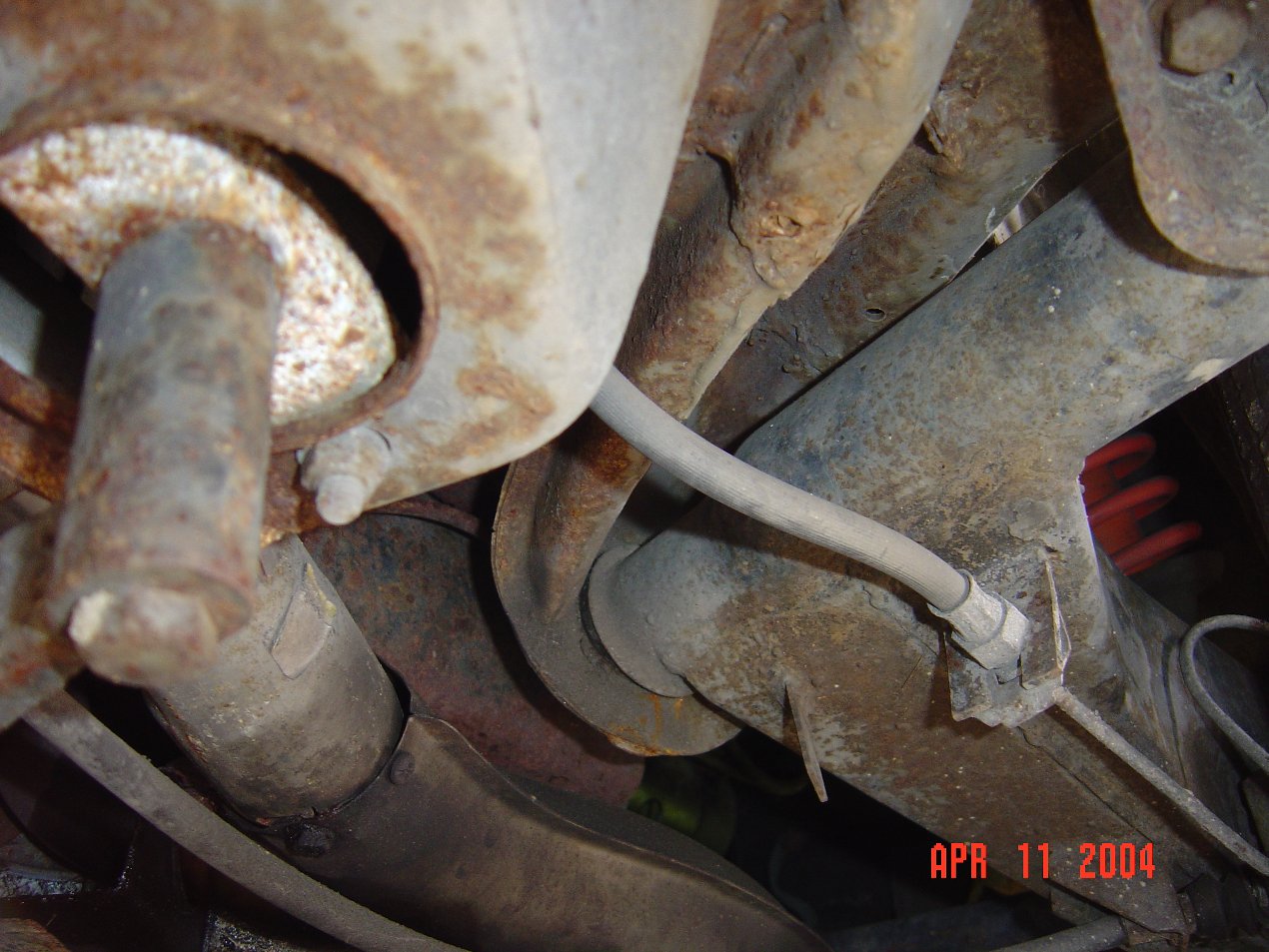

Now, here's a link to the pictures. I'm interested to hear your reactions.
http://users.rcn.com/mikecdgn/Porsche/
what's it like at the bulkhead, behind the seats ? under the driver's pedal board ? under the carpets ?
it looks OK on the outside, but you should have taken pictures of how it looks UNDER the carpet in the rear trunk and UNDER the spare tire and UNDER the carpet in front and behind the seats and UNDER the battery tray and finally, UNDER the car.
just from looking at the huge amount of surface rust bubbles on the shift-rod and other metal parts (like the engine mount) i suspect more rust in harder to see areas.
take off the rocker covers and use a screw-driver to poke around near the jack-posts.
poke the floor-board behind the seats. do the "crunch" test. if the tar-like sound-insulation on the floor board crunches under your fingers, you found the rust!
at least it looks like the car was originally silver. oh, and it comes with a Hynes manual too.
