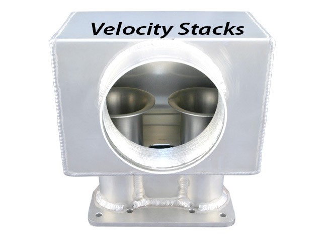

Somehting like this:
But the guy had made an all FG box instead that was less massive.
Zach

Huh. I wonder if I could use these (7617 and 7618) over my existing air filters and just point the "horn" backwards.
Does anyone know if these are designed to go over the air filters, or if they require the filters to be relocated. Enclosing the system should cut down on intake noise, right? or am I just sitting here sniffing glue?
Or maybe put them point forwards and attach them to an airbox that was attached to the firewall. Hrm. That could actually work.
Zach

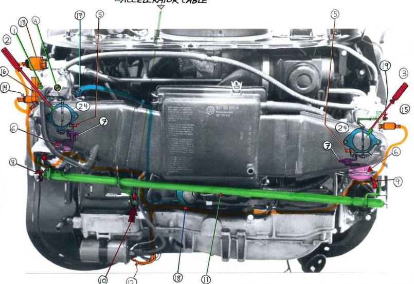

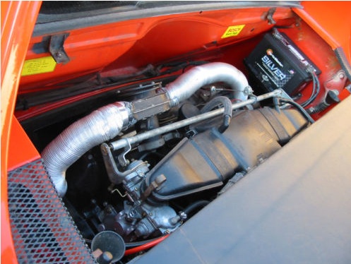

Posted by: Drums66 Aug 16 2010, 01:13 PM
QUOTE(dlee6204 @ Aug 16 2010, 10:59 AM)
For smaller single stack carbs... (This car was on ebay a while back)
Here is another angle from a picture I found. I think they were on some VW buses and carb'd euro 914s. I could be wrong though. I'm sure a simliar setup could me modified for use with 40s and 44s.
,,that 4 is a GC case

I have a regular engine grill. I like the GT style but am worried about noise and rain.
I added a layer of dynamat to the sheet metal part of my engine grill. It made
a noticeable lowering of the sound. I don't have a rain tray in yet but am going
to try one. I am trying to figure out how to dynamat the bottom of the rain
tray as well and see what happens.
I plan to add an external cooler with a fan like you did to help with
engine cooling.
Be nice if there was a reasonably priced air box kit that did not look out of
place in our engine bays.
You could always switch to regular air cleaners for autox and DEs.
John
