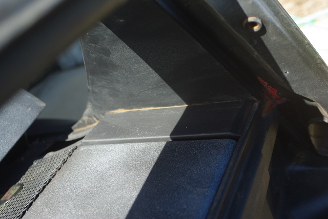

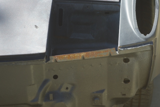

some pics of the (minor) rust:

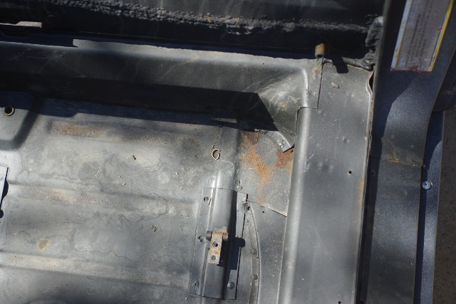

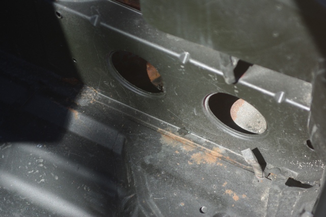

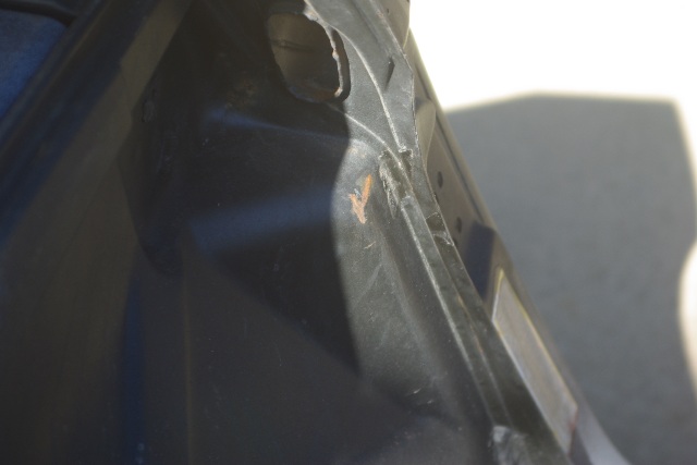

more pics:
This all leaves me feeling SO discouraged! How, for instance would you take care of the surface rust under the headlight bucket? You can't get your hand in there, and the bottoms of them are rusty, as well as the outsides of the bucket drain tubes.... or the area where the inside of the targa sail panel meets the body , next to the engine lid area, how would you get that seam rust free for painting?

Get a small spot blaster from Harbor Freight ( about 25.00 ) and a bag of glass bead. Blast the offending area and brush some Ospho down into the cracks as best as you can. Unless you drill out EVERY spot weld and seperate EVERY panel you will end up with rust creeping out of the seems. It is just a fact of life. I like Oshpo because it has not only proven tself to me, but it is also a water like consistency, and floods into seams very well.
Mark I see no major rust issues at all. All slight surface rust at best. I have way more than that and will get around to some day. But it is only surface rust. You are going to be picked on for sure Chime in east coast.

At least it had primer on it. How many projects do you see that are stripped and left setting? If that was road salt it would be much worse I think. Thats just where the primer was thin or not put on thick enough. Primer is porous and not intended to hold up very long without a sealer and top coat. To paint it most of that primer will get sanded or blasted off I hope. Anyway it needs a lot more paint on it and touched up and assembled like it is is not the way to go, you will be constantly touching up thin places as they show up as you go.
Clean up under the buckets with the spotblaster and get a small touchup gun and turn the air control down a little and the fan spray down to where it is a tight pattern about 2 inches in diameter but shoots out about 13 inches and shoot it up under the buckets. It got painted before it can get done again.
