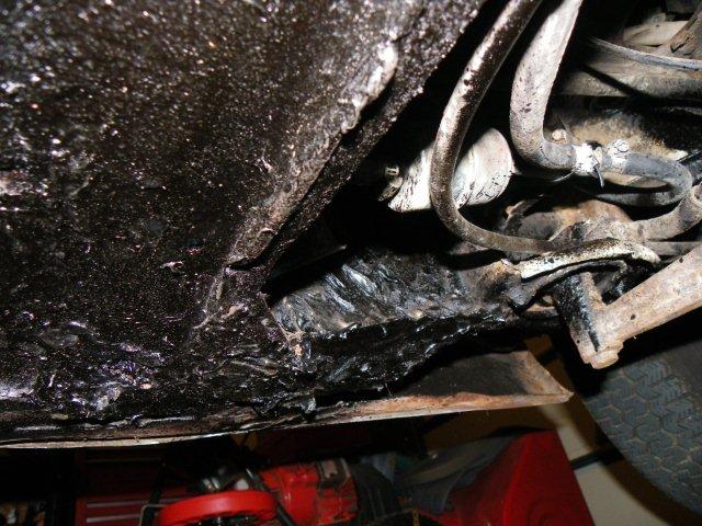

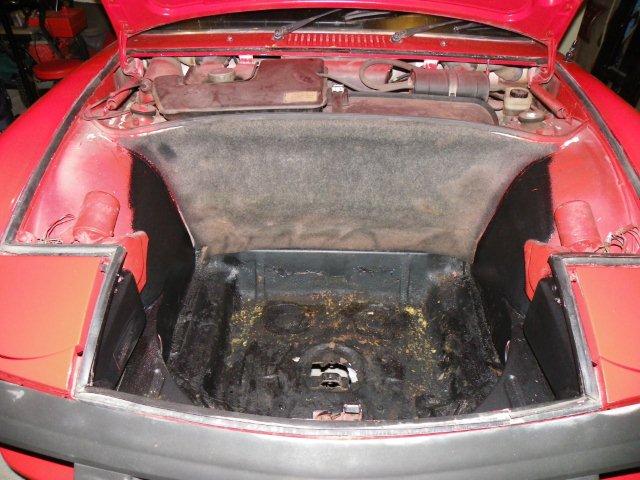

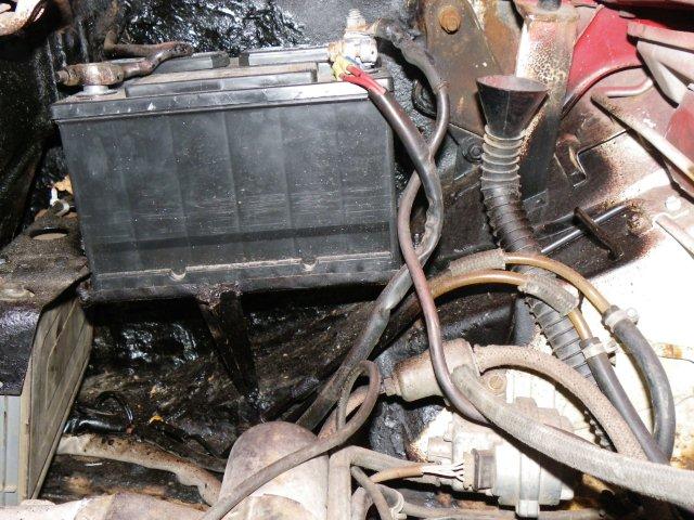

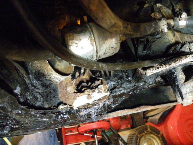

Soo... With Trick or treating done for another year I fired up the heater and went back out to the garage... I figured for sure I'd be taking off the outer rocker cover and prolly welding in some new metal in the rockers.. but the rest of the body from the outside looks good.. and the battery tray doesnt look too bad, so i figured I'd get away with not having to cut the rear quarter out.... WELL... after poking around a bunch more and sticking a screwdriver into the metal that has all this black tar on it.. i found a hole... a hole that means I wont be driving this car in the spring prolly... Here's some pics...
Hole under the spare tire... no biggie
booty fab'd battery tray and support.. the black tar stuff makes it look worse than it is on pictures.. It seems to be pretty solid around here, but I'll know more once the engine is out ( danm i didnt want to do that just yet ) and that tar is all cleaned off.
Here is the kicker... two pics.. before and after i pulled off a loose piece of rust that was all tar'd over..
soo now it looks like the engine long, perhaps wheel house and inner rocker sections... going to have to cut out the rocker panel on the outside... drop the motor , pull out the rear suspension... as well as fix the rockers and put in stiffners..

Good luck on your car. Your first 914 and you are learning already, . The next 914 you want to buy, if it has tarry stuff in these areas, it is to cover up rust that someone doesn't want you to see --RUN away. I hope you are able to make it into your dream car. Have patience and ask questions here.
