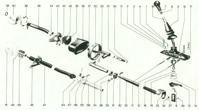

I am replacing all the bushings in my tail shifter linkage but had problems at the shifter balls (#53 in the schematic).
How are they removed? Didn't want to damage anything else in the process.

Posted by: 76-914 Nov 1 2010, 08:14 AM
Mine just fell out. To answer your question; they just slide in n out.
Posted by: Mikey914 Nov 1 2010, 09:53 AM
There is a crush washer you can see in the diagram, you can simply pull it off. The problem you will have is installation, it may not crush enough to hold as well. I drop or two silicone will help (do not use allot if you ever want to be able to remove).
Posted by: pcar916 Nov 1 2010, 09:56 AM
Many of them are stuck in there, some with a vacuum behind the plastic cup if the vent hole is plugged. It's an easy fix.
Solidly mount the shift lever, like in a vice with aluminum jaws or something to protect the shaft, Then don protective goggles and gloves and firmly hold the ball-socket. Blow compressed air into the vent hole. It'll pop right out.
Then separate the ball from it's plastic cup. Lubricate it, replace the cup and stick it back in there. I like silicon lube.
