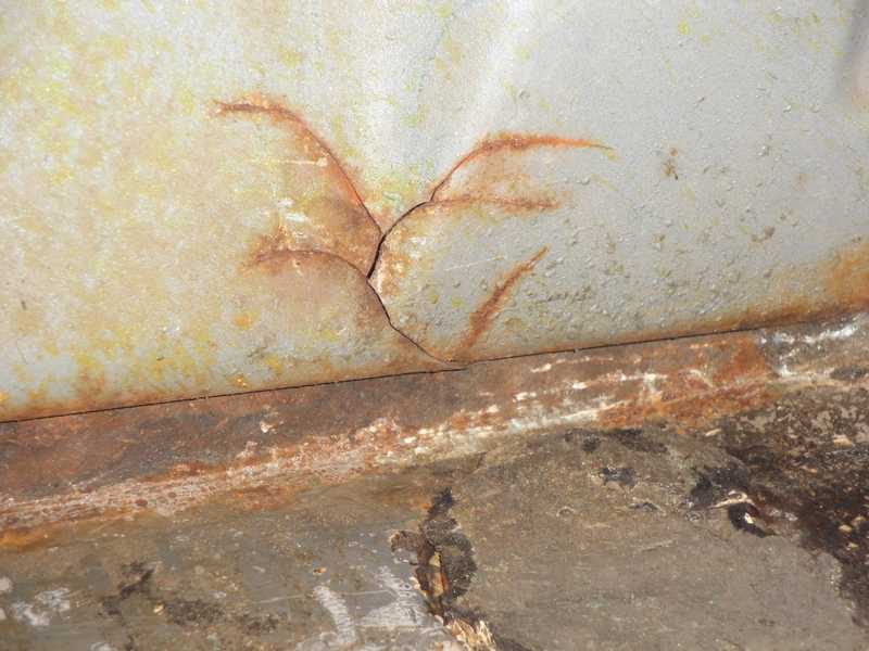

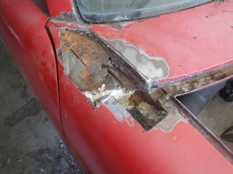

Last summer I noticed this creeping up my driver’s side long:

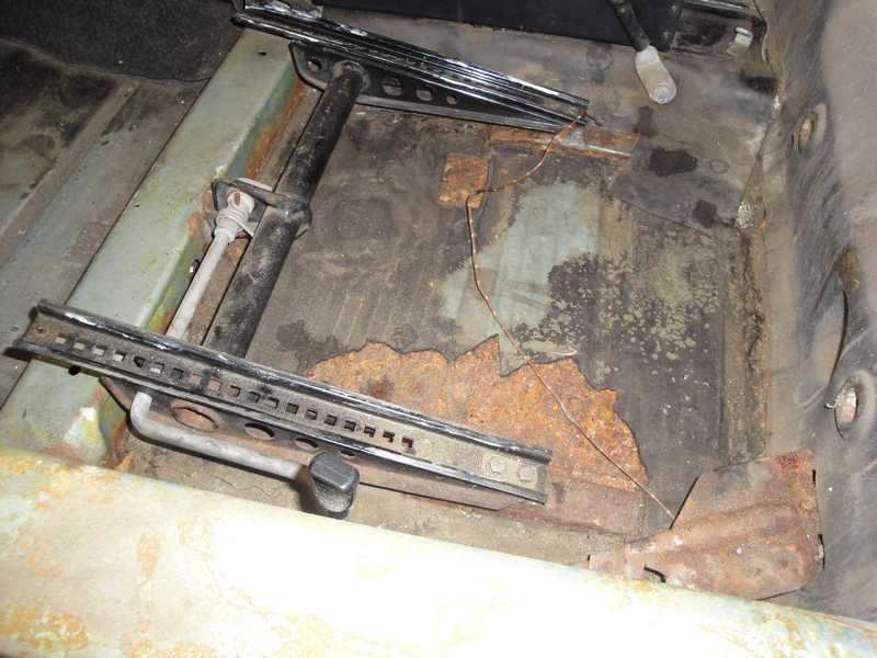

So I decided I had to fix that, and then noticed this a little flaking of the tar under the driver’s seat:

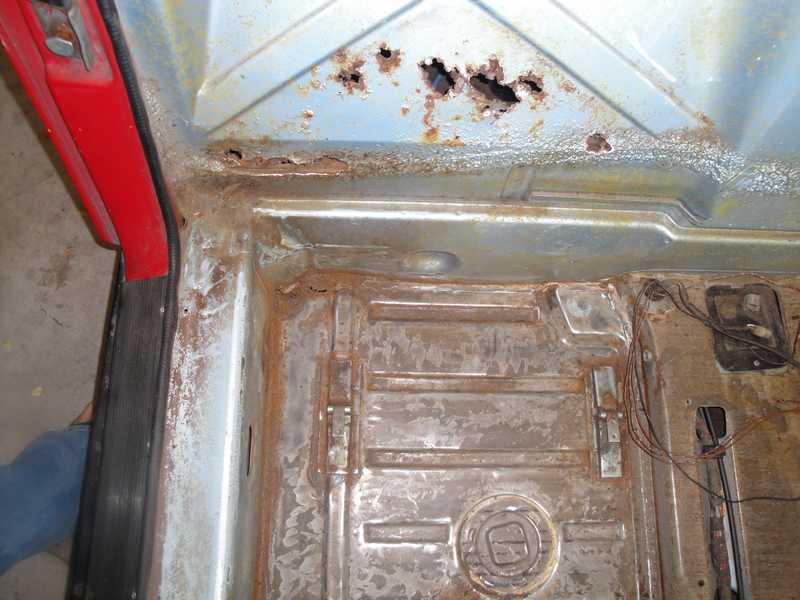

A little poking around and cleaning revealed this:

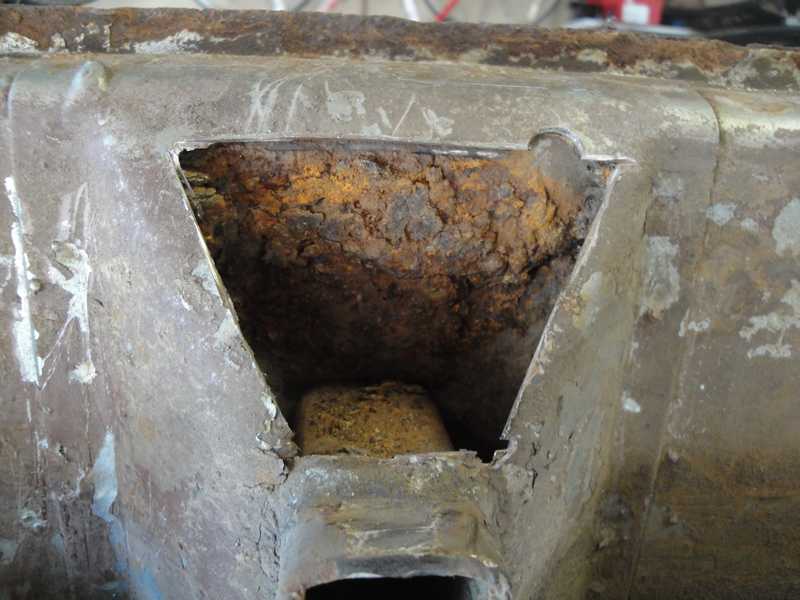

And while I’m fixing those, the PO’s repair of the passenger suspension console looked a little suspect:

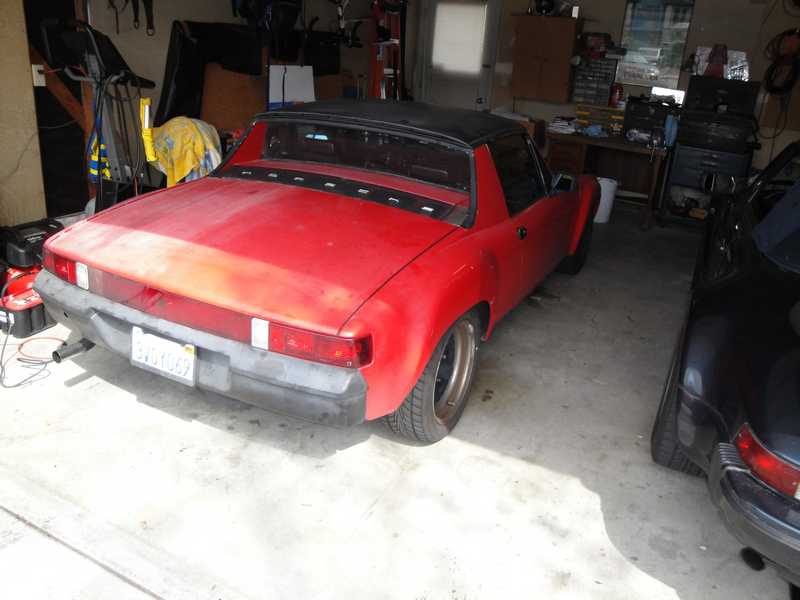

About the car: It’s a 1973 2.0 that’s pretty much stock except for the FG flares a PO put on and the unusual 4-bolt wheels.
As far as I can tell it’s straight and never been in an accident, unless you count a dent in the bottom of the front trunk. It started out as a Florida car, but as far as I can tell from the title it came to California in the 70’s. I’ve owned it since 1996. I rebuilt the engine from the bottom up in 1998 (back when there were sites like the 2-trunk tribune and roadglue was big).

The car has, I’ve now discovered, a few rust issues:

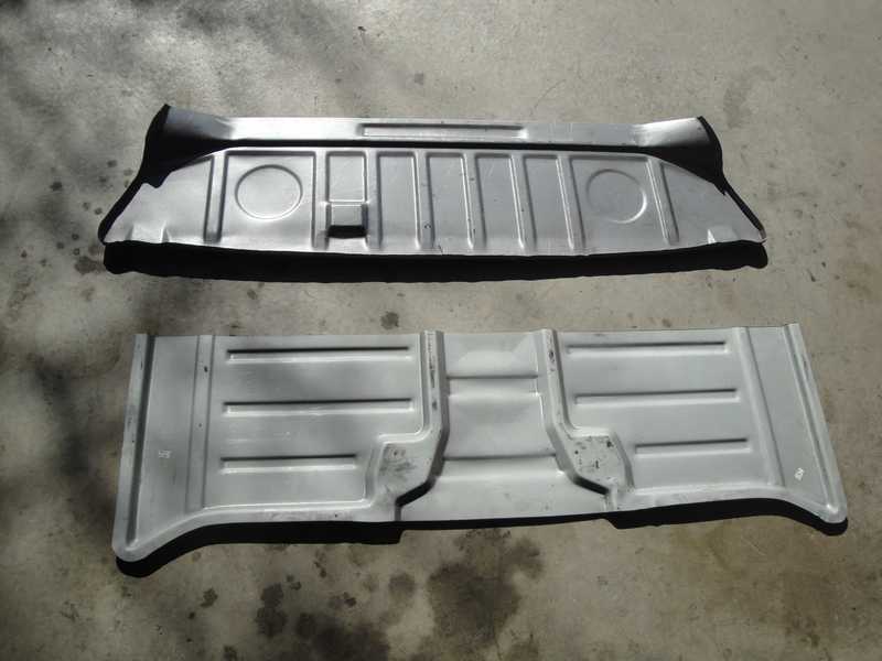

Install Engman long kit
Repair hell hole and surrounding area
Repair firewall
Replace and repair floorpan

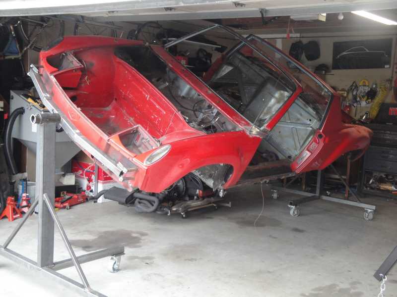

I built a rotisserie using the excellent plans over at Roadglue. It went together without much trouble. As I said, I’d never Mig welded before, but figured it couldn’t be that tough to learn for someone who can Tig, so I went out and bought a little Miller Mig welder. Mig is no doubt much faster than Tig. My welds are pretty mediocre, so I’m glad I’m getting to practice on this before the car. So far the rotisserie has been great. The materials cost a lot more than I expected they would ($500), but I ordered them online, and probably went overboard on the casters ($100 just for them).
I think if I had it to do it over again, I might make the rotisserie have a height adjustment. It would make loading the car much easier. Getting the car loaded was dicey, and I nearly had it fall off the blocks I had stacked underneath it. I finally lost my nerve and bought this:

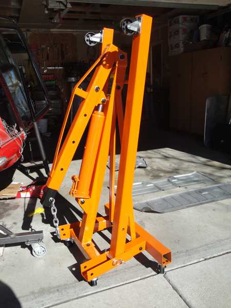

The crane made lifting it very easy – just hoisted the whole tub at once using the seat adjuster mounting holes. Of course, if you have a few friends handy, you could easily lift it and don’t need a crane.

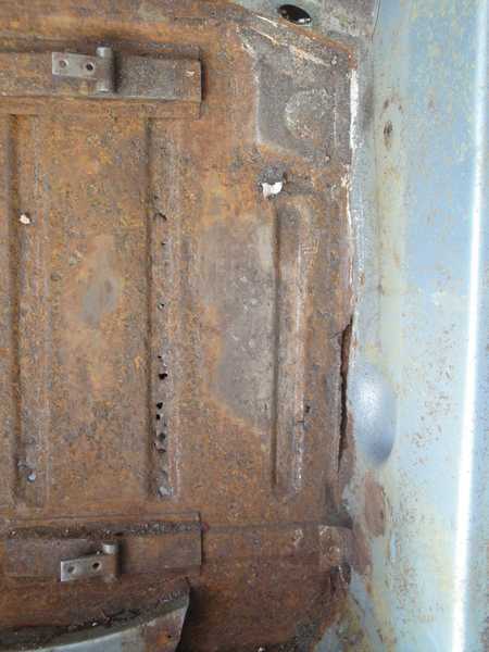

I have the car pretty much stripped. Just need to finish removing the wire harness and a few odds and ends. I’ve also removed most of the floorboard tar. Once I finish that I’ll install the supports I bought from Chris at Tangerine, orient the car rightside up, put bottle jacks under the front and back of each long, check dimensions (I measured before I put it on the rotisserie) and start to work on the hell hole.

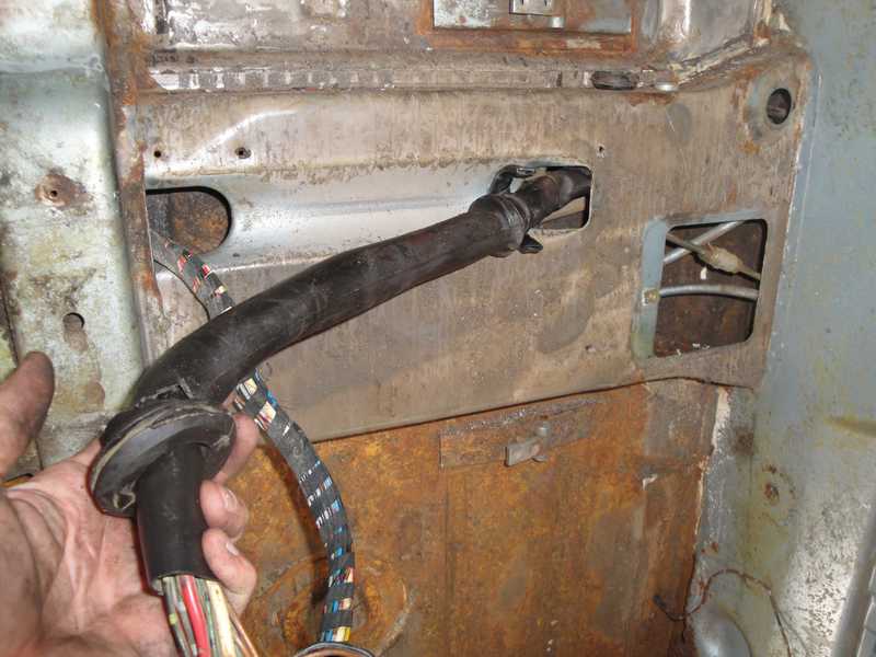

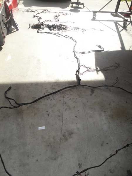

I was able to remove the wiring harness. Not an easy task, but not as hard as I feared either. Getting the snorkel through the firewall and tunnel was the trickiest part.
As in so many things, lube helped:
I Managed to ease it through the tunnel with no tearing beyond what was already there:
Anyone know of a source for these snorkels?

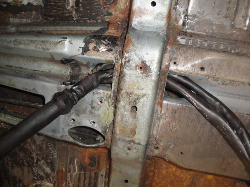

Guiding through the rest of the harness, from both trucks, so everything sat in the driver’s foot well.
Looks like a serious mess. Hopefully I’ll be able to sort it out when it goes back in:

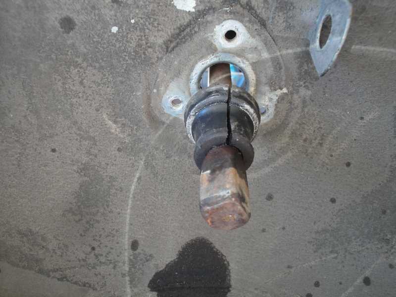

I also removed the factory front and rear sway bars. The front bar was confusing until I learned (from this site) the rubber bushing is split:
Pulling the bushing bracket over the bushing was pretty easy with lots of lube and a gear puller.

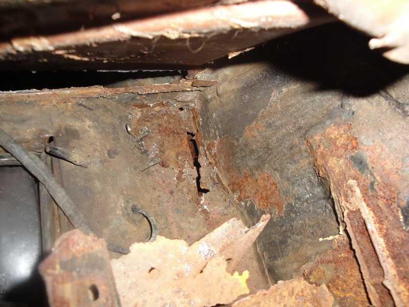

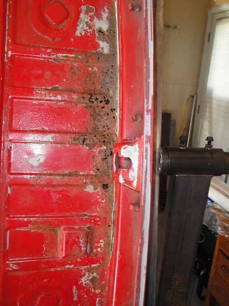

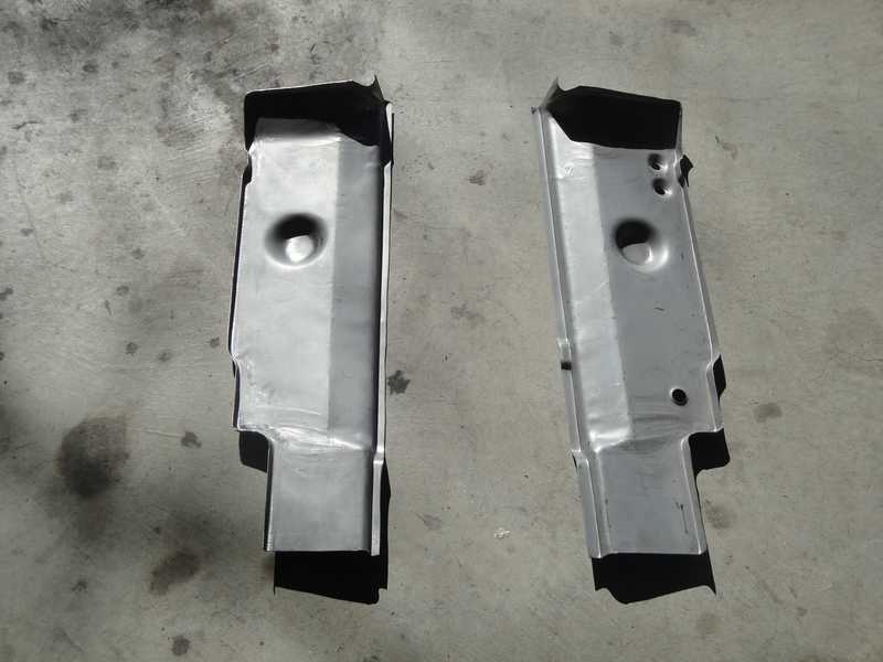

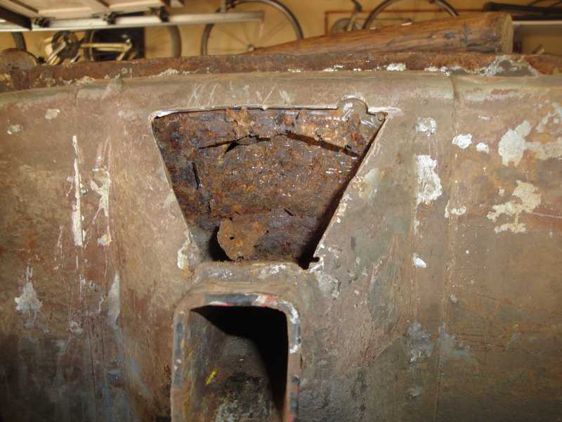

While I had the car upside down, I took a closer look at the driver’s side long where the jacking hole sits. I knew it was rusted and have the replacements pieces ready to go, so I cut a hole in it to see how bad it was on the inside:
After a little poking:
It’s hard to see, but the first layer of metal is mostly rusted away behind the jack support, and the second layer is pretty thin in the worst spot. Looks like I’ll have a little more metal work to do here than I originally thought.
I still haven’t figured out how to replace those brackets without removing a part of the fender. All the build threads I’ve read involve cutting away the fender, which I’d of course prefer to avoid.
I’m not actual digging into that or cutting away any more metal though until I have the car upright and the supports installed to set the gap dimensions.

Your build is looking good. You got a lot of rust to deal with, but not more than
many people here have successfully tackled.
Cutting off a generous piece of the rear fender will make repairing the long and
hell hole area so much easier that it is worth the hassle of welding the fender
back on.
It is so hard to access a lot of that area to clean it or weld on it that you really
can't do a very neat job of it.

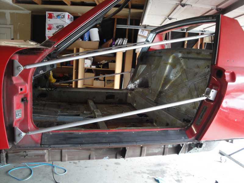

I have the car on a rotisserie. While I’m making the structural repairs I have the door gaps supported:
I also have the car supported in several spots under the longs.

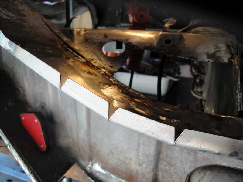

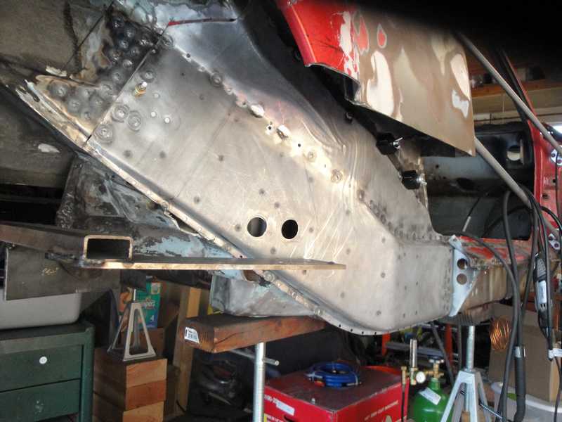

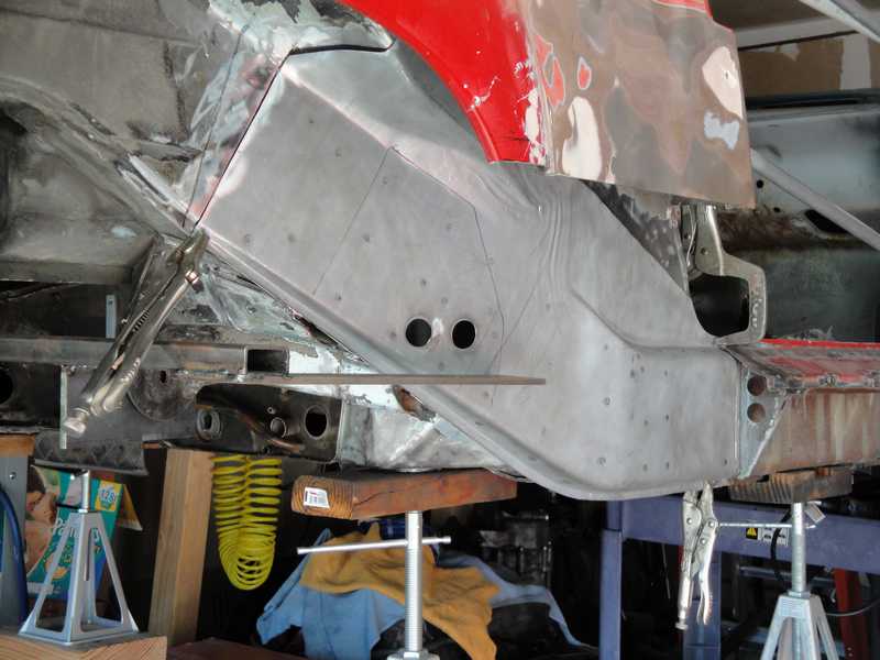

I started digging into the hell hole and discovered tinworm between the panels near the outer suspension console, so ended up removing the inner wheelhouse all the way past the where the outer suspension console mounts, and forward to the passenger long.
My plan is to leave the engine compartment inner long in place. Doing that would allow me to use it to locate the other half that sits on the outside (what Restoration Design calls the inner wheelhouse). The engine compartment long had some pitting and the “floor” of it, below the hell hole and up as high as the hot air duct, was hopeless. So I cut out the rusted parts, fabricated and welded in some patches, and was able to keep the original . I am replicating the 2-ply approach of the original in all replacement pieces. A couple of pieces I fabricated:

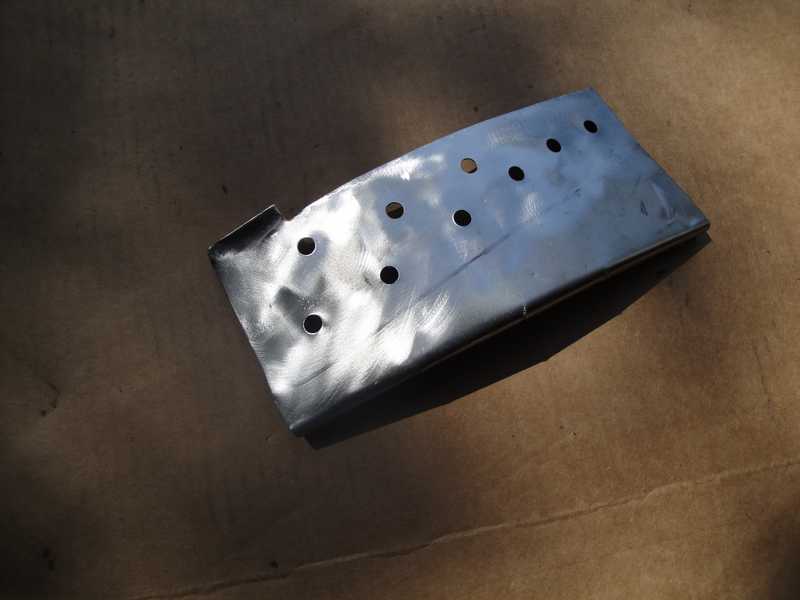

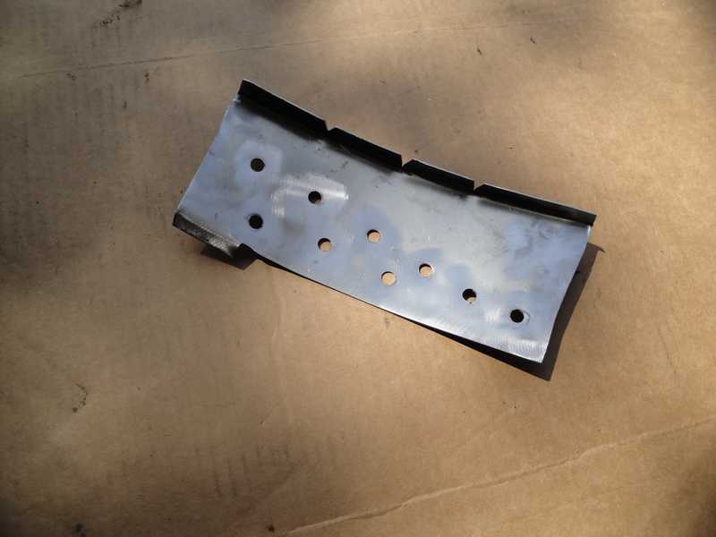

Hell hole patch, goes below battery:
The piece that patch sits on top of, already in place:
The patches welded together:

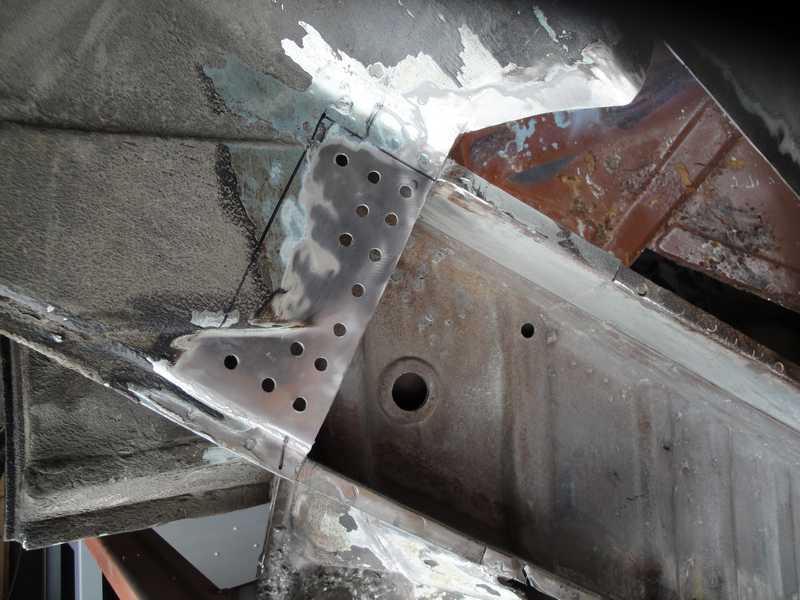

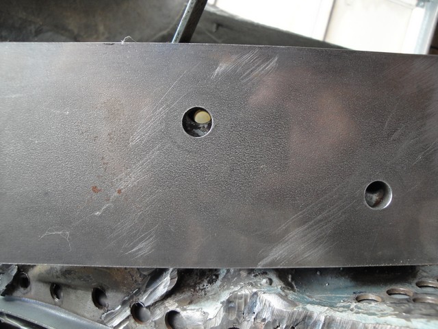

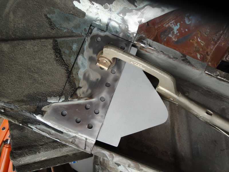

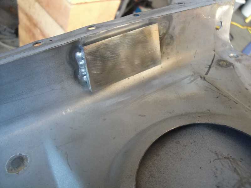

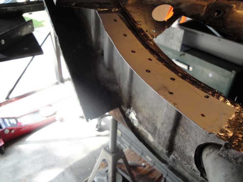

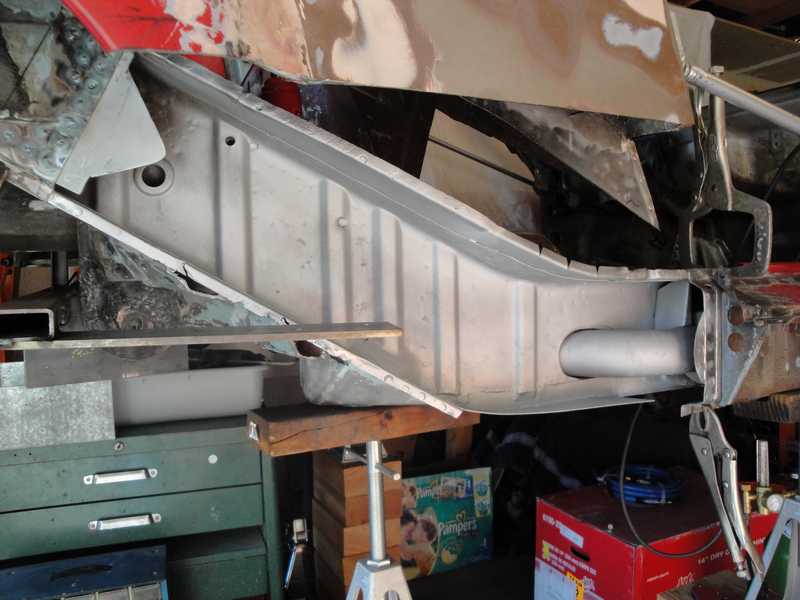

I added this piece to the RD inner wheelhouse, just below the jack receiver, so I would have material to tap into when I get to mounting the rocker panel.
I fabricated and welded on a splice plate to back up the butt weld when I put the wheelhouse piece on. It has an odd shape to accommodate the shape of the RD piece, which is double-walled:
In the below pic you can see a couple of other patches below the air duct, and a patch for the internal portion of the long floor (the external ply will go on later). The splice plate is upper left:
Here’s the RD piece clamped in place:
And here it is tacked:
The fit is generally pretty good. You can see a gap in the upper left where the bend in the RD piece does not match the counter of the existing wall, but that’ll be easy enough to patch. For placement, I am relying mostly on the fact that I was able to leave the other half mostly in place, and so could locate this piece on its counterpart. The angle remains consistent, as near as I can measure it.
My focus is getting correct placement of the outer console. You can see my jig in the pic. It’s attached to the inner console, and the inner and outer on the driver’s side. I am confident I will be able to accurately place the outer console front-to-back, since my jig has no play for this dimension. Up down has some play in the jig, but that ‘s dictated by having to sit flush with the wheelhouse anyway. Same goes for vertical and horizontal orientation. As I mentioned in this thread:
http://www.914world.com/bbs2/index.php?showtopic=140467
The outer console will sit too far away from the inner console, and from the drive’s side suspension, by about 3/16”.
The only explanation I can come up with is that the RD piece is that much wider than my original piece. Since there is no real way to rework the piece to remove that difference, I plan to live with it. I’m really not sure what this will impact in terms of alignment, and whether it will be a problem when I mount my trailing arms (what will take up the slack?). Happy to receive any more input on this.

This looks terrific, Steve. The braces for the door areas you made are really neat. Are they adjustable? Also, is that all of the bracing that one needs? That is, with this setup one doesn't need to support the back and front of the car too?

Doug B: I didn't make those braces, they came from Tangerine Racing, a member vendor. It's a well-made product, and they are adjustable.
No, I don' t think the braces alone are enough support, at least not if you're going to cut into the longs. The car is supported front and back by the rotisserie, and also was supported underneath the longs by jackstands on blocks in several places (the non-hydraulic adjustable kind used for leveling RVs). Those stayed there and I didn't rotate or move the car until I closed up the longs and the car had some structural integrity back. I was trying to get that far before having to move the tub, and just managed it.
