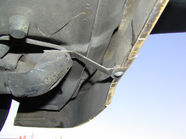

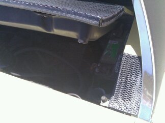

Here is a better photo of the LE front spoiler brackets:

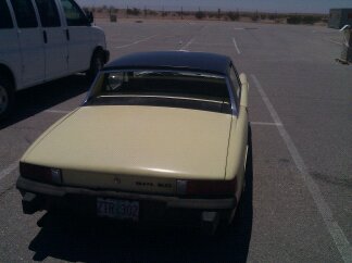

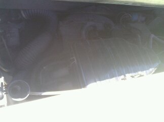

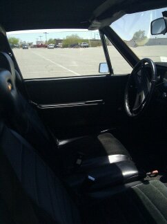

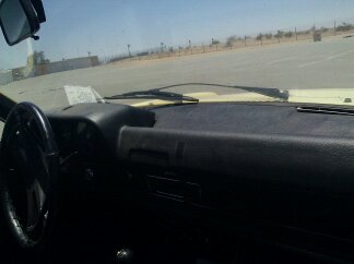

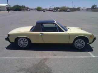

Finally got some pics. Took me forever, but here it is.
Nice looking car; thanks for the pictures.
SWEET looking car. Semper Fi Marine. Don't get married or you will lose your car. Haha
At this point it would seem that a witticism about how I could have my cake and eat it too would be fitting. But I have seen too many people get married to know this is not the case .
