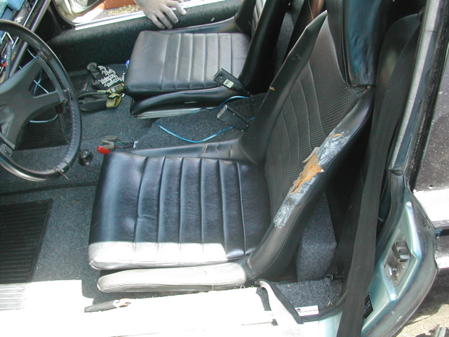

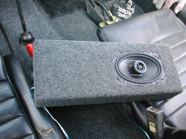

I made a new set of behind the seat speakers for my new car. Check em out.
They're Eclipse 4"x6".
They look awesome.
Dude, your hands could use a tan.
Jen
How do you suppose I got my hand on the camera on the drivers side and then put my hand on the longitudinal on the passenger side? I'll pass the message along to Brandon though.
Thats alot of air volume for that little speaker..(keeping in mind its a speaker, and not a subwoofer) You could have put another speaker in there for that much air!
Looks good though.
Although I havent turned on my radio in my car for hmm... 7 months?
Looks good! I'm not trying to critizize, but putting a 2-way speaker behind the seat is going to block almost all of the highs and mids that the speaker produces, making it sound muffled. If you are using them for bass, you would be better off going with a small sub-woofer, maybe around a 6" or 8". Of course, I am no speaker expert (although I did stay at a Holiday in last night), so everything I say should be taken with a grain of salt. I'm sure somebody that knows a lot more than me will weigh in.
mike the man is right most mids and highs require a direct path to the listener.or they will sound"off" ,what will over come that is power lots and lots of power any speaker that dosent require you to cut into youre 914 is a great one. i see you found carpet to cover them that match youre carpet
looks good ,are those speaker panels installed with no speakers???
that would give you great sound,and btw thats a great looking carpet
I do agree that hacking up the car to put speakers in is bad, some jackass put speakers in my door panels, and did a piss poor job of it I might add. So, putting the speakers somewhere out of the way is a good idea, they just might not sound the best. If I didn't already have holes in my door panels I'd get some of those fancy kick panels that Morphenspectra makes. But who really needs a stereo anyway? With the top off and the motor wound up, you can't hear much in any case.
The sound isn't crystal clear from the rears, but I don't think it's much different than speakers mounted by the rear window in some modern coupe. Those speakers have a lot of crap in the way of your head as well. What I do know is that they really round out the sound and give you a little kick in the back to go with the bass. Now I'm thinking I should put two 4x6s in a box that size as mentioned above. Might just have to make new boxes for those. I have to do some research about 4 ohm versus 8 ohm loads on a head unit and volume effects and such. I would be running all four rear speakers off the head unit and each box would act like a single 8 ohm speaker (or 2 ohm, if the head can handle it). Might be good.
A lot of external amplifiers are 2 ohm stable. Not sure about head units, though. I've never heard of any that are 2 ohm stable, but I'm sure there are some.
Yeah, I'm having trouble trying to figure out how to wire four speakers in the rear. I guess it's time for a bigger amp.

My boxes are 2.5" wide, so I think 4" would be too much. I actually could have gone a little thinner and been okay.

I'm no expert but I do know that frequencies below 250hz are non directional. So I'd guess that if you could put a decent small sub with a 250hz low pass filter (or if you had a nice crossover), it would probably be ideal.
