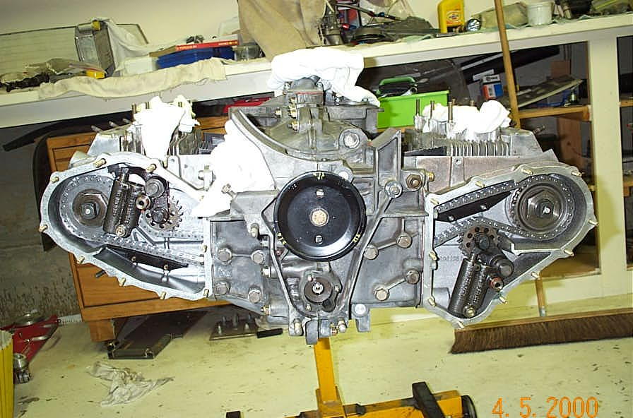

A fairly common occurance with magnesium chain housings. Those shafts (steel)are only pressed it to the mag. Couple that with the fact that the shafts are not as hard as the chain wheel pivot thus they notch the shaft oblong (making a step in the shaft). Some think this notching helps lead to tensioner failure( & shaft walking)....include me in that "some". Your displaced shaft will just walk out again.....the epoxy is just used to seal the shaft/housing interface.
My orginal bits went into the recycle bin.
The cure for this is $tone expen$ive. Aluminum chain housings hold the shaft in much beter. Bushed wide foot pivot arm are also necessary....been there, did both 10-12 years back when it was less expensive.....but not cheep.
I've included a pic showing the ten & pivot wheel on the same shaft.

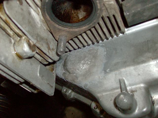

Here's the temporary fix so it doesn't leak oil all over the shop:
Surface roughed up with crocus cloth, sprayed with brake cleaner, wiped with alcohol (several times). One layer of JB Weld, then covered with fiberglass mat impregnated with JB Weld, then a small coat of JB Weld over that.
