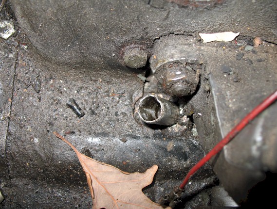

Posted by: jimkelly Aug 9 2011, 05:44 AM
related pic
Posted by: rnellums Aug 9 2011, 07:44 AM
QUOTE(jimkelly @ Aug 9 2011, 04:44 AM)
related pic
Good shot of how the oil gets all over everything! It is nice to get back on topic!
