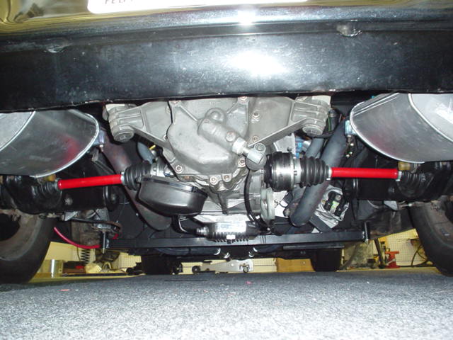

Heres the mount... I THINK I have it in backwards (I debated on that for a LONG time installing it... guess I just did it wrong.... Eh I'll figure that one out.
Andrew
Posted by: dan10101 Sep 30 2004, 11:47 PM
hehe, ya, I cut the tip of the exhaust off... It was hitting... and it was quiet... now my quarter pannel gets warm.. lol
Posted by: skline Oct 1 2004, 12:23 AM
Dude, that aint right. It should fit perfect, that looks like its going to fall out. You need to fix that right away. Trust me, you dont want to take any chances with that one. Did you see this???
Posted by: Andyrew Oct 1 2004, 12:29 AM
Oh, I know its not right... notice that I posted pics on it and such? lol
Ya, Im going to fix it before I drive it again.. the trani is being supported by a small jack right now just in case.
Andrew

Attached are a couple of pics of how the trans. mount is supposed to look. This is a combination of the 911 sport mount, a notched washer from the stock 914 mount and Rengade's spacer.
Getting the timing right can be challanging with the v8 installed. You may have the distributor installed off a tooth or two but you should still have more power than described. With my timing set correctly, I could still rotate the distributor 3/8" in either direction without loosing the amount of power you describe (3/8" measured by marking base of dist. and having a fixed mark where it slides into intake).
I'd somehow verify the secondaries are opening with a device that indicates movement while your on the road. I don't have this device exactly figured out but had visions of a pen attached to secondary that would mark a fixed piece of paper?????? Maybe Dad could be talked into looking at the secondaries with the targa removed while your driving : )

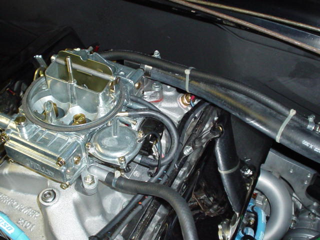

Not the best pic of how to connect hoses to a Holley but all I have.
The three hoses connected to carb are as follows:
Large, medium and small........viewed left to right
Large goes to PCV on valve cover.
Medium is self explanatory (carb to carb connection)
Small hose is connected to vacumm advance on dist.
John

Posted by: John2kx Oct 1 2004, 12:11 PM
QUOTE(Andyrew @ Oct 1 2004, 07:44 AM)
In what order did you install the mounts? Trani to adapter to body?
Don't think this is critical but I installed the sport mounts firmly, then installed the remaining pieces loose. With the engine beam mounting bolts loose, I positioned engine fore/aft, left right until the large bolts that go through tranny ear were lined up, ie, no binding fore/aft or side to side. Then tighten everything up. Don't be surprised if you have to make a clutch cable or shift linkage adjustment if the engine is moved fore or aft. Never had the tranny move in two years of operation using this method.
Do pay attention to where washers are installed or ommited as compared to your setup, and the size and thickness used. (there has to be a good footprint between rubber and metal for this setup to work right). Installed correctly, you will keep everything in place when you squeeze the power on.
John

Redoing the trans mount seems to help. But the trans hub is lower than the wheel hub. Upon acceleration it must be dipping more expecially with 2 people in the car. Not sure how much the axles can be out of square before they start having problems.
Posted by: John2kx Oct 2 2004, 10:30 AM
QUOTE(dan10101 @ Oct 2 2004, 08:07 AM)
Dan,
This is how my axles looked with car fully assembled and tires planted on ground. You may be onto something but you mentioned being able to roll the car by hand. Maybe try rolling it with 1-2 people inside.
I could shift my axles side to side at least 1/8" or more while in the air or when planted on ground.
John

Our trans sits much lower. Possibly too low.
We're going to have Andrew try without my fat butt in the car to see if it makes a difference.
