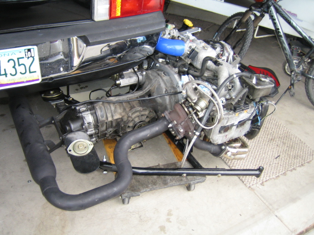

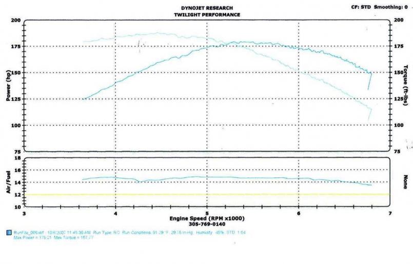

In 25 words or less, my reasons for going Subie turbo:
- easier to maintain modern engine,
- lighter compared to a small block Chevy,
- reliable 215 RWHP plus tunable to more if desired.

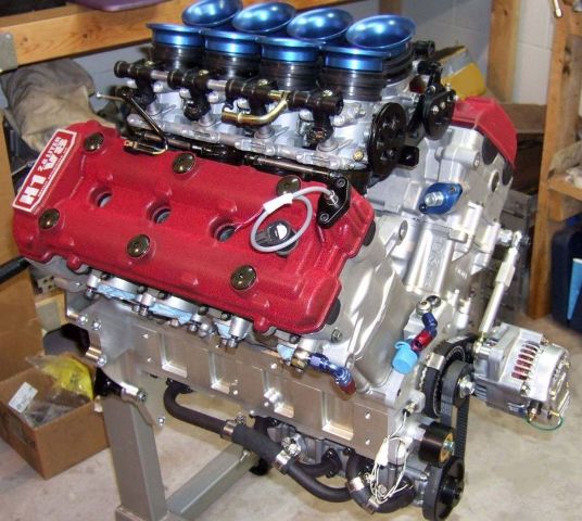

Money no object would involve a Hartley H1.
2.8 L
400 HP @ 10,000 rpm
275 ft-lb @ 7,500 rpm
200 lbs
two Honda motor glued together.
OK not glued.
Yea somethng like that.
