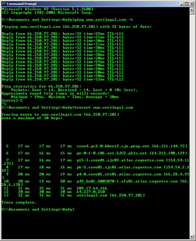

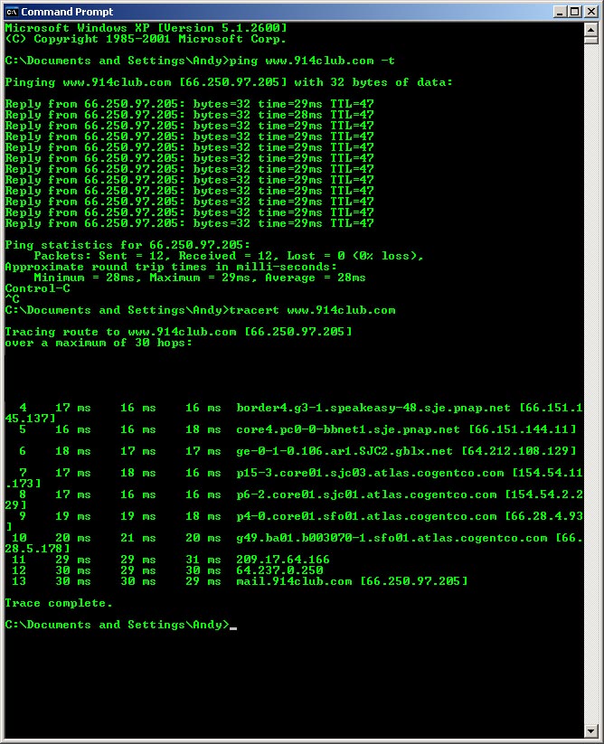

ping and traceroute to www.verilegal.com:
ping is a steady 30, traceroute has no major hickups, site runs fine
ping and traceroute to www.914world.com:
ping is a steady 29, traceroute has no major hickups, site runs fine

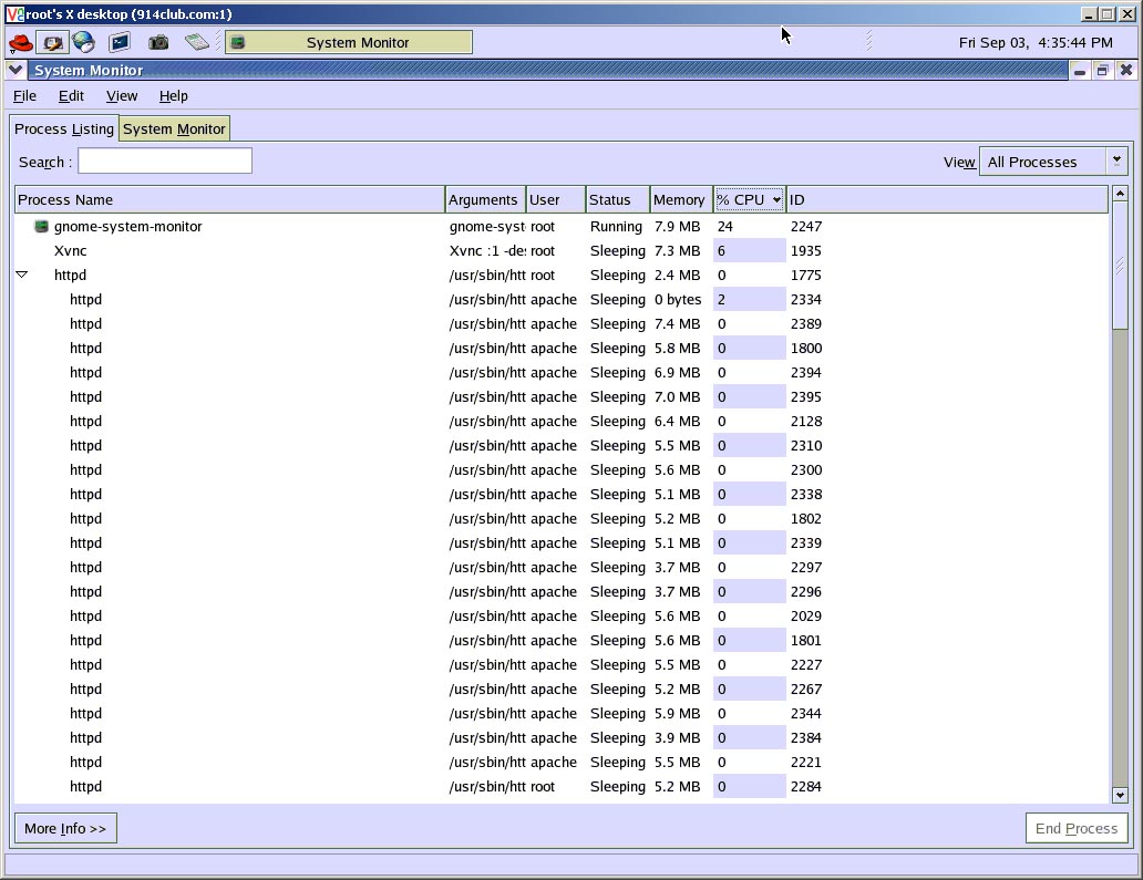

Here you go...
here's a shot of the system monitor ...
as you can see the monitor itself and VNC eat up most of the CPU, but obviously only when i'm remotely connected and run the monitor.
the same is true for the CPU bar-chart. it's almost maxed out when i look at it but when i minimize it and come back later, it's fine except a occasional spike.
the monitor itself eat's up 1/4 of the CPU!!!!
however, the machine will clearly benefit from more RAM, the physical ram is almost maxed out ...
so that will be the next step ...

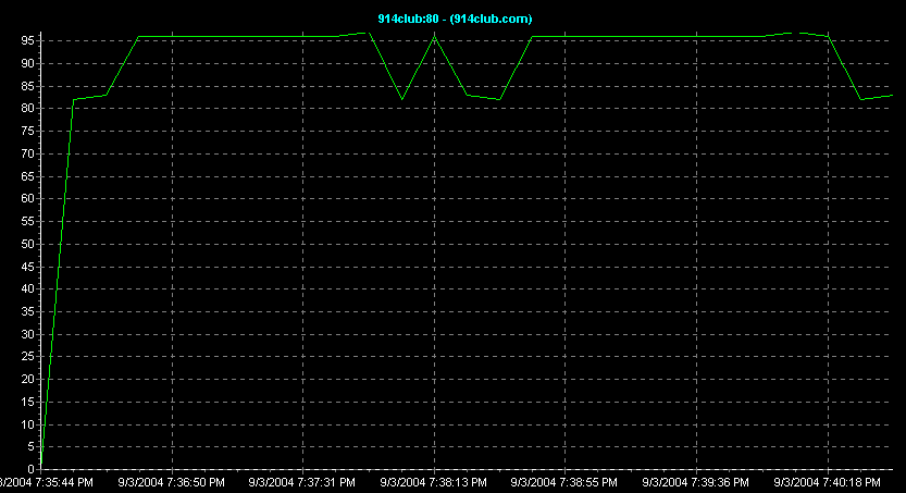

Andy,
I pinged the box at 10 second intervals for five minutes. The results are below.
I got responses between 82 and 96, with 96 being the norm. Oh, I'm on the East coast.
Yes. It's running slow. About 20 to 25 seconds to load a page on the forum.
Not surprisingly, it loads slightly faster if I am not logged in. (by about 5 to 10 seconds)

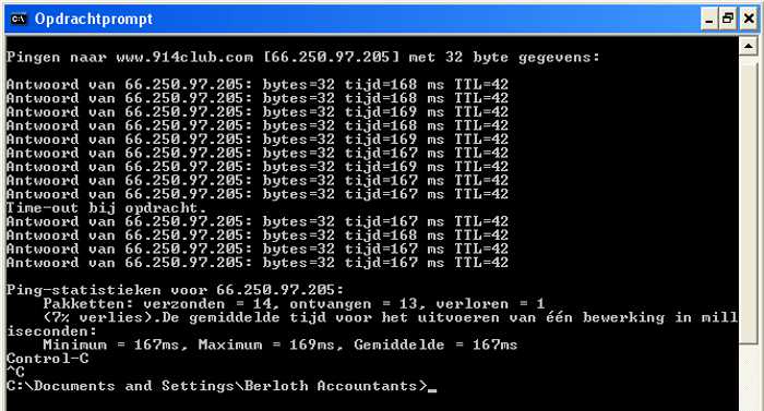

ok, so your ping is steady (altough on the high side) but the site is slow. as is jeroen's connection ...
one last thing
can the two of you post a traceroute to the club server?
thanks!
Andy

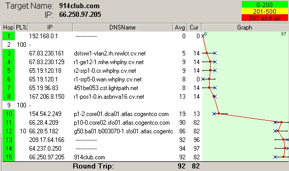

Here's my tracert
Whoa. I think this is a simple case of Andy's juggling too many things at once, feeling harassed, Anthony misspelled Mark's name as Marc, and general confusion...No need for everyone to get their knickers in a twist.
Andy, I did a traceroute from my home ISDN connection, and everything looks fine to me. 20-50ms times, which is basically about what I'd expect to see over this connection to anywhere. Someone's reverse DNS is choked up, as I halt somewhere inside cogentco unless I used -n to turn off name lookups (209.17.64.166 is the address it's choking on). I'm 12 hops from the server here, and the last hop has roughly the same ping time as the first hop. Looks pretty clean to me. I get essentially the same results with verilegal. Indeed, pretty much the same ping times to www.yahoo.com (lord knows where that actually goes).

I notice that the traceroute is taking a different route across the country. Last time I provided a traceroute (about a 4-6 weeks ago, on another thread), there was a different router somewhere that we thought was causing all the hangups.

OK, that vmstat dump (thanks, Mark), shows:
there aren't many processes waiting to do anything (first column is mostly 0)
the CPU is reasonably busy (20-50% idle)
it's swapping some (mostly single digit numbers in si so, but some double digits)
relatively little disk activity (bi bo numbers, anything under 400 regularly is low)
We're not really correlating this to board "slowness" (seems fine to me right now), but I'm sticking by my guns on this. If one of the admins can repeat the vmstat exactly when the board is definitely running slowly, we'll see what it's like then. If it regularly goes into double digits on si/so, it's hurting. Disk and CPU don't appear to be a bottleneck, at least from what I've seen so far. The fact that the CPU isn't idle yet it's not running user processes means it's busy doing housekeeping tasks (like swapping).

it's not a network issue. you can see you get a fast reponse when setting up the tcp connection with your http request, but a long delay waiting for content ("waiting for www.914world.com"). when the content is ready, it loads quickly. if it were packet loss, congested network, etc you would get a slow loading page more so than a slowing responding page. someone should run tcpdump on the server and watch the connections being made, might give some more clues.

Here's a traceroute from my mail server. It's interesting to note that there is a lag of 50 seconds between hop 7 and 8. The response times don't show it, but it's there. I don't know what it means since it obviously doesn't take that long to contact the server. Anywho...
> traceroute 914world.com
traceroute to 914world.com (66.250.97.205), 64 hops max, 44 byte packets
1 access01-fe6-0-18.ftc.frii.net (216.17.222.6) 0.448 ms 0.422 ms 0.296 ms
2 core01-fe6-0-701.ftc.frii.net (216.17.230.17) 0.749 ms 1.019 ms 0.928 ms
3 core01-atm3-0-32.den.frii.net (216.17.230.42) 3.698 ms 3.817 ms 4.784 ms
4 f29.ba01.b006467-1.den01.atlas.cogentco.com (66.250.5.253) 3.879 ms 3.803 ms 3.805 ms
5 g9-2.core01.den01.atlas.cogentco.com (66.28.5.21) 3.927 ms 3.829 ms 3.808 ms
6 p4-0.core02.sfo01.atlas.cogentco.com (66.28.4.130) 238.887 ms 205.652 ms 218.214 ms
7 g50.ba01.b003070-1.sfo01.atlas.cogentco.com (66.28.5.182) 28.611 ms 27.725 ms 28.216 ms
8 209.17.64.166 (209.17.64.166) 28.969 ms 29.106 ms 29.114 ms
9 64.237.0.250 (64.237.0.250) 29.632 ms 29.475 ms 29.830 ms
10 mail.914world.com (66.250.97.205) 29.281 ms 29.258 ms 29.638 ms

Gint, that lag between hops 7 & 8 on your traceroute is the name lookup for that hop timing out. Use -n to skip the name lookup, and it will sail right past that. The reverse DNS for that 209 hop is having problems. You can't look it up with dig -x, either.
