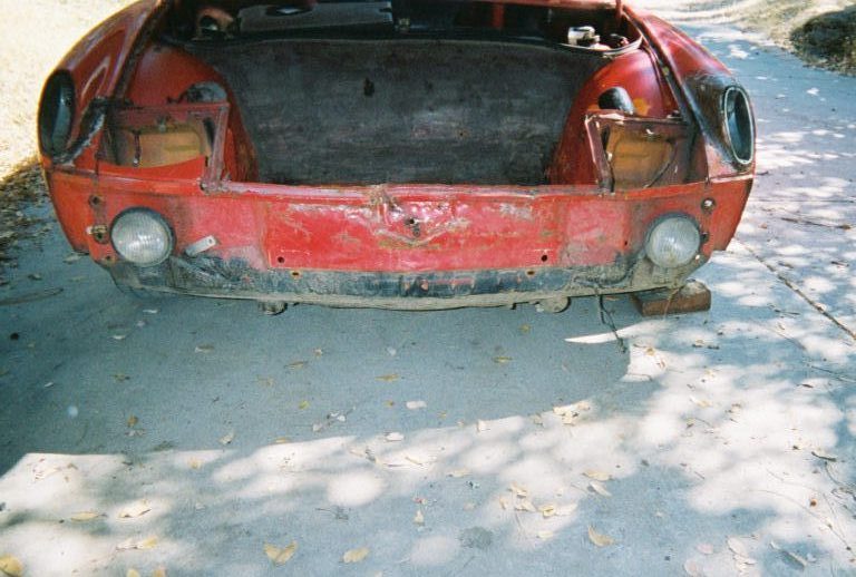

Ok. I have finally got pictures I was a little disapointed in them. try to see them more in 3D. the pictures look so flat it is hard to see how the trunk is pushed in and how bad the damage is.
Her is the front of the car. obviously the bumper and everything but fog lights have been removed.

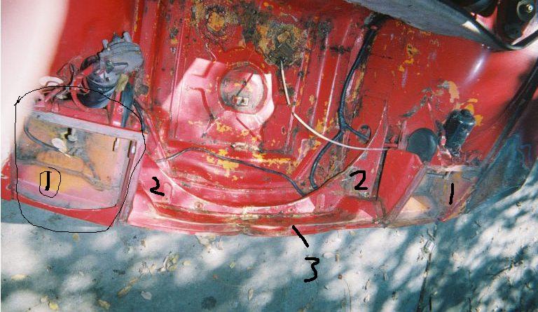

I have had some time to think about it and figured that all I really need is a plave to do some torching and welding on this thing. I just dont think banging t
his metal straight is the right way to go I see three basic sections that could be cut from either a doner car or bought new and welded inplace of what I have. 1st I would want new headlight buckets (both). 2nd The front trunk molding in between the headlights and 3rd the supporting brace that forms to the spare tire. If i could get these in pieces or even better all in one piece then I might be able to find someone to just do the welding swap for me. ok that is my new idea. here are more pictures

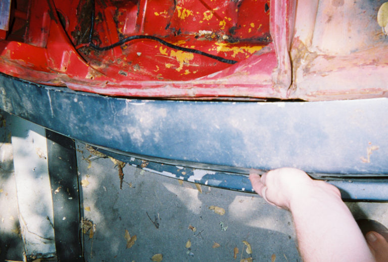

I am using a gt type style front bumper to show the gap that still remains after I pushed most of it out.
I'd just go for the whole front clip. Cut off the first two feet of the car and replace them. If you're going to do cutting and welding make it all perfect and replace the whole thing.
the fenders are still straight. The right side took more damage than the left. Here is the only place that i found damage. it seemed to slightly buckel but it is not bad at all.
Maybe cut along the seal channels. Sometimes you have to replace some good with the bad to keep things easy.
you mean like cutting alont the blue line. also... how much will metal work like this cost? is this going to save me any money?

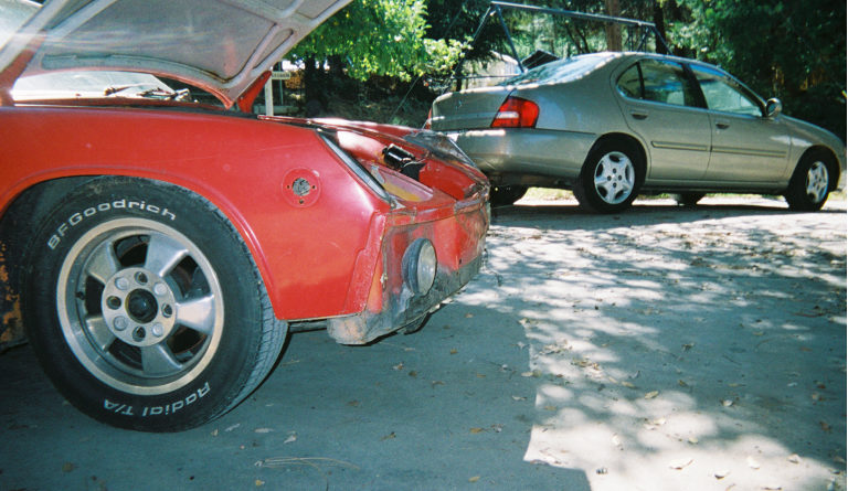

here is a good side shot too. I hate it. from a couple of angles (looking from the rear of course) you cant even tell their is any damage. pisses me off everytime I see the car. Hate deer. If I had a snow plow I would just go driving and pick off all the ones I found wondering in the road. then we will see who wins.
When I hit the deer i was doing about 50 and hit him dead on right between the fenders. In fact I hit him so hard he cleared the top of the car and didnt touch the windshield. I know becaue I had the hop down and saw his body fly over me. I will never forget that.
For what it's worth, I don't think he meant for you car to hit him.
The feeling's mutual. Deers hate 914s too. They told me so.

Yeah, you could cut it along that blue line to each seal channel and then down to the front. Call HPH for a price on the front clip or see if someone on here is cutting up a car.
Do you have access to a welder, or are you going to have someone do this work? If you replace one large chunk there is much less cutting and fitting than if you're trying to piece part a bunch of small areas. That blue line replaces all the bent stuff and all the welding seams are easily accessible. If I were doing the replacement, I would quote 35 hours for the large section.
