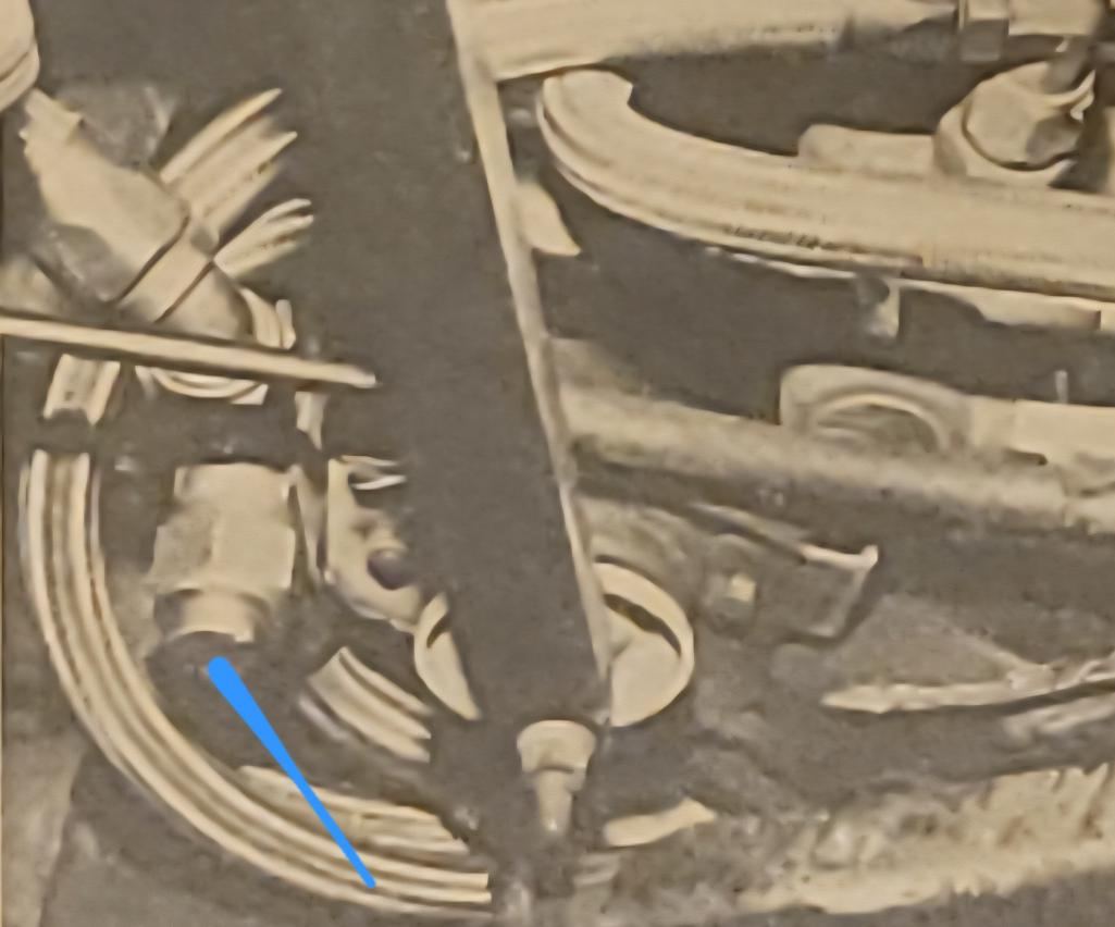

The scavenge line feeds into the lower part of the oil tank. (see pic) Internal passages feed it thru the filter then into the tank.....it also feeds the opposite way to the sump if left to sit for a week or 2.
Many feed lines ...tank the below oil cooler....have a steel joint that can be cracked to drain the tank if necessary. You wouldn't want to use an aluminum fitting here as they will wear out if disconnected repeatedly.

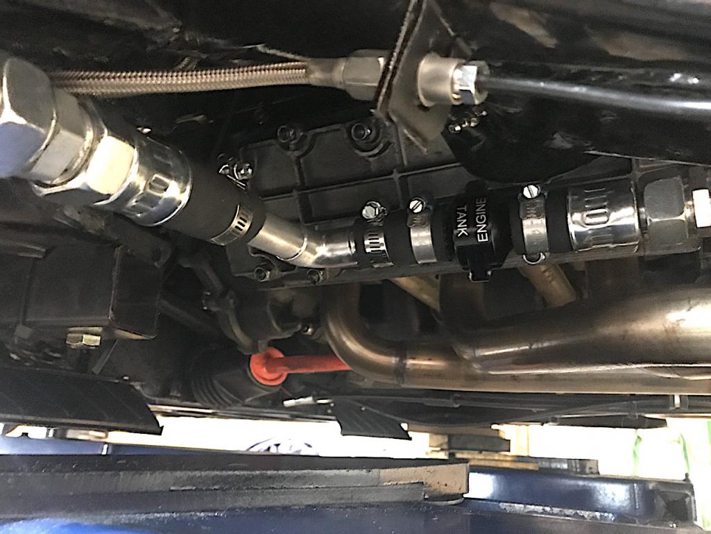

Posted by: mb911 Jul 9 2024, 05:14 PM
I did this for mineAttached Image
Posted by: 930cabman Jul 9 2024, 05:35 PM
QUOTE(mb911 @ Jul 9 2024, 05:14 PM) *
Looks slick, no interference with your exhaust pipes? Mine is vey tight in this area
Posted by: mb911 Jul 9 2024, 05:47 PM
QUOTE(930cabman @ Jul 9 2024, 03:35 PM) *
None whatsoever

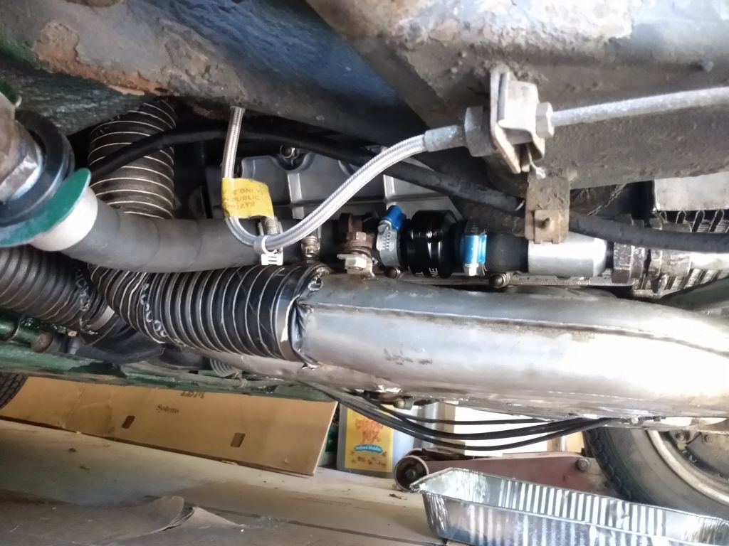

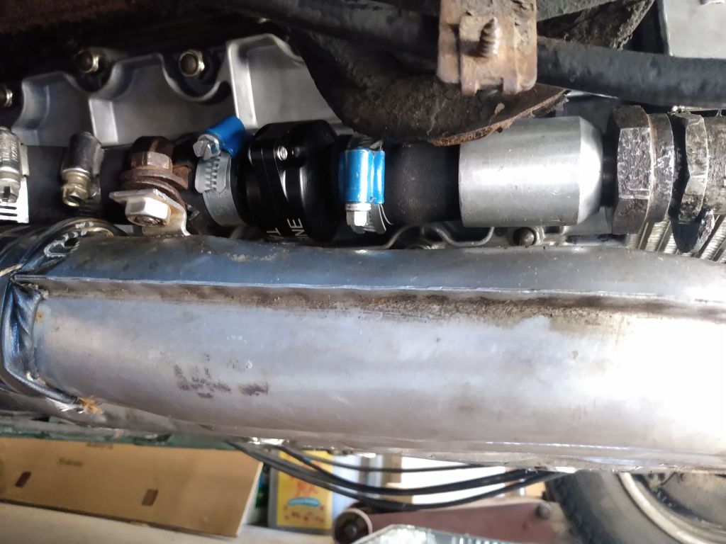

Posted by: Krieger Jul 9 2024, 07:38 PM
This is the solution I came up with. I ordered the factory oil lines from the the tank to the cooler. It came with a union. I had a face machined then drilled and tapped it for a drain plug. I drilled the plug so I could safety wire it.
Posted by: Krieger Jul 9 2024, 07:43 PM
I am very happy I did this. It drains very quicky and isn't messy like disconnecting fittings. I use an aluminum washer from the valve cover as a sealing ring.
Posted by: brant Jul 9 2024, 08:17 PM
QUOTE(Krieger @ Jul 9 2024, 07:43 PM) *
That’s nice
-12 or -16? Scratch that ….. pipe thread what size?
Where did you find it?
I’ve been splitting aluminum AN fittings in my line since 2005 without issues
Probably over 150 oil changes/events
