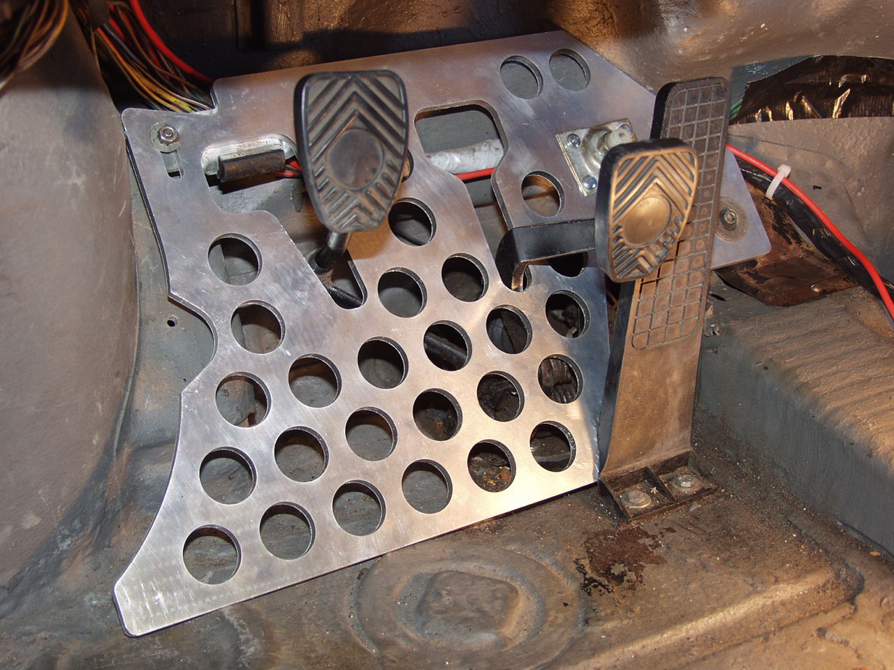

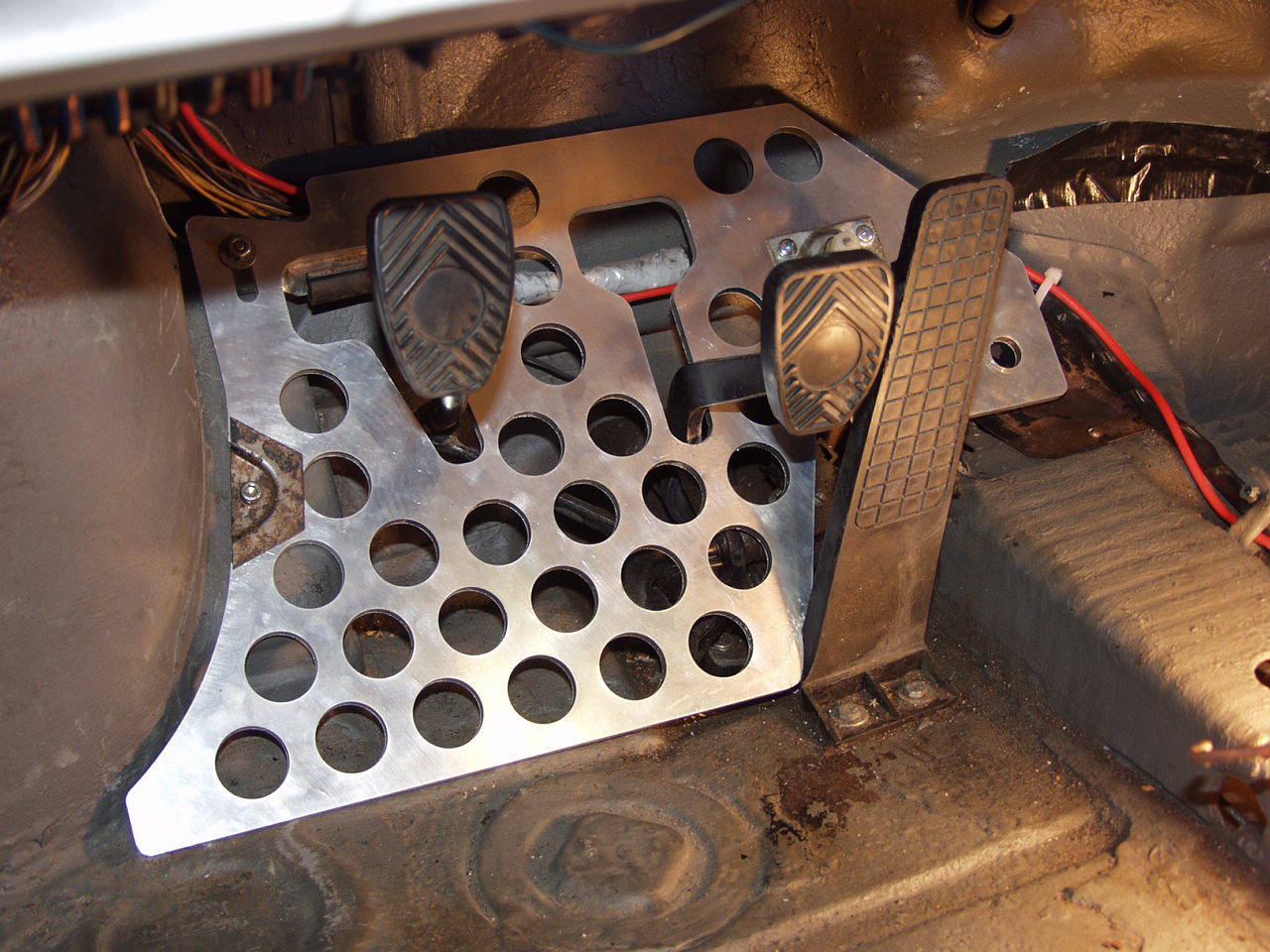

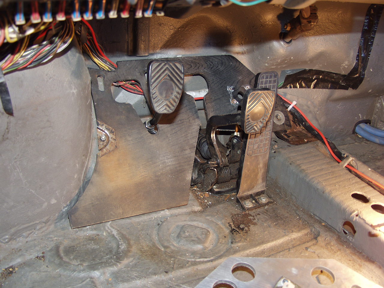

OK, try these.
The board is on and I attach the right hand side mounting screw. The middle of the board is pressing against the bearing tube and the brake pedal and the left hand side is way up in the air.
Now try the other way - attach the left hand mount screw. The board is catching in the middle on the bearing tube and the brake pedal. The right hand mount hole is way up in the air away from the hole on the cover plate. If I try to force the right hand mount in I am bending the board and the brake pedale is depressed over half an inch by the board, and I still can't get it to attach!
The clutch pedal fits fine, but notice that the board is binding the bottom of the gas pedal, even when it is 'almost' in the correct position. I know the board is EXACTLY correct, its almost as if my pedal box is too far towards the back of the car (and I did check to see if it had been relocated).

Whichever side I attach, the board on the other side is about half to 3/4 inch up in the air over the mount hole - its pivoting on the brake pedal and bearing tube (the big bit at the end that the pedal stop is mounted on). Like I said if I 'bend' the board (and that why I said the wooden one was more accomodating since its easier to bend), I can almost get it to touch but by then the brake pedal is depressed around half an inch.
Richard
Remove the screw and mount on the lh side. Board looks to be too far to the right and and too close to the pedal (ie it should fit further behind the pedal) Try to get the position good. Then lets see where the mount screw holes are located. I am wondering if the hole locations are off or if there was somrething else that was moved in the car.

If you look at the first picture I had only the rh screw attached and I couldn't get the lh side anywhere near the mounting hole you can see - I tried to force it in fact and it popped the cover plate off even though it is screwed in! I do wonder if there is something odd about the car. The board would mount perfectly if the pedal cluster wasn't getting in the way!! Thats why I actually checked under the car and at the firewall to see if it appeared to have been moved backwards perhaps. It looks absolutely stock though.
I think the interference with the gas pedal is because the pedal cluster is pushing the board to far back and into that pedal. The board would fit perfectly if I cut away the lower section by the bottom of the brake over to the gas pedal Maybe I'll try to cut the wooden board and try that.
Richard
A few minutes with the saw and I removed that lower section of the board and it now fits straight in. Notice that the bearing tube end is actually in the plain of the board - thats what was interfering and causing all the problems. So is the board mounting too far forward, or is the pedal box to far back?

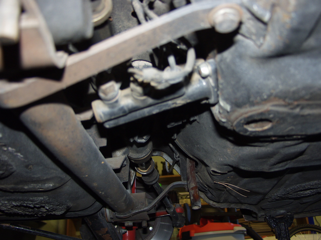

That is F'd up. I wonder how the MC clears the cross bar for the front suspension ??
Shoot a pick with the splash pan off pointing up towards the MC.
[B]
Sorry about the focus...

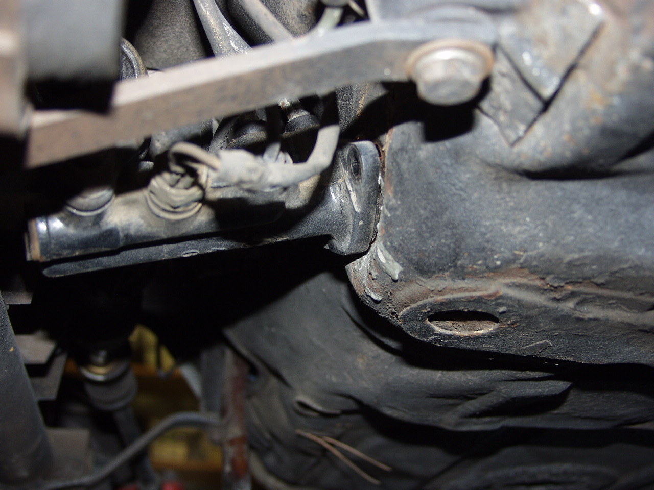

The rod is properly seated?
What is up with that... seems like the whole shooting match is forward..
Please remove that piece of pinestraw, that is one of my pet peaves.
M
I don't like the looks of the master, it seems the lines are not hooked up in the usual fashion.

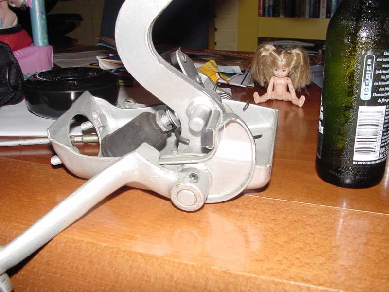

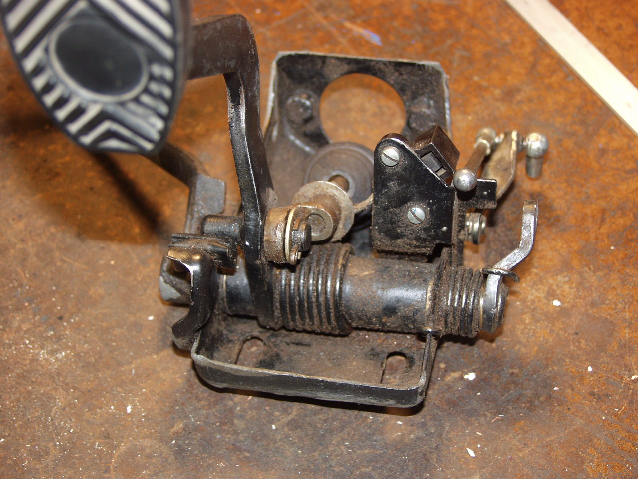

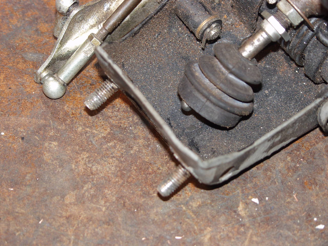

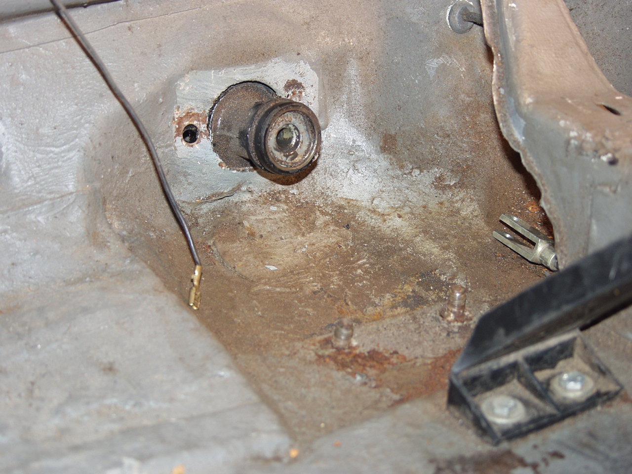

I pulled the cluster and took some pictures. I couldn't see in all the crud and no one mentioned that there is actually nearly 1/2" of possible variation in the position of the pedal cluster. The lower alignment areas (on the studs through the floor) are actually grooves rather than holes. (see the first picture).
In my case the studs were positioned at the very front of the grooves - which puts the pedal about 1/2" further back than they could be - and hence (I think) my problem.
and the reason I think is because of two things.
1) The firewall end of the cluster is distorted. I hope it shows in this picture but the part that touches the firewall is not flat
and (2) it looks like the firewall at this point is actually bent - maybe it had an impact at some point in its life
I hope this shows up...
looks pushed in 1/4 to 1/2" huh?

Yep - its pushed in.... time for .
I am betting that the brakes will feel better as well .
M
I was able to regain about 1/4" or so (as measured where the studs come through the grooves in the bottom of the cluster), which reduced the brake pedal freeplay accordingly. I am still some way from getting the pedal board on.
I need a better drift so I can actually hammer with some leverage. Its almost impossible to get to these places because of the roll hoop which really restricts access. I'll see what I can get hold of tomorrow morning
