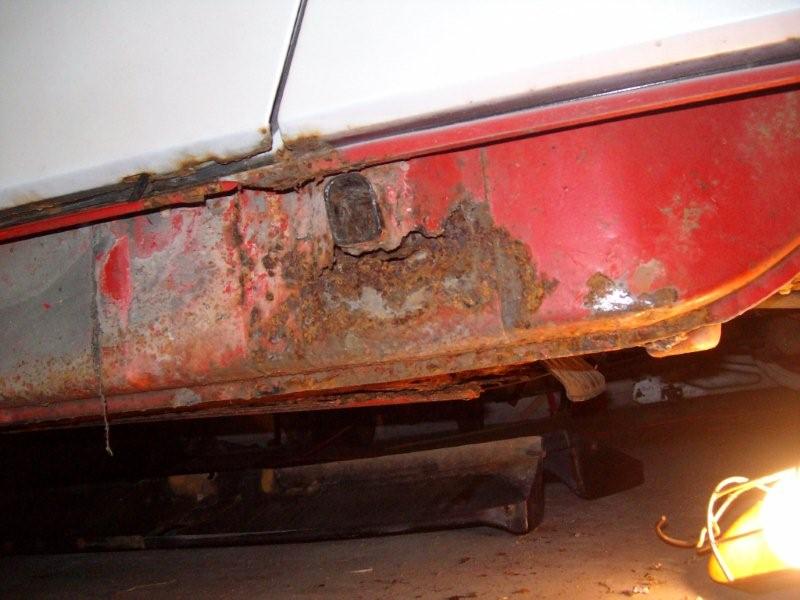

I bought a project car site unseen. It was a gamble, and it is worse than I imagined.

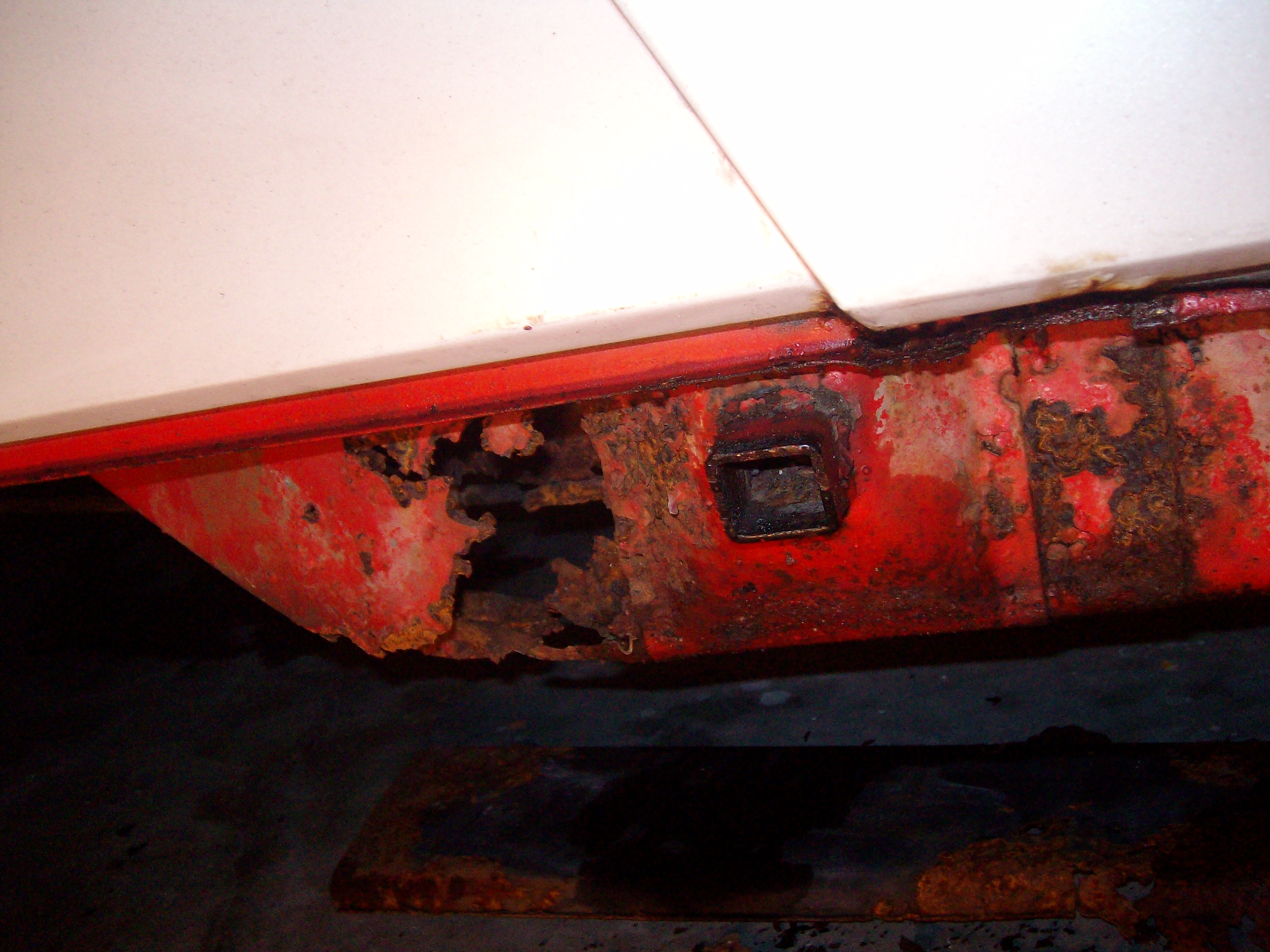

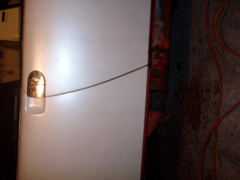

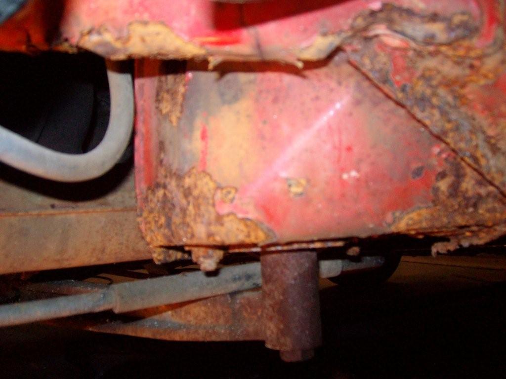

Passenger Long is very bad (photo) Door will still open and shut but gap is very narrow. Rear Floor will also need replace.
Question, would the Brad Mayeur kit alone fix this??

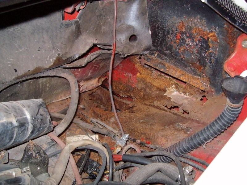

I know I probably need pictures of other areas, but if I am not interested in engine bay cosmetics or autocross stiffness, would I need other reinforcing components in the hell hole area or inner long areas for a daily driver scenario?

First, you have to find out exactly what you have and be prepared for more as you dig into the rusty areas. The long repair by Brad Meyeur is excellent but it does not do it all. You may have to repair/replace sheetmetal and related areas such as the "hell holes". The long themselves may have to be rebuilt before using any stress kits. There are many different stress kits available through our manufacturing suppliers. Pictures are a necessity and the advice you will get here invaluable. In addition, there are many threads available for your review and knowledge base.
The welder you mentioned should be adequate. I personally have a 110 volt Miller 135(?) which I did my entire job including sheetmetal repairs, Brad's long stress kit, other stress kits, floor boards, etc. My car was a California car and it still had a lot of rust including "the Hell Holes".

It looks like the door is closed in the pic, if so; that car is sagging very badly and will probably need much more than you think.

Yes, brads kit will do the structural job, but you need to stop the rust.

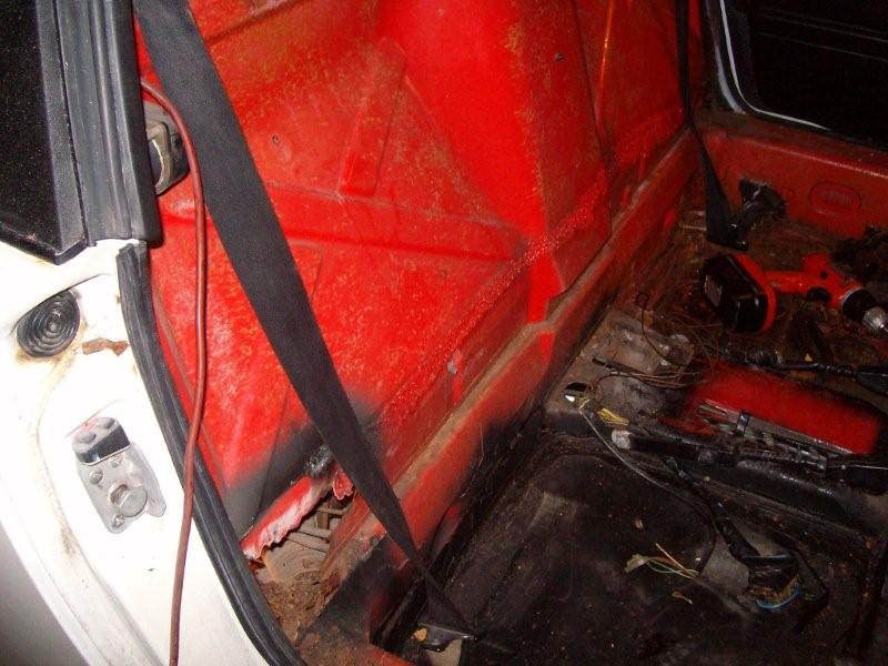

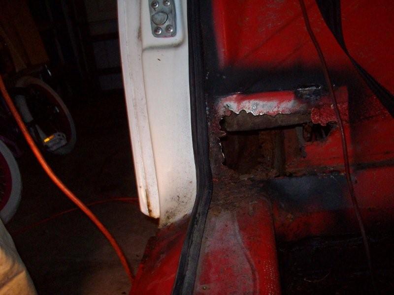

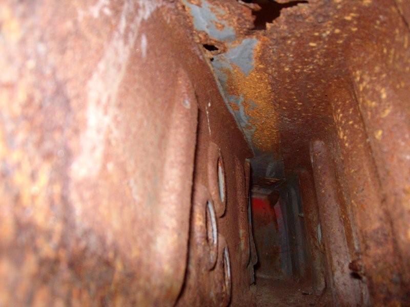

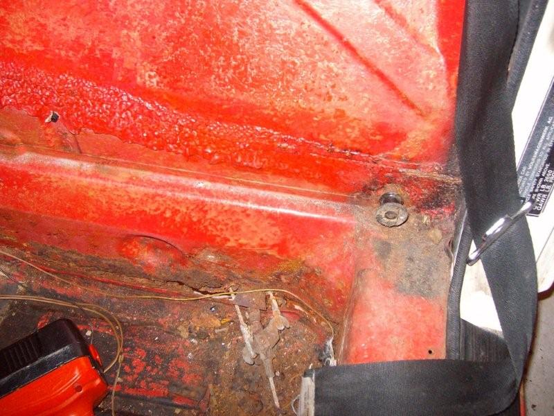

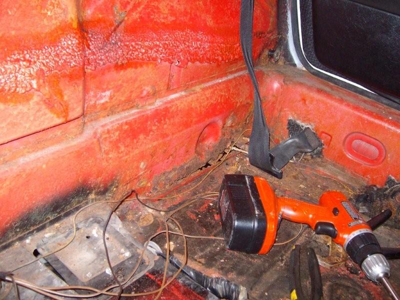

I am going to expose the hell hole, and the floorboard/firewall area.
Hopefully I can post more photos soon.

Wow, the long looks almost exactly like what I got myself into. See my thread at the bottom of this page in my signature. It IS possible to do this with a cheap 120v flux welder, I don't care what anyone says. But its much harder. And even worse if you don't buy the restoration design replacement pieces. It does not necessarily need to be expensive. But if you short cut, it won't look as nice as others. For me, it was a learning process anyway, so I basically brought a car back to life that had no business being restored. It would have been cheaper and easier to find a decent roller, but in Florida that is a lot harder than it sounds. I would say just in metal alone, you're looking at upwards of 500-600 dollars in parts from RD. If you go the long, drawn out and cheaper route like I did, it may be no more than 50 bucks. But keep in mind, every piece that you fabricate requires cutting discs, blades, etc. This adds up quickly. If I had to do it over again I probably would have bought all the metal instead (fitment will always be better as well).
Before you do anything else, make sure to read, read, read the many threads here. It helped me immensely. Also, before cutting into or welding anything, make sure to make yourself a door brace that goes between the B pillar seat belt bolt and door mounting bolts. This will keep the gaps straight so everything fits when done. Good luck!

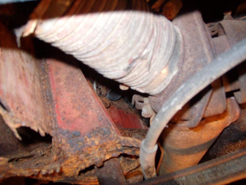

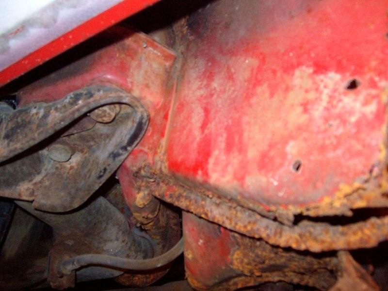

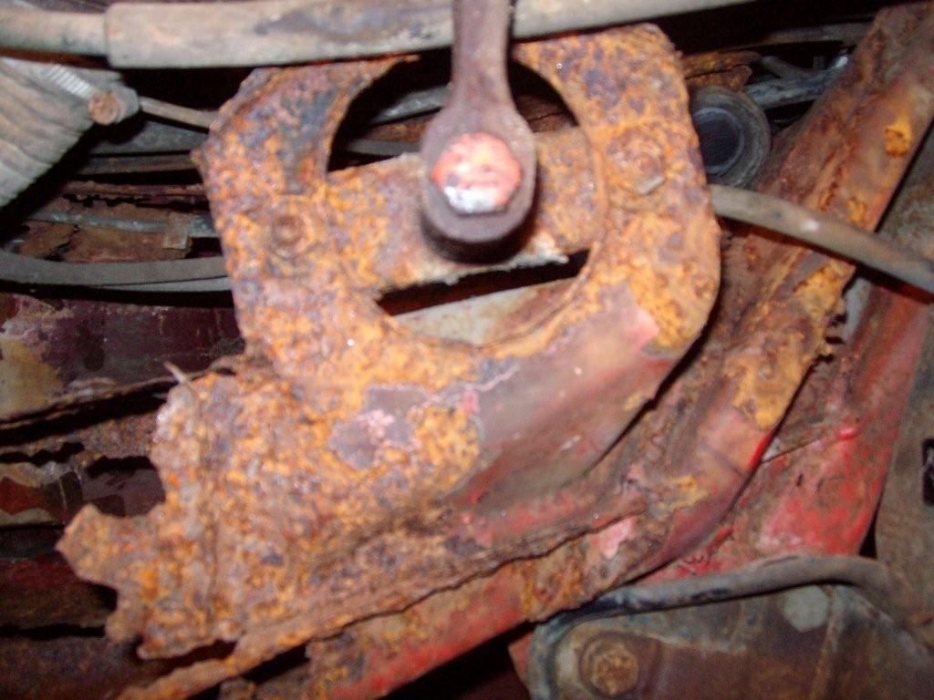

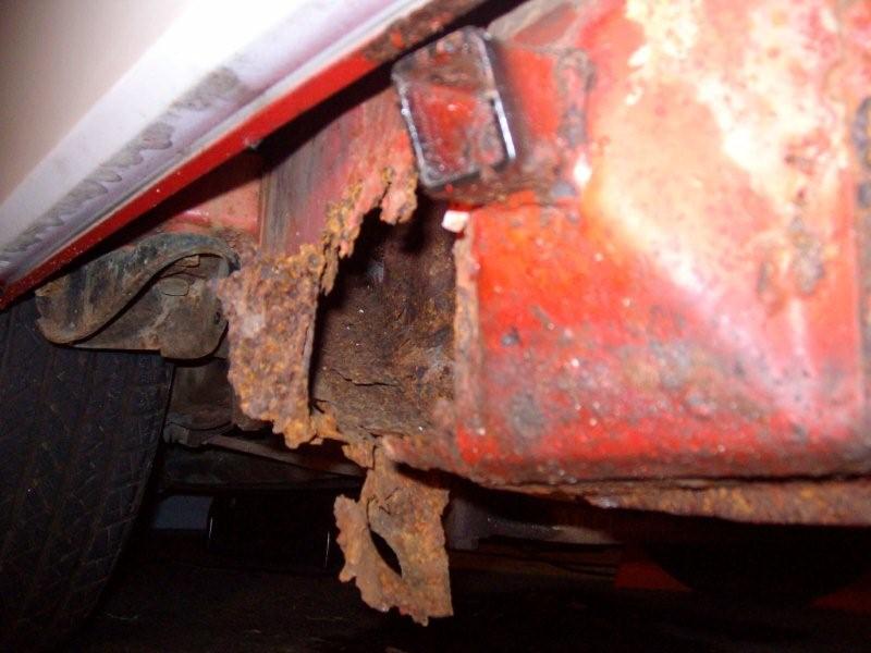

PS suspension ear looks suspect, if there is rust ozzing from the bottom seams of the ear, it likely has a good deal of rust internally, they are made of about three layers of metal, and the water gets in there and the rust is history. Also if you see signs of bulging of the metal, likely that is caused by rust under the outer layer of metal, forcing the bulge out. Hit the bulges with a hammer, and see if it open ups a hole, no bother if it does, you didn't hurt anything cause it was near ready to fail anyway. if either is the case, failure is forth coming and it should too be replaced.

[attachmentid=308

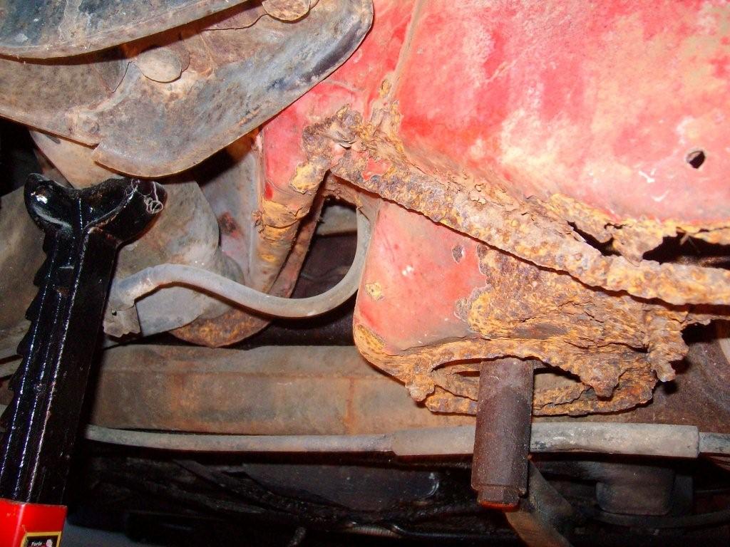

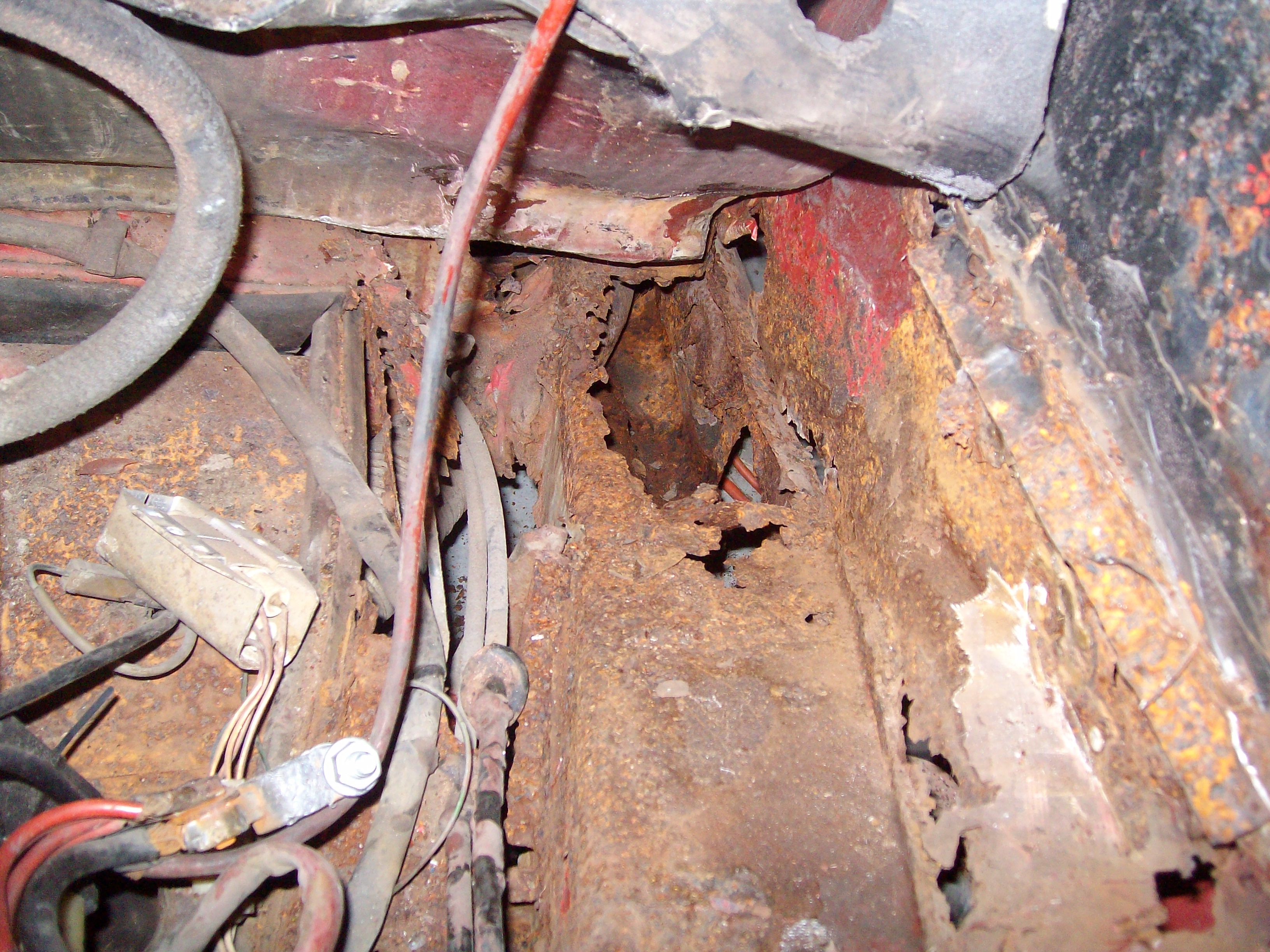

242]Final photos before I decide to try to save this car or part it out.
Surprisingly the suspension console appears to be decent.
The motor mount appears to have a potential future too, if only to serve as a falsework to build on.
I am thinking about a mayeur kit for the outer long.
A resto design inner long (Ouch $$ for a small piece)
A resto design rear floor
An engman kit to tie it all together.
If nothing else I will learn.
I have no illusions about this car ever being a beauty, but if I can get it to be a driver, I will be happy.
Do I do all of my cutting with an angle grinder??
How should I support the car while I work (no floor and bad frame, donuts up front look good.).
The car is fixable...but you have a ton of work ahead of you. If you commit to doing it, be prepared to go all-in on a restoration because you will find yourself priced in at some point buying stuff, making bailing out tough to justify financially. On the bright side, you will know this car inside & out when you are finished!
Like the paintedman said, buy all the replacement panels you can from restoration design...there will be plenty of fabrication to learn from in other areas.
An angle grinder will do a lot of the cutting, but won't allow you to get everywhere you need to. I use a die grinder and a dremmel tool with cutting wheels quite a bit too.

Sorry man, that is a parts car.
There are always nice rollers on SF Bay Craigs List for $2k or under. You will spend way more than $2k fixing all the rust. When the drivers side jack post is rotten, the car is much worse than you can see.

I've welded up several rusty 914s and I can assure you that this car is beyond help. Anything can be saved for a price but common sense tells me this is a parts car. Sorry, Ray
That is a typical northeast car IMHO.
If you want to, it can be fixed...all the pieces you need can be purchased from Restoration Design.
Nothing out of the ordinary from my salty perspective.
Looks like 100 or so hours to get the metal work done.

I'm about a year into my first 914 resto..I, like you, am learning as I go. But every day I count my blessings that the car I have is 'largely' in good shape. It's no way near as bad as the pics of your car suggest. I worry that once you start digging you may just be overwhelmed by what you find.
You will need LOTS of good tools to get it done....and a decent welder! It's more than a learning experience...it will need a lot of $$$$$$!
My honest advice would be to keep it for parts and get yourself a really good tub from California as alot of others are saying. Even though you have the added cost of a new tub straight off, you will be saving yourself a ton long term..
