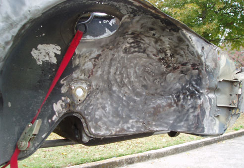

Replace it with metal. I found so much bondo in my car when I started stripping it . I would like to kill the mud master.
Who ever did the work on the car filled the inner fender with bondo and then covered it with undercoat. WTF was that lazy bastard thinking.
