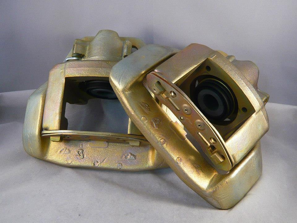

Just wanted to show off our newest build... 944 single piston, floating steel calipers:
This is our first couple of sets. We finished these for Henry at Intermeccanica. Really happy with the way they turned out. I must say, I like the ATE's much better than the Girling version found on various VW Buses etc.

Didn't I read somewhere that these were adaptable for the 914?
Posted by: matthepcat Sep 18 2012, 10:38 PM
I have the 944 turbos on my teener. Requires some machining to work.
Posted by: wingnut86 Sep 18 2012, 10:41 PM
I thought you could buy an adapter rail for the Turbos?

Who the hell wants those turds ?
Probably guys that want to restore or keep their 944 original.
Oddly enough, at 7lbs. 10oz., they're about 2lbs. lighter than those A-Calipers (SC/Carrera) that everyone likes to put on their cars.

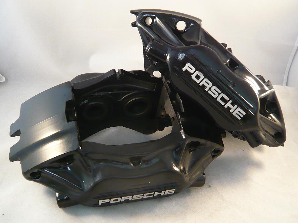

We have a full set here we're experimenting with. The problem with the later Brembo's is... Brembo. They have made the kits unbearable. Each bore seal is $25.00. Each dust boot/wiper seal is $32.00. Now x8 ($456) or x16 ($962) and you've just covered the "rubber" bits for your restoration.
To refinish them properly requires fully stripping them, de-anodizing them, re-anodizing them in black, assembling them, clear coating in high temp clear and then re-machining the PORSCHE logo. There's another $400 per pair to get them like factory new.
Who's ready to pony up $849.00 per pair for these dime-a-dozen calipers? This is why I currently call them "throw-a-way" calipers.
The spring plates in the pad cavity are also a problem. Almost all of the fasteners need to be machined out. Small fastener in steel into an aluminum body.
Again, we're experimenting with some low cost finish alternatives. It's admittedly a back burner project.

My cousin gave me a pair of these, and I was never able to determine exactly what they came from until seeing this picture. I have M calipers for the front. Would these be something worth considering for the rear? I have't yet decided if I will keep my car narrow or install flares (but I am leaning toward flares).
