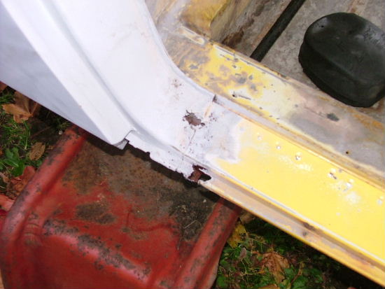

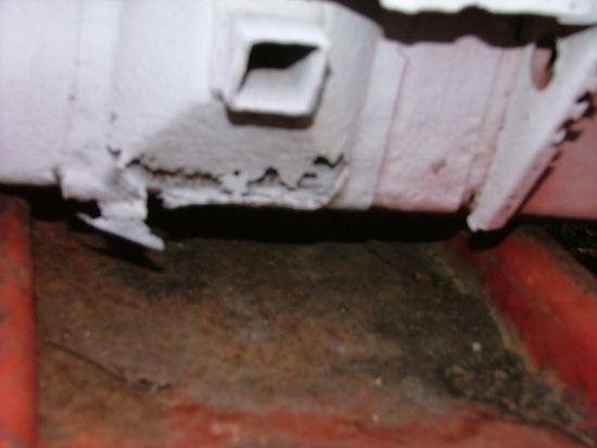

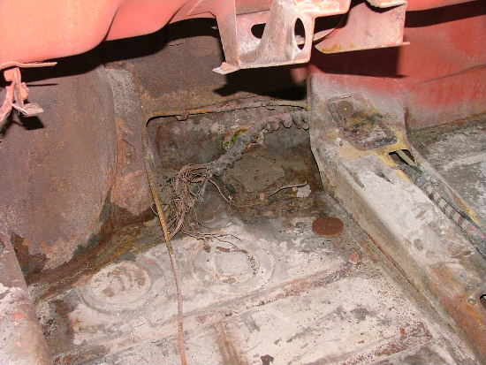

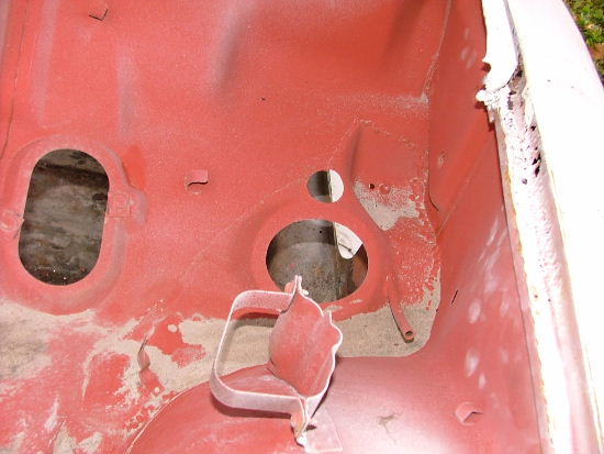

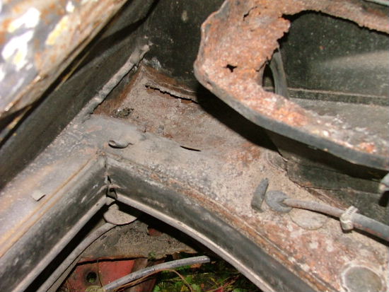

what are you talking about? the longitudes are in very good shape! the floor is only surface rusted!(and that is where it has no paint only!) it needs the jack posts repaired, they are strong enought to use still, just the lower plate was rusted, the car has less rust on it than the one that Rob ways is selling!, i will take a new set of pictures, the problem is that i only took shots of where there was any rust, i did not take any of where there wasn't ....whatever. as far as 2 chassis weled together, i thought that too. but here is the deal, show me the seam, you can't. it has had the dash and cowl clip replaced. this is the crap i get for trying to save a 6.....whatever

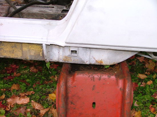

here is the right jack point
here is the sill directly above it

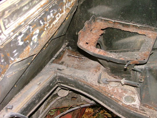

here is the battery area
another of the hell hole

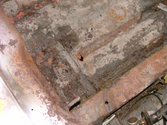

here is the driver side inner rail...i can't see any bad rust
the firewall rust....most every northeast 914 has this from a loose window

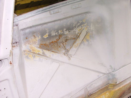

here is the only spot on the floor with any rust, it is about the size of a quarter....this is not even in a place they rot, so this is easy to get a panel from another junker
this is the driver footwell, it is surface rustee, thuis is because it was never repainted....no holes and it is not thin....the car was not left out in the mud or anything. it was stored inside till i got it

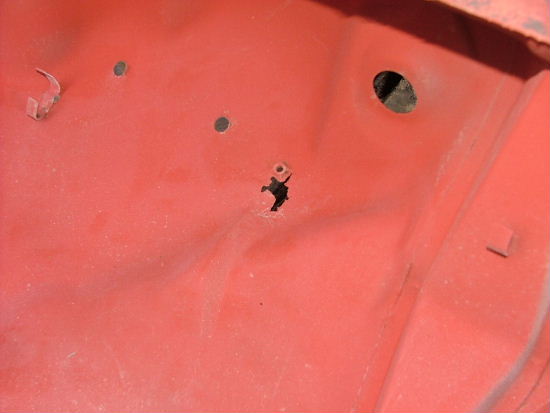

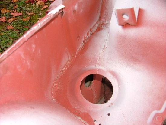

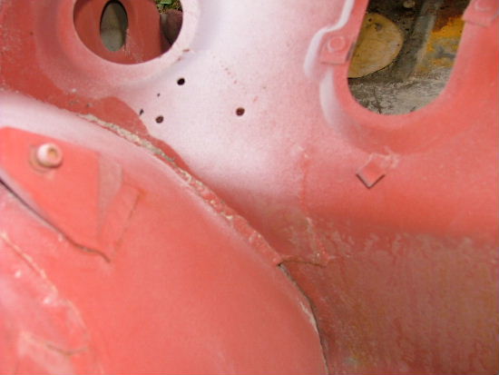

look carefully at the welding seams in the next few pictures, they clearly show the sectioned in part of the cowl/post clip.(there is a little hole in this clip....it is not rust, it was drilled.....poorly
another closer
the hole
another of the seam

as for the front clip, you'll always be able to tell if the whole clip was replaced, especially since the tub is stripped.
another easy to spot clue, on a original /6, the wall between the front trunk and the gas tank did *NOT* have a hole for the washer hose in the lower left corner!

I don't know what he's complaining about. Looks damn decent for 1K. Where did he get the idea that it would cost another 4K to fix? He should buy a welder, some sheet metal, some stiffeners and go to town on it. Shouldn't cost more than 3k to make it real tight.
I saw the pictures in an email David sent me, and suggested the chassis might be welded from two because the front was red and the rear yellow. It could be that ALL the yellow was stripped off the front and that is red oxide primer. In any case, it appears the problems are more extensive than Nick is suggesting from my limited perspective.
The jack post with the holes is heavily sand blasted, but it still appears that the surrounding metal is heavily corroded and the long. has a hole at the lower front edge of the jack post.
There is a sizable area of rust perf in the channel where the front trunk seal goes, along the inner edge of the fender. There is no right front fender.
It is always worse than it looks in low res pictures.
It is worth restoring, but to pay a professional to fix all the problems nicely would take at least 3K. The entire chassis needs to be stripped and repainted after the metal repair. There's another $2K or more. William Harris can tell us the cost of that since he is in the middle of it right now.
