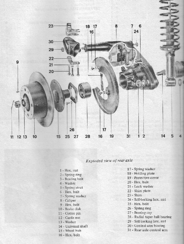

My right rear bearing is making noises. I called my mechanic and he said to get parts and he would install it.
I am looking at the exploded view of rear axle. (See below)
When I order parts, do I just need the Bearing #28?
Is there a race for the control arm because I don't see one?
Does he need to remove CV axle and tap out the bearing from the inside?
Thank you in advance for your help.
Posted by: Travis Neff Nov 14 2012, 01:13 PM
You just need the bearing, its a sealed unit so the bearing and races are all one part
