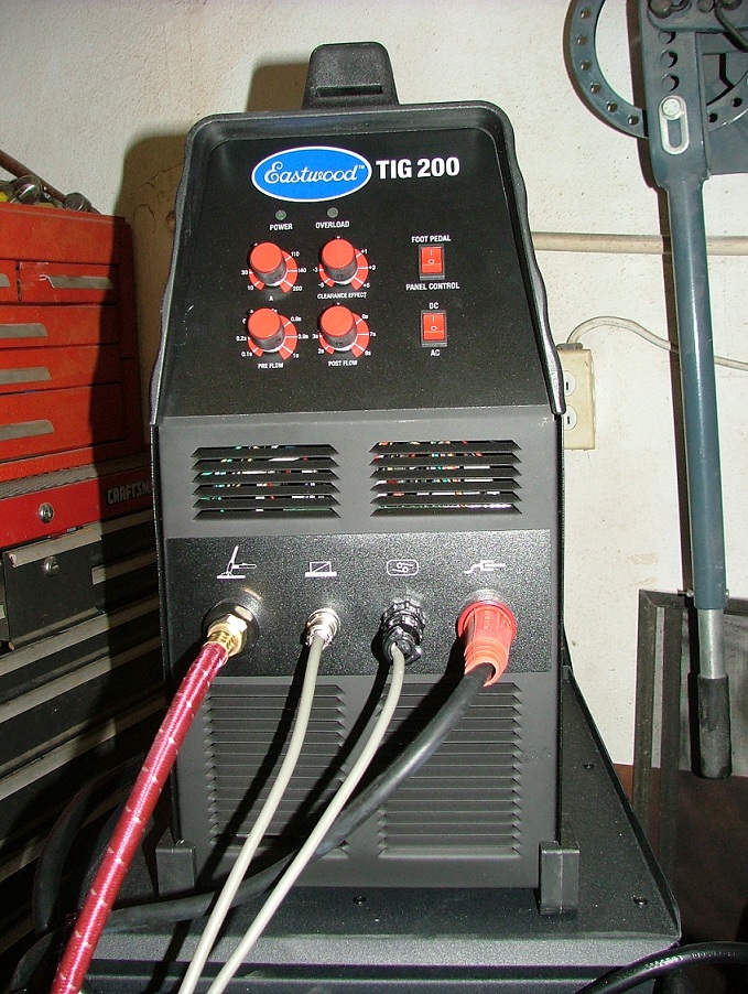

I am using the foot pedal to start and control the heat.
It has a knob on the pedal which is supposed to set the maximum amps with the pedal fully depressed. It does seem to make a big difference what I set it to.
You can see the unit does a high frequency start with a long thin arc and humming sound before the main arc comes on. I try to never touch the electrode to the metal but that seems to be my downfall right now.

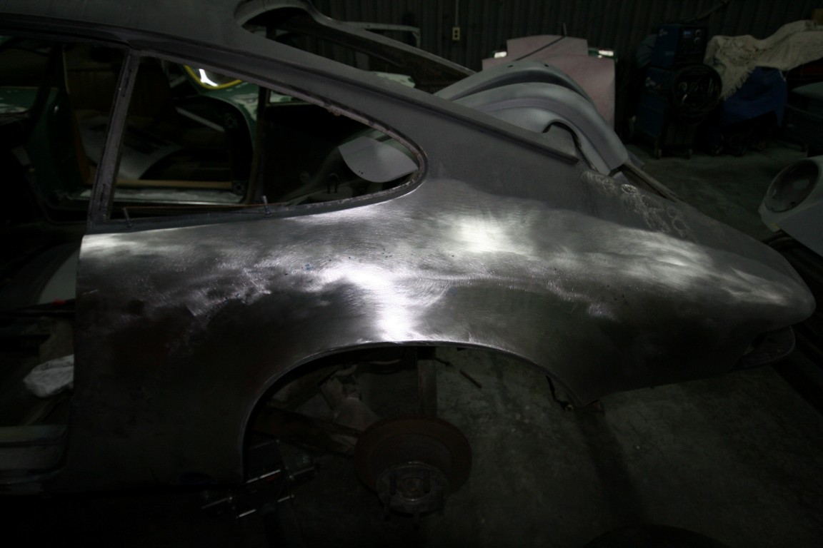

I'm tigging 1/4 on a 911 right now. this is the fitup. Forget about the stack of dimes on sheet metal. You'll need to get good at fusion for 20 gauge stuff. I also buy .035 tig wire. You may have to order it as it is not a big seller, but it is a lot better than trying to strighten mig wire like I used to do
also starrt out with some scrap working on your puddle, then try fusing. Once you can fuse the two pieces together without filler, then start diping the rod.
diping the rod

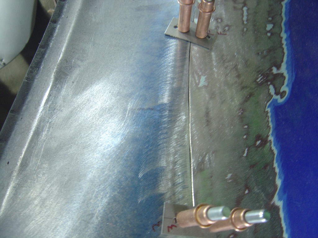

So really tight fit up is important, which makes sense.
Do you start the puddle on one side then move across the joint to fuse the sides together or do you start in the middle of the joint?
When I try to start in the middle of the joint, all I end up with is a hole.

I am pretty sure the eastwood ac/dc tig varies the amperage as you press down more or less on the pedal. I can back off the amps slowly at the end of a weld. The trigger that is on the torch is an on/off switch though.

I have the Eastwood 200 AC/DC Tig also. Great welder. I don't use the foot peddle much. The Eastwood unit comes with an optional little on/off thumb switch. I set the welder up with test pieces first. I have to use 350 power cheater glasses as it is hard to see the puddle. Like most my eyes are getting older than I feel I am. Sux
