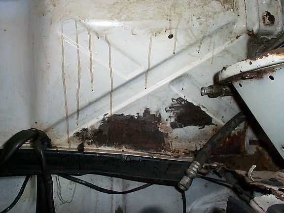

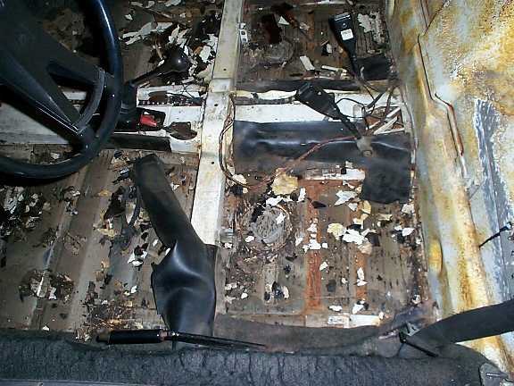

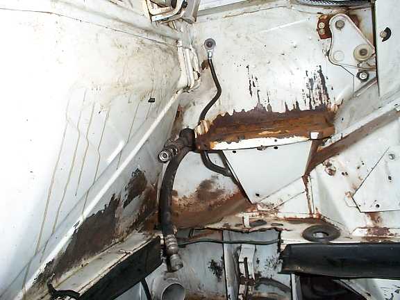

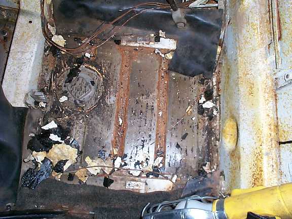

I am going to strip the tub as far as I can windows, trim, gas tank and ventilation. I am going to weld in a front trunk floor due to the A/C cutout, fill all the holes for the A/C hoses, fill side markers and antenna, patch 2 spots on the firewall, new engine shelf or patch the A/C cut. Grind down any surface rust and treat it. Put some 911 mirrors on it, flare out the rear fenders for 16x7 wheels. left rear corner of the front hood is bent from me dropping it, rear trunk lid and engine lid is being replaced since being trailered backwards and the trunk lid flew open (bad upper trunk pin) and bent up what I had. Do some chassis reinforcement (engman kit and whatever parts are needed from the rear chassis stiffy kit, brace trailing arms, reinforce pedal box- anyone have pics or instructions on that one?)
The car has been repainted one time and the paint is chipping off, actually I stripped 1/2 the car with a razor blade in about 3 hours down to the filler/primer coat (car paint shouldn't come off like that, no?). I can take it down to bare metal if required - depends on whatever painter I use wants me to do.
I would like a nice paint job, not a maaco job finish. I am gonna drive the car, not garage queen it. Hell I'd love to take it down to just the tub and paint everything - but again this is where I am asking for ideas on roundabout labor to see what is realistic. I would try painting the wheelwells and engine compartment, maybe even the trunks myself if there is tons of labor in just the outer paint. I would even try my hand at color sanding, if there is enough coats of paint for an amature to try. Just in parts alone I am at about 4-5grand right now, seals, bumper tops, used parts, new metal, lights, windshield, 5 lug conversion etc.

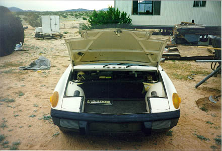

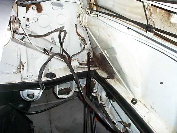

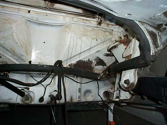

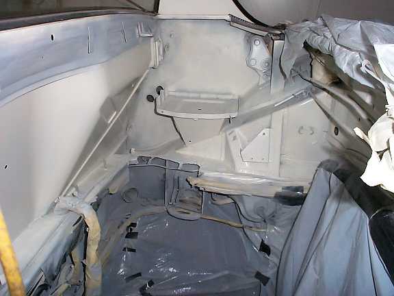

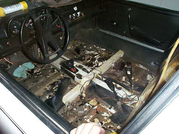

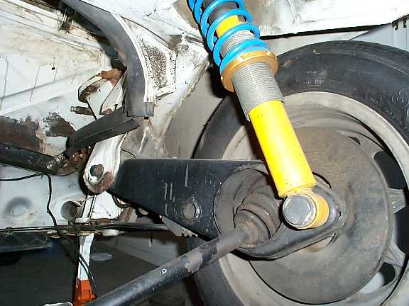

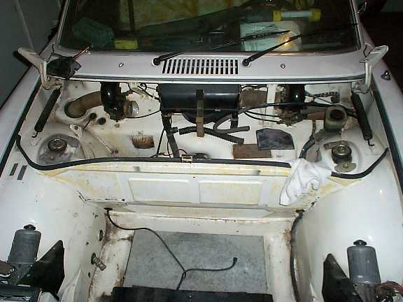

I'll dig up a few pics of the car to show what condition it looks like now to better illustrate where I am at.

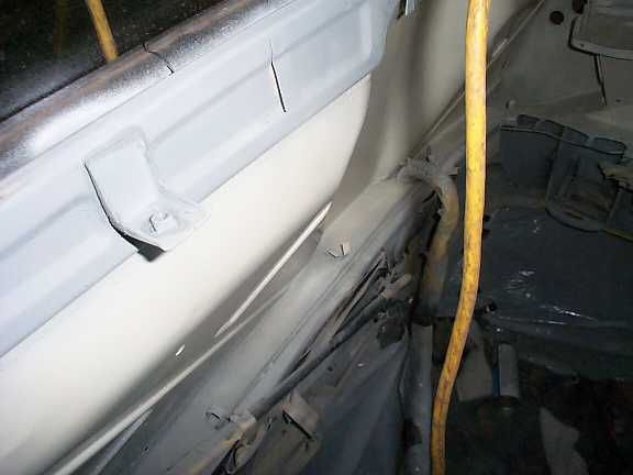

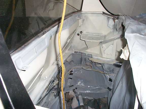

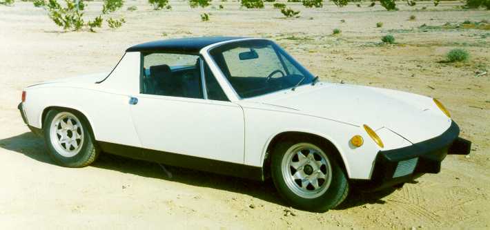

pics when I bought the car
