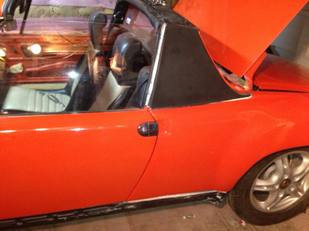

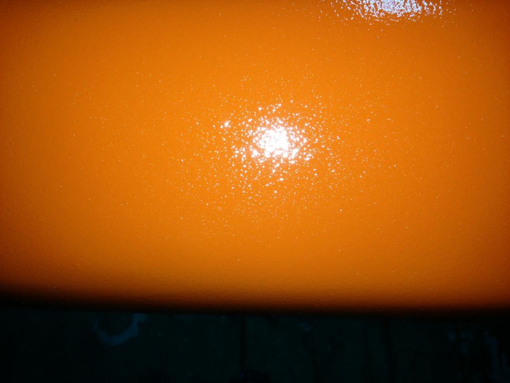

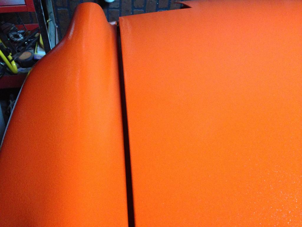

Can you put a florescent above and take another shot showing the light? Hard to see the finish in that. I can see it a bit in the first pic on the bottom right.
If the base went on nice and it was just the clear that was bad then I suspect you wont have any problems after the cut and buff.
that Is orange peel. Wet sand it. If you want to be ballsy, start with 600, then 1000, then 1500. At that point you CAN buff it, but it will take more effort. Idelaly you should go to 2500 or 3000.
If you want to play it safer, start with the 1500.
If you do start with 600, just use that to knock the height down a bit, don't try anf get it perfectly flat with the 600. Wait until the 1500 to get it flattened down

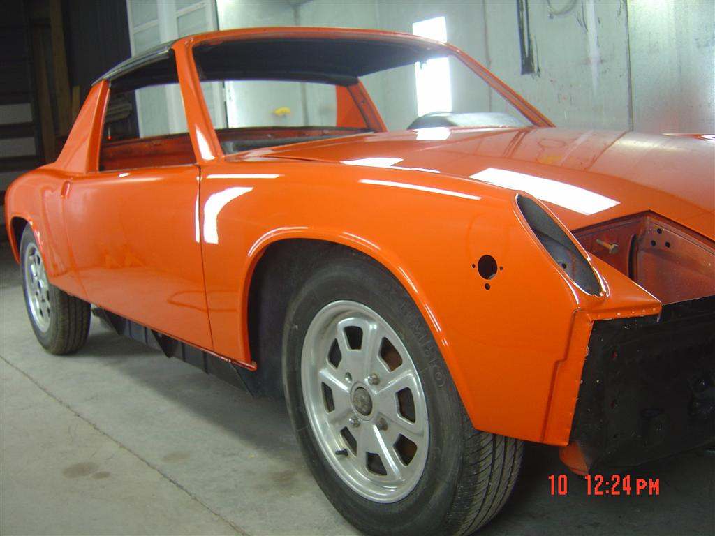

Scotty, What color code was this? you posted this on my previous painting thread.

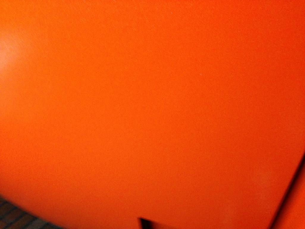

This is what my color looks like now.
looks like it has a little grey on it

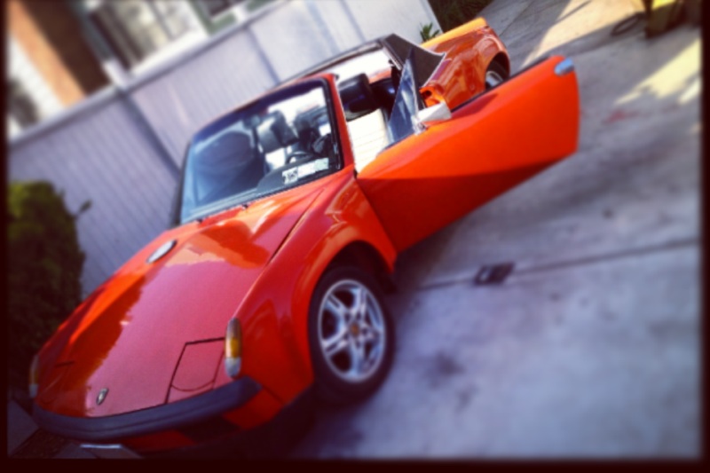

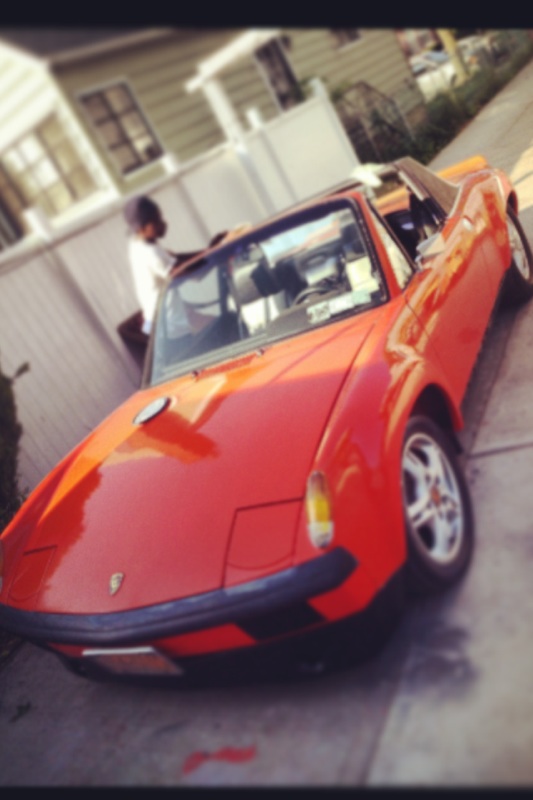

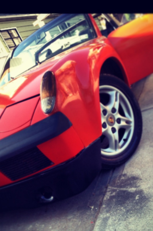

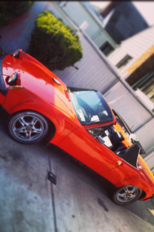

Final product.
Way to go Paul! You did it right by repainting it, and I wager you learned a lot more by doing it several times in a row... unlike myself where I only paint cars sporadically. I'm very impressed - your car looks great.
Did you get any compound on the rubber when cutting/buffing? This is something I still have yet to figure out - I don't know of a good way to get buffing compound "sling" out of rubber without messing up the rubber itself.
Thanks, a bit of patience, and yes I learned a lot , my messing up was a combination air pressure , gun settings and temp. I learned the hard way, but the end results is satisfactory.
All rubber was off with the exception of the front Wimshield. I worked slowly around it.
iPhone and glare from the hot sun today.
Scotty we should meet at that bugger place in brooklyn for lunch sometimes this weekend.
That really looks good Paul. Is your son receiving fair compensation? No wonder you don't hesitate to sand.
Looks great!
Paul:
Must have been frustrating as hell going through it, but your car looks awesome!
Good work!
