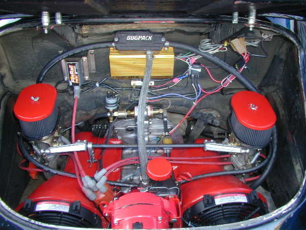

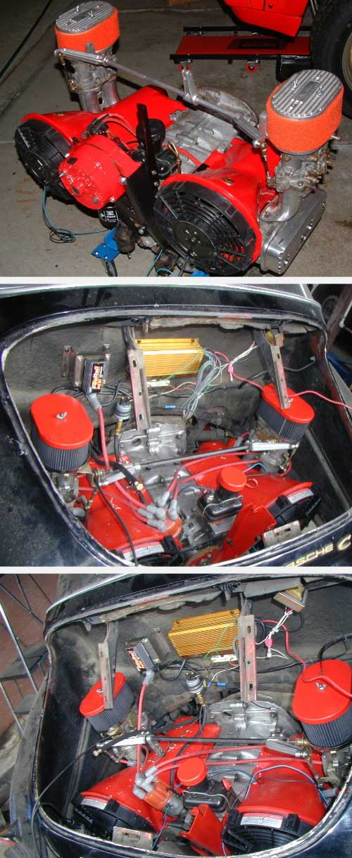

here is one electric setup I have seen.
don't think it worked too well.
more found...
I have also seen a rig with one big electric fan on top of a fg shroud. I don't think any cool as well or as evenly as the Jake's DTM.

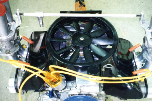

An electric system could work just fine. Wayne Baker's car ran three of the fans used on the 911 to cool the thermal reactors after shut down and did fine with that system. Rumor has that the Horizontal electric causes number 3 or 1 to run hot. A fellow that was running one said he had to reshape the shroud to fix the problem. That is the only fellow I have seen running one though.

It uses the same fan as the vertical 911 unit and no directional vanes or deflectors, so I don't see it being much of an improvement over the normal 911 style...

The 911 system is different because it uses an AXIAL FAN which has alot of volume and less pressure. The holes being drilled in the shroud created a lower pressure area over the cylinders nearest the holes and the air did its best to take the path of least resistance and found its way to those parts of the shroud and cylinders. This is also impacted by the design of the under cylinder tins which we found on a TIV to create issues when using upright cooling.
The 911 system not having any vanes or deflectors benefitted from these holes being drilled, because without them all the air blows straight back on #3 and #1 and nothing to the cylinders below and underneath the fan- #2 and #4... The 911 engine does not have this issue because the fan is far enough away from the cylinders that the air does not have to bend 90 degrees to find its way there to do its job...
