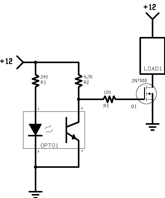

okay you EE types out there.....
want to check out this circuit?
There will be 2 opto's each with a "Load1" going to Pin 21 and Pin 22 of the ECU to trigger the injectors.......
The opto isn't useful in that circuit. It's not isolating Q1 from anything coming down the left-hand +12.
I assume the left-hand +12 is some sort of switch signal you expect to be nasty, and the upper +12 is constant power. If so, then run the collector of the opto's transistor to the constant +12 up top. Be sure the opto's ground is run back to the ground shared by the nasty signal generator, whatever that is. The idea behind an opto is you have a clean power source and a nasty switching signal. The signal goes on the LED side, and the clean power source on the transistor side. The signal switches the clean power on and off, so you get clean power "out", to the thing you're isolating. As drawn, you'll get the left-hand +12 running straight to Q1, using whatever ground potential exists between Q1 and the switch signal. The opto might as well not be there at all.
What's to the left of this circuit?
this circuit was posted on an electronics forum....I asked a question and this is what was replied...totally clueless whether it would work or not
Left hand +12 is from the vehicle power source (ignition activated to turn on)
Here is the typed response along with the circuit:

Hi, I put a circuit with this to perform your function. Any interrupter optocoupler or combination of IRLED and phototransistor will work for the detector. Also, about any N channel hexfet (or power mosfet) will sub for the 2N700. If you get the interrupter, it should be marked E +/- and D +/-. That's Emitter and Detector with polarity marked. For reliable operation, the IRLED needs to run at about 50 mills. It doesn't matter to the IRLED, but the phototransistor has to have lots of photons to go into conduction. If the collector of the phototransistor doesn't pull low enough, increase the value of R2. In operation, the phototransistor will be on with the base illuminated. The collector voltage will be close to ground, keeping the hexfet off (no current through the load). When the illumination is interrupted, the phototransistor will turn off. The collector voltage will rise to +12, and the hexfet will conduct, allowing current through the load. |
OK, I understand the explanation, but not the circuit, still. If both +12 inputs are constant power, then where does the "interruption" come from? If this isn't an optocoupler (aka optoisolator), but an optical sensor with a shutter between the LED and the transistor, then it all makes sense.
The OPTO1 would be either a reflective or transmissive optical switch or interrupter module. These are an LED and phototransistor pair in a plastic case, and the light beam is either interrupted with a slotted disk or similar device on the rotating shaft, or small reflectors on the rotating shaft bounce the light beam from the LED into the phototransistor. It wouldn't make sense to use an optoisolator, these are used to couple signals between two electrical circuits with different ground references.
The circuit would work, whoever posted is just saying that other power N-channel FETs would work, it doesn't have to be that exact one. The LED needs to have 50 mA current but the spec sheet for the part would tell you how much current. You pick a resistor value to give you the right current in the transistor. Use the biggest value to allow the FET to turn off and to keep the power dissipation down. The spec sheet will call out the optimum phototransistor current. Here's a http://rocky.digikey.com/WebLib/Fairchild/Web%20Data/H22A4,H22A5,H22A6.pdf for an example optical switch.
Just tested the circuit on my workbench...it works with the following components:
http://www.fairchildsemi.com/ds/H2/H21A1.pdf#search='h21a1%20sensor'
and
http://www.semelab.co.uk/pdf/fet/2N6661.pdf
only reason I used these is that we happened to have these sitting in a draw...we used to stock more, but we sold off most of the small components since we don't buildup PCBs anymore....time to do some more research and start ordering parts....
I need to add:
the circuit works as is, I have NO idea if it'll trigger the ECU and ground pins 22 and 23 as needed....
