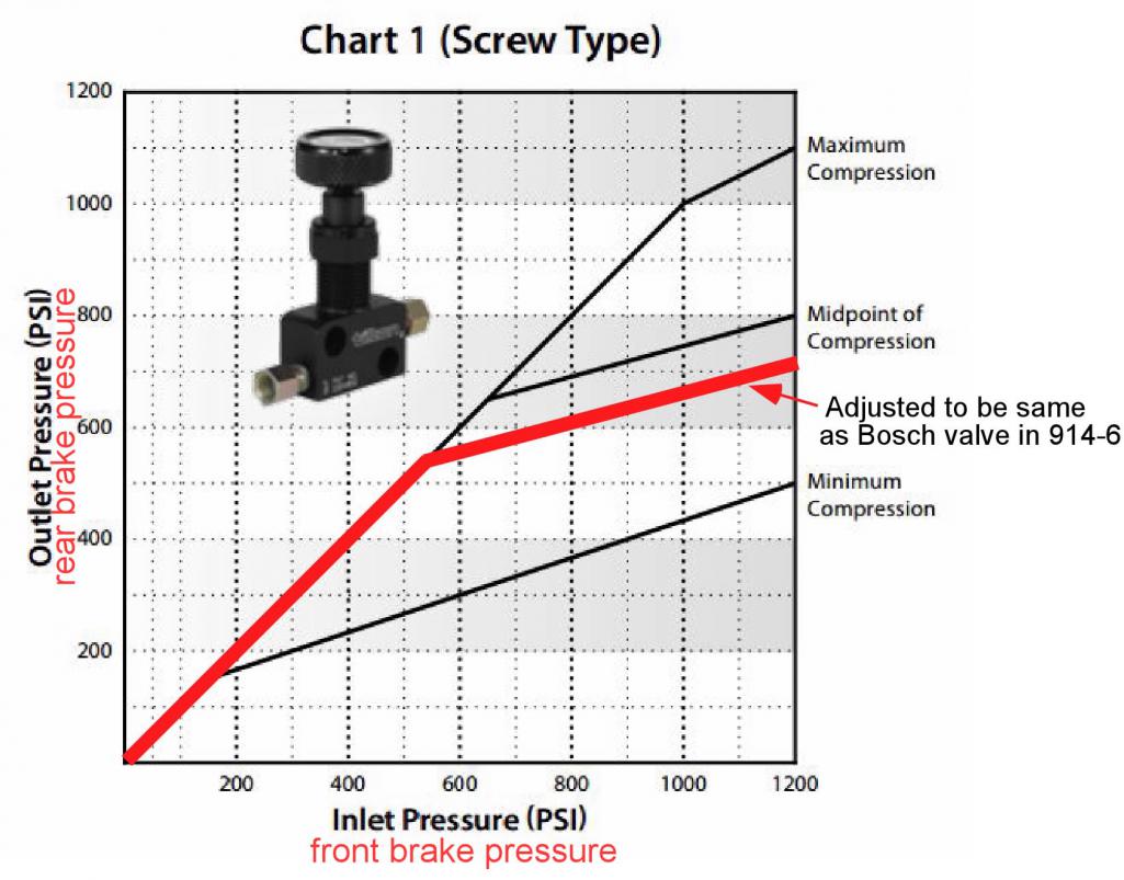

Posted by: DamonsCarrera Dec 22 2013, 01:13 PM
I've decided for now to replace the factory pressure regulator with one made by Tilton. Suitable adjustment will give me the same characteristic (see attachment) as the Bosch unit (which can be seen in a previous attachment). Additionally I can adjust the Tilton valve all the way open when I want to bleed the brakes (this would be possible with every adjustable prop valve out there).
I'm choosing the Tilton valve because they provide alot of technical data which lets me choose a characteristic similar to the Bosch valve, at least to start with, and it's available with metric brake line sizes so I don't have to use adapters.
Attached File  Tilton_98_1261_Brake_Proportioning_Valve.pdf ( 410.95k ) Number of downloads: 637

Posted by: DamonsCarrera Jan 24 2014, 09:39 PM
Well, in case anybody is following this thread ...
I added a T-fitting with a bleed valve right next to the tee fitting that splits the brakes to right and left rear. This second T-fitting is at the highest point in the brake system after the line from the master cylinder comes out of the back of the car, and it is at the same height as the T-fitting that comes out of the top of the original proportioning valve, which I had removed as noted in a previous post.
To recap, after removing that valve and replacing it with just a T-fitting, the brake pedal was a lot less spongy. I thought I might have solved the spongy pedal problem but I was bothered by the idea of air possibly being stuck at that high point at the firewall before the lines go right and left to each brake caliper.
So I put this second T-fitting with a bleeder valve at that high point. After bleeding the brakes the normal way, using only the bleeders on the calipers, I found as before that the pedal felt pretty good. But then I opened the new bleed valve on the firewall, and got several inches of air in the fluid line before getting solid fluid. So air was indeed getting trapped there.
After bleeding that air out, the brake pedal now feels excellent and solid.
Then I plumbed in the new Tilton valve so I have some brake proportioning. I made a temporary bracket out of sheet metal to keep things in place while I design a nice aluminum bracket to hold the valve and the T-fittings for the long term. Rebleeding as before retained the excellent pedal feel.
So the car is back up and running, with great-feeling brakes. Next is to figure out what's wrong with my original Bosch valve and why it wouldn't bleed.
It's clear at least that air gets trapped on the output side of that valve. Some people suggest cracking the lines at the output as a way of bleeding out that air, but that's not easy to do if my stock-configured car is any indication. It's very difficult to get a wrench on these fittings with the Bosch valve installed, hard to open and then close them in a timely manner like you can with a bleed valve that you have great access to. Cracking those lines would certainly get brake fluid all over the paint on the firewall, which I want to avoid on my freshly-painted car.

Yes, true. I set the valve according to the charts I got from Tilton and the diagram in the factory repair manual showing the Bosch valve characteristic. I tried to get it close based on those data. As soon as the weather warms up I'll go out and find an empty parking lot at night and make sure that it works as expected. I can reach the valve from outside the car so I can make any small adjustment that's needed.

I used the Tilton 90-2003. You can see it here
http://tiltonracing.com/product/screw-type-proportioning-valve/
and you can see the document showing the performance curves in a previous post in this thread.

Posted by: DamonsCarrera Jan 25 2014, 08:03 PM
@ 914 teener
I'm not sure how you mean to use the word linear here. None of these valves makes a linear relationship of output to input pressure. For instance, if we look at the Bosch valve in the following graph (I'll call it Figure 1)
we can see that the output pressure has a kink at the threshold pressure, after which the output pressure increase is reduced for each increment of input pressure. Compare the resulting pressure curve to the linear relationship shown for reference, which just keeps going up at a constant rate after the threshold pressure is reached. So the Bosch valve is NOT linear, and in fact all of these proportioning valves create a non-linear relationship of front-to-rear brake force distribution.
Actually, the engineers (of which I am one, by the way) are entirely concerned about load, since the ability of the tire to generate lateral (cornering) and longitudinal (braking) force is reduced with decreasing load, and load decreases on the rear tires as weight transfers to the front tires under braking. Thus, the ability of the rear tires to generate cornering and braking force is reduced during braking, and that is what can cause a spin to occur. The 914's lower moment of inertia in yaw does complicate matters somewhat, but all cars suffer from the problem of optimum or ideal front-to-rear braking force distribution, not just the 914. That's why most performance-oriented European cars, not just the 914, came with these proportioning valves before the advent of ABS.
The later versions of these proportioning valves came with the Dynamic feature you are talking about, as a way to further optimize the rear brake performance. Let's be clear, the "Dynamic regulator valve" differs from the "Static regulator valve" in that the Dynamic regulator valve changes the threshold pressure as a function of the loading on the tire, while with the Static valve the threshold pressure is constant (unchanging). This Dynamic valve was adopted even on the Fiat 124 that I mentioned, even though it had a high yaw moment of inertia, because the ideal brake force distribution (the pressure you'd like to have going to the rear brakes if you could get exactly what you wanted) changes with load. Note also that the lowly Fiat 124 had the Dynamic valve while the performance-oriented 914 did not! Why would this be? Hint: the 124 had a huge trunk that you could load with heavy stuff, thus changing the load on the rear tires more dramatically....
To see how load affects the need for rear brake pressure, look at Figure 2 ...
and you can see that the rear brakes can take a higher pressure (more braking force) at a higher load (max load) than at a lower load (min load). But the Bosch valve shown in Fig 1 is a Static valve (the threshold pressure does not change). The Bosch valve doesn't know what the load on the tires is, so its curve must necessarily be more of a compromise than if it were a Dynamic valve. Translation: the brake force curve will be closer to the "Min load" line so that the unwitting driver won't get in to trouble in conditions of high load transfer. This results in the compromise of the rear brakes being underutilized most of the time. You find this compromise on nearly all cars built before the advent of ABS. The engineers of that day tried to deal with this issue as best they could by introducing the non-linear force distribution curve with the kink in the curve at the pressure threshold point. The ability also to change from the max load case to the min load case with the Dynamic control feature came along a little later. Relatively few cars were equipped with dynamic regulator valves, mostly just the performance oriented ones. The rest just dialed back the rear brakes way way back. And then, ABS came along and changed everything.
Now look at Figure 3
to see how the Tilton valve can be adjusted to perform the same as the Bosch valve, with the same threshold point. There is, of course, no way to precisely adjust the Tilton valve to hit the desired threshold pressure exactly. I just found the midpoint of the adjustment range of the valve, then turned the adjustment knob a little bit more counter-clockwise. It's not exact but I think it's in the vicinity of being correct. As I said, I'll check it once the weather gets better.
