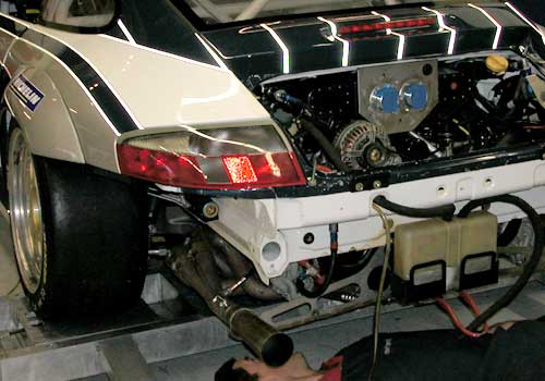

I shot this when I was at Orbit Racing couple years ago. It is their RSR LeMans Car.
I like the way the bracket captures the megaphone from underneath and then the top is held in place with a spring.
Something like this would look awsome on a 914.
I only have 1 muffler with a crappy FLAPS hangar but I'd like to fab something like this.
