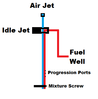

Posted by: jmill Jul 15 2014, 08:28 PM
Theres only a couple of reasons to have fuel leaking out of the progression ports with the engine off.
1- idle jet air vent blocked and you're siphoning fuel from the fuel well.
2 - heated soaked and its boiling up and out.
3- flawed casting. (Seriously doubt it)
Check the vent really well and ensure its clear. Did you install the spacers?

Posted by: jmill Jul 15 2014, 10:26 PM
The float bowl vent (which is a huge slotted hole) and the idle jet vent are two different things.
Idle jet vent is kinda like the AC jet for the idle jet. Air sucked in there mixes with fuel from idle jet and gives you your idle mixture.

Posted by: jmill Jul 16 2014, 08:06 AM
QUOTE(Milkman7286 @ Jul 16 2014, 08:00 AM)
What keeps the fuel from dripping on its own on these carbs? I mean the mixture screw is at the bottom of the carb and the progression ports are fairly low too. Since gas is above these points what stops fuel from leaking just by way of gravity?
The idle circuit takes its fuel from the main fuel well. It then loops up higher than the float level and then comes back down to the progression ports and mixture screw. The idle air jet is at the top of the loop which breaks the siphon and stops the flow. A plugged idle air jet won't break the siphon and fuel will continue to flow until the float bowl is empty. Your idle mixture will also be super rich.
To clean it, remove the idle jet on the offending cylinder and blow from the vent (idle air jet) down. You'll easily see when it's clean. If there's crud, make sure to get it out so it doesn't plug up the idle circuit. You can stick something in there as long as it doesn't booger up the hole. Get that whole circuit super clean.

Posted by: jmill Jul 16 2014, 10:29 AM
There's 3 holes that need to be clear. I made a quick drawing of the idle circuit for you. It's the top air jet you need to make sure isn't blocked.
If it's not that, I'm out of ideas.

Posted by: jmill Jul 17 2014, 12:11 PM
QUOTE(Milkman7286 @ Jul 17 2014, 12:56 PM)
What I'm now wondering is: if the lowest progression hole is open and exposed below the throttle plate, would fuel leak out (with engine off) because the throttle plate isn't covering it?
No. Look at the picture of the idle circuit I provided above. Fuel and air are drawn into the circuit by vacuum. With the engine off you have no vacuum. If the air jet is clear it will break the siphon and the fuel flow stops.
But like George said, you have another issue if your butterflies don't close all the way.
