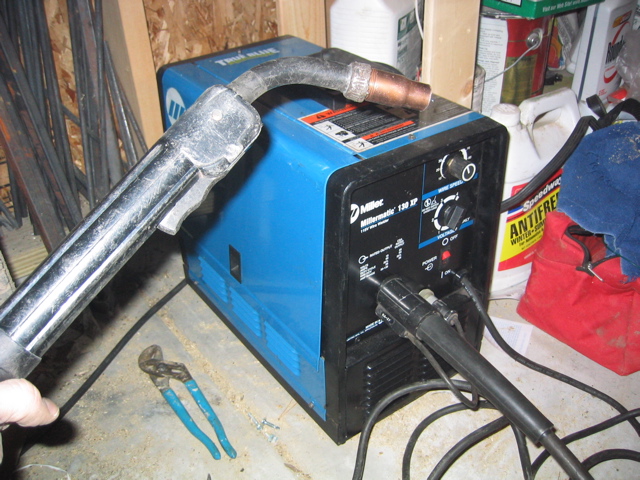

Ok, got a new welder last night that'll let me add a tank. Now the question comes up....how big of a tank?
I don;t want to just walk into the welding supply store and say "Hey, I need a tank!" and have them sell me something I don't need.
I'll be welding new floorpans in the car initially, and I'm sure I'll want to do a BUNCH of practicing first. I don't want to be running out to re-fill this thing every day either.
Anything else I should look for?
80 cubic feet oughta do just fine.
I'll have to look when I get home, but the tank I have is about 36" tall and 6" in diameter, and a full tank of the argon/co2 mixture lasted me about 7 lbs. of welding wire (about 3-1/2 rolls). The tank is relatively small and easy to handle, and doesn't take up too much space. I cut up an old shopping cart for a welding cart, works nice...
I have a 125gal tank on mine and it will last me a few months unless I am doing a BIG project, like welding a set of stairs (I think I went through 2 125 tanks in a two week period) Anyway, the tank cost me ~150 bucks and I pay ~25 bucks to refill it...not to bad...
happy welding ...
Most all welding shops require that you have an account with them for bottles over 90 cf. I would go with that size to minimize trips to the shop, and it is actually a little cheaper in the long run than going with a smaller bottle. PLEASE only use .023 on body panels, I have seen to many people ruin a panels trying to use .030-.035. Good luck

So the HF deal isn't so great. The welder has a REAL small hose out of the back that NOBODY could find a fitting for. So back it went. I was searching pawn shops for welders that went unclaimed when one of the local dealers that I trust gave me a great idea....Call repair places to see what hasn't been picked up.
I called a guy in Akron (Welding Diversified) and he got me the DEAL OF THE CENTURY. I picked up a Miller 130MX with a reg for $325. Needed a new circuit board, and the kid never came back to pick it up. It has a 20ft wand on it, and he threw in a large spool of .23, 5 tips, and a mess of replacement parts for the wand in case they went bad. That would have been enough, but when I went to pay for it he stopped me and said "You aren't allowed to buy it yet...We're going to weld together first."
He spent the next 2hrs with me giving me all kinds of instruction on welding, maintinance, and 'best practices'. We did about a small spool worth of tacks, spots, plugs, butts and anything else he could think to show me. I'd have paid $300 just for that! To say that I feel WAY more confident is an understatement. I'm still going to practice a lot more, but I'm SO excited to jump back into the garage and do my floors now.

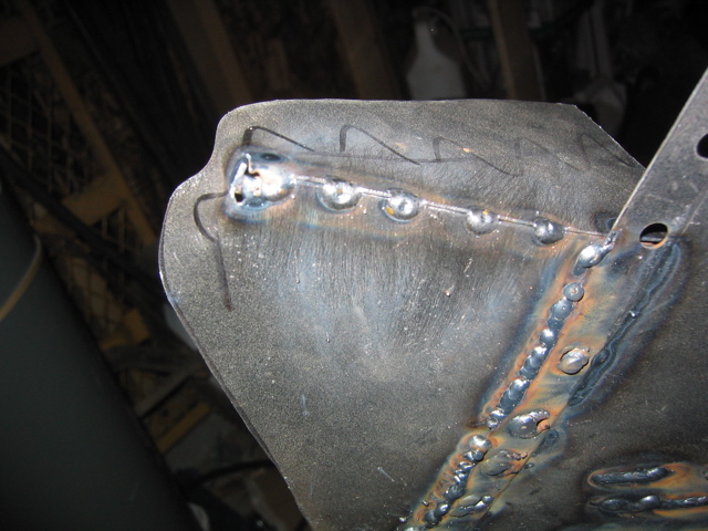

Here's what getting rid of the Flux-Core stuff can do...
Along with a lesson...
(Not perfect, but WAY better!)

DOUG!!! Those look alot better! You could probably turn down the wire speed or turn up the heat just a touch. Once you get to meltn' stuff on the car though you'll probably go with a slower wire speed. Sounds like you got some good training that will make the learning curve a little faster. After you cut some of the metal off the car, practice welding new metal to that. Make some notes regarding your wire speed and heat settings. You'll probably find that you need different settings for doing the rosette welding than you will just joining panels. Do lots of practice on the rosettes, you'll be doing lots of those
