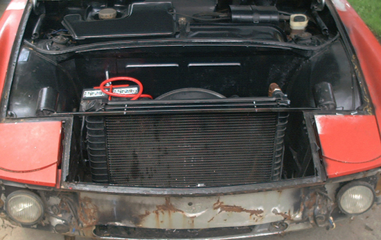

Hi
I recently replaced my custom 6 core radiator with a "Howe Racing" aluminum 2 core. My
car now runs aprox. 10 degrees cooler. Don't know if it was the change to 2 cores or the change to aluminum, but she does run cooler. I have also had good results with a Howe in my Monster Miata. In the 914 I am using a 16x27.5 (no fill-chevy) which cost
$190.
Bob

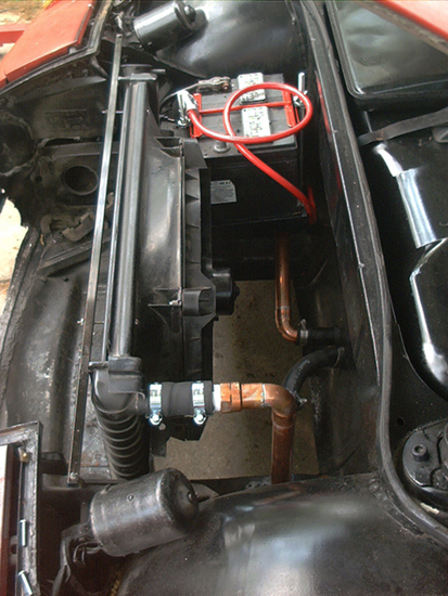

On my application I use aluminum condit instead of rubber hose under my car. I think this should also help get rid of alittle heat.
CONDUIT (yes I can't spell)
Bob,
The conduit looks good. Hell of a lot easier to work with than the steel pipe I used.
Nice, where do you get aluminum conduit? The stuff I've used (for electrical wiring) is all galvanized steel or PVC. Aluminum would be ideal.
Check with any electrical supply place. They also can supply you with long radius 90's.
The conduit also welds very nice.

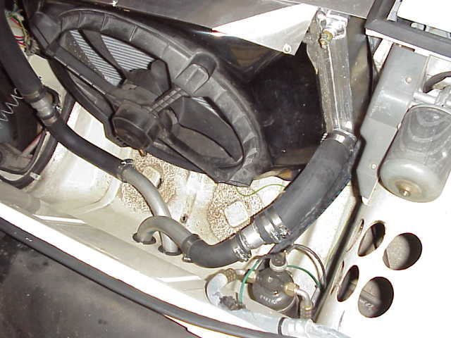

v82go the fan and shroud look like they are from one of the first orginal Renegade brass and copper radiator setups. I also see a ac drier.
Does the car have AC? Also is this the car that was for sale in Orlando a couple of years ago. Looked real nice from the pictures.
Bob

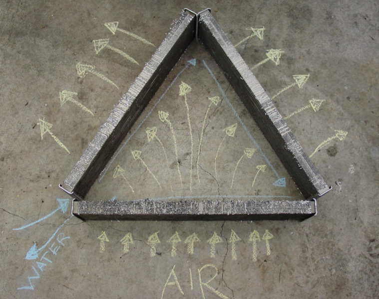

Whenever I need to design something unusual I turn to... garage floor engineering!
Here's the latest idea... semi-paralell, semi series. Solves the air expansion problem as the rear layer has twice the area of the front layer. This still may not work, but I think it has a better chance.

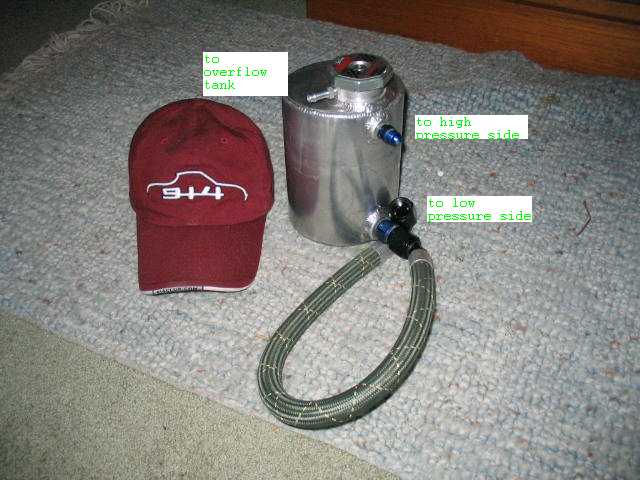

I think the main thing is to have a expansion tank that will bleed the air from the system. If you look at the pictures of BOXSTR new yellow V8 914 you can see how it needs to be plumbed up with a larger hose from the bottom of the expansion tank to the low pressure side of the radiator(feed to the water pump) and then a feed line from the high pressure side(hot water from engine) of the radiator to a point about 1" from the top of the expansion tank.
This will bleed all of the air pockets from the system. On my V8 car all I do is put water in and bleed the air from the top of the radiator and drive.
If you look at most of the new cars this is the way they are plumbed. Here is a picture of the expansion tank I'm using on my new V8 car

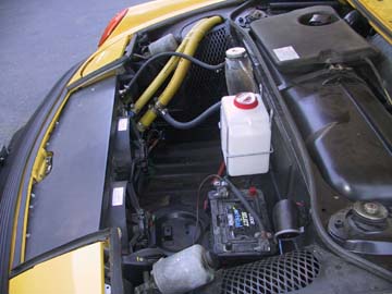

Here is Boxstr new yellow 914 this is what I was trying to explain.
Bob

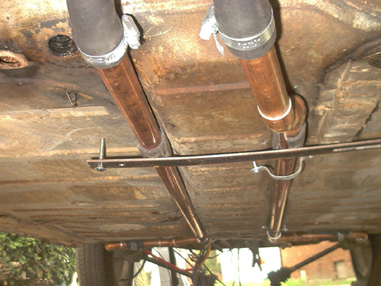

Here are some pics of my setup during the build. Here is how I built my system for under $200 (excluding pump).
84-89 corvette stock radiator, fan and shroud $125 (Used)
JC Whitney thermo switch: $25
copper pipe and such: $30
1 inch truck heater hose and alot of clamps: $15

Here are the hardlines under the car when I was test fitting them. Its good to have some bends so that when the pipes are attached, they do not twist. I hope this helps.
Mark
