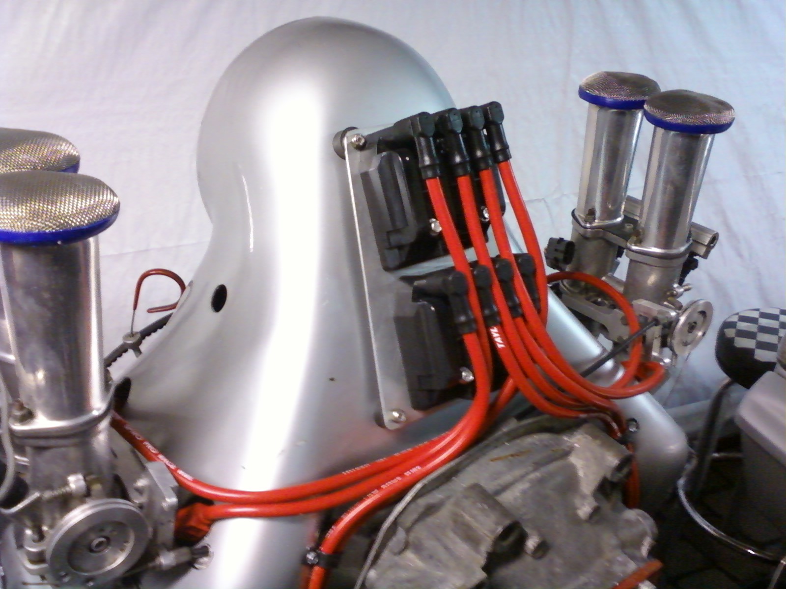

For a twin plug 4-cyl setup, you could use your trigger system with an arduino beetle (the size of a quarter, it would fit in the cap) and it would send your timing pulse to two separate MSD DIS-4s. The Arduino would delay the timing pulse to the second MSD with a adjustable duration that would determine the spacing between the plug firings. Both MSDs would drive 4 coil on Plugs.

I go Electromotive. You can either buy a Tec-S and use just the ignition channels, (keeping the FI channels for upgrade later) or you can go to the XDI and run twin coil pack assemblies from one trigger and wheel.
I used an XDI on my 2.6 T4 in my 356, and back in the 90s, when we started twin plugging these engines, the predecessor to the XDI, known as the HPV-1 is all that was around. I have several of those HPV-1 fired engines running around on twi plugs today and they've never had an issue.
