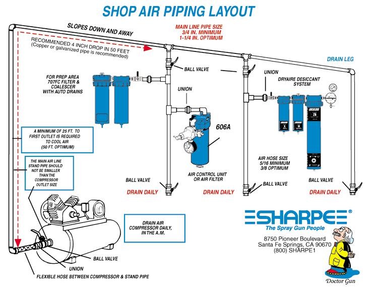

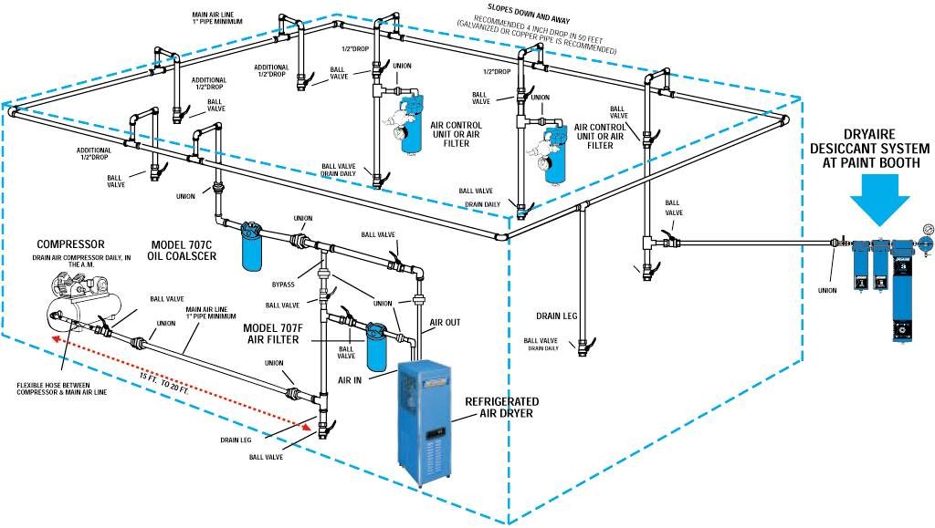

http://www.oldsmobility.com/air-compressor-piping.htm
This is a good tech article. You do a separator at your drop. And from what I gather, you want eveyrthing flowing away from the compressor (water), as the water will just get re-atomized as the airflow passes through. makes sense to me, but what do I know?

These ones have a single drop and air separator, then use that drop for pure air, the other drop is for air/oil (which I would do downstream of your clean air). You will need several separators if you do each drop if you cannot do it in line. Read the articles, it will help make more sense. I like the stepped tubing at each drop as well as the rise over from your horizontal lines for the drops.
One idea may be to use 25 feet of air hose, and hook that up to a separator - then do your hard lines (you could have it coiled up all neat and out of the way).

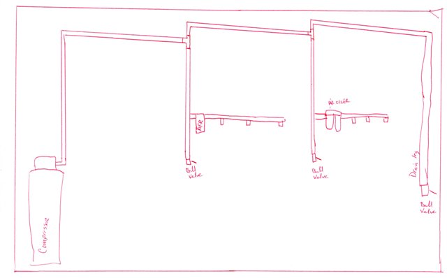

I had a reply but the bbs took a dump. Here goes again. A quick draw up of something you may want to ponder. Note the drops also have a dogleg step up, water flows downhill and will head down to your drops. the drop continues about 8 inches or so below your service stub with a ball valve - water trap. You can also get AFR's that will drain automatically when full, with one of those you can mount it up high and forget about it (except when it drains the water on your head).
The hose idea, was just an idea. You will get a restriction anyways coming out of your compressor, it would be a 1/4 or 3/8 output anyway. And also you will have to neck down to get into your AFR's and whatever tool that is using air. Also note that you will be setting your final pressure at your AFR. Full blast at the compressor, scale down at your AFR - make sense?
Image is too small to read, at least I used a red pen instead of a crayon..
Each drop has a ball valve for draining water. Drain leg at the end of your run. the first drop goes to an air/water separator/regulator, horizontally shoots out to T connectors with quick connects, 2nd drop for air/oilers (if you are going to use something like that).
