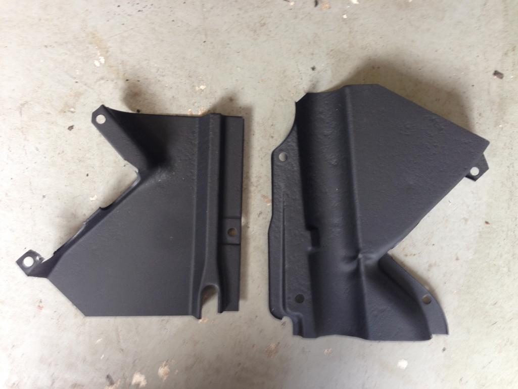

Now what? Rubbing tires? Burning brakes? I got on my back and finally deduced it was the newly powdercoated underside tins that attach to the heat exchangers! 400 degrees doesn't cure the parts when subject to 7 or 800 degree temps, at least for a while.

Are these the tins you are referring to? The pic is of the newly powdercoated ones I just put back on my own car.
BTW, gasket remover will take off powdercoat almost instantly.

And yes, those would be the underside tins Amphicar. They stopped smoking after being extra cured. I have experienced some powder coating that gasket remover won't touch, BTW.
