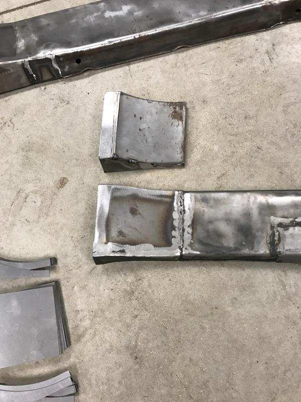

Posted by: mb911 Aug 5 2016, 05:16 PM
My newest project showing a bunch of students how to fabricate over the last few days.

Posted by: mb911 Aug 5 2016, 05:36 PM
QUOTE(Mowog4 @ Aug 5 2016, 03:28 PM) *
QUOTE(mb911 @ Aug 5 2016, 03:16 PM) *
Those are awesome, are you interested in selling a set?
Ed
We could do a set for you. I Will have to come up with a cost..
Tuesday we are going to weld these to steel rockers and update this thread will what they look finished.. I have considered marketing these just like aj usa use to do for the 930 conversion s

Wouldn't be hard to do generic fit for GT flares, often one car will be different from the next. confused24.gif

From my perspective it is impossible to make a generic set, the upside of steel is I can rework it and make it perfect for my car. I have a preference to work in steel vs fiberglass. I have no clue how to work in ABS.

I think the beauty of these is that they are steel and could be tweaked for fittment to their application. I think a great program would be to do an exchange program with people sending in their steel rockers we weld on the flared ends and sending back..
There will be variables based off of position on the rockers. The best way is rocker flares first then weld on the flares on the car.
I know not everyone will agree with me but I believe you weld the flares to the car first. The flares are structural and also a focal point to the wheel. Then you fit the rocker to the flare. The rocker is a trim piece.
+1, and don't forget to get the correct size of wheels that ones going to use- before you weld / cut those babies on the body. Trim is easier to mold vs the contour of the flares smile.gif
Posted by: 914forme Aug 6 2016, 07:51 AM
Also if you make the ends, it will allow others to do the same.
If you want a turn key product. Build templates that can be printed by the prospective customer then have them mark their flares to rocker panels with the correct template. While it is on their car, then they send them in, and your crew smash.gif welder.gif sawzall-smiley.gif smash.gif welder.gif aktion035.gif and after that you send back the final product.
Also takes the liability out of the equation since they or there shop made the markings.
Best way is to have the tub right there, you all spend the time fitting them. Another lesson learned.
Now onto my question, you teach metal bumping in a class - do tell, or PM me if you want to keep this thread clean.

This would be the best way to do this, sell the ends separately so the builder can custom align them to fit their flairs.
BTW Restoration design makes new stock outer rockers, would be an easy job to weld these on for a perfect GT rocker.

A couple of questions to answer. Yes I teach welding and fabrication at a local college. I teach how to properly use cnc brake presses,planishing hammers, English wheels, slip rollers, plate rollers, standard box and pan brakes, shot bags, shrinking and stretching metals.. I have done this for 16 years. Previous I was a welder fabricator in the avaitiob world along with rotax trained to rebuild all of their aviation engine types. Rebuilt 100s of them over the years. Along with that I had my Porsche only business where I designed and built all of the m&k exhaust.. So I guess metal working and engine builds have always been part of my life..
Now to these parts to be honest they take enough time to make that it maybe to costly to retail. I am not sure though. I would say that materials are probably only about 8 dollars per corner with the steel, blending disks, filler metals and argon. That said I believe labor is going to be about 1-1 1/2 hours per corner to make. So price might get up there. Maybe a group but and have laser cuts done Would be the best way to do this? That would help drive the price down

Most of the guys here that would want these will have some welding skills.
You could offer the cnc'd cut parts, as one option, and welded as another.
Cost difference would be the cost of your labor.
Each corner would need to be labeled if you simply sold the steel -
Again, just my .02 -

The problem is that there is extensive forming that needs to be done and probably not by the novice. I have been doing this along time and it is not for the weekend warrior.

Here is a front shot. It lines up exactly where the fiberglass one lined up its all I have to go by but looks great.. Attached Image

So my rockers were done in class as a graded fab project for a student. That student has graduated and is working at a local fab shop.. I told him I would buy sets from him if he wants to start a small business and I will resell them.. He is working on them I just talked to him last week about it.. I am trying to foster the start up small business ideas with students after graduating. I will start making them myself if he opts to not make them after a few month pass by if he can't or won't do them anymore but again my hope is he will do them.. He could be very talented.
