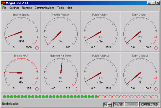

Keep it up you guys are making me feel better all the time. Geoff, the vacuum when warmed up at idle, taken off of Megatune (the tuning software) is 41-46 kPa or 5.9-6.5 lbs/sq in. It doesn't move around much.
Still gonna do the compression checks Wednesday.
Dave
Hmmm, that doesn't mean anything to me. On a vacuum gauge you need about 15lbs hg of vacuum steady. If the needle wobblbes, or is reading low it tells you alot about the condition of the motor.
Geoff
Geoff
That equals13.28 inches of hg which I think you are referring to. Its how much a column of mercury will move in response to a change in pressure. Like a blood pressure cuff when the doctor pumps up the little ball.
So this could be a little low and the needle moves some. It moves thru a range of 10%.
Dave
