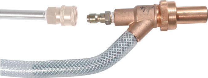

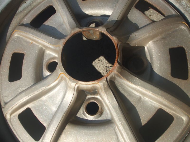

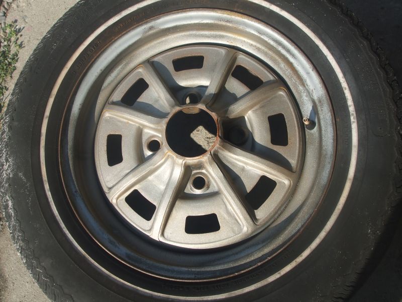

Well I was intrigued so I went and bought an el cheapo, so far I just shot a rusty rim face and I'm impressed. I have a 4hp 3000psi power washer, the WSB unit was something like $70.USD ($119CA at princess auto in Canada)
I haven't done enough to review it and I have no holdtight so we'll see how much it flash rusts over night.
So far I'd say it has it's place, but care will have to be taken to to avoid the pitfalls. It makes a mess, you still get hosed with sand, but don't have to worry about breathing it in. Looks like it will go through a shitload of sand, I'd say I went through 50lbs just to do a rim face, but it only took me 10 minutes.

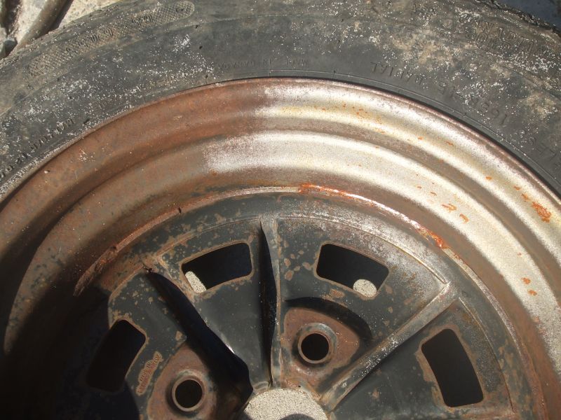

So this was the result of my quick test shot. As I said I don't have any Holdtight 102 (I need to find a canadian distributor) it's fairly high humidity out and I didn't dry it proper. Not to mention it was after dark and I wasn't dressed proper.
So it's starting to flash, but even with the flash it took off the heavy rust PDQ. If I just went from here and hit it with the dry blaster it would clean up damn fast.
The last pic of the back of the rim shows how heavy the rust was on most of the face.
As said you would have to be super careful if doing the body, but it will definitely be a useful tool.

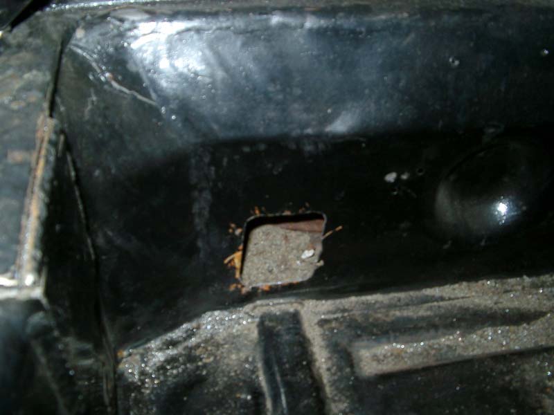

Body shop I sent my car to had it Soda Blasted and
I didn't get to go see the car for over a week.
Took this picture while it was sitting there.

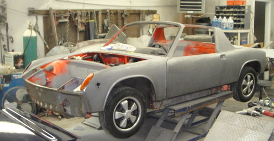

Well I got busy wet blasting the 914. Ran out of sand (2000lbs). 90% complete. The blaster worked flawlessly not a single clog after blasting through 2000lbs of sand. Did not use hold tight. Spoke with my paint manufacturer and they said flash rust is not a problem for epoxy primer. Just hit it with scotch brite and a cleaner that they provide. Steered away from rust convertors or soda or anything that I would have to neutralize either acid or base.

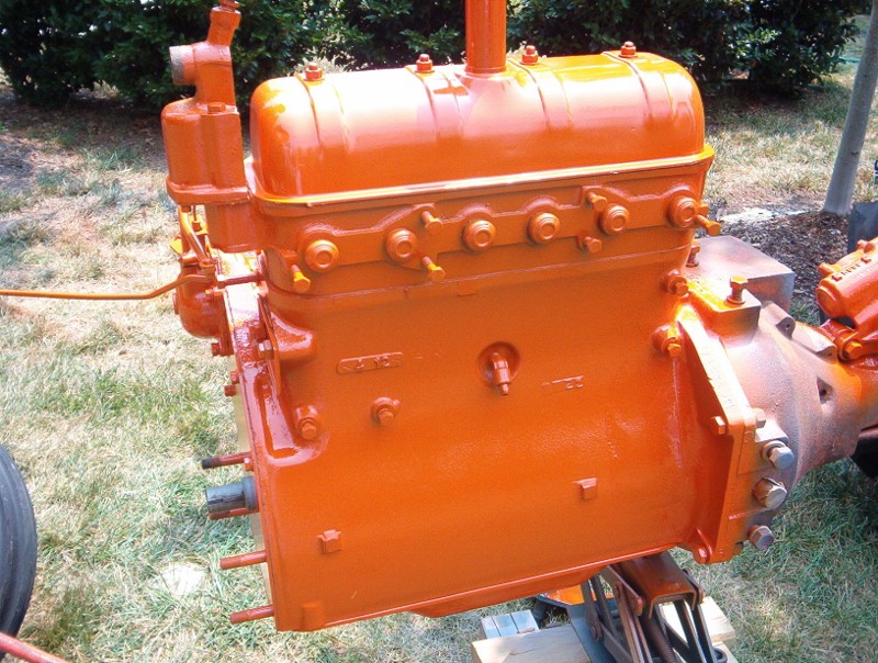

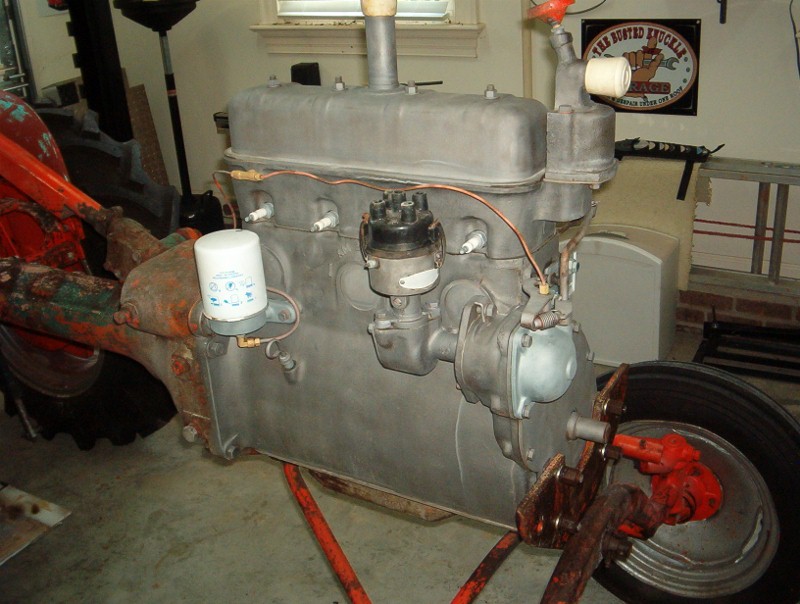

Allis Chalmers engine one week after blasting
Primed and painted PPG
