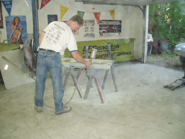

Here's my mask...it was like $50. I bought some of those Tyvek suits, but it was too hot to wear it, and I'm only doing Primer right now.

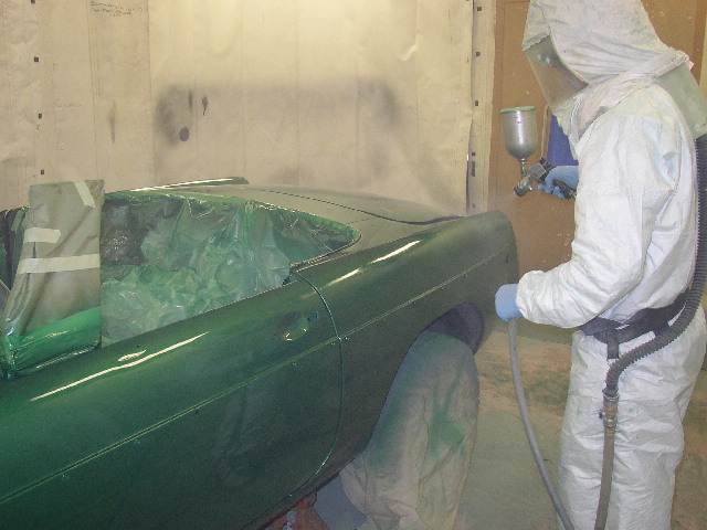

This is how I suit up when painting.
forgot the pic...
QUOTE (914GT @ Apr 15 2005, 07:52 PM) |
This is how I suit up when painting. |
So how does a "supplied-air respirator" work? Is it kinda like scuba diving? How does it supply you with air?
you have a large compressed bottle of air or a bank of them. the pressure is regulated down and fed into some kind of face piece. the pressure is high enough in the face piece to create a positive pressure environment . kind of like SCUBA but the hle face area is infused with air.
