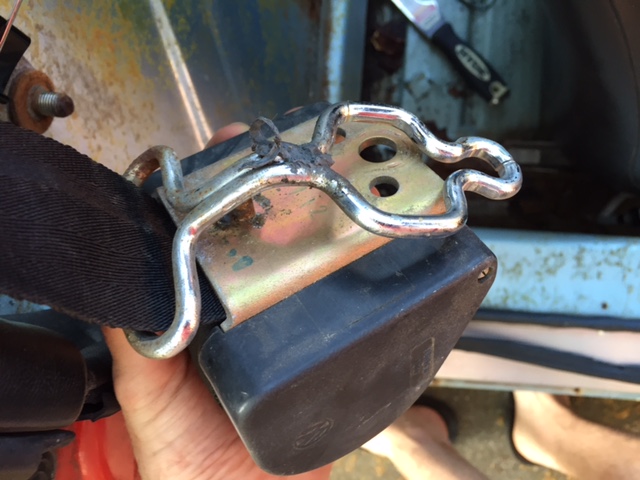

They help guide the belt so that it spools straight on the reel. I wouldnt leave them out. If the chrome is flaking it can hang/catch on the webbing and impede retraction. Ideally you should send them out for rechroming.

What is a reasonable cost for the rechroming of the guide bracket? I got this quote through emailing a vendor pictures. Reasonable? Note, I had only asked about the chrome guide bracket but they expanded a bit probably because of the pictures.
Guide bracket: $60.00 to $75.00 each
Seat belt reel: $85.00 to $100.00 each
Small triangle mounting bracket: $35.00 to $45.00 each.
A 6% metals fee, sales tax and any return shipping is added to all jobs. 50%(cash or check only) deposit.
Don't know what this service costs so I have no reference other than cost for a set of new belts. Thank you!!

I polished my guide brackets with a sanding paper and a fine steel brush on a dremel. They feel very smooth again and it gives them a certain patina. And it's free.
Posted by: Larmo63 May 19 2017, 11:27 PM
Those chrome guides can be carefully split and re-used.
Carefully.

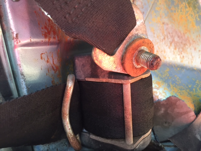

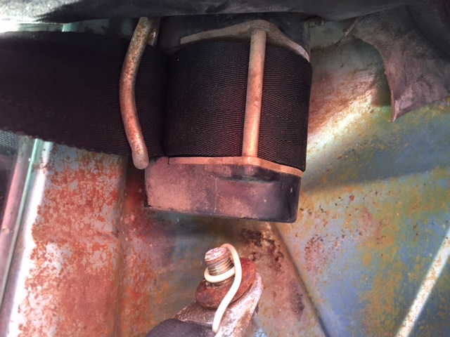

Seatbelt retractors only work if the belt is pulled out straight, which is why the metal "cage" is there.
Anything that makes the belt not pull perfectly straight will make your new belts useless ...

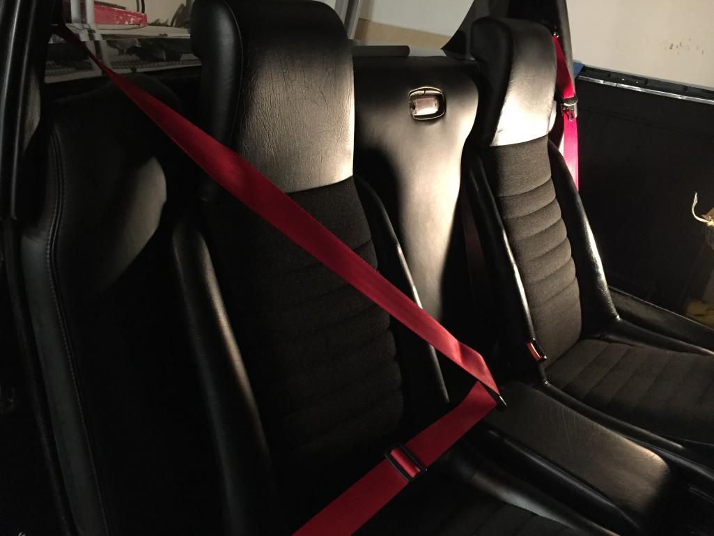

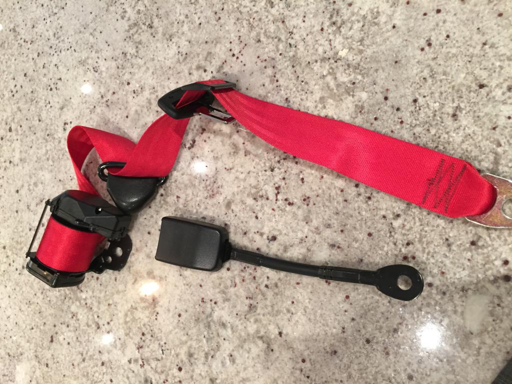

I didn't reuse that piece. The Seat Belt Planet kit comes with a guide plate that takes its place. I haven't had any issues with the belts not retracting properly. Sorry I didn't take pics of my install.

I have these same seat belts and did not put in the chrome piece and they work fine.
