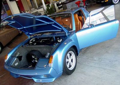

I was at my shop today and took a picture of my spare to go in my 914-V8 car, I have the same set up for my 914-6 because I have an oil cooler in the front like a 916,
Not clean but I thought I would show you for an option on this thought. This is around 20 inches tall.
Bob

I found this from an old post from a guy that used to post a lot. That is what Eric is doing with #41 my 6
Bob
