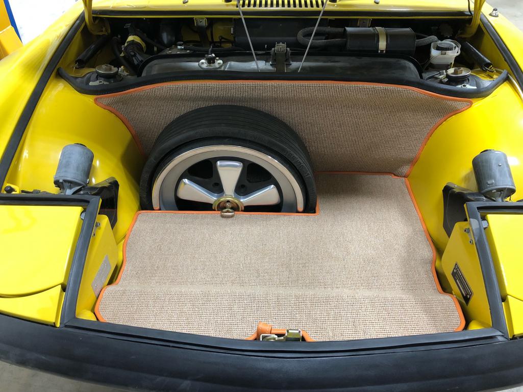

Posted by: burton73 Apr 5 2017, 04:08 PM
Some of the guys have asked what is in this Engine. Scott Kinder built it for me and this is what it has inside.
1978 3.0 SC big-port base (case, crank, rods, oil pump)
Custom JE Pistons, replated Nikasil cylinders, 9.8:1
New valves, 38/37 ports (stock)
ARP head studs & rod bolts
GE40 "Mod-S" cams
PMO 46 carbs & manifolds
JWE custom curve on SC distributor to match the carbs/cams
930 tensioners, idler arms--all rebuilt
Otherwise just everything new or refinished, redone, rebuilt
Best
Scott

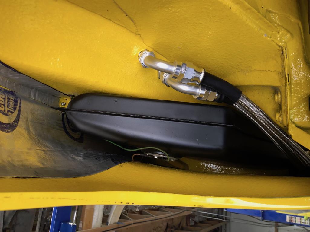

-6 mount for oil line from the tank to the engine.

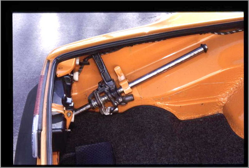

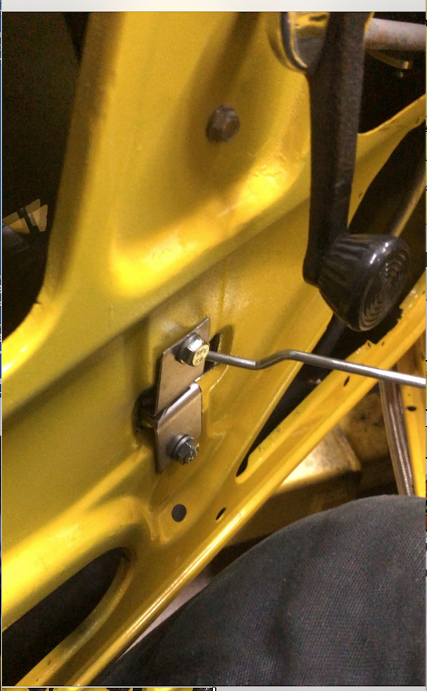

Some cool stuff or what I think is cool stuff: The owner’s book says it had its engine rebuilt at 64,828 miles.
The speedometer now says 110,000 or so. It has been so long scene I have looked at it.
#41 delivered on 1-4-70 to Dick Barbour Porsche. Engine number 640-4016 long gone.
The book was validated by Porsche Audi Pacific in Culver City CA not 1 mile from where I live now and 3 miles from where I grew up. I live 1,000 Ft from where Howard Hughes built the Spruce Goose. My house was built on land that Hughes Aircraft owned on the bluffs above the old Hughes Aircraft. Today that is called Silicone Beach and Playa Vista
Tool kit was in the car as well as factory jack. I had to buy copy red screwdrivers but what the hell. I have a Hot Rod VW. Waite till you see the NOS radio that I bought. 41 had a 80s loud radio with huge amp put in. I deiced to leave 41 in the spirit of the late 70s and not put her back to what a 914-6 was from the factory. I had to thing on it hard and a number of guys here back when it was up for sale, posted that it was a solid car but did not have the original Eng. and trans and it had the oil cooler and the trick body cowl door for fueling and it would never bring the big bucks.
Well I have really not wanted to sell her and build in this form is what I am doing. With some help from my friends.
Bob B

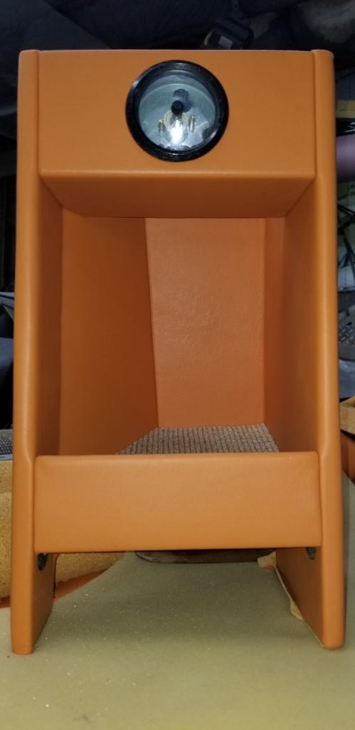

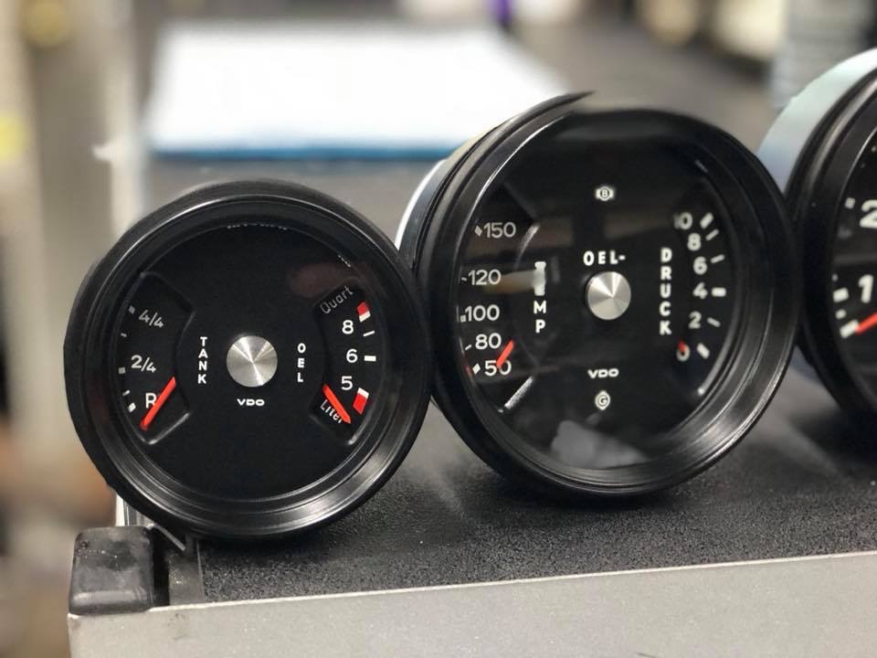

Posted by: burton73 Apr 6 2017, 10:31 PM
Before we go to far with the assembly, I have more pictures of each part that was in the “as received from a long sleep”. After these are cleaned and restored and Eric put his new Copper lines instead of the braded stainless in the rockers and we will see more of “the art of the build”. Not deal
Bob Burton
Attached Image Attached ImageAttached ImageAttached Image[attachmentid=599
739]Attached ImageAttached ImageAttached Image
I am getting the hang of this

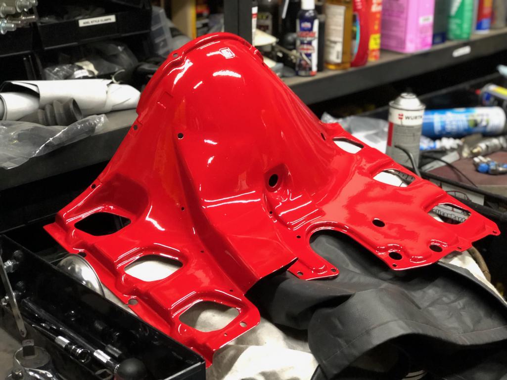

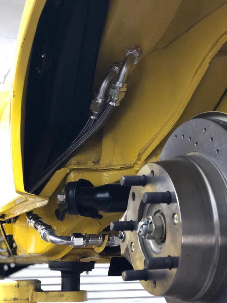

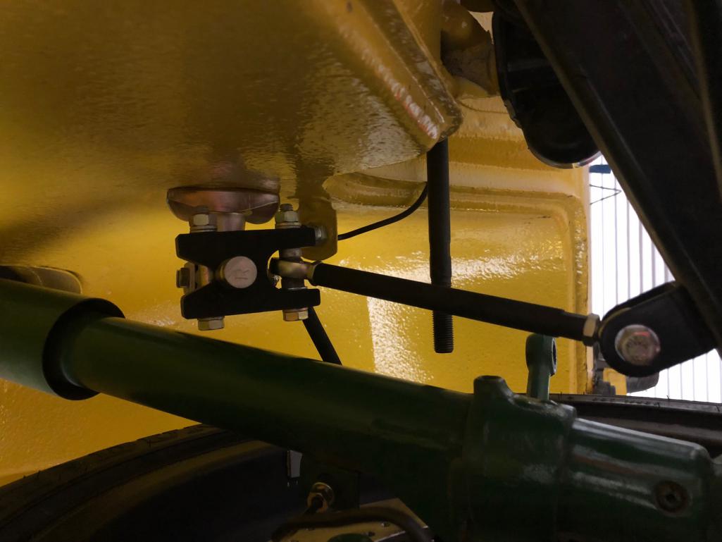

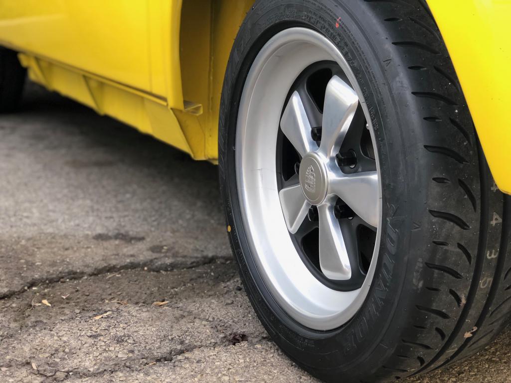

Posted by: burton73 Aug 9 2017, 01:21 PM

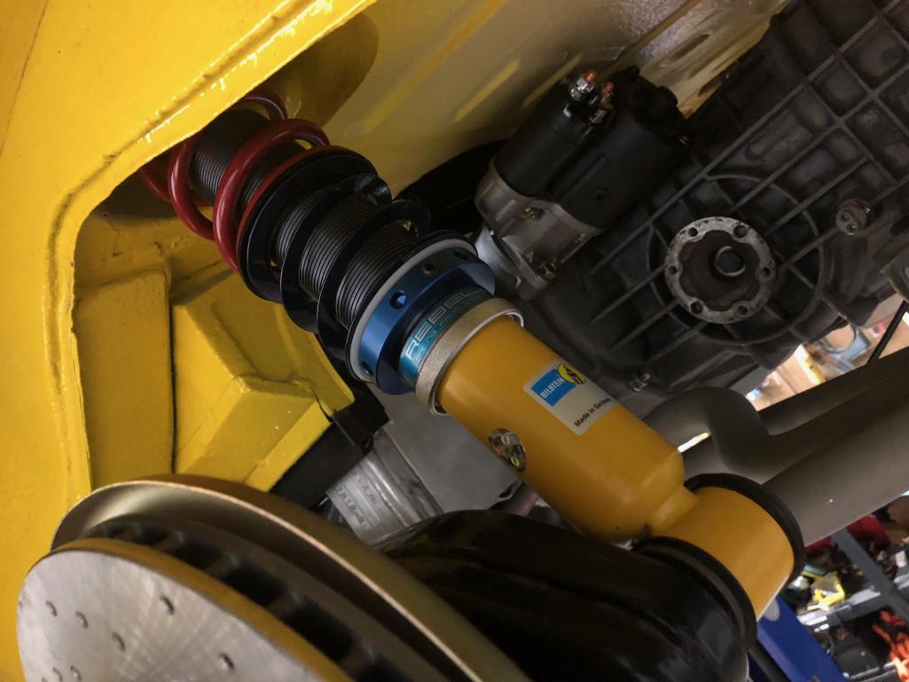

Work goes on with 41. Trans rebuilt. Lower gears from the 70s hot rod days. Suspension is yet to be detailed. Engine and trans are going in,
I will post, as this is moving along. PMB has a few cars in the shop. E sent me pictures of the restored Euro turn style buckets with 2 blubs and horn restore but I cannot find them now.
Bob B

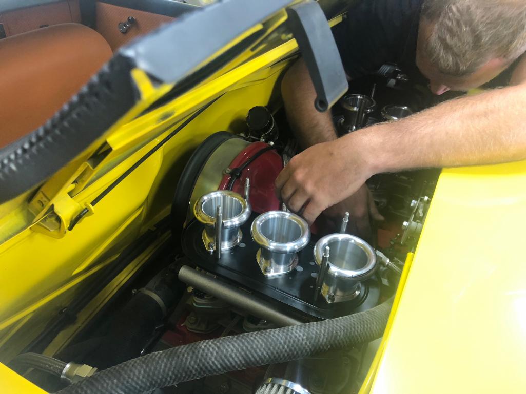

PMB put the stacks on my PMOs. The PO had non 914-6 air cleaner on it and I am going with the same set up. Will show more. Also the trans after PMB re freshened it. I got a NOS case from AA 9 years ago and it looked great in its Porsche box but after PMB inspected it had a cracked bearing seating area so we are trashing (recycling it)
I got it in the first place, as the old Transmission case looked pickled from what I guess was engine cleaner.
This was the info on the transmission. From the PO. “Transmission Rebuilt 2000 Miles ago by Performance Haus, , Hand polished close ratio 906 gears Late model "side shift" linkage” PMB found that it needed more than just new seals and gaskets. You really have to CK out everything on a restoration. Even N.O.S. parts or you can be S.O.L. That 2,000 miles was 30 years ago.

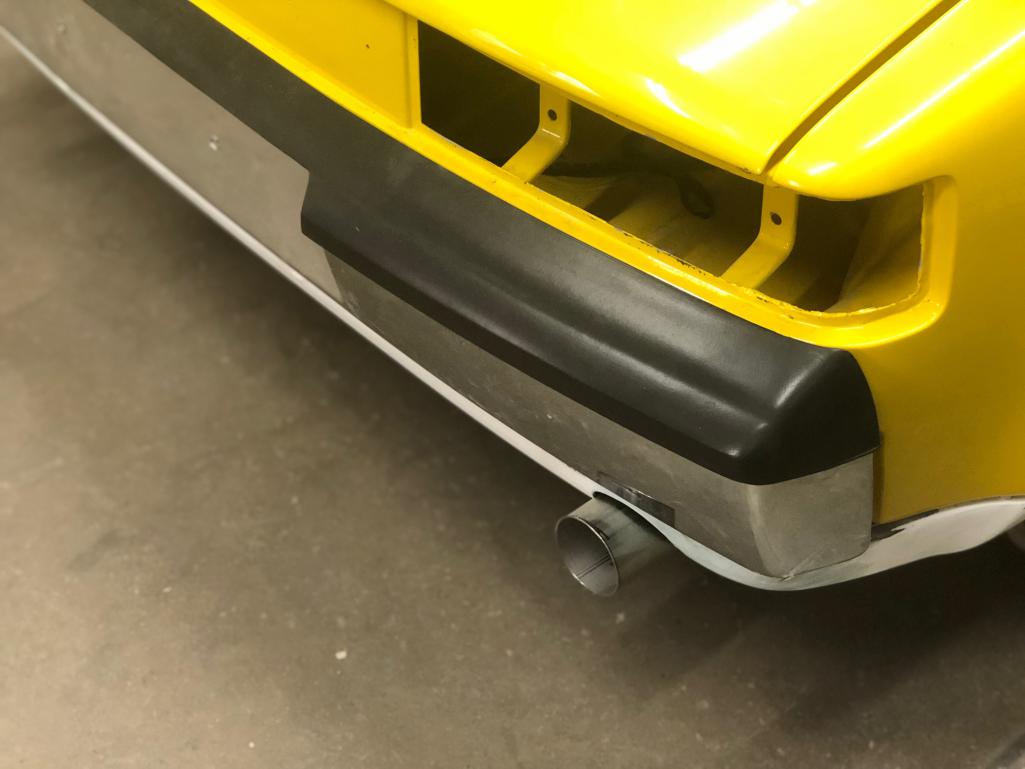

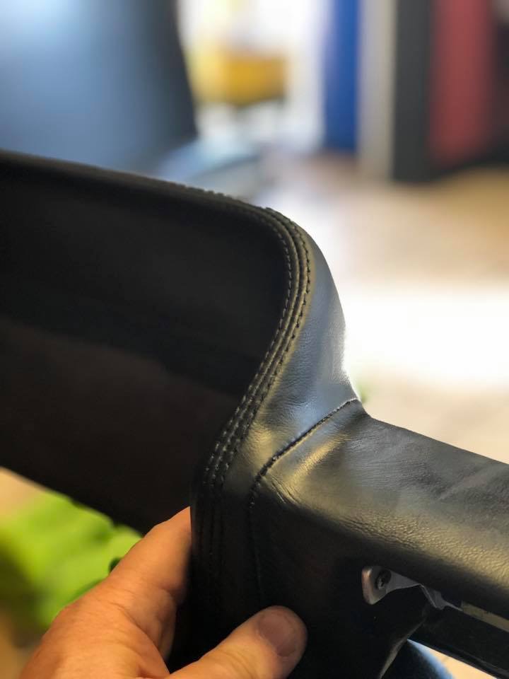

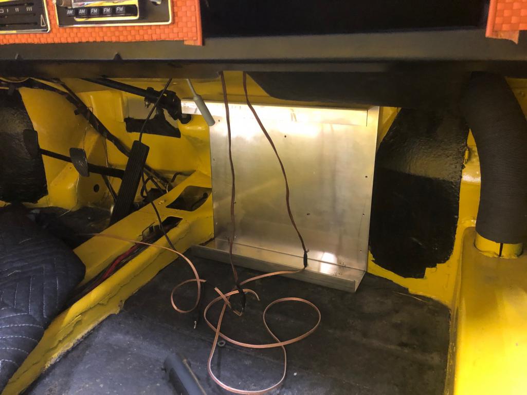

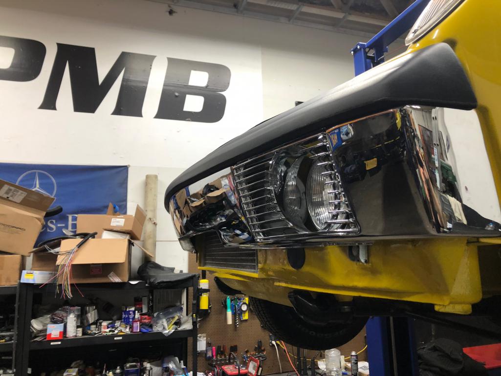

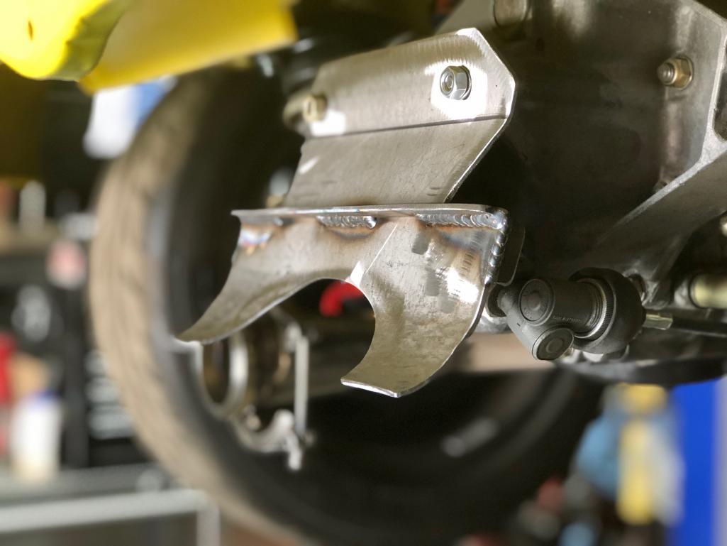

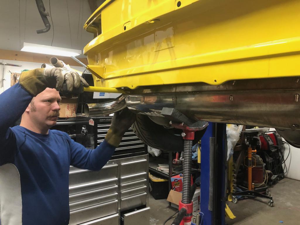

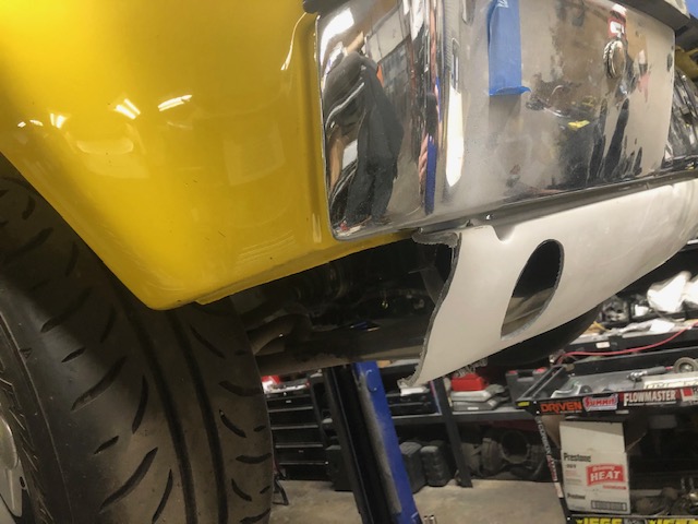

Posted by: burton73 Aug 28 2017, 07:54 PM

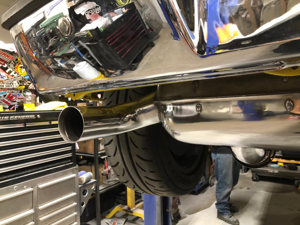

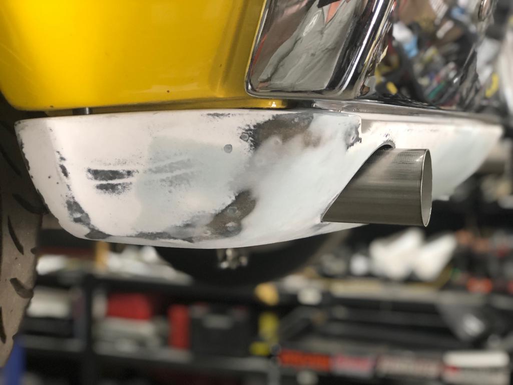

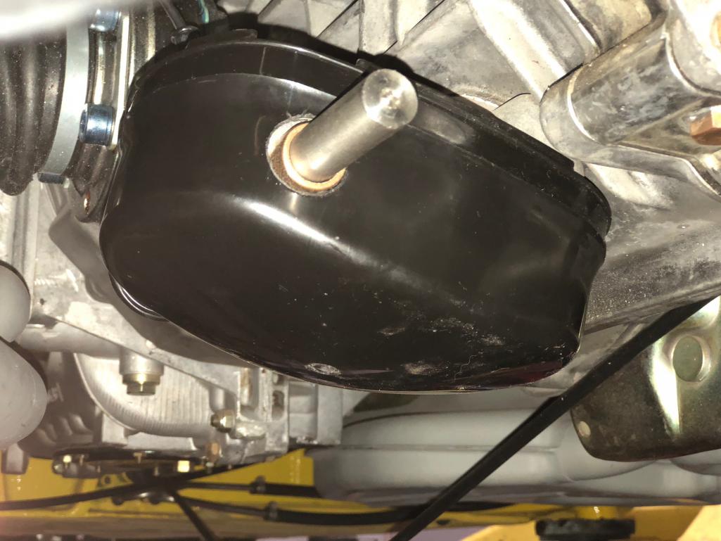

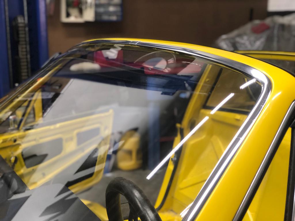

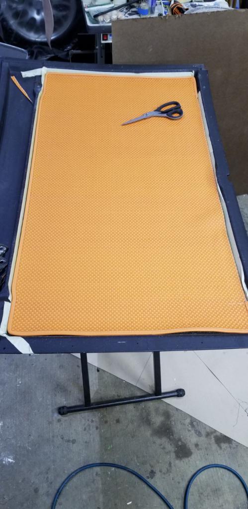

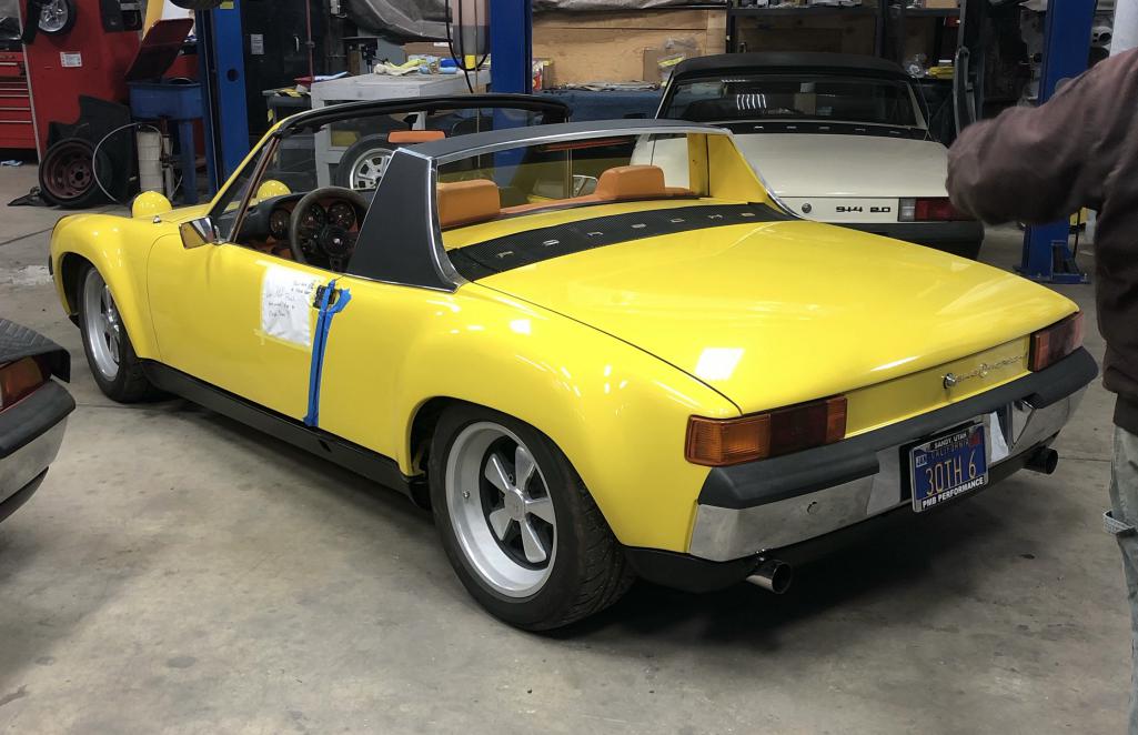

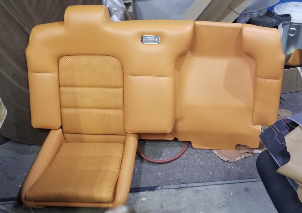

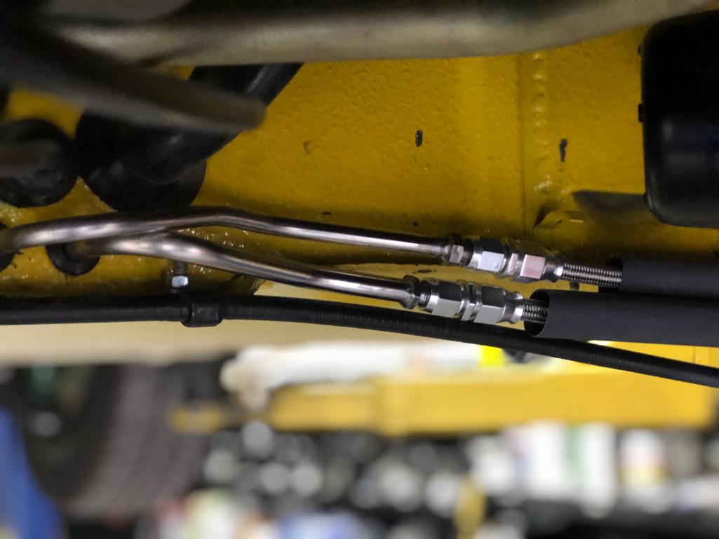

The work continues at PMB Performance. The work and parts are works of art. August 2017 working #41
Bob B

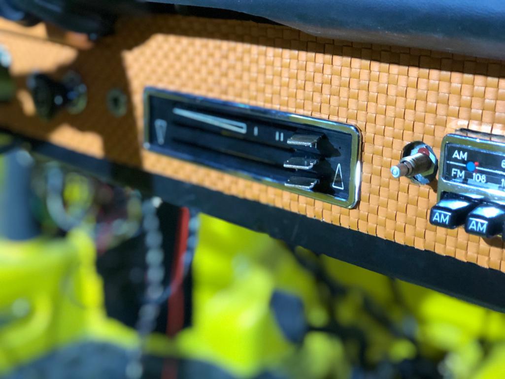

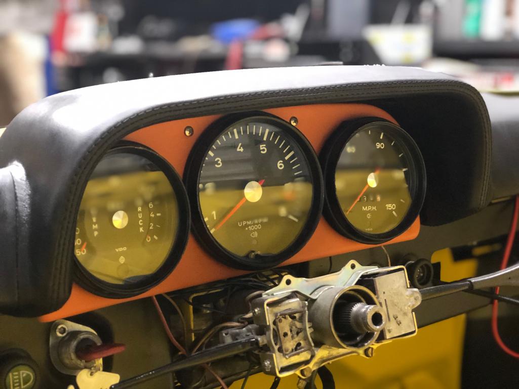

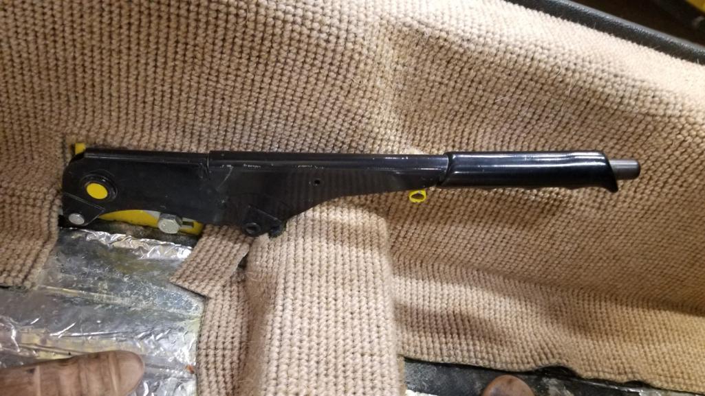

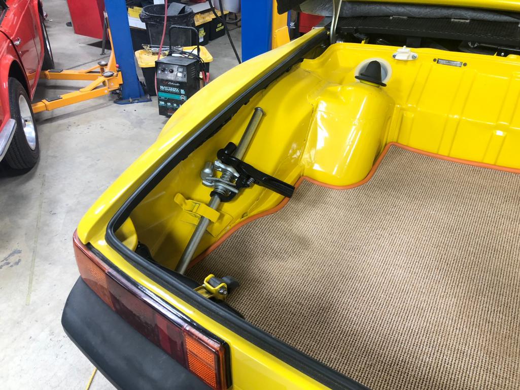

Posted by: burton73 Aug 30 2017, 02:06 PM
Sorry for posting on my car out of order but as Eric feeds me pictures I will put them up.
My Wife says that I really do not own a 6 it is just in my dreams. It is a distance from LA to Sandy Utah
Bob B
Attached Image Attached ImageAttached ImageAttached Image[attachmentid=618
201]

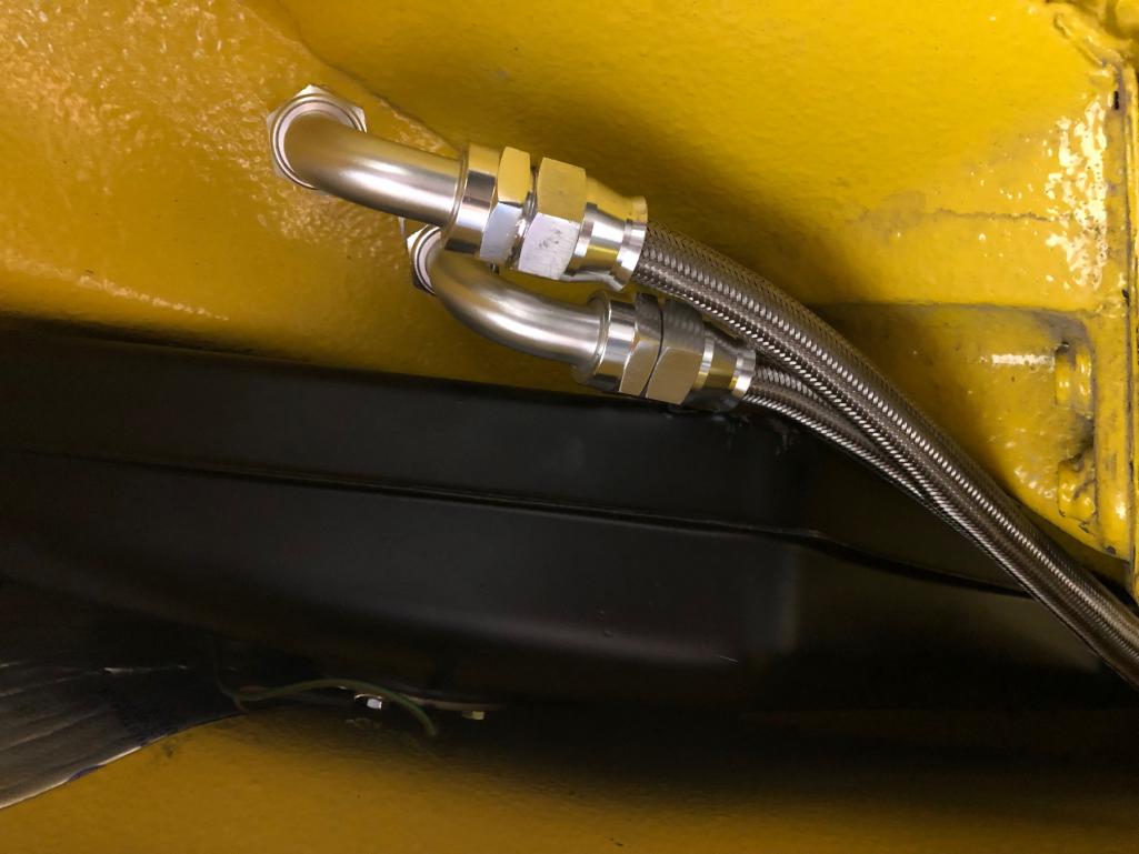

Posted by: burton73 Aug 30 2017, 02:08 PM
MoreAttached Image Attached ImageAttached ImageAttached Image[attachmentid=618
202]
Posted by: burton73 Aug 30 2017, 02:10 PM
207]
Posted by: burton73 Aug 30 2017, 02:11 PM

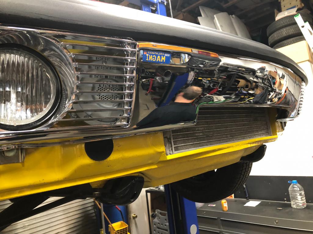

Posted by: tygaboy Aug 30 2017, 02:16 PM
Posted by: mb911 Aug 30 2017, 02:21 PM
Who did it?
Posted by: burton73 Aug 30 2017, 02:51 PM
Eric did it or had it done a few years ago.
It is very nice.
Bob B

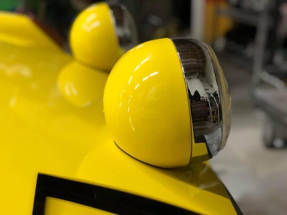

Posted by: burton73 Sep 1 2017, 07:07 PM
Back in the 70s these French’s did not cost too much.
Bob B
Posted by: 914Sixer Sep 2 2017, 07:59 AM
Yep, the French ones used to be the same price as the Euro's. Loving the pictures.

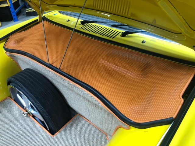

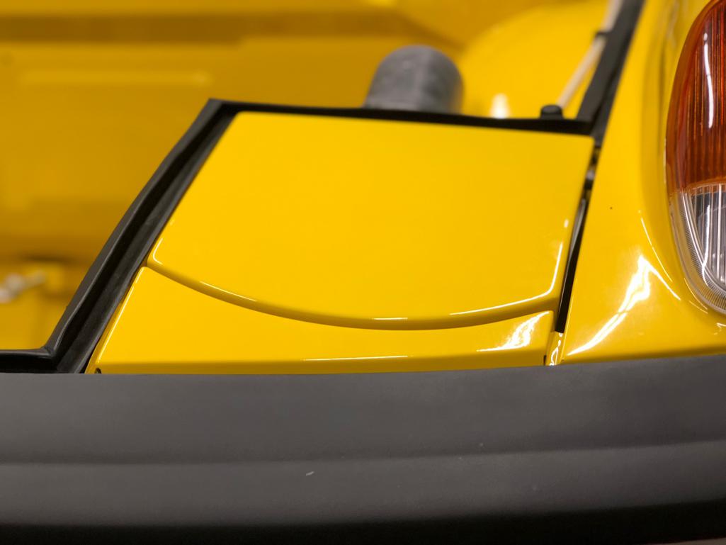

Posted by: burton73 Sep 3 2017, 12:43 PM
Fuel Door from an aircraft. A 70s touch from early POs One of a kind so I know it is #41 Done really well. Just seemed right to leave it in the sprit that the car as it was modified in the 70’s
Bob B

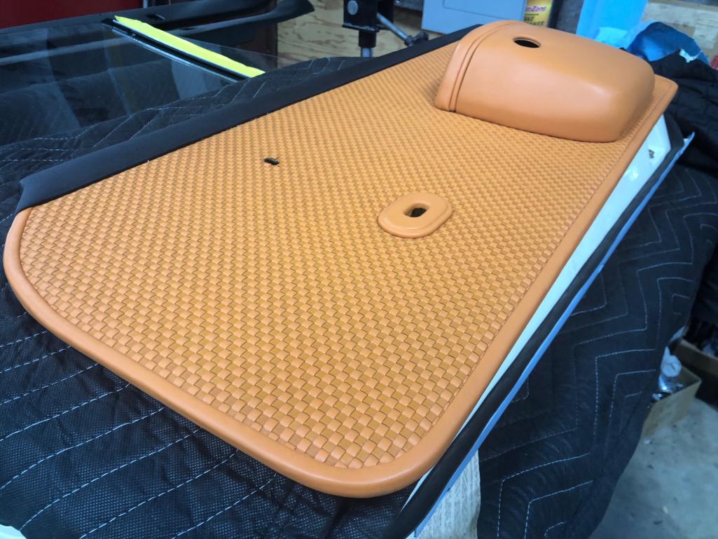

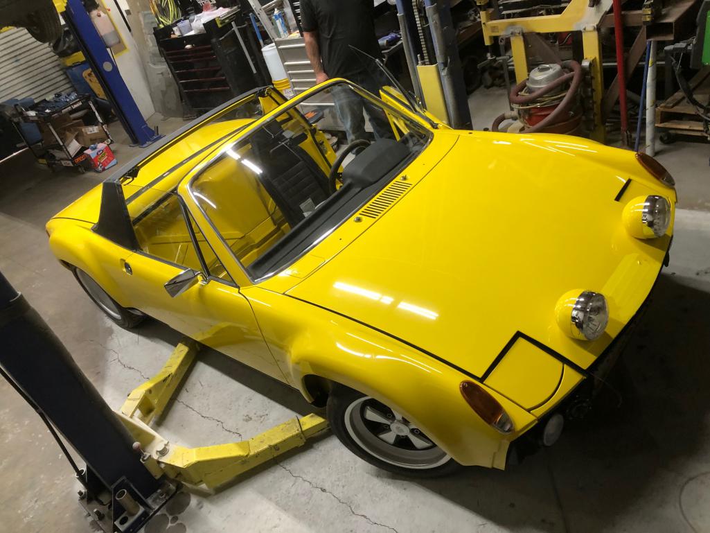

Posted by: 914 7T3 Jan 10 2018, 11:55 PM
Updates?
Posted by: JamesM Jan 11 2018, 01:08 AM
QUOTE(914 7T3 @ Jan 10 2018, 10:55 PM) *
Updates?
Not going to expose any details as its not my car but sung by the shop yesterday and its on the lift, exterior wrapped in protective plastic like a brand new toy, in the process of receiving an extreme dose of OCD. Addison and Eric were reviewing the condition of the chrome on the window rails when I arrived.

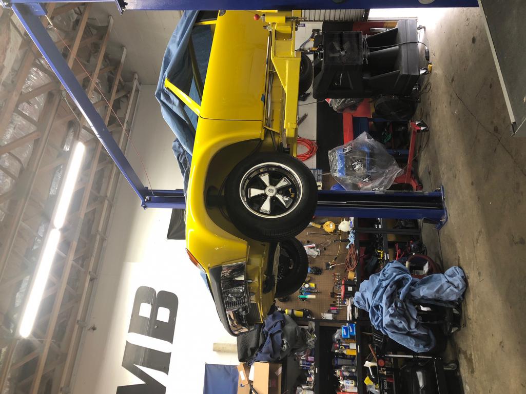

Posted by: burton73 Jan 25 2018, 03:20 PM
Today’s pictures from PMB Performance. Clearing out my garage to get ready!
Note: the guys wrap the car in plastic to keep the paint safe during the work on the body.
I also got a call from www.FuchsRestoration.com Rick that my 7 and 8 15s and spare 6 x 15 are ready. He said 6 weeks but it only took 10 days.
Bringing back my 8s and 9s x 16in that are on there now.
Bob B

Posted by: burton73 Jan 27 2018, 10:53 PM
As I had said before, I do not have my rebuild in a set order as far as the photos go, so please excuse me if there is more than one copy of some shots.
Some points on my car that are different than a GT car is with the Troutman touches in the cowl fuel door and there touch as far as the front Sheet Metal oil cooling shroud and shaped metal goes. Very nice curves up front under the hood. The work is tremendous. That is the way they did it back in the late 70s.
the black shroud is yet to be repainted.
Bob B

Posted by: burton73 Feb 4 2018, 07:53 PM
Eric moving on closing her up. I am making room in my Garage and increasing my insurance as we have been going along: My wife says I just talk #41 but it really does not exist.
New rubber on all body seals. New Shocks, New, or rebuilt everything. Changing out long lugs to standard lugs and factory BK caps. Had 3 piece BBS wheels that I sold to Jamie 8 years ago. S heads and Cams that I sold to Mark Henrey 7 or 8 years ago. Clutch that went to Mark. (Euro911) last month.
Bob B

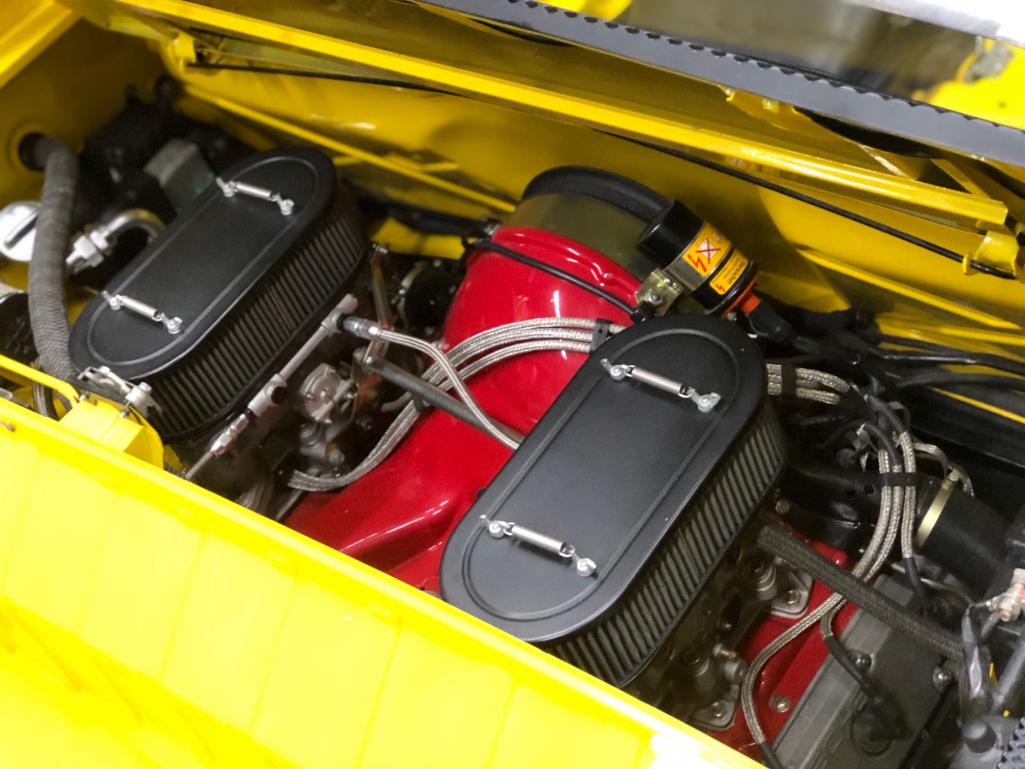

Posted by: burton73 Feb 7 2018, 10:36 AM

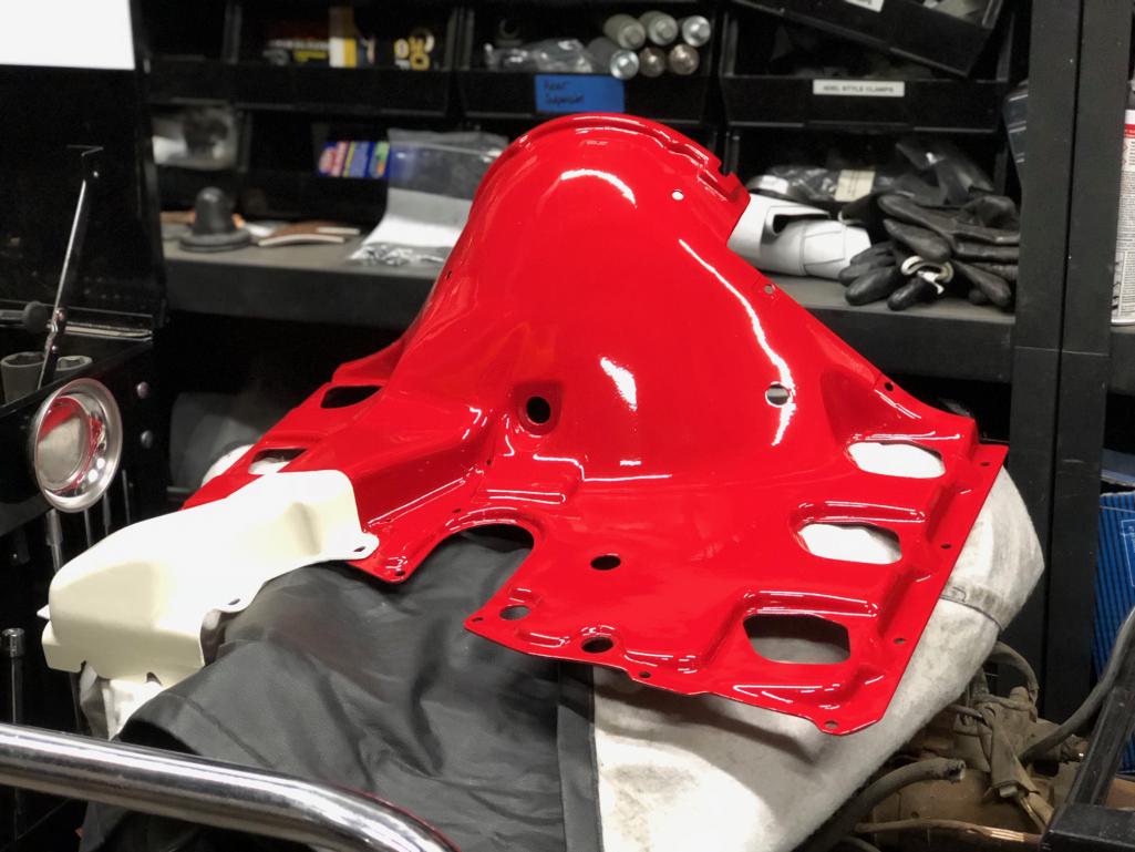

Some pictures of before of jack post side, under shot of oil tank and cooler lines, front drivers side front sway bar and Bilstein strut minus earls S caliper. Wait to see how pretty that turns out from the Maestro’s team.
Picture of linkage carburetors that I misplaced in my bead blasting cabinet. I had not been in it for 5 years and found the parts just in time.
Air box restored by PMB to a level that may look better than new. Special things on 41? I guess some things look a little different. I am so impressed on the level or work on my car.
7 and 8 x 15 Fuchs refinished and in route. 8 and 9 16 Fuchs coming back to me. Great work by PMB and I am very happy with the way it looks. Eric playing a great riff on my car.
Bob Burton
Attached Image Attached ImageAttached ImageAttached Image[attachmentid=638
164]Attached ImageAttached ImageAttached Image

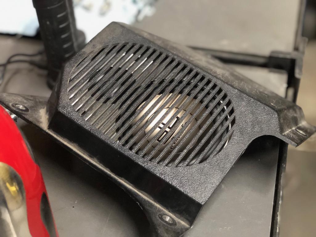

Posted by: burton73 Feb 8 2018, 04:08 PM
These plastic parts where early prototypes pieces that had to be restored. Eric has had to do a lot of research as well as use all of his talents to get the 30 six this far. I sound like the Godfather. “Use all your talents”.
Great job PMB
Bob B

I want to thank Gusti for sending me these pictures from the 916 that was sent back to Europe and Gusti got these pictures. This is helping me decide just how I will do 41’S interior with Cork Leather. Making 41 a very unique car. Eric says he has the man to do the interior. I painted the car Cannery yellow as suggested to me (Iris blue) is my favorite color combo as I had a 1978 911SC Targa in this 916 color combo, at least I can match the interior color now.
Bob B

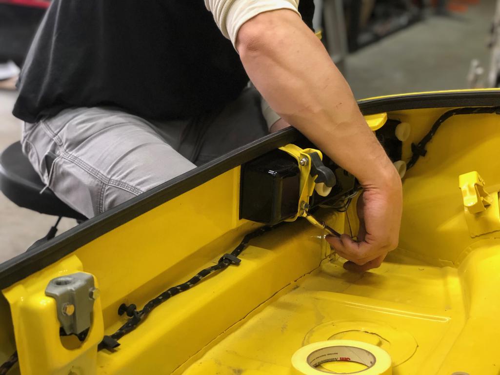

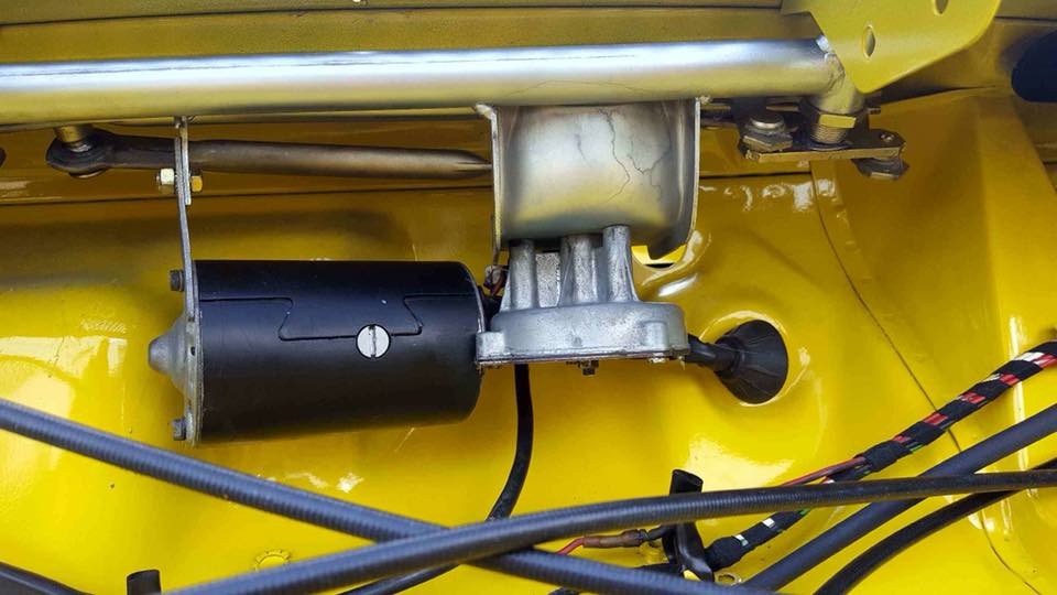

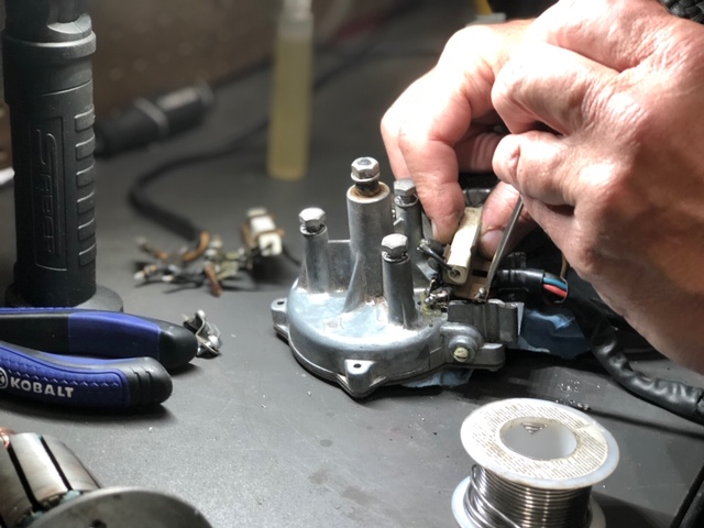

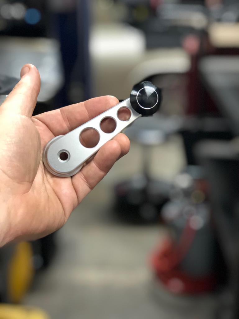

Posted by: burton73 Feb 10 2018, 02:51 PM

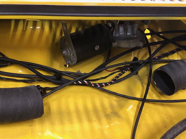

More work: installed vent and wiper mechanism
Bob B

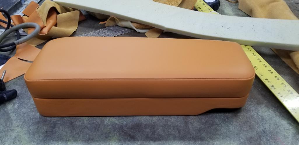

Posted by: Mike Fitton Feb 11 2018, 11:20 AM
Thanks for posting those 916 interior pictures, very interesting. Also noted the ashtray is leather wrapped.
Posted by: Mike Fitton Feb 11 2018, 11:29 AM
What steering wheel are you going with? Here is one of mine 380mm and thick wrap to 3 5/8".
Posted by: Larmo63 Feb 11 2018, 11:31 AM
That door panel looks like it's out of a Cadillac Eldorado.
Posted by: ConeDodger Feb 11 2018, 11:31 AM
The really great thing about working with Eric is that when he gets rare brake calipers in for rebuild or in this case, a very early numbered car, he is truly honored to be working on it. pray.gif
Still makes you write the checks though! evilgrin.gif happy11.gif av-943.gif
Posted by: pete000 Feb 11 2018, 11:31 AM

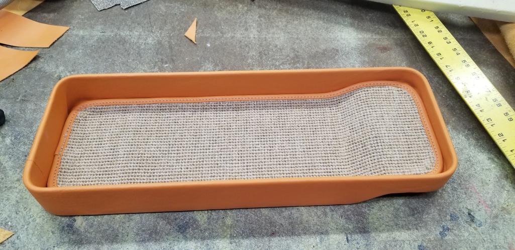

I like the shortened center arm rest exposing the center tray.(also leather wrapped)
Posted by: burton73 Feb 11 2018, 01:25 PM
QUOTE(Mike Fitton @ Feb 11 2018, 09:29 AM) *
My wheel is a, new leather double wrap 380 just like yours and the hockey puck I bought on EBay 9 years ago from an early 911. Eric just needs to finish the leather on the puck and plate the thin chrome ring. He did say my paint on the steering wheel was wrong shade. I think he said it needed to be very dark gray almost BK. I guess it is BK now.
Bob B

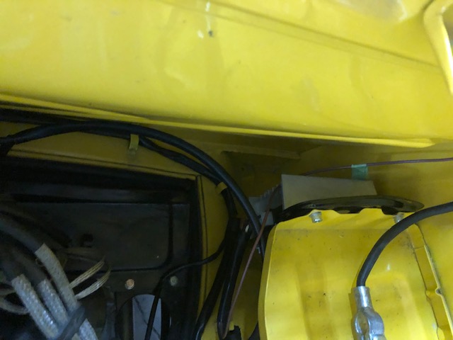

Out of order but: Hell Hole (not) in 41 when I got it 2007
Paint was Brown when I got it but when I striped it I found Green in the engine compartment but no any other spot on car. I painted the battery tray and support with blue that I was going to paint the car. I could not find any green on any other area but the Eng. compartment.
I personally removed all the paint before took the car.
Bob B

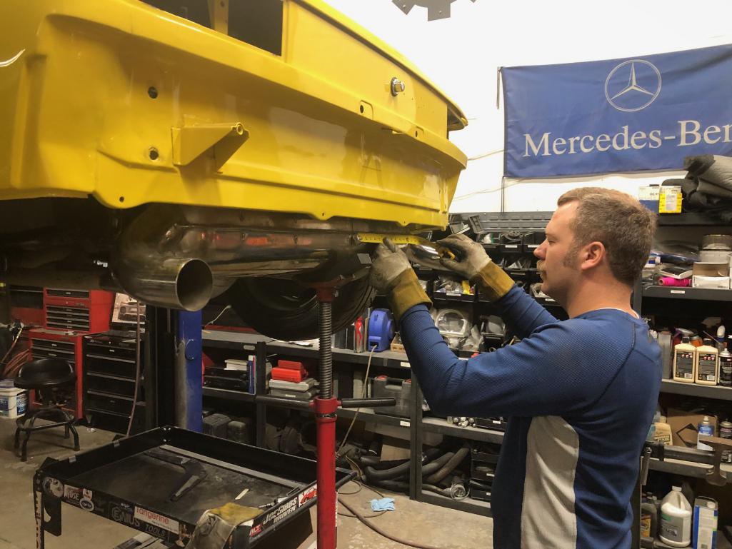

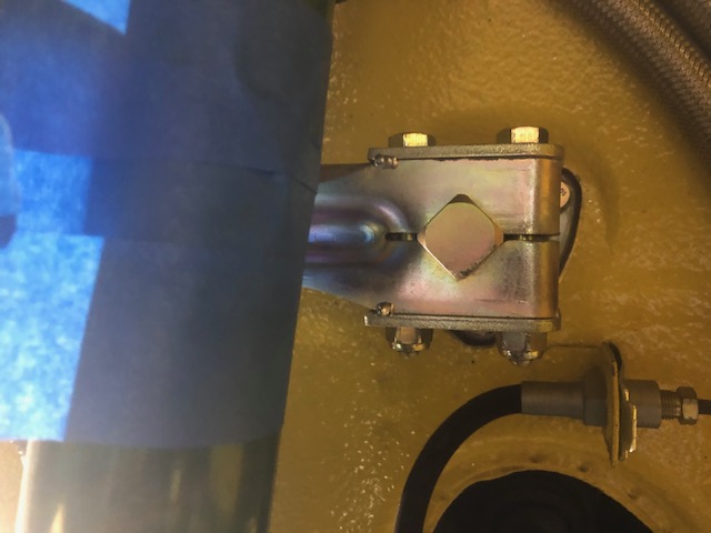

Posted by: burton73 Feb 15 2018, 03:41 PM
Wednesday 2/14/18 update of pictures on #41
Today on Thursday lots of stuff going on with the rear left suspensions.
Trying to pick up my new license plates. “30TH 6 “

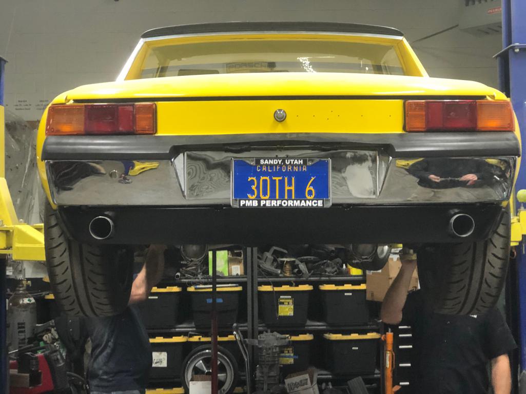

CA only has black with yellow so I will need to paint them as 70s CA blue.
The DMV where dicks and would not let me use the PO plates innless I paid the registration all the way back to 1985.
Bob B

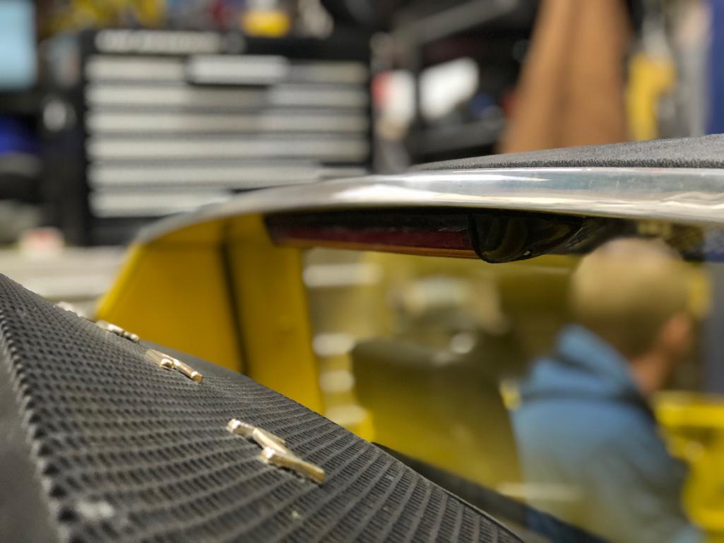

Daily Add on from Eric at PMB
He says “Prototype Latch Mechanisms” Must be a first 50 thing?
Bob B

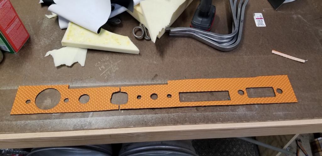

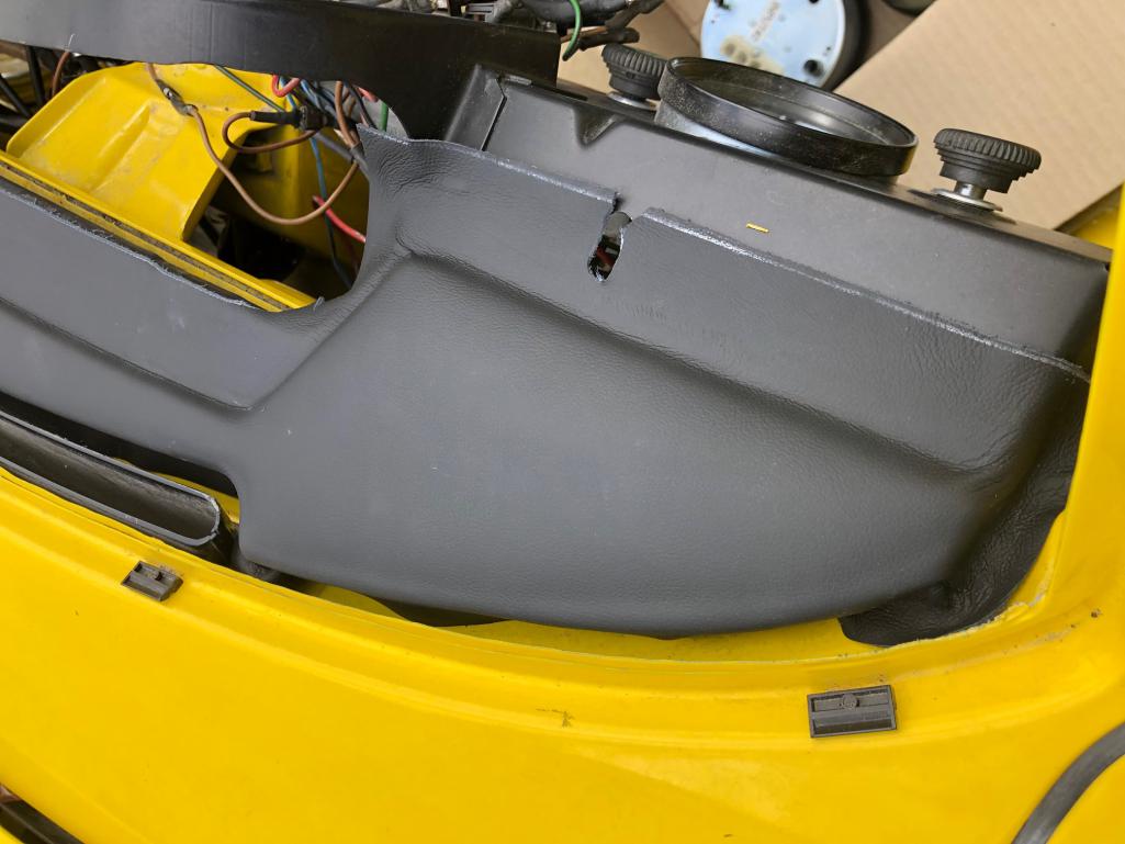

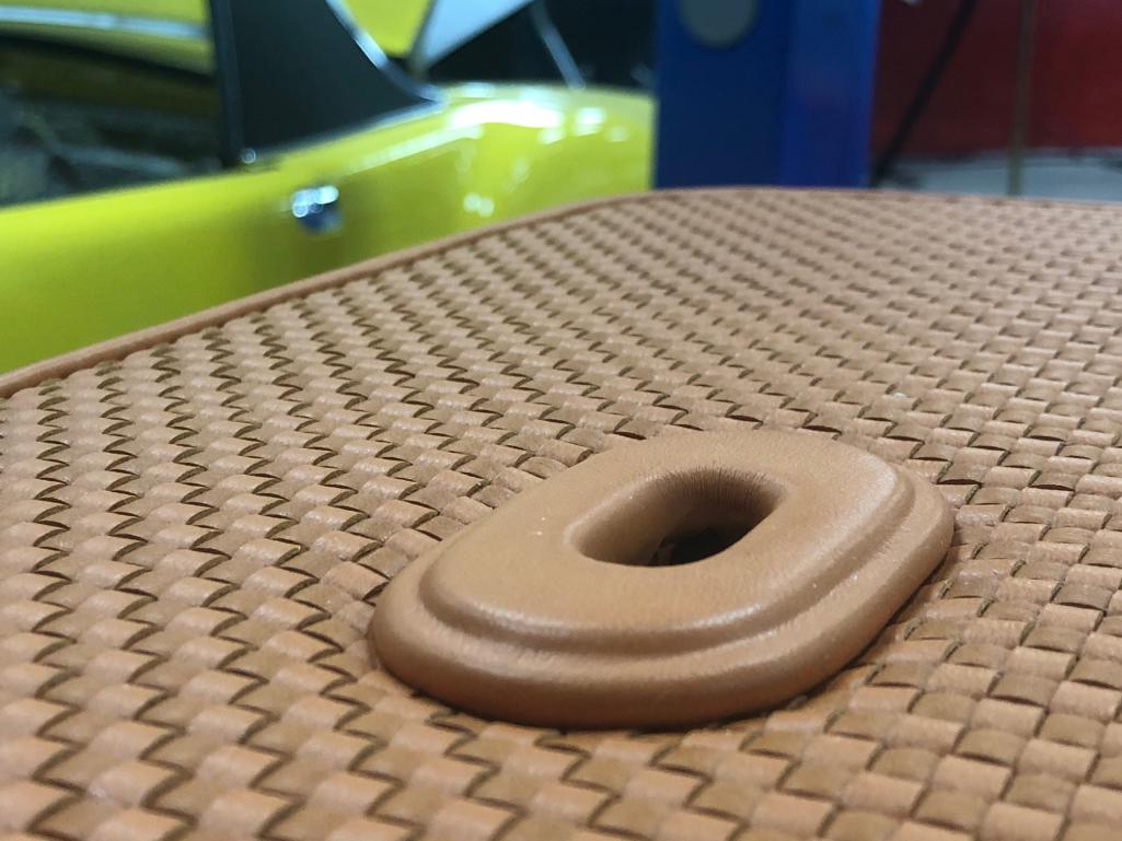

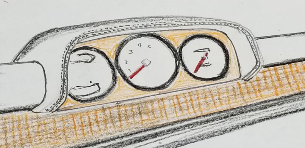

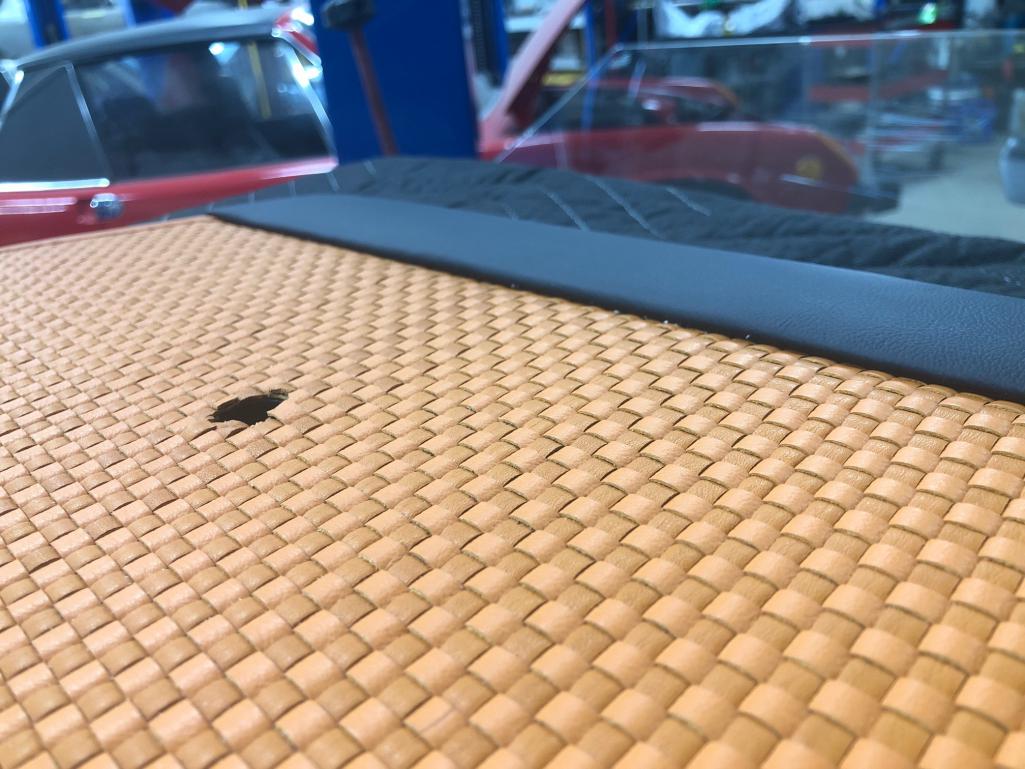

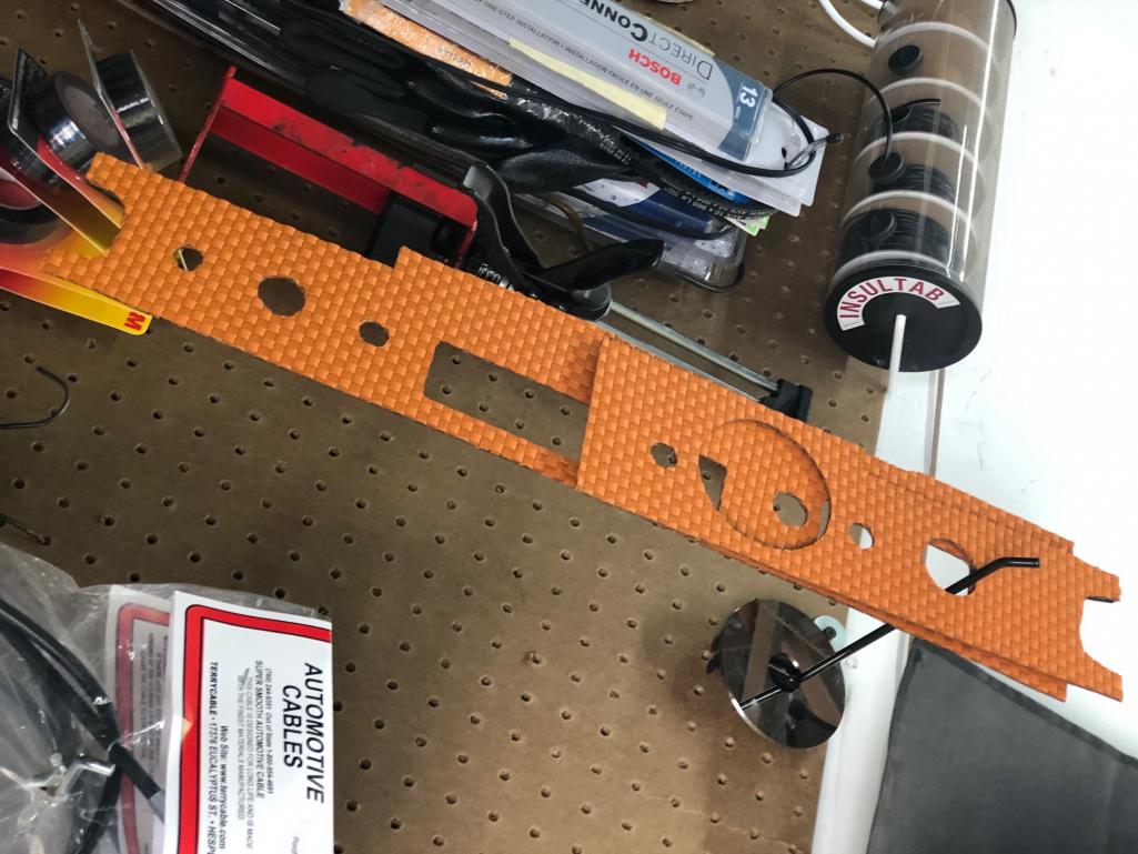

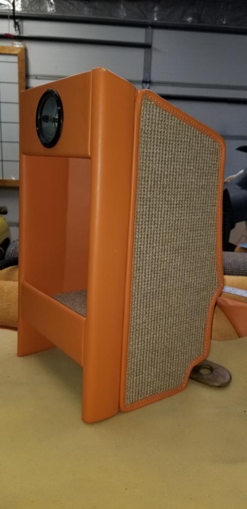

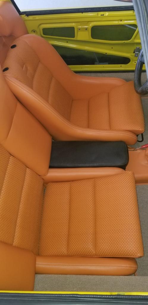

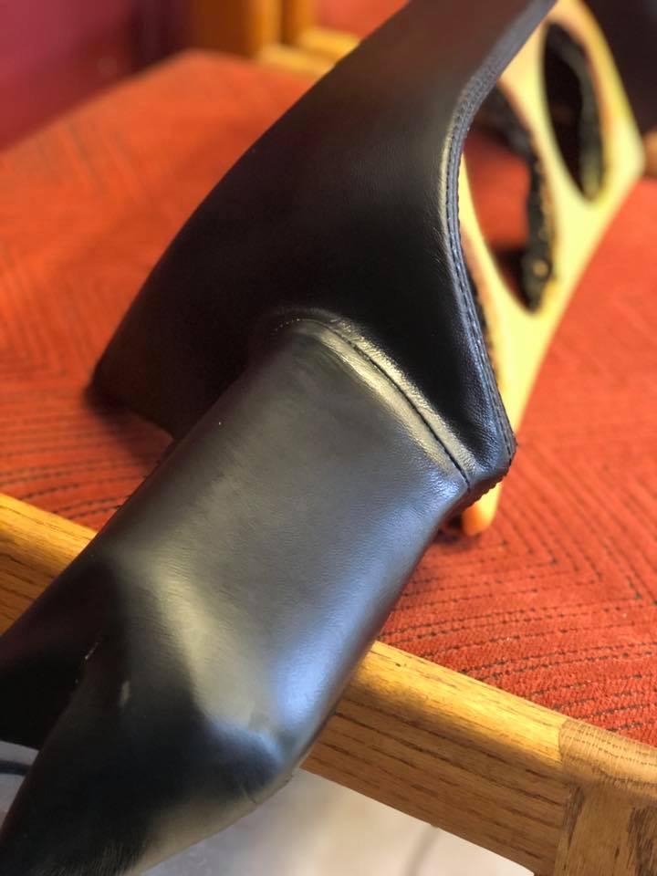

Posted by: burton73 Mar 16 2018, 06:00 PM

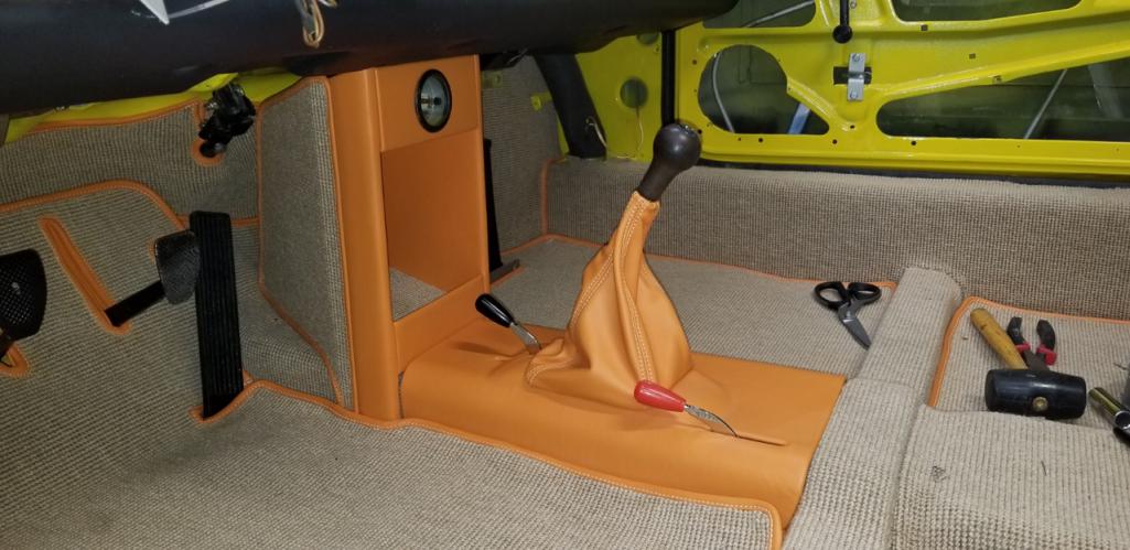

I like the look of the Singer interior in this color. I am getting samples of leather weave.
My car will be one of a kind. Looking for an update from PMB
Bob BAttached Image
Posted by: Cairo94507 Mar 17 2018, 06:38 AM

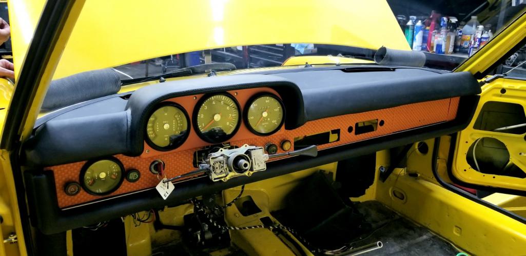

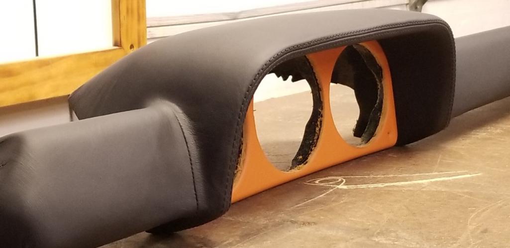

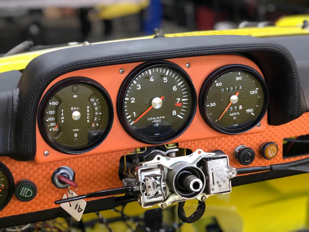

Posted by: burton73 Mar 20 2018, 12:42 PM
Gauges are back from restoration. They look great.
#41 has an oil tank level sender for well, the oil level.
-Picture of before restoration of oil tank. –
Bob B
Attached ImageAttached ImageAttached Image[attachmentid=643
462]Attached Image
Posted by: Larmo63 Mar 20 2018, 01:50 PM
Gauges look sweet. Where is the smaller one going? Are you doing a 911 type dash?
Great build!

Posted by: burton73 Mar 20 2018, 06:16 PM
QUOTE(Larmo63 @ Mar 20 2018, 12:50 PM) *
Great build!
No 5 across cluster on #41 but they do look cool on most cars. The POs put the small gauge on the center area next to the key if I remember right. Cannot find the picture from the 100s of them I have. Going right back there after I get leather weave behind it.
Bob B

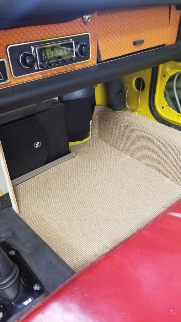

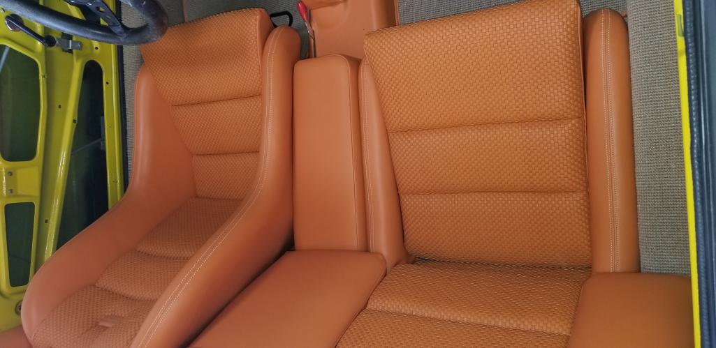

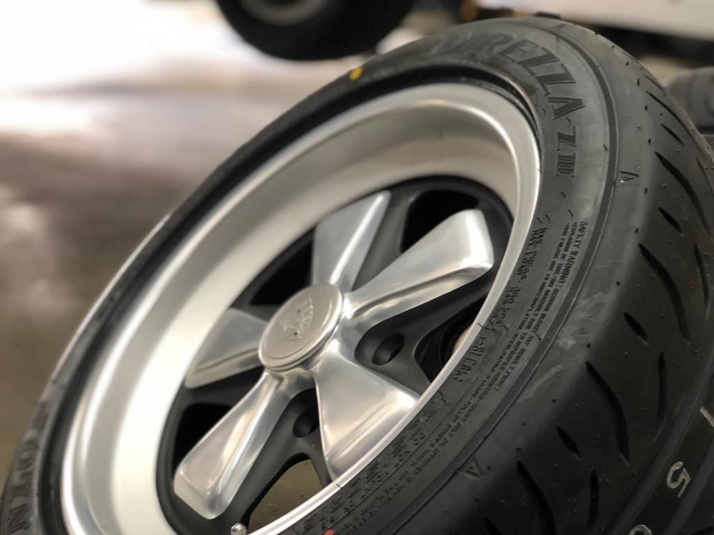

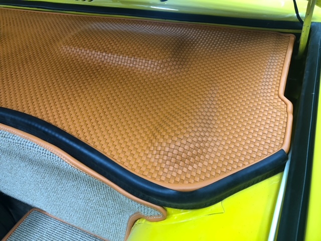

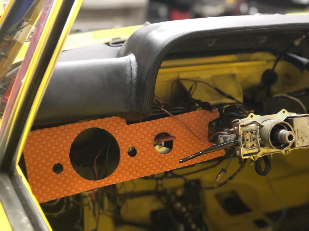

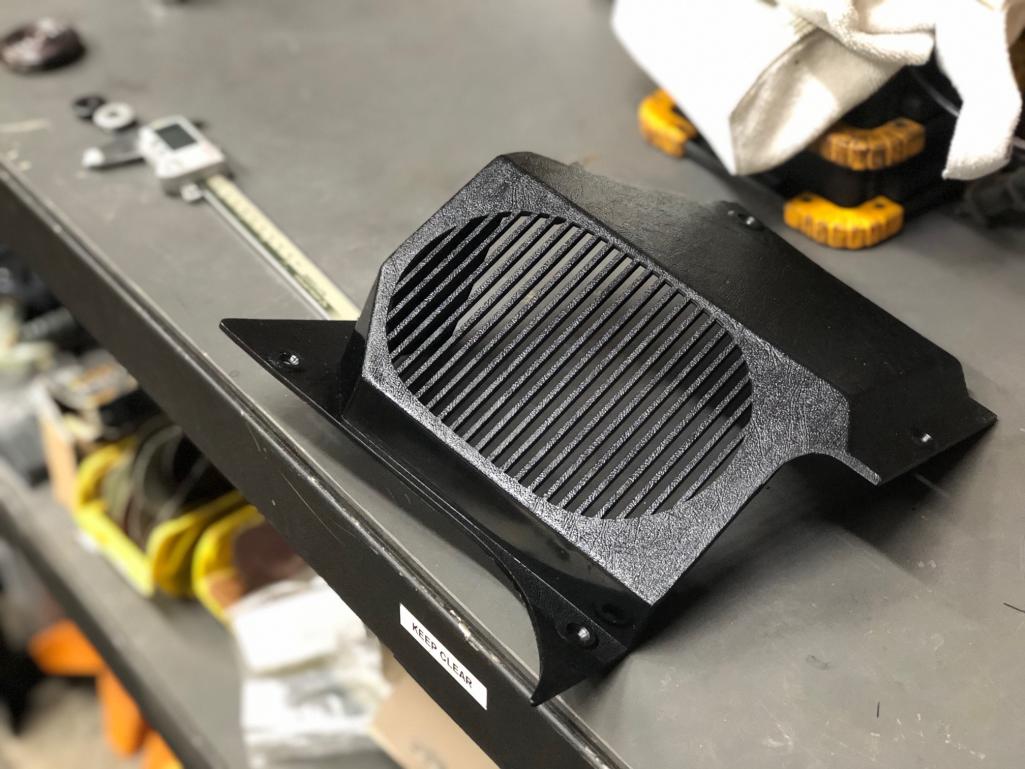

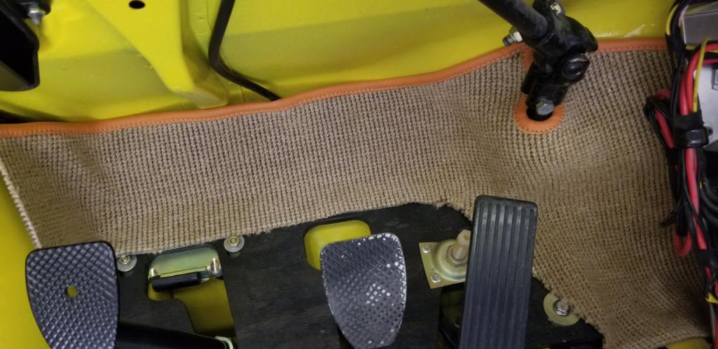

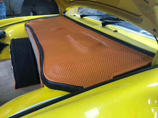

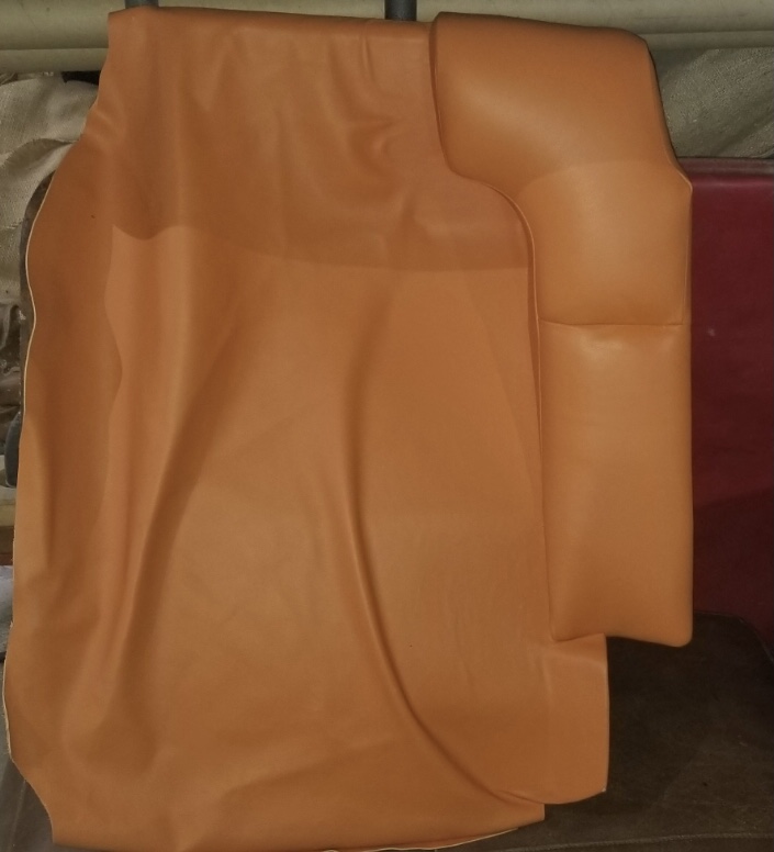

Posted by: burton73 Mar 21 2018, 08:41 AM
Well new tires and wheels. Gone from 16 inch 8s and 9 911part # to 7 and 8s 15in 911 #
Seat has gone from perfect good-looking upholstery to the workshop for widening for my fat ass and then the specialty leather
The studs in the hubs where changed from longer ones that worked with the 7 in BBS that it came to me with, down to a shorter stock length. E says we have a lose stud hole that needs work or change to one new (used) hub.
Each step along the way even with NOS stock parts need a bit of love (money to clean up and rework). NOS Fuel pump had assembly lube that had become funky and needed to be cleaned up along with the contacts. It is each and every part in this car that is getting love to make it like a brand new car. Well almost the wiring is old but in great shape but still needed some love from PMB.
Covered and in a covered environment from 86 on. Made this car a great one to restore.
In the last 12 years we have seen the price of 6s go ape shit. Glade I got #41 then.
Attached Image Attached ImageAttached ImageAttached Image[attachmentid=643
558]Attached Image
Posted by: mepstein Mar 21 2018, 11:47 AM
Looking good Bob. What size tires?
Posted by: burton73 Mar 21 2018, 02:28 PM
Not sure. I told E to get the right tires for me. I see they are Go, Go, Goodrich TA radials. The back wheel does not look much different that the fronts. They looked very different on the floor of my shop. One 6, 2- 7s and 2- 8s
Bob B
Posted by: Tdskip Mar 21 2018, 04:33 PM
Thanks for the update
Posted by: Eric_Shea Mar 22 2018, 09:32 AM
205/60-15
225/60-15

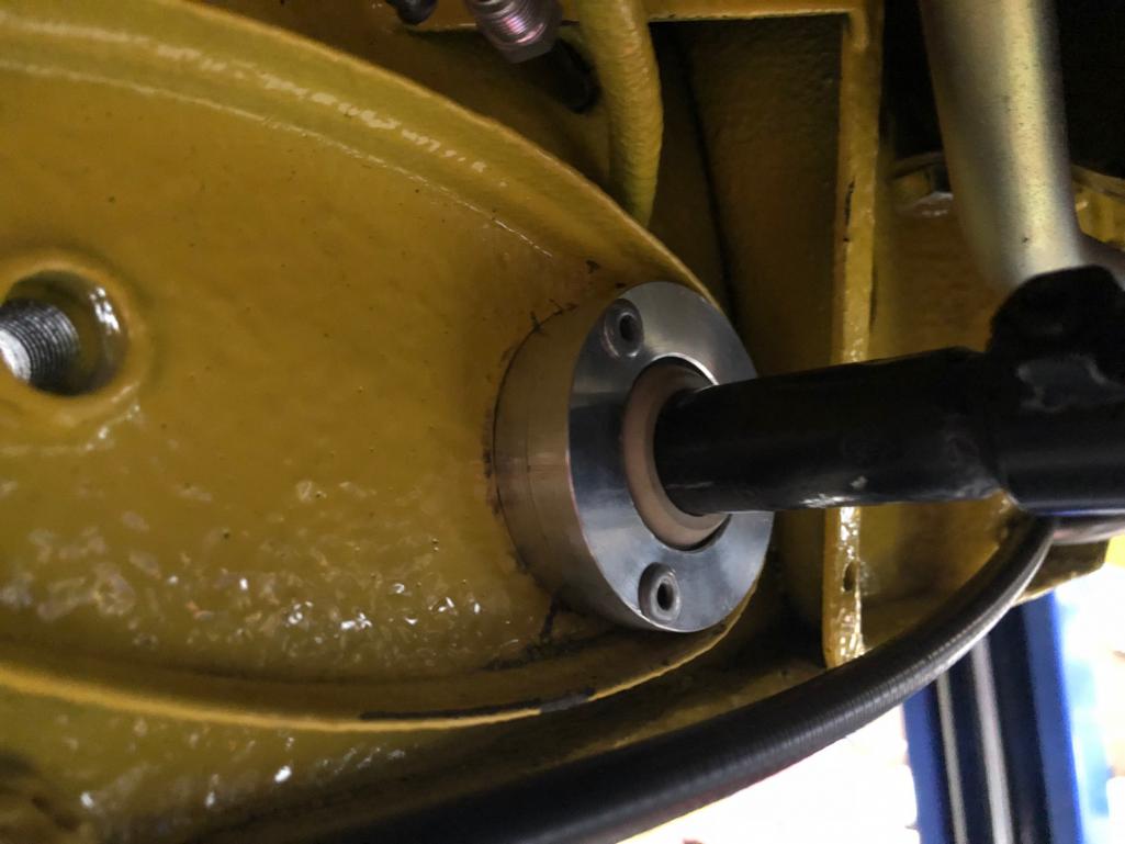

Posted by: burton73 Mar 22 2018, 11:10 AM
QUOTE(Eric_Shea @ Mar 22 2018, 08:32 AM) *
205/60-15
225/60-15
Eric,
Can you post the Facebook posting here on the rear left hub story? It would be fitting for this build thread.
Thanks,
Bob

I had been looking at the BFG TAs...nice sort of period tread pattern too...
any spacers on the wheels or are they just standard 7/8x15s
Posted by: burton73 Mar 22 2018, 06:39 PM
no spacers.
Bob B

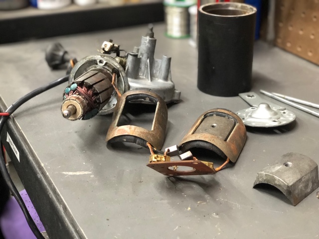

Posted by: burton73 Jul 31 2018, 03:46 PM
Back at it at PMB. E is looking for bushings for the headlights that are new. There was a member that had them several years ago when there were guys doing the hand flip up headlight kits. We cannot seem to find him or them. Any help would make us happy.
To say that I am itchy to get my car is an understatement.

Well moving along with #41. Headlights are LED. E will find some sticky tires for my fresh RS finished 7in and 8in 16inch and we are looking for a buyer for 15” 7 and 8 fresh polished finish plus the 15 x 6 spare with same polished finish.
Bumpers are ready to go on and I am hearing talk of starting the Eng. Up. Interior up next. Getting cork leather weave for centers of seats and center of dash. Leather all over.
(Singer like) More pictures coming!!

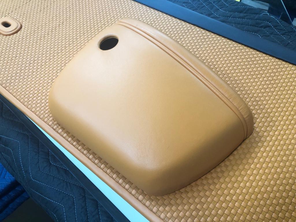

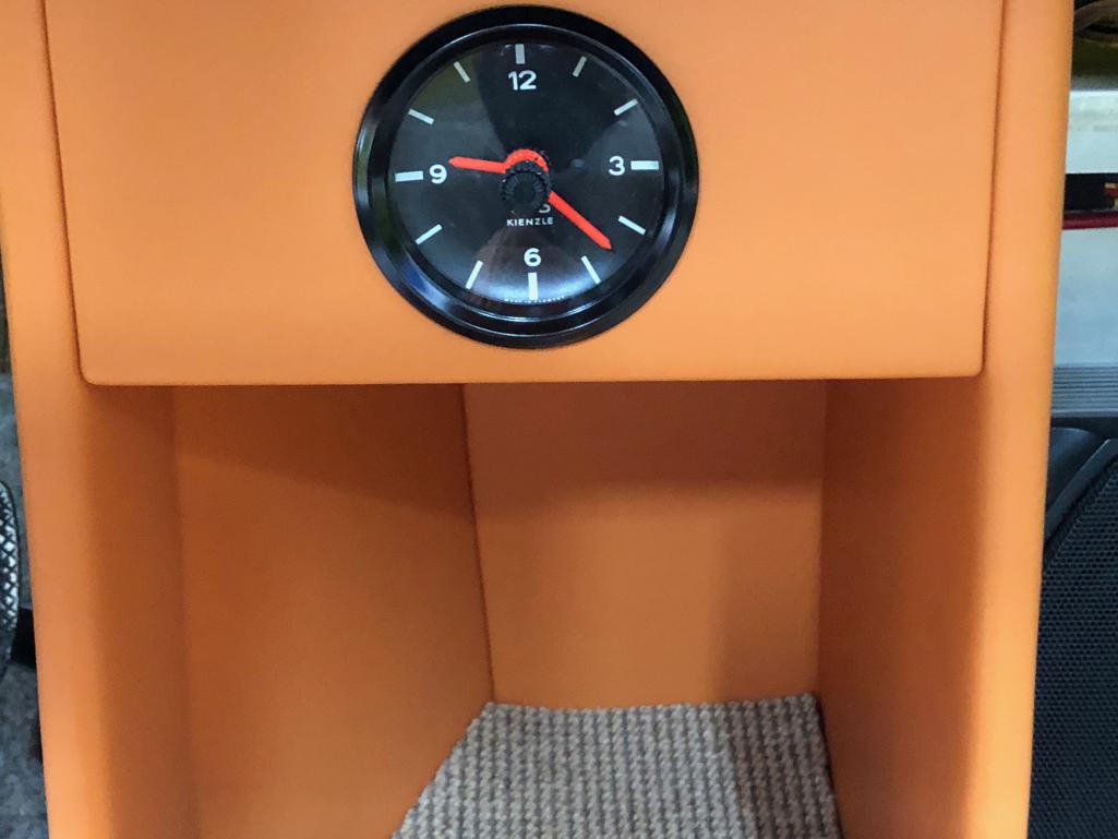

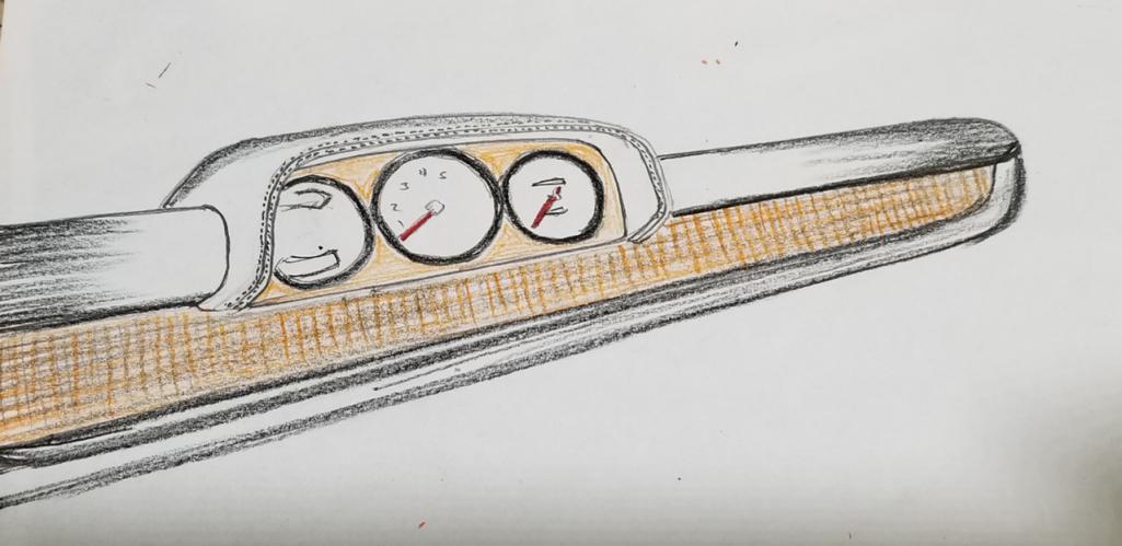

Posted by: burton73 Sep 15 2018, 09:33 PM
I went over this with Eric and his superb interior man on facetime this week as what we are going to do with the interior soon. Looked over the samples of the basket weave leather like they use on Singer cars. Just for the custom basket weave materials for the car I have to buy enough to do 2 cars the way I want. That is around $3,500. Just for that part plus all the rest of the leather material. I love the look of this color combo. Black leather plus the orange/tan weave I believe this will be killer look. We will do #41 with the Scheel Sport seat that was in the car plus we will also do the factory driver seat that came in the car from the factory just in case I do not like the Scheel Sport seat for everyday driving. Not that this car will get any daily driving. A very special 30th car not the way it came down the line in 1969
With the extra weave I think I will do the centers of the Speedster replica that I am envisioning
In my favorite blue exterior color with the tan/orange leather interior. This picture I believe is of a Real Speedster.
That is the color that I wanted to paint #41 but all of you talked me out of that. Got to have a metallic Blue VW/Porsche
Getting closer.
Bob B

Posted by: burton73 Oct 10 2018, 12:58 PM
More pictures from E today.
Bob B

Hoped up oil cooling coming in now. It is all happening. Lots of details
Bob B

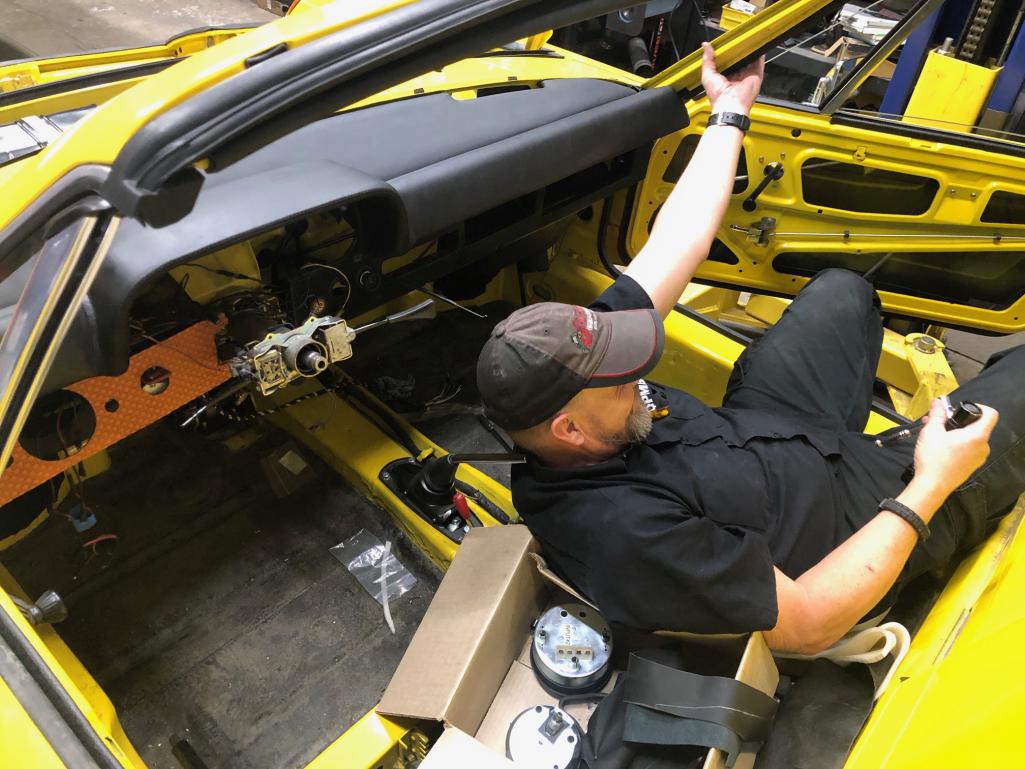

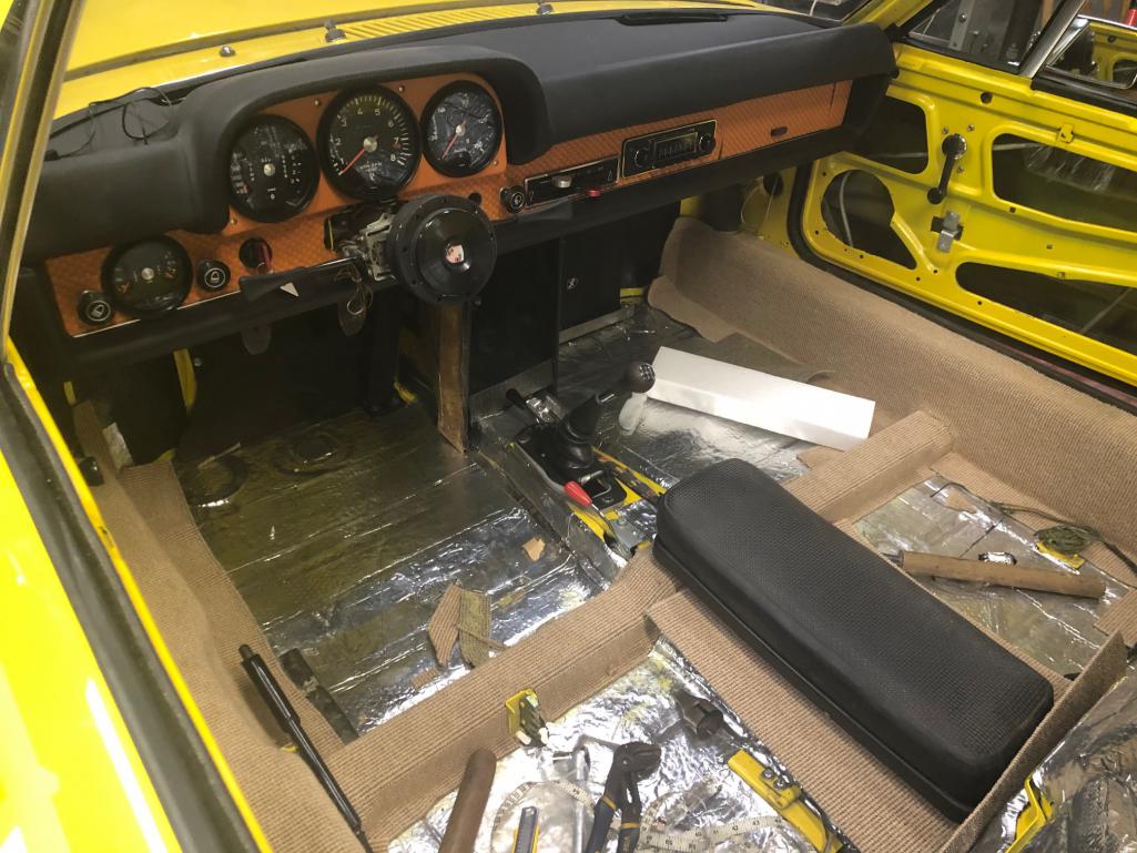

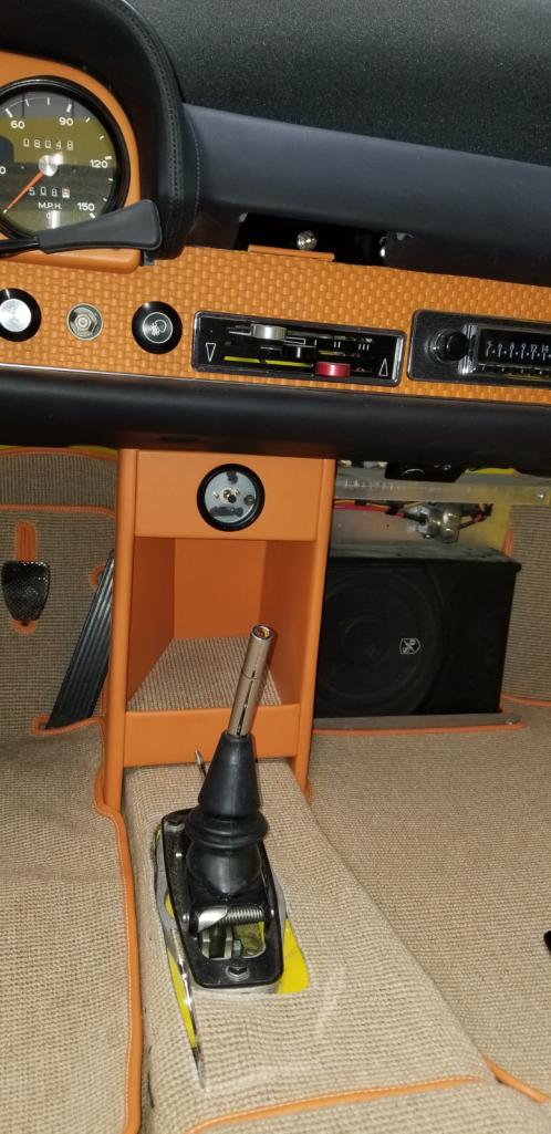

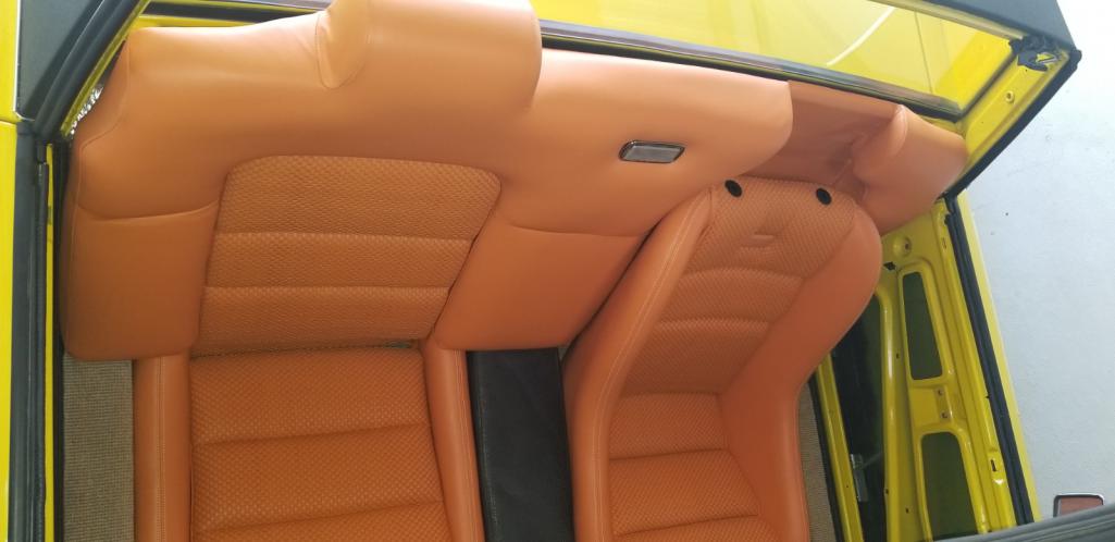

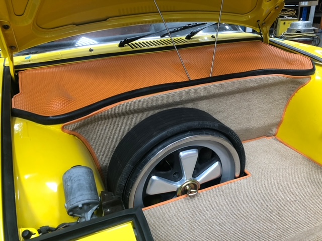

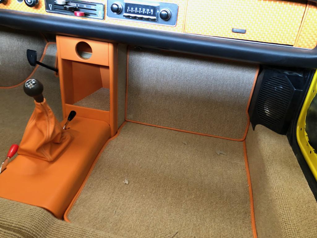

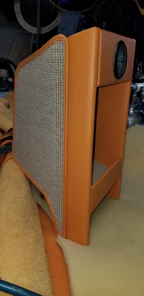

Posted by: burton73 Nov 28 2018, 01:46 PM
Well moving on with 41. PMB is finishing under the dash and putting in the windows.
Note the steering wheel on there now is a La Carrera and will get a 914-6 double wrapped leather with real early Hocky Puck that I bought 10 years ago. Note that the center support under cowl is cad plated as the 1st 50 cars where.
I have spent a bit of time going over the Singer inspired interior. With Dale, PMBs master interior man and I have gone over the materials for the interior. German Tan Basket weave for the carpets and headliner and trunks. lots of tan/Orangeesh leather in two tone weave for seats centers and door panels and center of dash, and Black leather for dash and trims. Leather everywhere vinyl was from factory. Insulation mat in the interior. Materials coming from Italy and the weave from the company that does Singers cars. $9,600. Just for the materials for the interior.
I am doing the Scheel modified seat plus the stock seat in this material just in case I do not like the feel of the Scheel seat. Passenger seat is same treatment on no moving seat that came with the car. Leather all over the back area of the interior that was Leatherette (Vinyl).
Will update here as it is happening. Custom basket weave is 10 weeks off from now.
Bob Burton / Bob B
Attached Image Attached ImageAttached ImageAttached Image[attachmentid=676
712]Attached Image

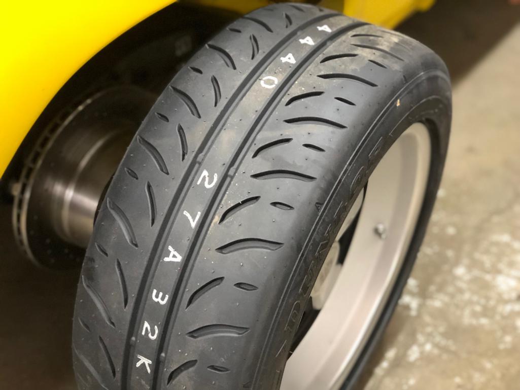

Posted by: burton73 Dec 2 2018, 10:33 AM
Sorry it took so long for me to post the size of the new tires that Eric picked out for my 16s. I think they look very good.
Size and brand.
Misc.
225/50R-16 DUNLOP DIREZZA ZIII SL
Misc.
205/50R-16 DUNLOP DIREZZA ZIII SL

Posted by: burton73 Dec 7 2018, 07:55 PM

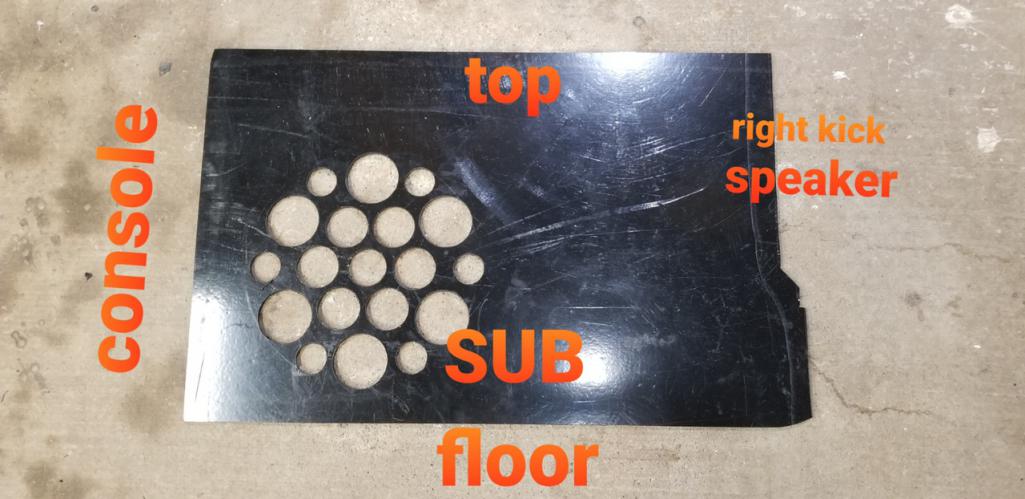

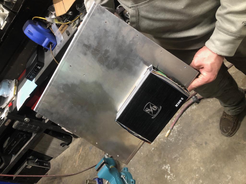

We are really moving on. But I have not been able to get to PMB in person yet. Second set of samples on Leather and carpet. Dale is working very closely with us on the art of the interior.
We all seem to be on the same page. Pictures are flowing
Bob B
Posted by: burton73 Dec 10 2018, 12:29 PM
Screen is in and painted for GT front oil cooling.
Bob BAttached Image

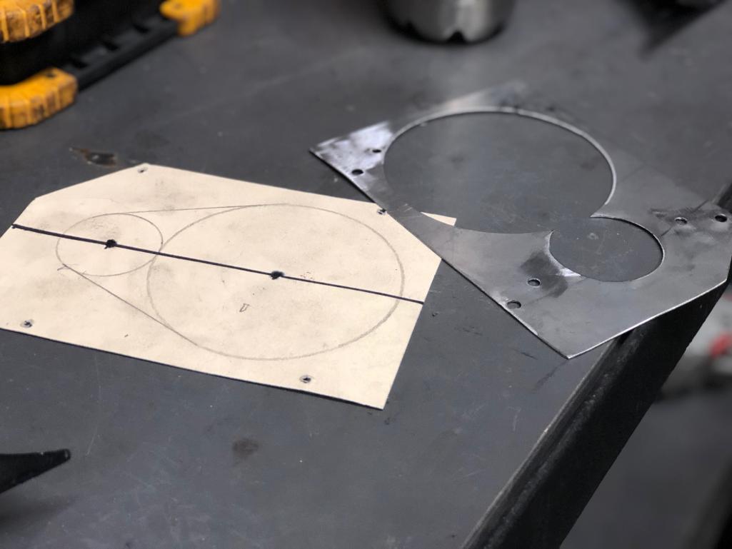

Posted by: burton73 Dec 10 2018, 04:36 PM

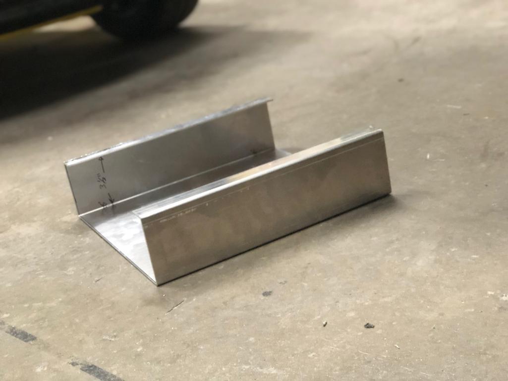

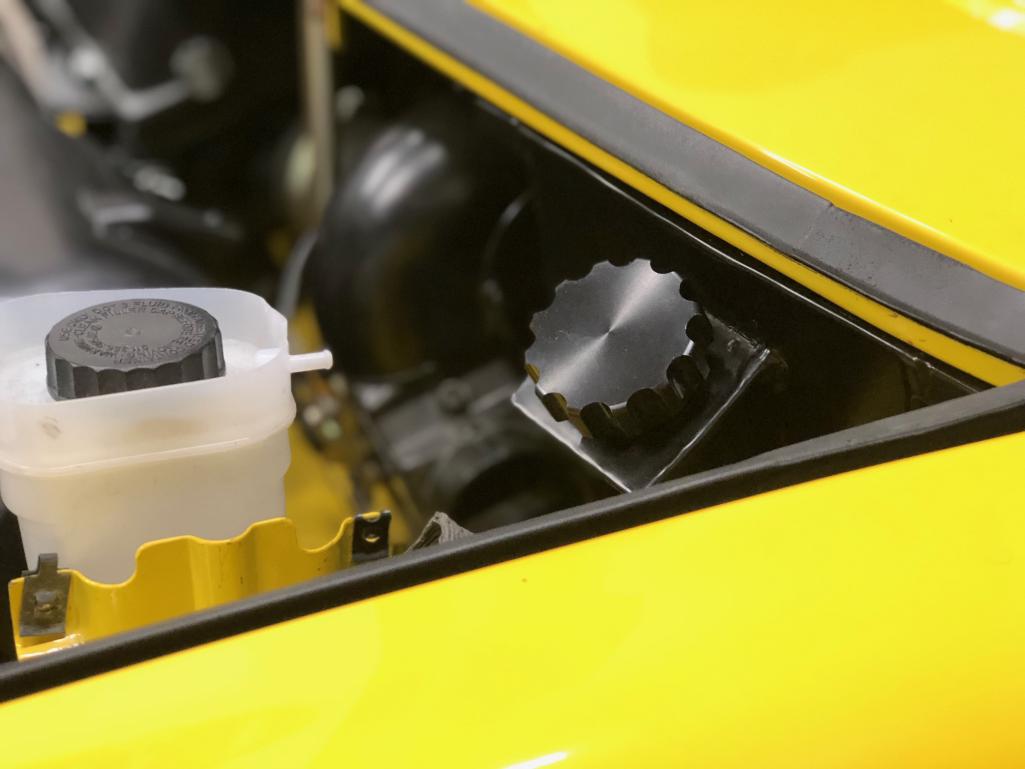

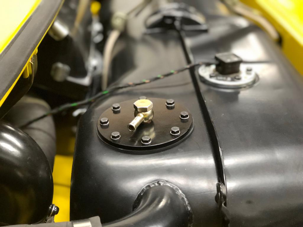

Because of the custom cowl fuel filler unique to number 41, we needed a Custom Washer Fluid Tank that matches the fuel filler on the opposite side. There was no place for a standard water bottle so PMB designed this set up. Keeping it all as clean as could possibly be.
Keeping as true to the build of this special early hot rod 6 car back in the late 70s
There was no windshield water bottle thought of back then by the builders of Hot Rod #41 but PMB felt we needed a washer bottle that matched the current set up with a balanced look under the front hood. This works well.
Bob B

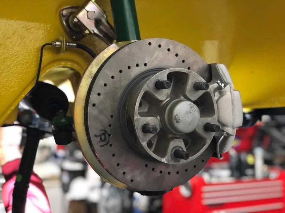

Posted by: burton73 Dec 12 2018, 01:54 PM
Goodies off to PMB. Rebel Racing fully adjustable rears springs perches I bought for my new Brillstein shocks for my V8 car but #41 will be done much sooner than the 74 so we will put these on so we get 100% adjustment in back as we have up front.
My remanufactured Blaupunkt radio I bought 10 years ago on EBay.
My artsy shot with Lucite I make, not going to E.
Bob B

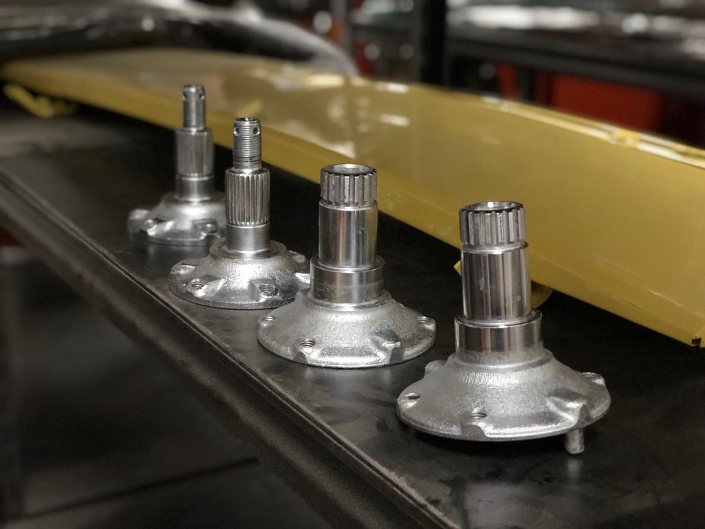

I up date as PMB sends photos. E says, thumbs up to 108MM on CV stubs. 3.0 with 3.2 big valve heads 46 PMO's special can grind and engine work done by Scott Kinder.
Bob B
Posted by: burton73 Dec 13 2018, 12:55 PM

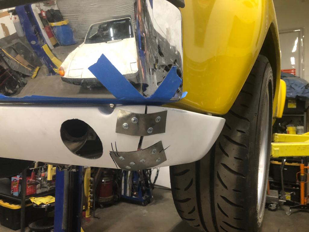

Custom washer fluid bottle done and in place, Vent that was needed for cowl fill, and welded fuel tube that was done by Peter Dawes many moons ago. Only on this car. Super early 911-S front brakes. We keep on moving forward.
Bob Burton

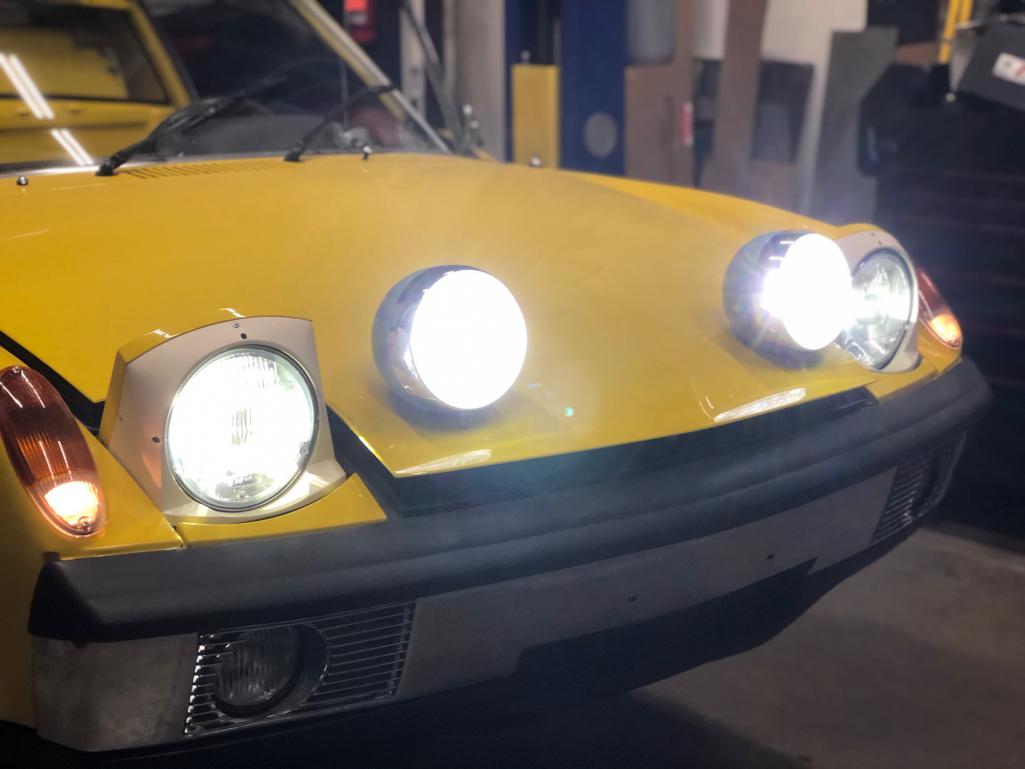

Posted by: burton73 Dec 13 2018, 05:46 PM
More: wub.gif

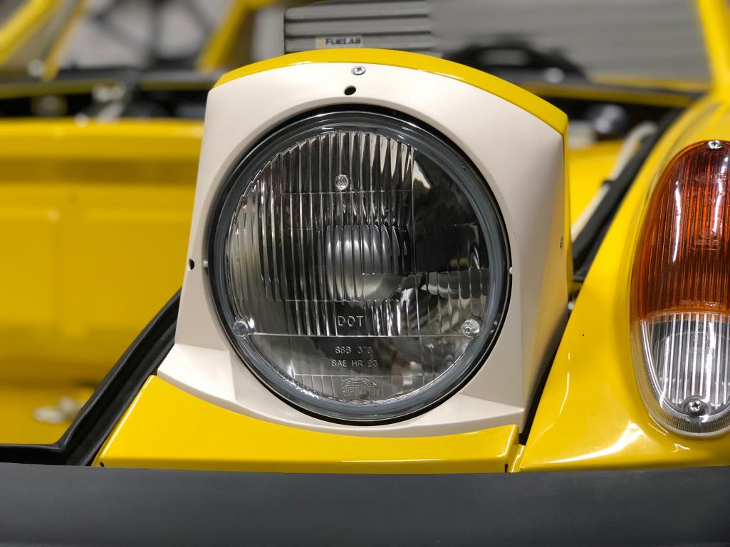

The white headlight surrounds are one of those things I didn't care for back when I purchased my first 914 and now I love them.
Posted by: altitude411 Dec 14 2018, 07:34 AM
QUOTE(mepstein @ Dec 13 2018, 09:00 PM) *
Wow those surrounds look awesome. NOS? or just fantastic work by PMB? Thanks for posting these photos ... One of my favorite threads. Great photography. beerchug.gif
Posted by: burton73 Dec 14 2018, 10:01 AM
QUOTE(altitude411 @ Dec 14 2018, 05:34 AM) *
PMB is the master of refinishing the headlight surrounds and parts as well. As far as the pictures go, Eric is a very good photographer as you can see. Rumor is the lights in PMB are LED? That is why the pictures look so good. Great eye on Eric, great composition and great subject.
Bob Burton

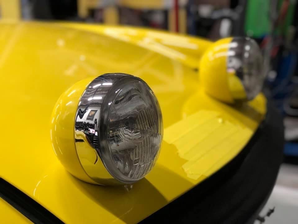

Posted by: burton73 Dec 14 2018, 06:42 PM
One more for the weekend. Front hood mounted today. It’s a car!! That Canary yellow looks great!

OK, that is a clean shroud.

The Leather Weave and leathers, Black, Orangish Leather and German weave carpet from (Italy) Why not German Carpet from Germany? Are in
We are moving forward.
Bob B
Posted by: burton73 Apr 2 2019, 02:50 PM
It has been a while since an update. Eric sent me there pictures today. The note was “It runs today or tomorrow. Depends on how much daylight we have”
I loved to hear that after 5 years. Next is to hear the sound! This car has not been run since 1985 Many moons have come and gone!
Bob Burton

What type of lines and fittings are those?

From what the PO was told, the early work on this car was done by Peter Dawes when he was at Dick Trotman’s shop in the 70s. What was on the car back then was braided Stainless lines and AN fitting for the front oil cooler and Troutman thermostat. I had thought we may change to Elephant oil lines but Eric has given my guidance on how to restore the car in the spirit of a super early 1969 delivered hot rod 914-6 back in the day. I listen to him on almost every point.
This is a Southern Cal hot rod VW back from the days when I was in High School. By the way my 1st wife had a yellow 70 914-4 back then that she could not figure how to drive. My in-laws got her a new VW Bug with auto stick.

Friday news from PMB Performance. We had some electrical problems. It was a short in the wiper motor. It had had to come back out. E says the starter is open and one of the brushes has 400 Ohms resistance and it kept blowing fuses every time they plugged in the battery. A rare 1969 911 only motor.
I said a close out to a busy week. Time for an adult beverage Sandy, Utah style
On to next week.
Bob Burton
100 steps forward and 1 step back
Posted by: burton73 Apr 22 2019, 12:47 PM
We were held up by a couple of things. One was the bracket to attach the CDI box and Eric had to find a one year only 69 911 wiper motor to use the winding so we have savaged the
electrical parts needed give life back in to my 6s wipers and let us move on to the next detail.
Lots of details on a car to truly be rebuilt/restored. I am sure most cars never come back to this level of restoration. Most are just made to look good for a sale.
Bob Burton

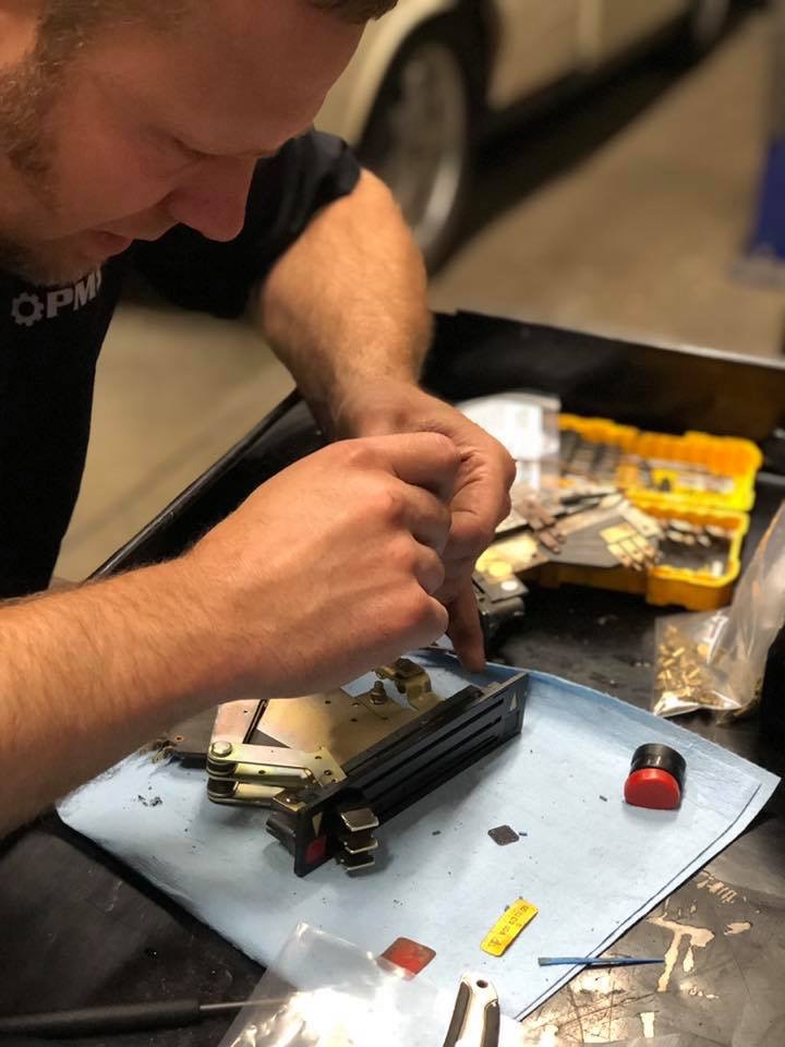

LED head lights and Fresh Air Control restoration. Going with LEDs in the Cibie Pallas Citroen hood Rally lights.
Bob B

Posted by: burton73 Jul 29 2019, 08:46 PM
Eric@PMB sent me a text today with this message:
Custom 914-6 Oil Tank with level sender and inner fender well heat shielding added to protect it.
7-29-19 We are ready to go to Dales to start the custom interior for #41. We have all materials in hand. Singer and 916 inspired as everything will be covered in super over the top, Leather. I firggin love Leather.
Bob B
[attachmentid=706649] Attached Image

Going to post the pieces of the all leather interior as it is going in. Today this is just hanging around.
Bob B

Filling in the ashtray. Drawings of some interior parts from Dale
Bob B

More pictures of custom dash by Dale Hancock – 1st thing is super soft Pussy Leather. My wife looked at me and said why do you call the leather that?
Anyway, Dale went with an ash tray delete and put some LED lights there to throw light under the dash and floor when I flip on the early 911 rear center pad light.
Contrasting color leather behind the instrument cluster. I like the way it is coming along. Love the stitching work on the dash. I told Dale what I was looking for and he did it.
Bob B
wub.gif Attached Image Attached ImageAttached ImageAttached Image[attachmentid=714

Everything is going to be covered in leather. Black or Tan or 2 tone Tan weave. If the factory offered a full leather package #41 would have been it.
Bob B

Posted by: burton73 Oct 16 2019, 11:55 AM
Some more of the dash. We will do something trick for the knobs.
Bob B
The oil level gauge and sender is something special that the speedshop did when this car had a change up to a 69s engen in the early 70s

Glass is in and Dale is working on the leather for all trim!
Bob BAttached Image Attached ImageAttached Image
Posted by: burton73 Oct 30 2019, 08:05 PM
Under dash in leather, installed. Glove box door with special welting and leather weave, installed.
Very happy with the interior work that Dale Hancock has been doing.
Bob B

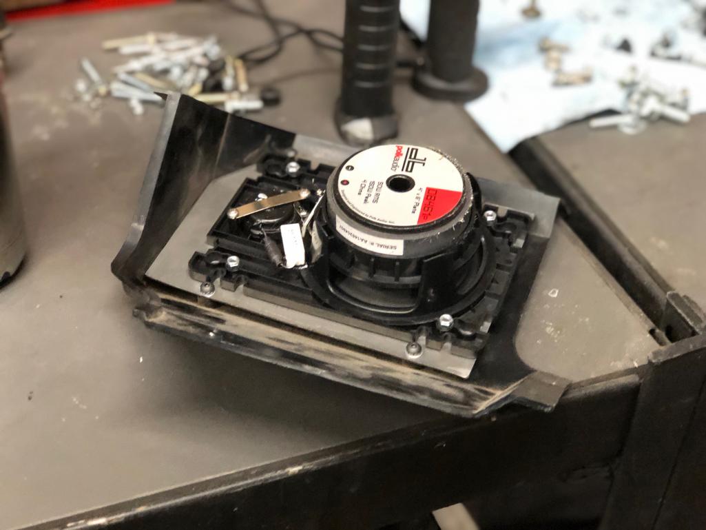

Posted by: burton73 Dec 5 2019, 02:10 PM

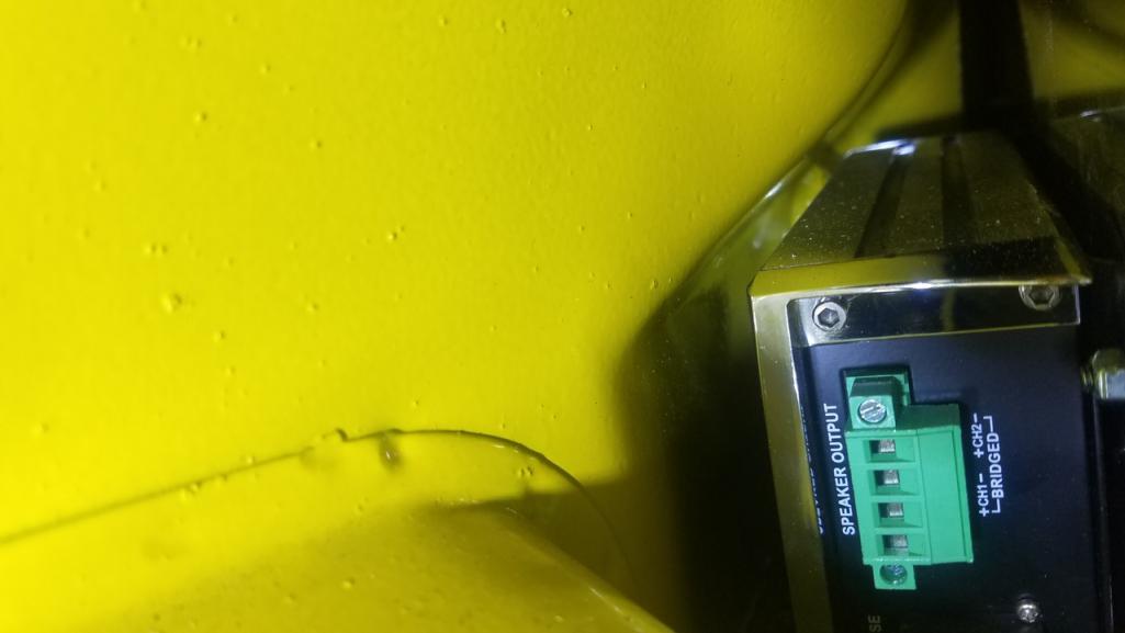

PMB getting the speakers mounted and cleaning up my original grills.

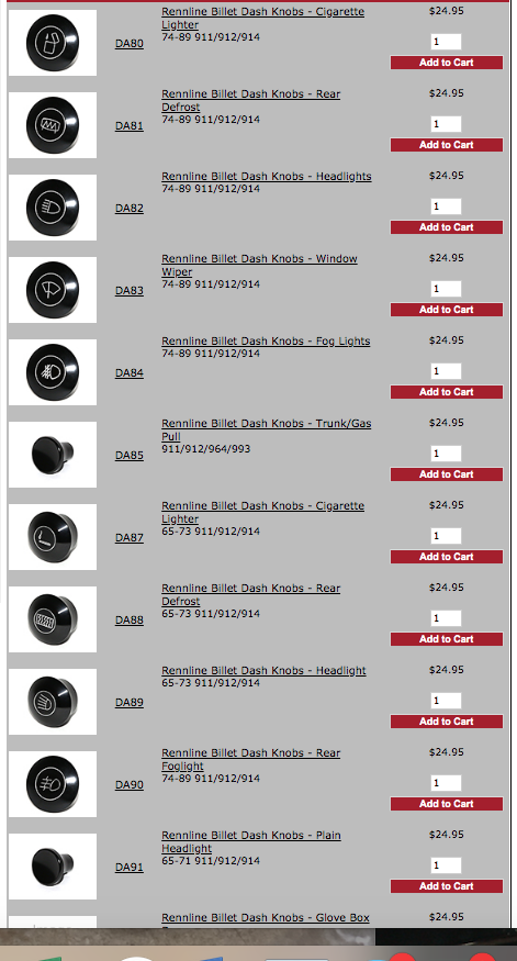

Fancy knobs for Front lights, fog lights, and Cibie frogs like Oscar has. Plus, they are making up an Emergency flasher knob.
The speakers are Polk Audio brand and that reminds me of a song I used to sing…
