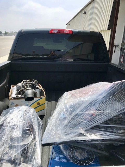

OK, it took a serious effort but Scotty, my brother and I got my Six into the back of the 26' truck.

Wow. That's quite a trek to Virginia to pick up an unfinished project. Were you able to get all your stuff back? I hope things go better for you with Kent. From personal experience I believe they will. Good luck!
Hey Jim - Yeah, about 2,400 miles from Scotty's to Kent's. I got almost everything, missing a dip stick, some cad-plated parts and maybe a couple other things. Scotty will be shipping that stuff once I get a chance to do a full inventory and get him a list. The trip was uneventful (fortunately) and pretty much nothing happened to the car or the parts during transport. Trying to catch up after being gone for 5 days. Cheers- Michael

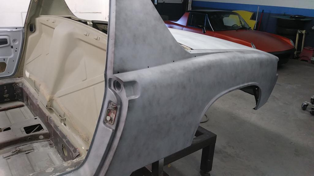

I got my first peek last night and we have our work cut out for us as with any resto!!! Looking forward to this one and getting you that gold star Michael

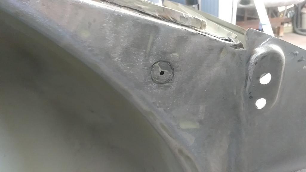

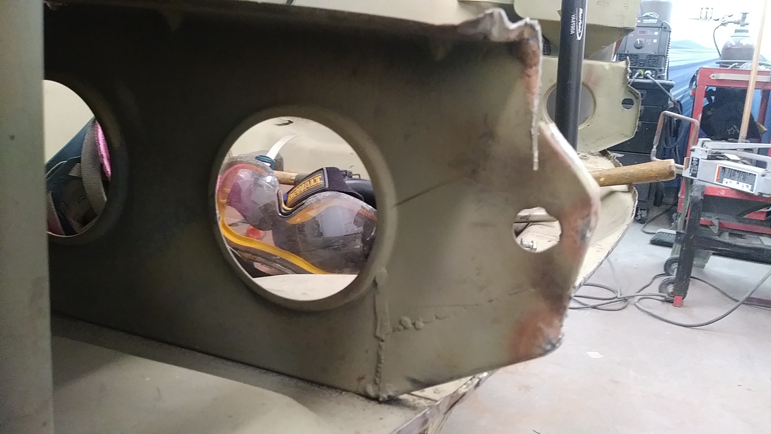

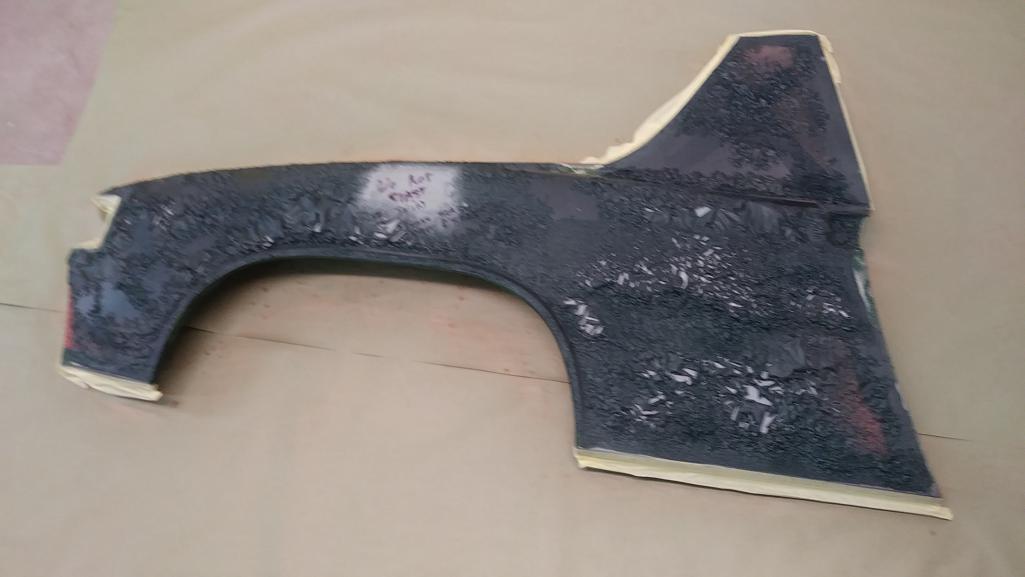

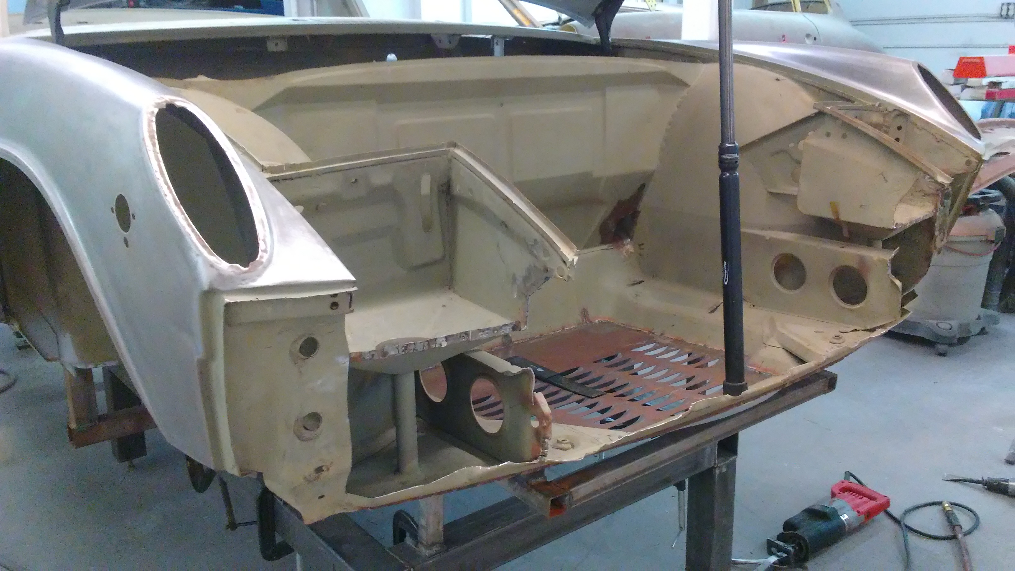

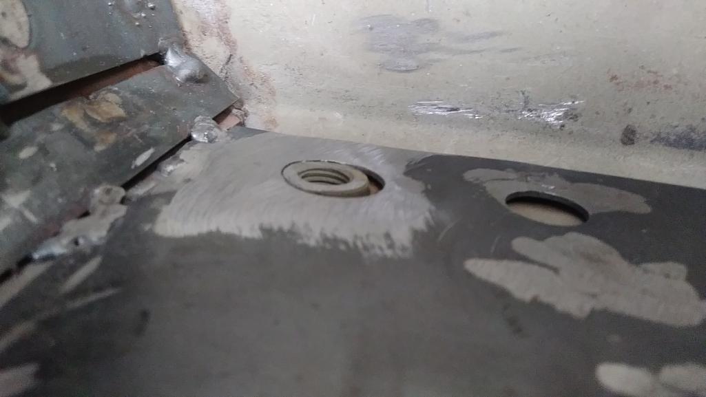

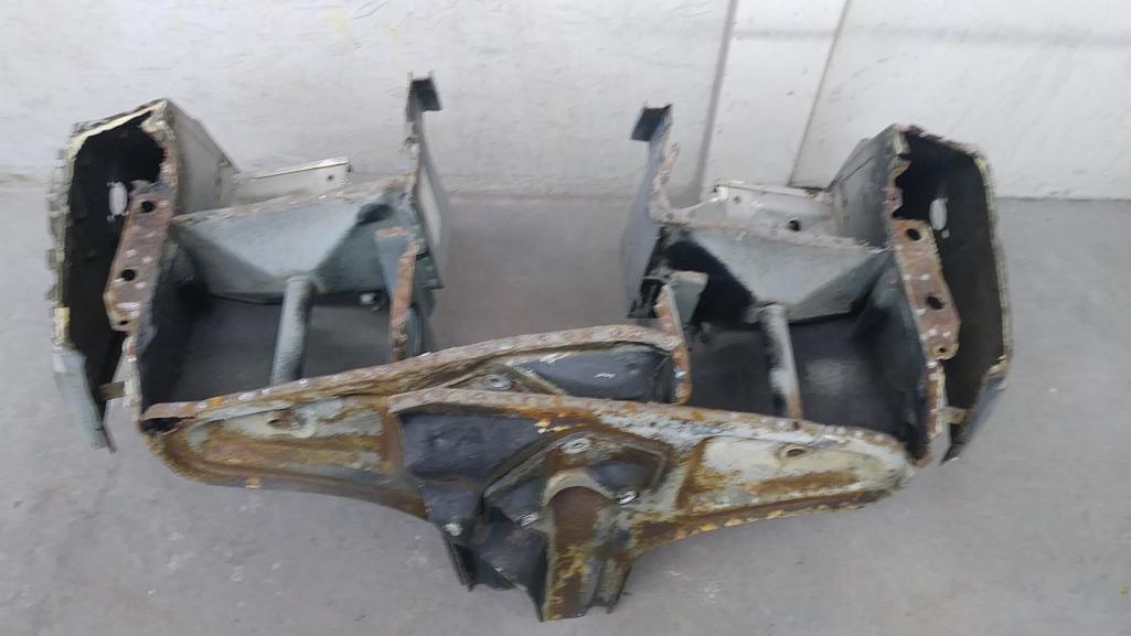

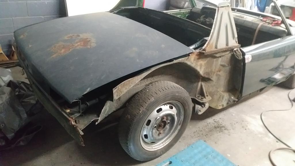

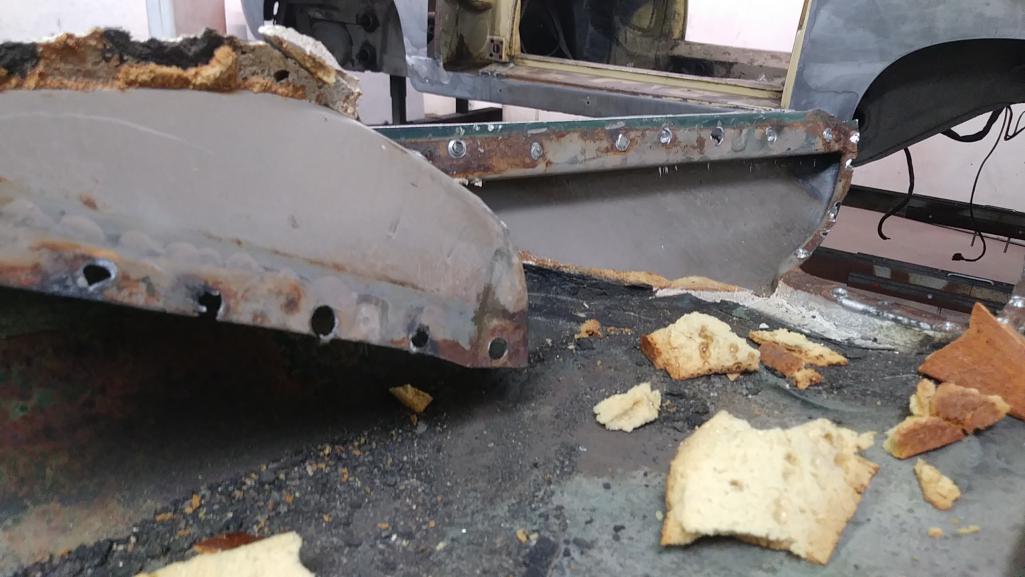

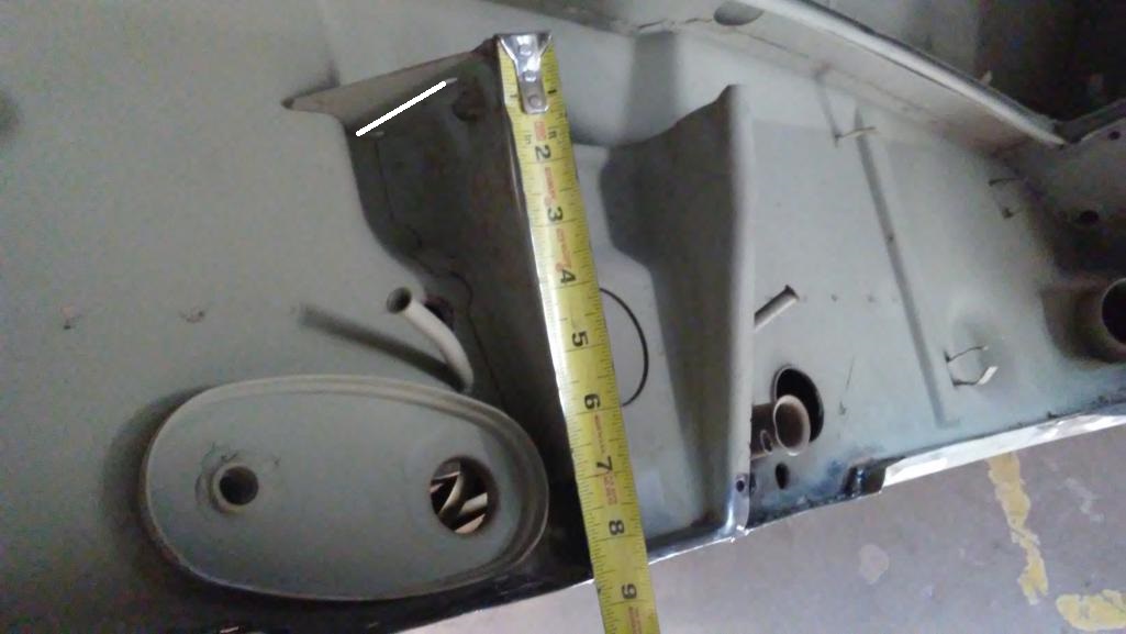

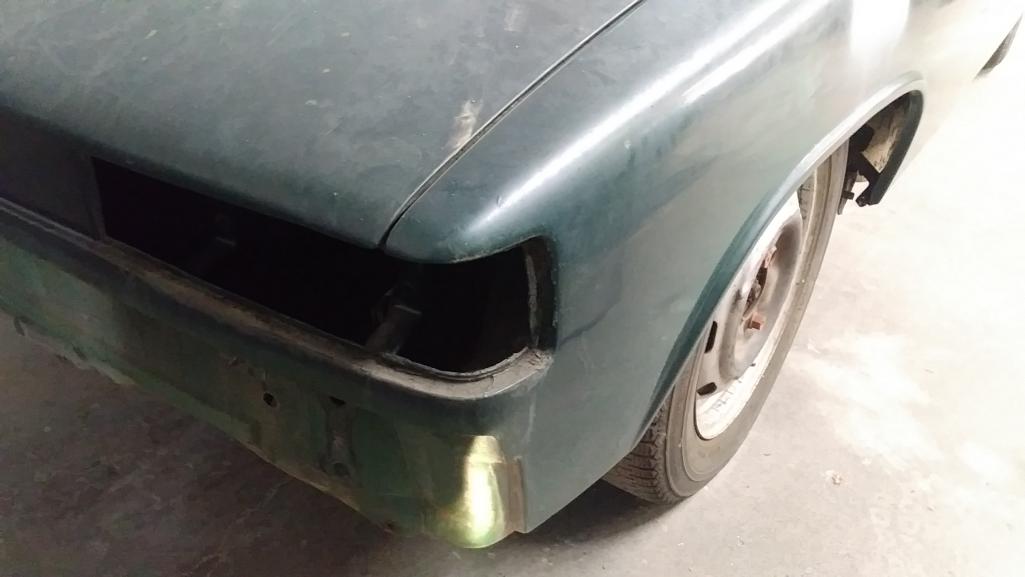

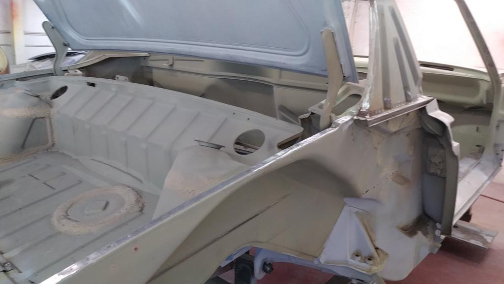

I received some photos taken by Andy when he visited my car (thank you very much). These are closer, focused images, of the work. As Andy said, this is going to be a lot more work than I had hoped for. I think I need a
On the bright side, my car is in California now.
Does this mean there is room for me now ?
Oh no.. That's not what I was hoping to see..
Well, it is what it is. Kent will be the judge of the quality of the work.
Michael - I'm glad your moving forward.
The light is showing off everything. You have to decide just how much you want to spend to primo out your car. If you want a show car body on it could cost you a lot of money. At least you are going with a light color that will hide some of the problems.
My 6 had what I think was a superb body with basically no rust and it still cost $20,000 to get to a show quality paint job from a point after new floors where welded in.
Bob B
Thanks Cal - I appreciate that. I am hoping this is the worst of it.
That is not good.... makes me sick to my stomach , actually.
Man, this is going to be lots of anxiety until Kent identifies and addresses all of the problems. I had hoped those days were in the rear view mirror after all of the work I had done.

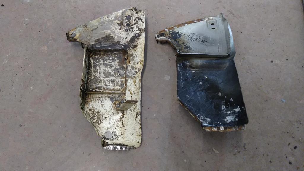

Wow...... so let me step in to address a couple things here
Michael. I NEVER told you there were only 8-10 hours of metal work left. What I told you was that you had a credit on the books and I guessed ( I don't keep my Quickbooks data in my head ) that it was 8-10 hours of work I owed you and I needed to check on that. What I recall telling you as far as the metal work is that there was a week or two left on the metal work. The repairs to your drivers door alone that need to be done are close to that 8-10 hour mark, not to mention the other work it still needs.
Per the front end mess----- You and I had a very frank phone call over a year ago about this very situation. It was to stay between you and I, but now that these pics are being posted with no explanation I need to refresh your memory and let the cat out of the bag......... As I told you in that phone call, I had an employee that I let work on your car while I was trying to deal with my personal issues. IIRC I had the front end and rear cut off, I believe I had the trunk fitted and asked him if he could finish fitting, and weld it all together. He assured me he could. Once he was done and I looked it over, I realized that I had made a major mistake having him work on it. I told you ALL of this on the phone, I told you I was going to have to re-do what he did as soon as I was back on my feet, and that is where that was left. I had been spending time ( as little as it was ) when I had a few hours trying to iron out his mess. For this I have explained and apologized to you repeatedly. I COMPLETELY understand where you were with the project and wanting it done, but I can assure you had I finished it, it would NOT have been finalized in that condition.
Per the mess on the roll bar------ THAT was on the car when I first stripped it. It was an old repair that had not been dealt with and I am fairly certain I even posted pics of that very spot in the initial thread along with some of the other messes I uncovered. This car was taken out of my shop in partial condition on very short notice so no, I didn't finish things I had started on and am quite disheartened to find out from other friends and customers this morning that I was being thrown under the bus. There was, and is a lot left to be done. I in no way indicated I was done with any single aspect of this job. There are cuts left to be welded, welds left to be finished, hammer and dollying left to be done, panels need to be fitted etc.

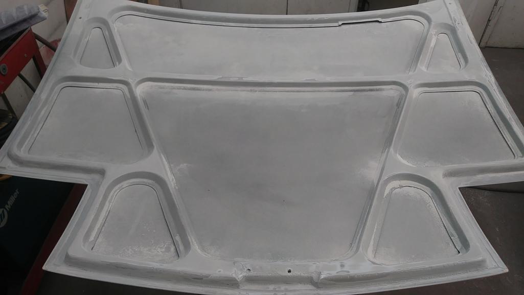

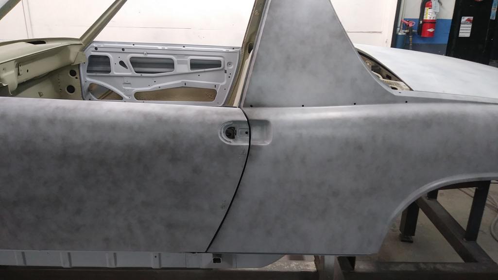

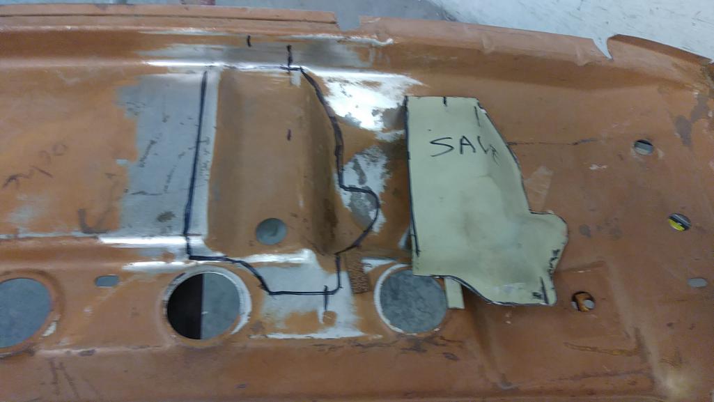

Picked out a couple of doors I had upstairs and fit them to the car. I'll chemical strip the face/skin on these then send them out for media blasting of the inside and the shell this week along with some other parts.

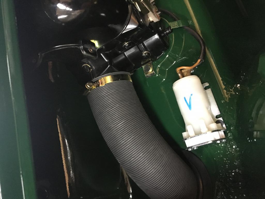

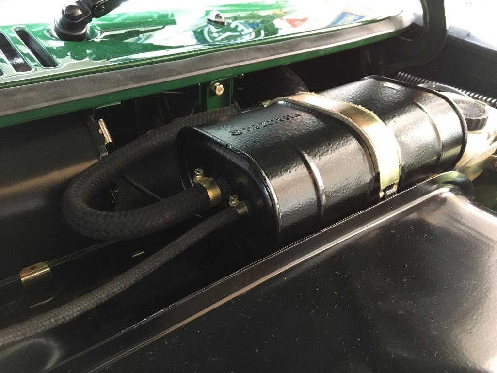

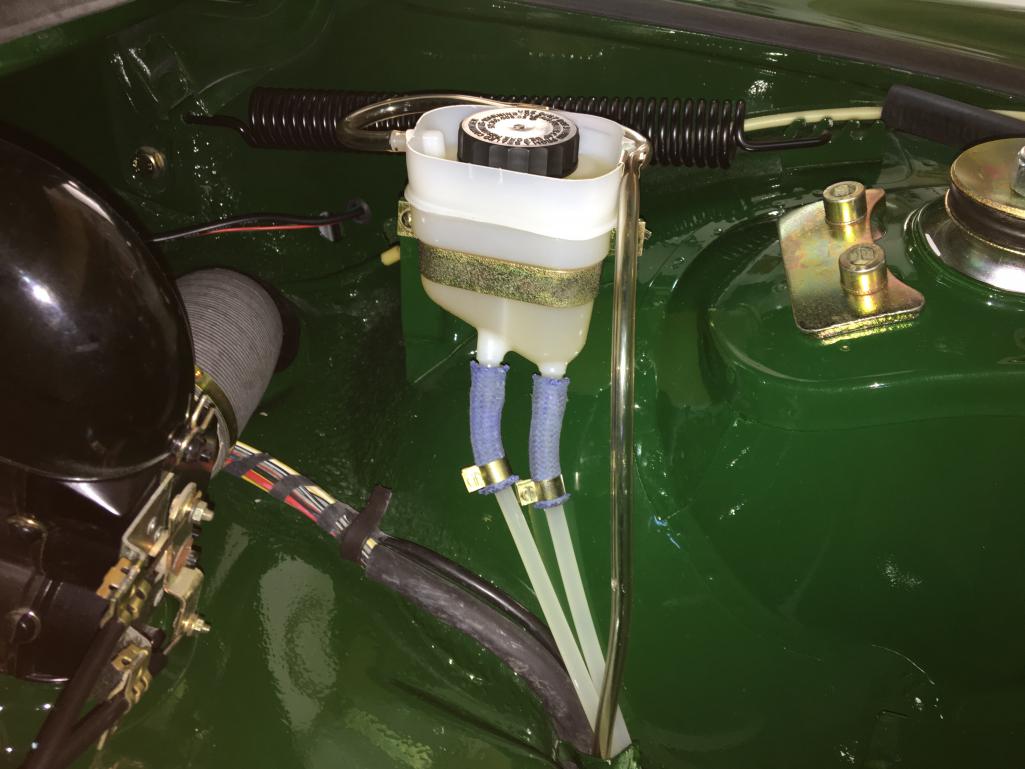

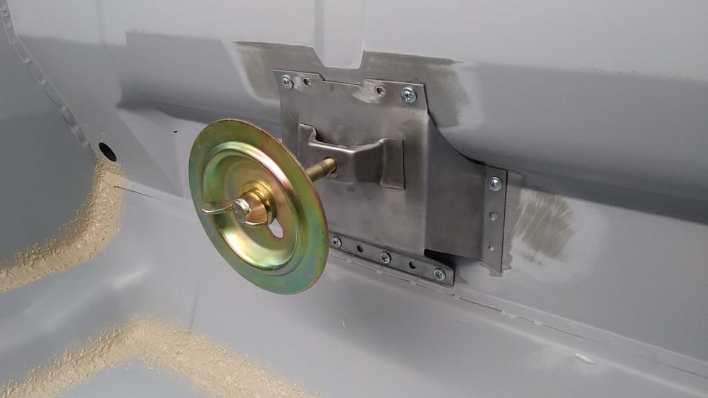

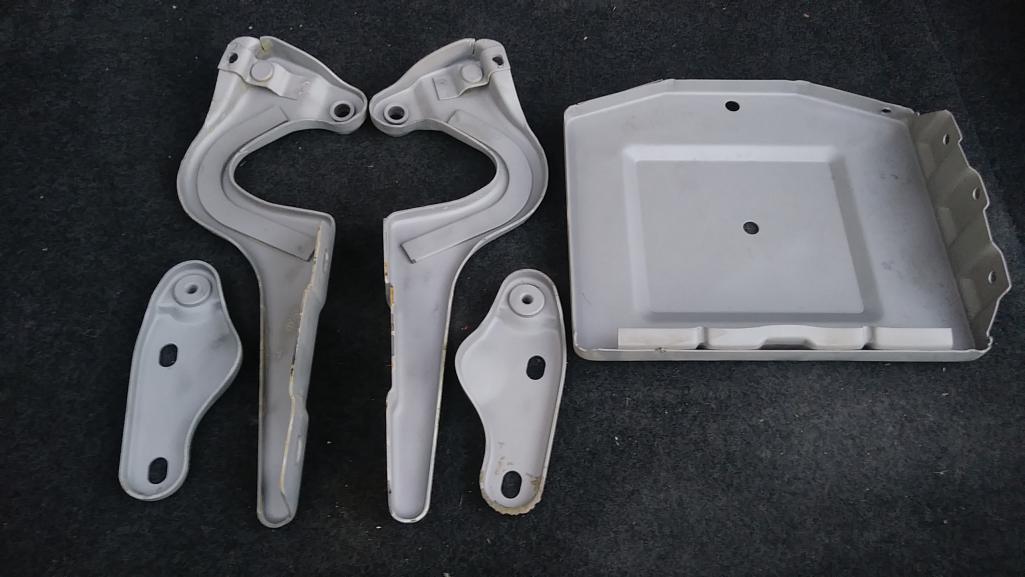

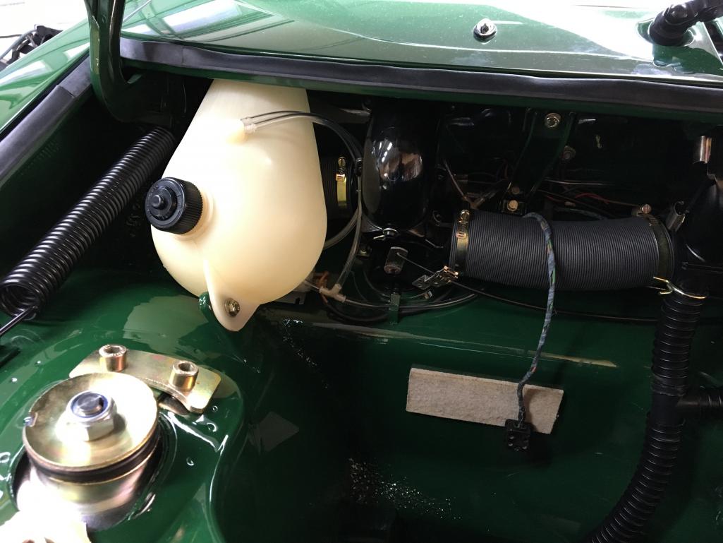

Jim sent me these pics tonight. This is an example of the attention to detail, terrific work he does. That headlight assembly bucket is perfect. The windshield washer bottle looks killer too. At the rate Jim is going he is going to have all my parts sorted and restored before I even return to Torrance CA at the end of the month.
How did he get that bottle looking so good
I'd like to know how he got the bottle so white also. Bleach? Ajax? Peroxide gel?

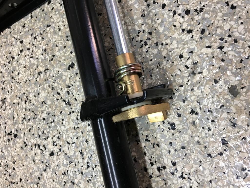

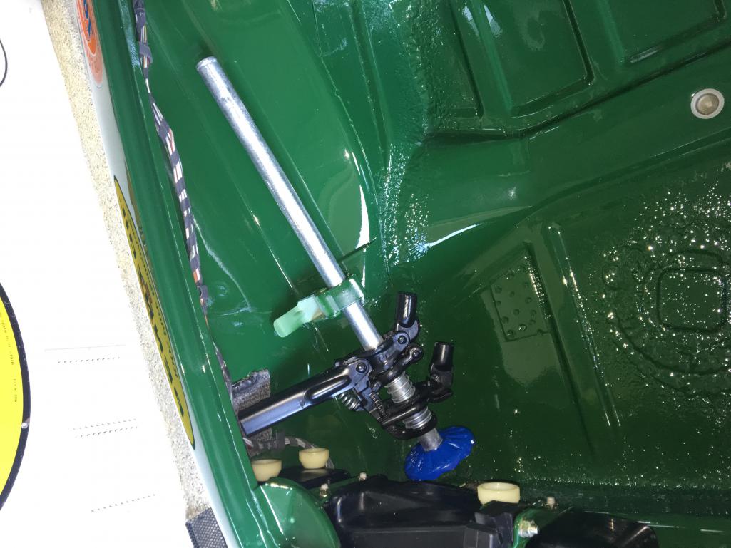

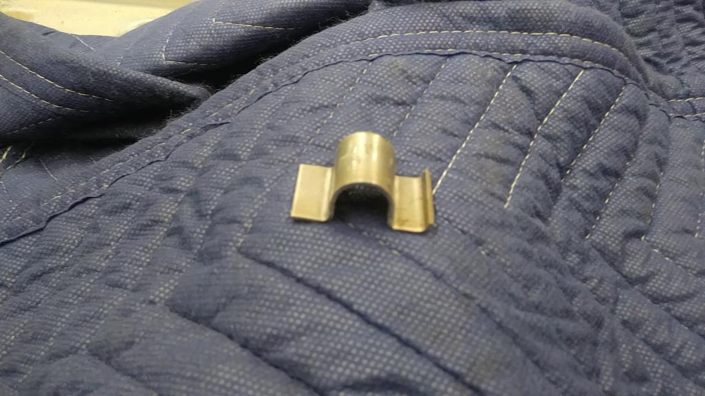

OK, so Jim has been a busy dude lately working on my windshield wiper assembly. It looks terrific of course.
Uhhhh, I may have forgotten to tell Jim I have a GT Hockey Puck for my steering wheel. I hope he did not spend a lot of time on this. Of course I am keeping it as I may change back and forth between the butterfly and the hockey puck.

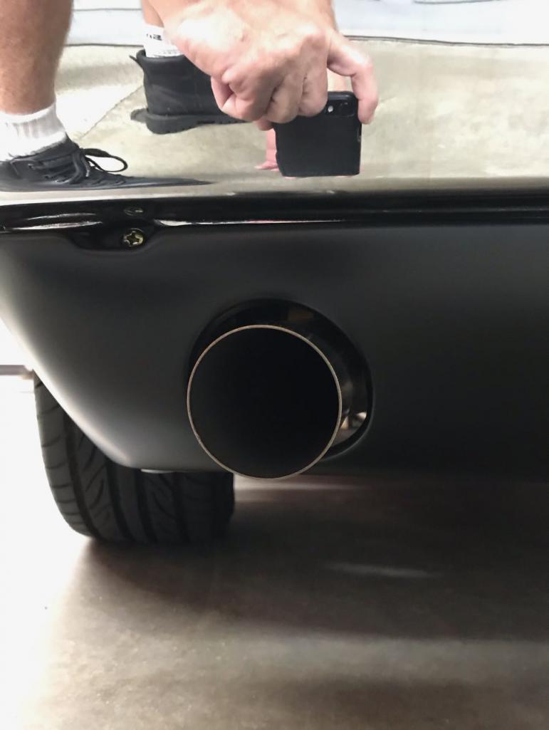

I am looking forward to seeing your heat exchangers and muffler when they are done. I think once the chassis is finished and in color this Six is going to come together nicely. My goal is to have everything waiting for assembly so there are no delays in assembly due to missing parts.

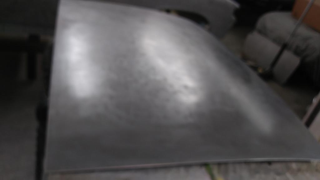

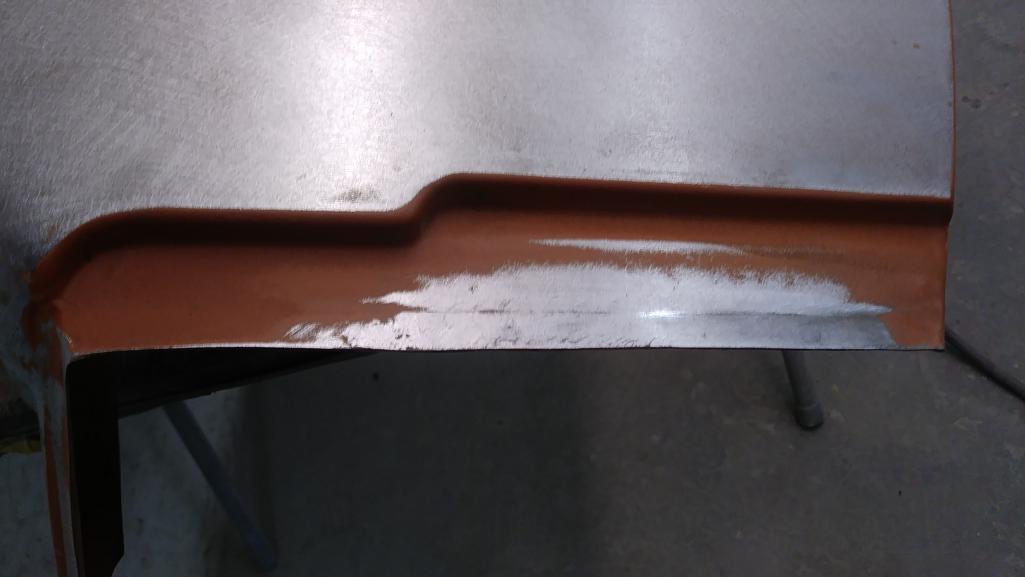

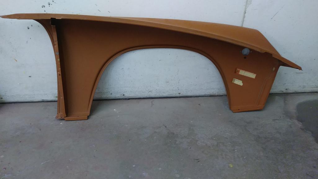

Kent- NOS quarter panels is definitely a great find. I was looking for a passenger side quarter with no luck about 2 years ago. The Gods are smiling on you with that find.

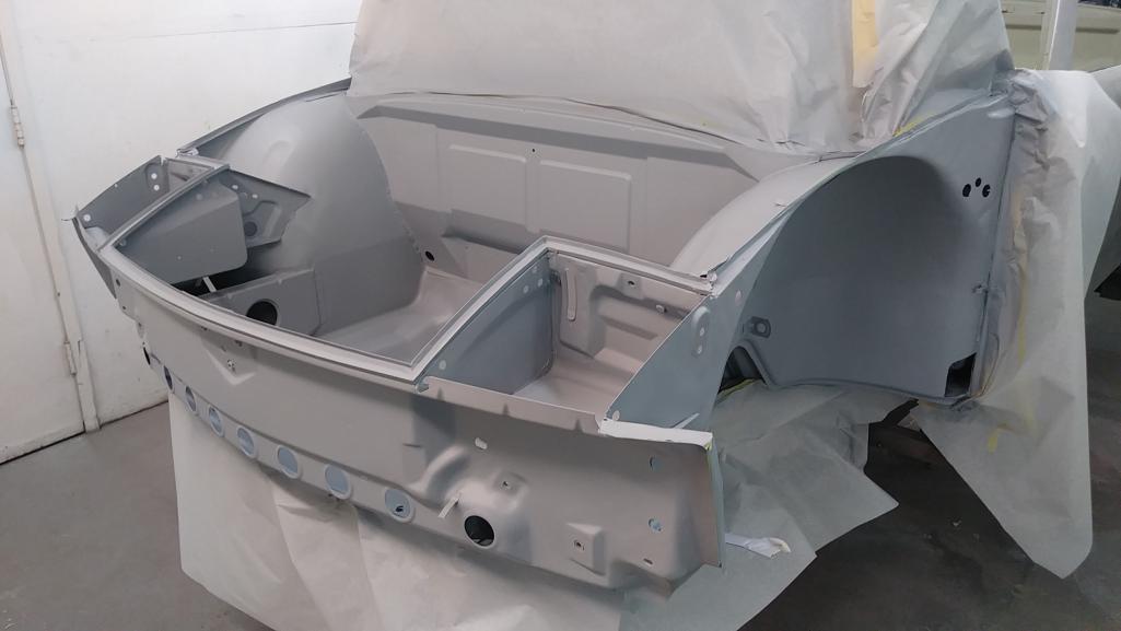

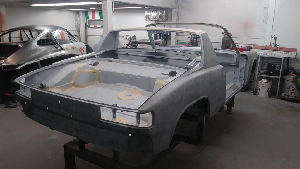

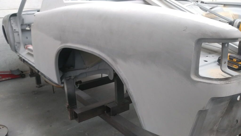

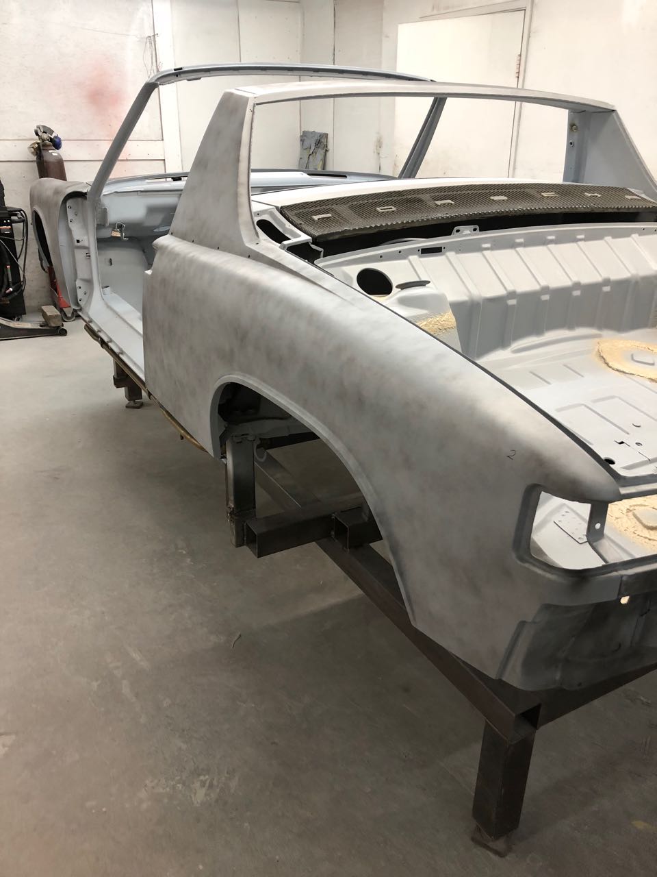

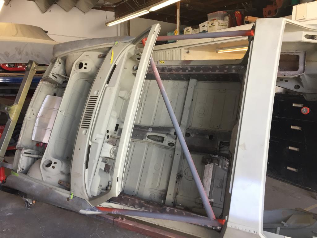

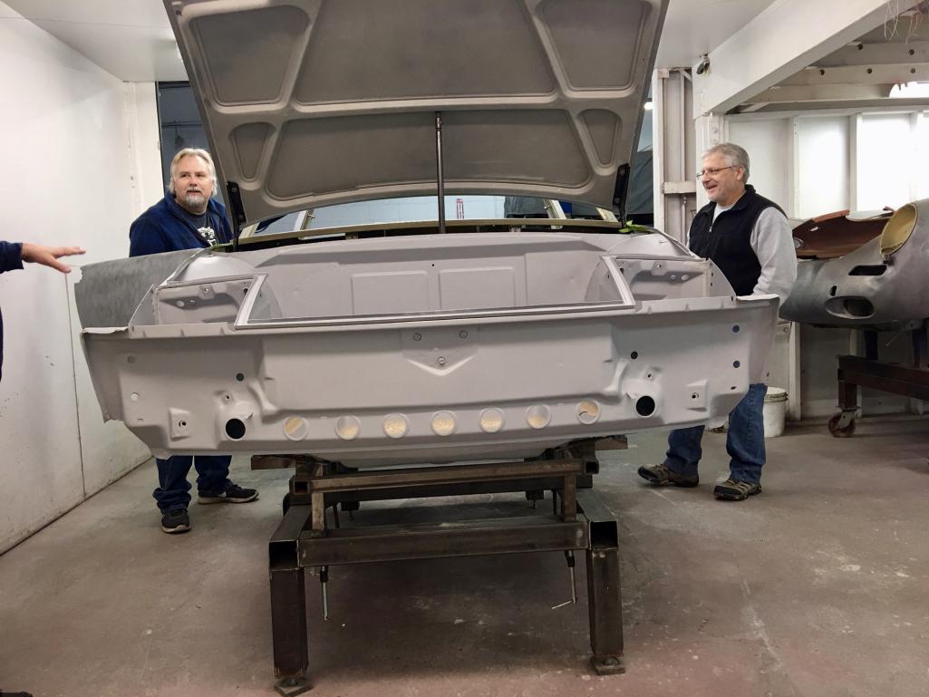

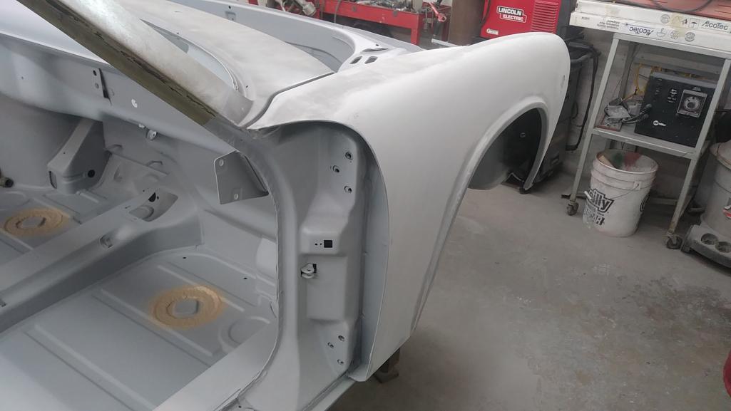

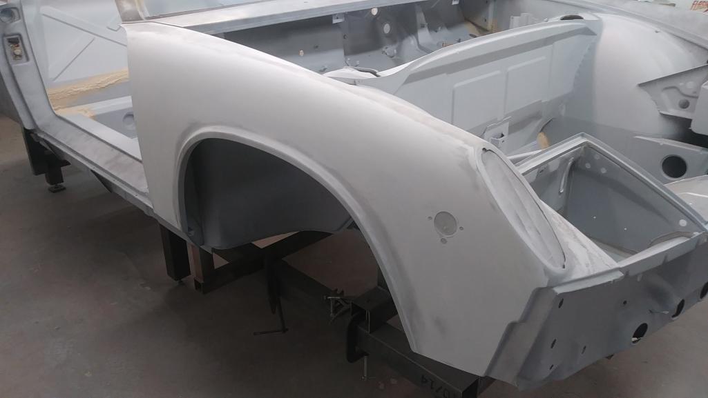

Got the Six on the Jig today. I'll see you on Sat. And we'll go over the car. I just got the 911 done and back to Tony Callas today so I'm ready to dig into your Six now. I should have the parts back from media blasting by friday.
All the suspension points etc. lined up great on the Jig as expected, the car hasn't been in any major accents.
Kent - Thanks for posting the pics of my car on the rotisserie and the frame jig. I am so glad to hear all of the suspension points are spot-on. I look forward to seeing you on Saturday and discussing my car. Food should be a part of that discussion -

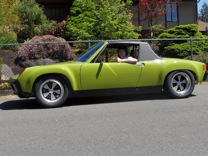

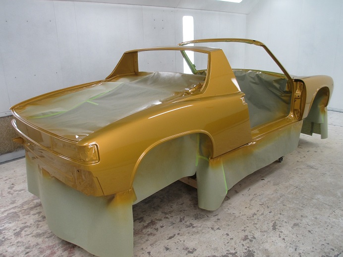

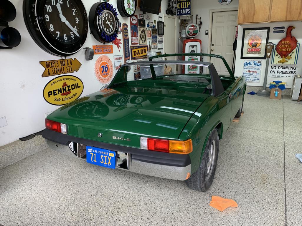

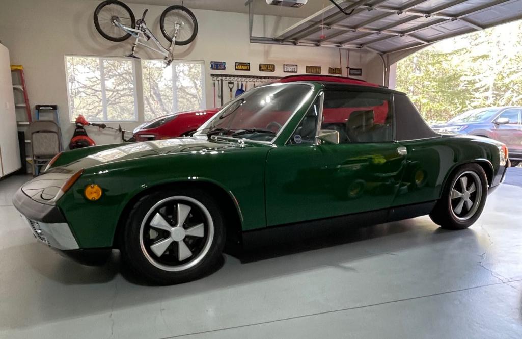

Just in case you haven't been teased enough about the color, I've included a pic of my car for inspiration.

So I just got home about 1 hour ago from spending the weekend down in Southern California seeing Jim, Kent, Andy and my Six. My brother went with with and we had a great time. These 3 guys are just cut from the same cloth- they are a pleasure to be around and talk with.
I was able to see my car on a rotisserie in good lighting and go over the whole car and discuss all aspects of the chassis with Kent and Jim. Kent will be putting in some time on this car to get it where I need it to be.
I also was able to go through a lot of my parts, not all of them, and identify some things that appear to be MIA at the moment. I will be emailing Scott and asking him to keep an eye out for them so he can ship them to me. I also somehow ended up with a refinished 911 oil tank instead of my refinished Six oil tank - pretty sure we just mixed up a box. I will ship that 911 tank back to Scott so he can ship me my correct tank with some other parts.
The next time I go down to SoCal I will continue going through the parts and hopefully be done with that at that time. That should allow me to send Scott a final list of items we are looking for.
I also got a chance to hear Jim's Six run - wow it sounds (and smells) sweet.
Then the cherry on the top was seeing Andy's Six - I can honestly tell you the pictures do not do it justice. OMG! It is just beautiful. Then he had to start it......let's just say that is one healthy motor.

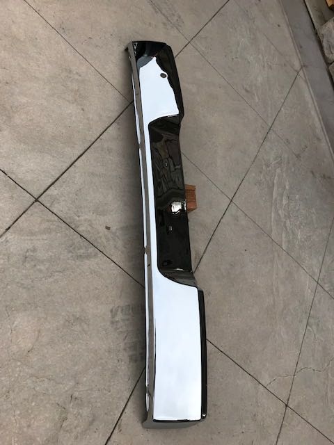

Received the rear valence today from rangrbob. Excellent piece in great condition.
That is a very nice looking original Six valance. Definitely going on my car. Thanks Karl (rangrbob). Great picture- thanks for posting that Kent.

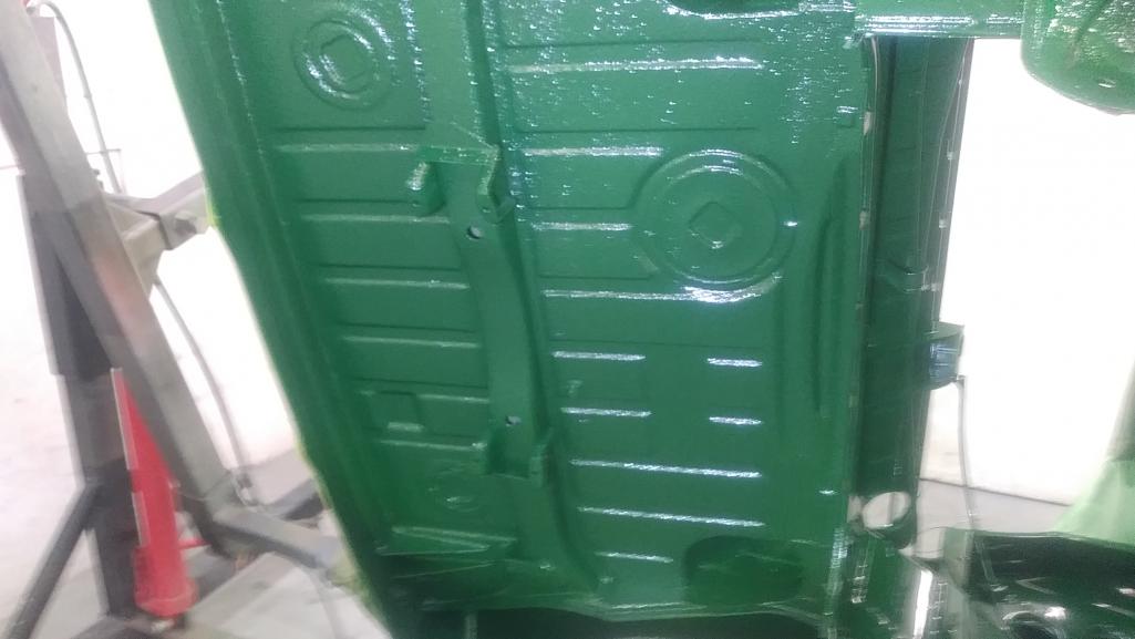

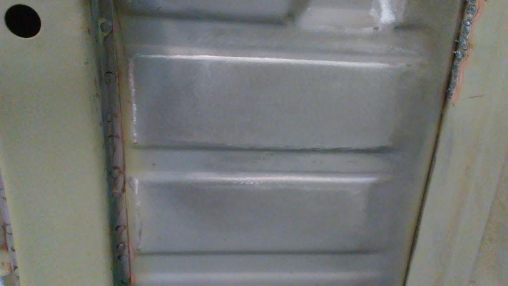

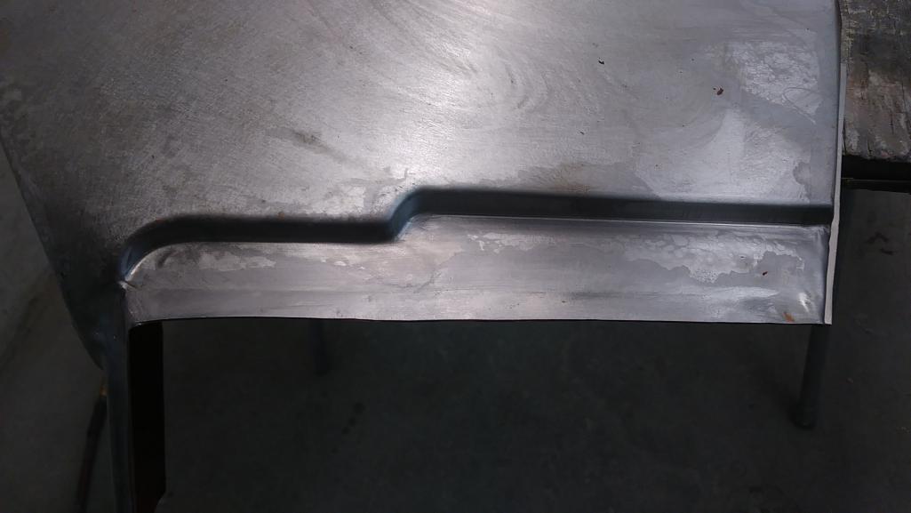

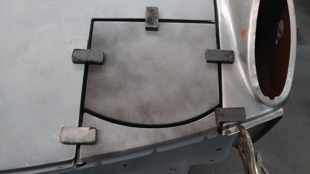

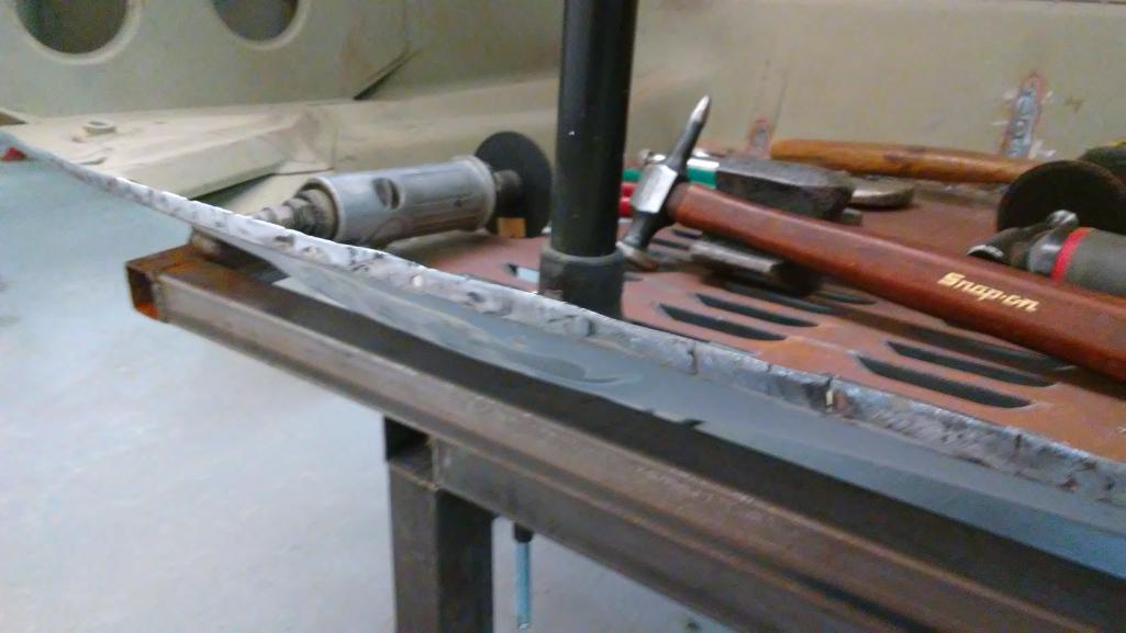

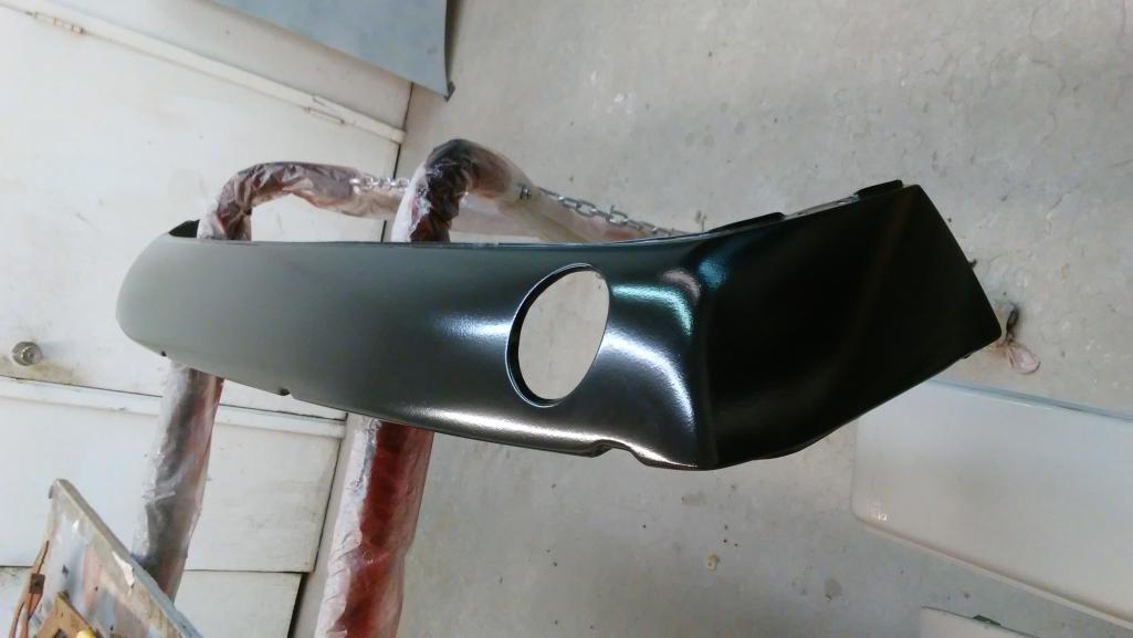

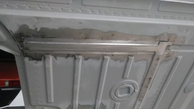

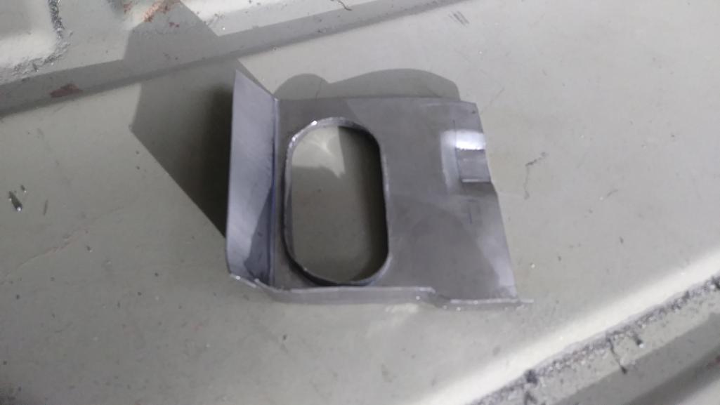

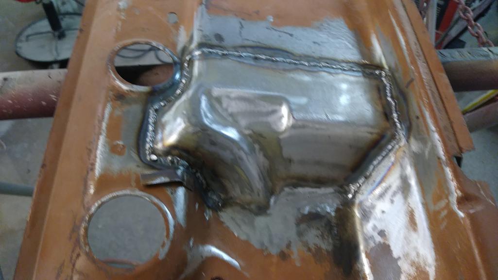

Created the drain channels in the panel then made the flange that comes down over them...also located and welded in the nut for the rocker cover.
Now it's starting to look like a nice straight pan.
Kent must be a reincarnated 914 factory body worker. He seems to know these cars pretty intimately.
Looks great!!

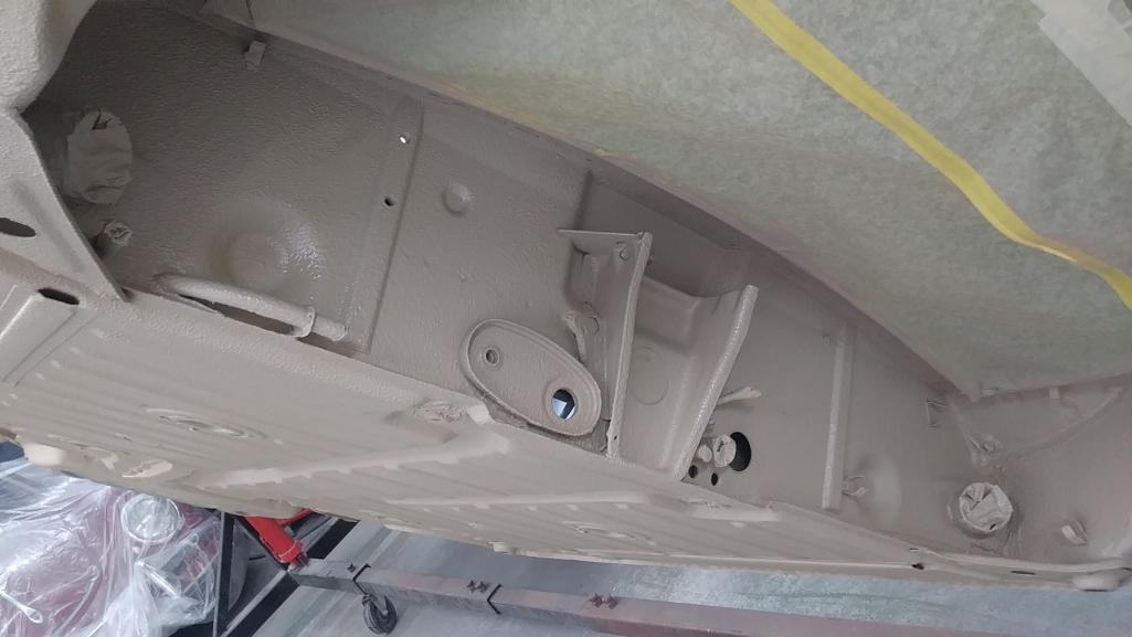

Been cleaning and straightening up the bottom of the car. Lots of little things. Should get a few parts I need from Restoration Design this week. Getting close to sealing the underside.
Michael car is looking awesome. Any way you could measure the bottom of the floor pan to the top of the engine mount for me? I know I am jumping in on this thread but I would love to get a real six measurements..
Keep up the great work..
Perfect.. Thanks.
Still chipping away at the stone. Eyes are finaly starting to recover from LASIK...it's been miserable. A couple of drops in each eye and the next day your back to work is extremely misleading.
Looking great and thanks for the help on the measurements. I installed my mount 2 days ago..

Lot of metalwork going on with some of our cars...
Nice to be getting these back in tip top shape.
Well done.

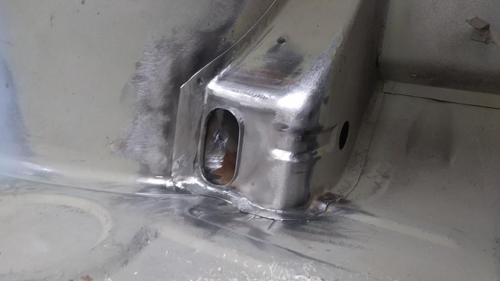

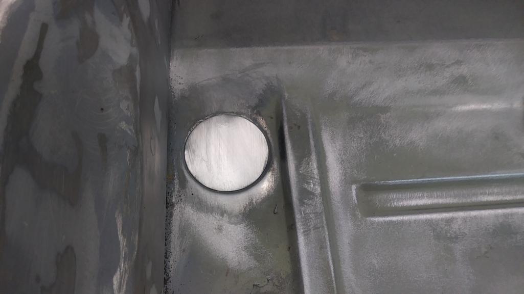

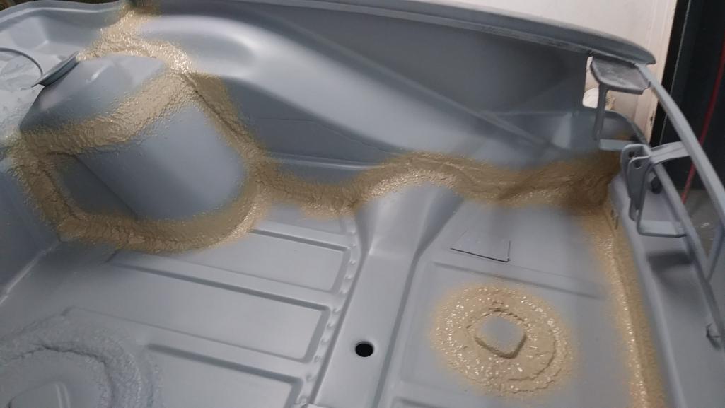

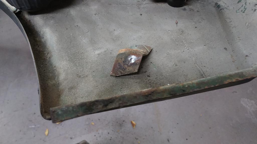

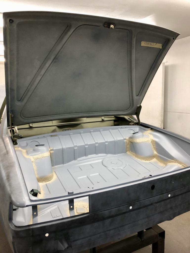

Pic of damage to new trunk floor section that was damaged during transport...fixed.
It is amazing the progress on this car.
Progress, and what looks to be very high quality of work.

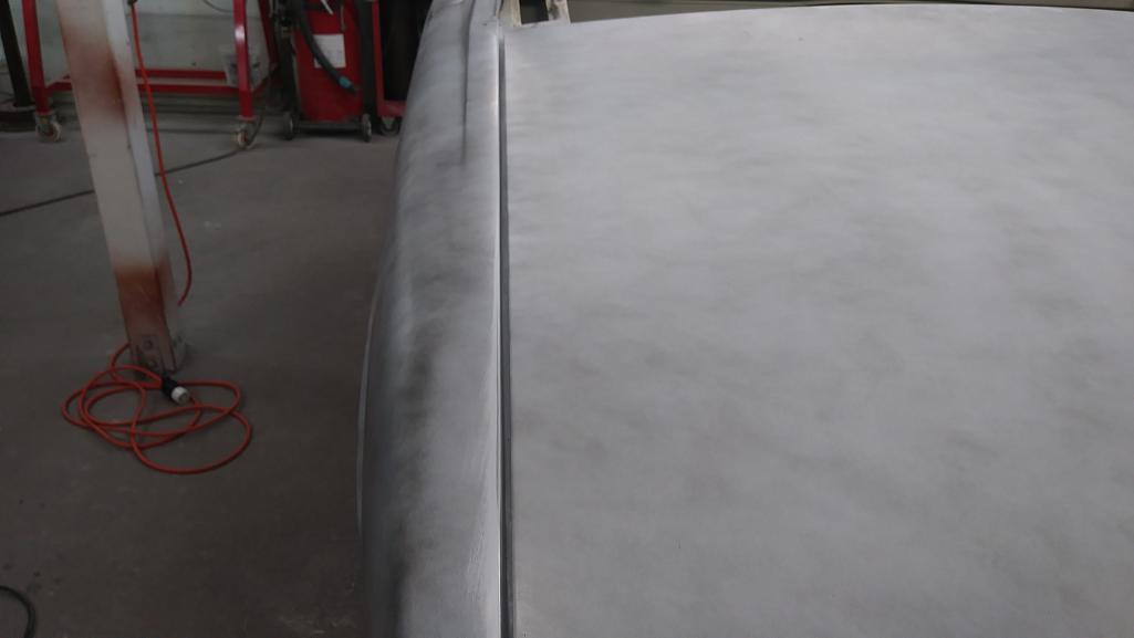

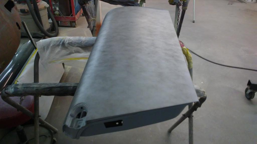

Working on the doors fixing some lite damage here and there.
Now that's what I'm talkin' about. That is how a car is supposed to be prepared when it is a full media blasted restoration. Great work Kent. Have some cheesy-bread on me. Now I can't wait for December.
Looks good!

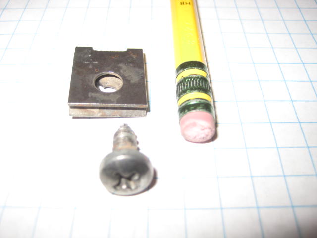

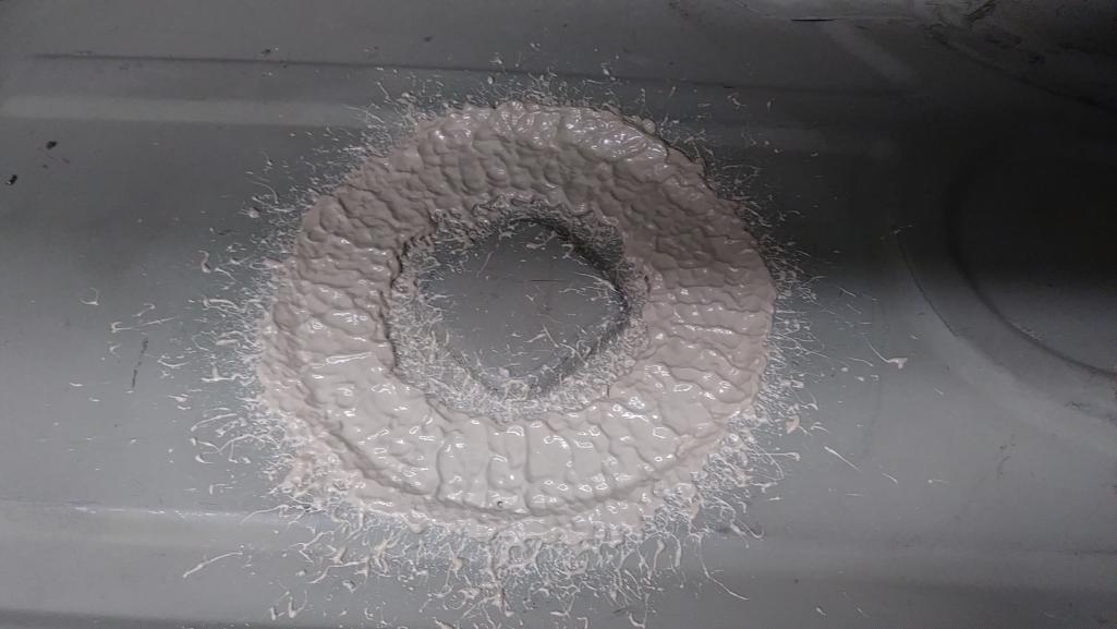

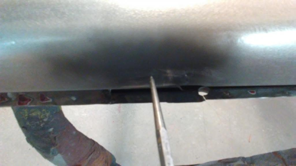

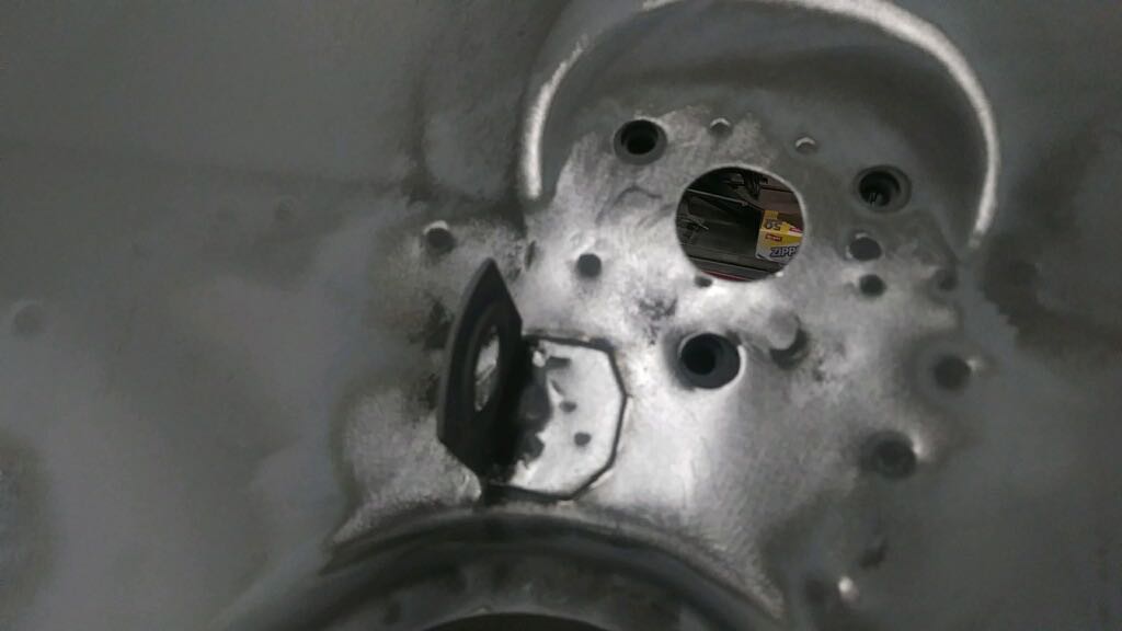

At first glance I thought a PO had drilled right through the nut plate for the mirror mount. Lookin closer, I saw that they had drilled two holes just off to the side of the nut plate. I welded up the holes then located and drilled holes to reveal the threads in the nut plate.
I showed how I locate and drill the holes for the mirror in Jims thread but I figured I show it in Mikes thread also.
I sprayed some black paint on the area.
Lathed a point on a bolt.
Screwed it in to the nut plate from inside of the door till it made a point in the metal.
Slightly sanded the area to reveal the mark then removed the bolt.
Used a punch to mark a guide for the drill.
Drilled a small hole.
Screwed a bolt in from the back to use as a stop so the threads don't get damaged.
Used a larger drill bit to open the hole to the correct size.
In the second pic you can see the bolt in the left hole that is used as a stop for the drill so that the threads don't get damaged.

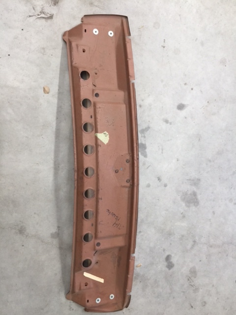

OK - Looks like I got very lucky here and this is the NOS nose going on my Six.....
Score ...............
Can I buy the old one from you? Mine is missing the curve, probably from a accident, which is causing the hood not to close.
Timothy_nd28 - If it comes off in one piece, you can have it for the shipping. However, I believe it will not come off well or in one piece.
One of the reasons we are replacing the nose on the car is it is creating issues with the whole front end and panel alignment. Evaluating it, we decided it would be easier to replace it rather than trying to remove and re-install it. Stay tuned for pictures of that in the near future once Kent has the new panel in his hands. To be honest, I am really excited to see this front end get buttoned down and finished.
Really? I would be a bit surprised if there was a special nose panel for the Sixes. No reason for there to be really. I am sure the one I bought is just a new NOS panel for an early car. I hope someone can confirm this special detail.
SocalAndy's car hard to see.
That's a bumper tit front panel ,,,close but not it....73/74,,,
No special panel for -6,,, 70-72 is what you need
4 types in total...
http://www.914world.com/bbs2/index.php?showtopic=198600&hl=
OK, correction. There is not a /6 specific front latch panel, but one for the 70-72 chassis.
Pete

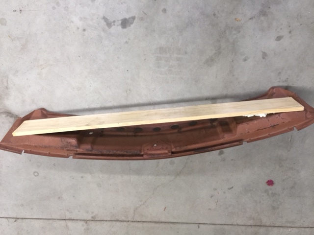

It breaks my heart, but this is a 73-74 nose panel and it will not work for my car.
So I am back on the hunt for a NOS early, 70-72 nose panel. I am hoping someone has one up in their attic, shop storage, garage, you name it, that does need it. Please send me a PM if you have what I badly need.
If we can't find a NOS panel, then I will start to look for a very clean used panel. But with the level of damage we are trying to correct on the front of my car, an NOS panel would be a God send.
Q.P. was replaced and lip was rolled by a P.O.
Straightened it and cut it as a 71 should be.

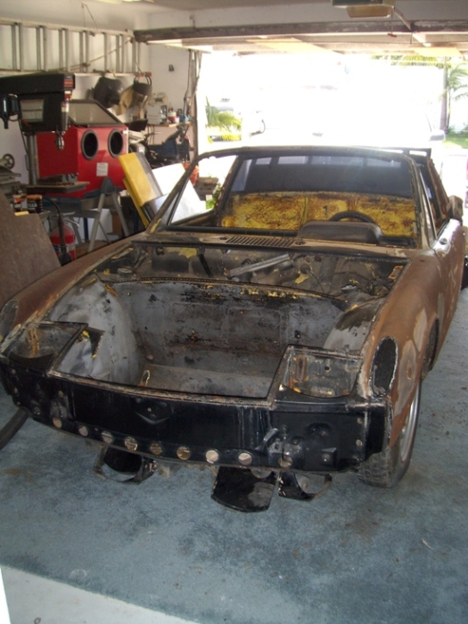

here's mine arriving at Kent's shop in Nov. 2011 after media blasting
Thanks for posting that picture Andy. Keeps me motivated and gives me hope. Someone has to have a spare panel sitting around.

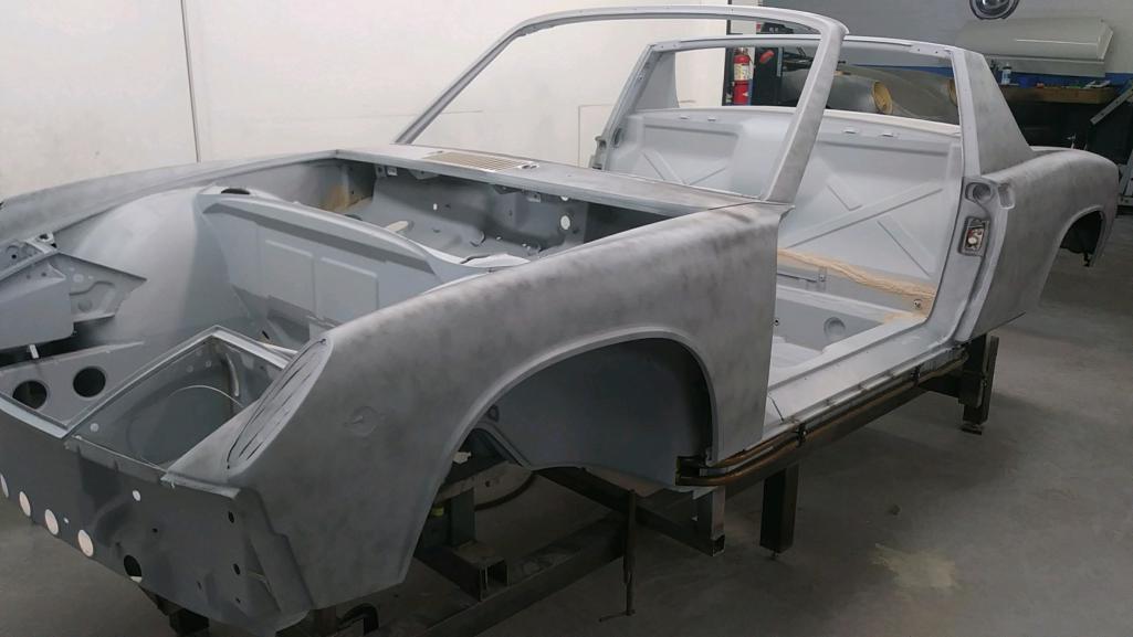

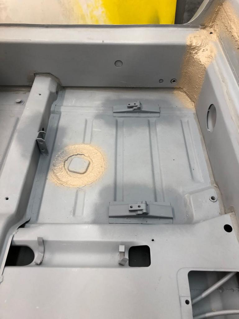

Got the car back on the fixture today.
When setting the car on the fixture previously, I could see that all the measurements were in spec although the back of the car was tucked down from a previous hit/accident slightly. I could see this in the suspension console alignment to the fixture. Although being off by 2mm is within spec, I brought the back up to get it to zero.
Ok, I'm caught up. Michael, I need to come down and see this thing. It's going to be sweeet!!!
Just amazing work. It is so calming to me to see the quality of work being done and that my Six is moving right along. Being back on the fixture means we are going to see some reconstructive surgery.......
can't wait. Thanks Kent.

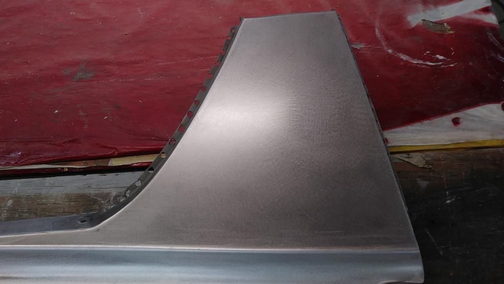

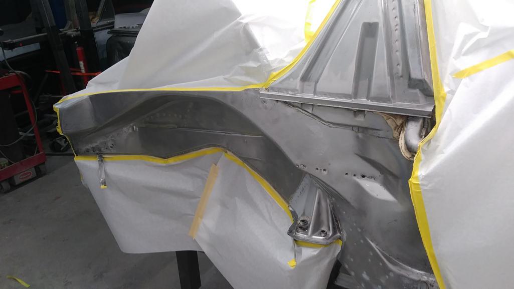

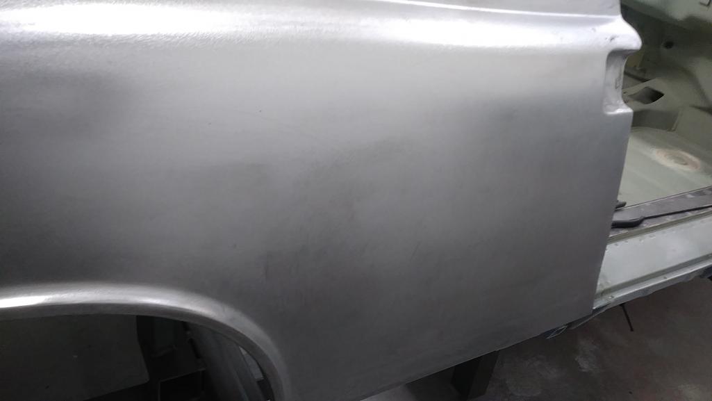

Drivers side quarter panel is rotted out from the backside. This full Q.P. was replaced at some point.
A section of the passenger side Q.P. was replaced at some point and was not put on straight and measures out 4mm to long.
Wow, that sucks!
That is just the way it goes I guess. I do know that the passenger side rear quarter, from mid-fenderwell back, was completely replaced - there are pictures in Part 1 of my build thread showing it being done.
Sad and sorry that has to be redone too. Regardless, Kent is doing this correctly and I know, and so do all of you by now, that is the only way Kent would do it and the only way I want it done.
I will just go without food this month and maybe heat too.....
So it looks like more bad news coming my way regarding the previous work. The passenger front fender has to come off because it was welded on over a bent wheel well that is high and the hood strikes that when being closed. The passenger side fender is also out of alignment a little, but the driver's side is off a bunch. These were both replaced in VA.
Also, as if that was not enough, the passenger's quarter panel is off, welded on the wrong way, and the taillight housing will not even fit in the opening. This was done in VA. The driver's side fits OK but needs some work too.
Looks like Kent is going to have to remove a lot of sheetmetal and then redo a lot of work I already paid to have fixed once. That really hurts.

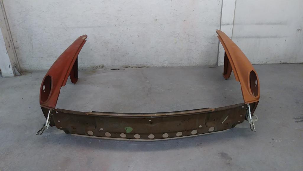

In process of removing the front panel. Since it was previously replaced, it tears up the flanges that it is welded to due to them being plug welds. It's the right way to weld it on but just harder to remove. All these flanges will be rebuilt.
Michael -
So sorry to hear about your facing "do-over" work. I feel your pain. The key motivator for me to teach myself to fab was a horrid and quite expensive experience I had with a shop that totally f-ed up one of my project cars. I renamed that shop "Dream Killer Garage".

Drivers front fender is rotted out and will need to be replaced.
Oh oh..
At least your car will be 100% primo. Great shop. Every detail.
Bob B
Michael - I feel sick every time I see another problem posted.
Mark - Don't worry; I know you had your problems too.
I feel like it is Ground Hog day and I can't escape the nightmare.....
Fortunately for me and my Six Kent is 100% on this and knows this is the level of work I want.
Not the continual replacing of panels part....
...again, plug welds are not as easy to seperate as spot welds.

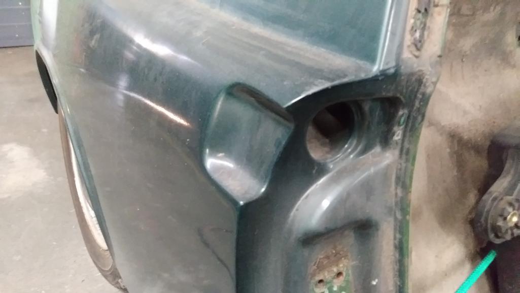

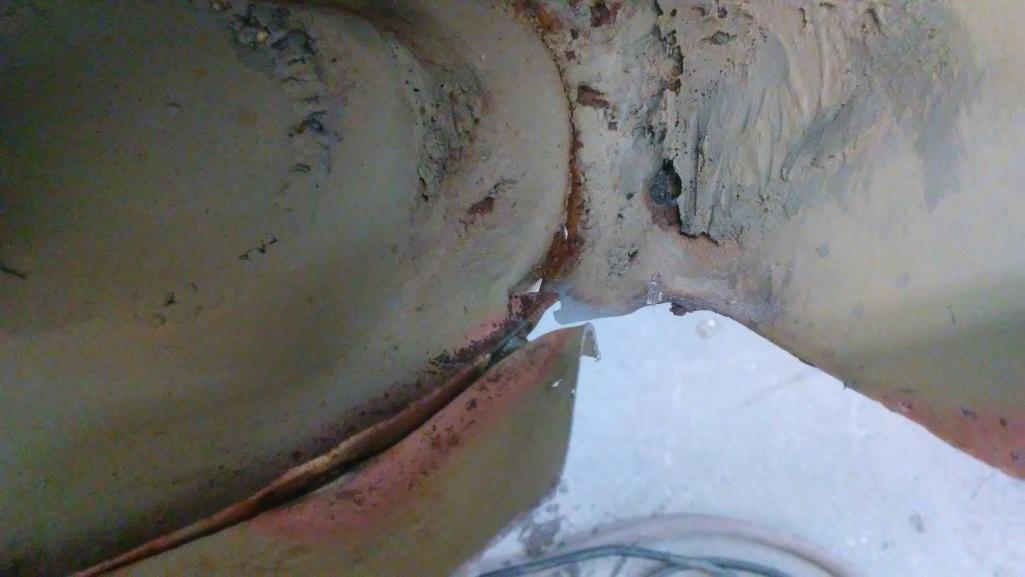

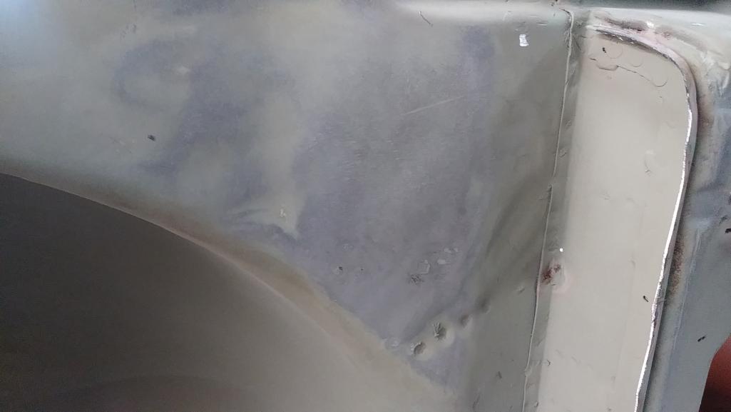

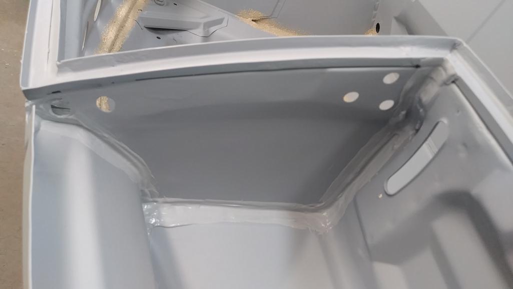

At some point the holes for the side lights and turn signals were welded up on both sides. I'll drill/bore the hole..
If you look, you can see in this pic how the bottom of the bucket is pushed over/inward. Look at the angle of the drain tube and the angle of the bumper bracket.
The second pic shows damage from a previous accident.
Because the inner structure was bad, the fender gap was gone on that side and someone had drilled the bumper bolt holes out to about the size of a quarter. So the bumper would align.
This section had to go. Pounded on welded on and damaged.
Good Riddance

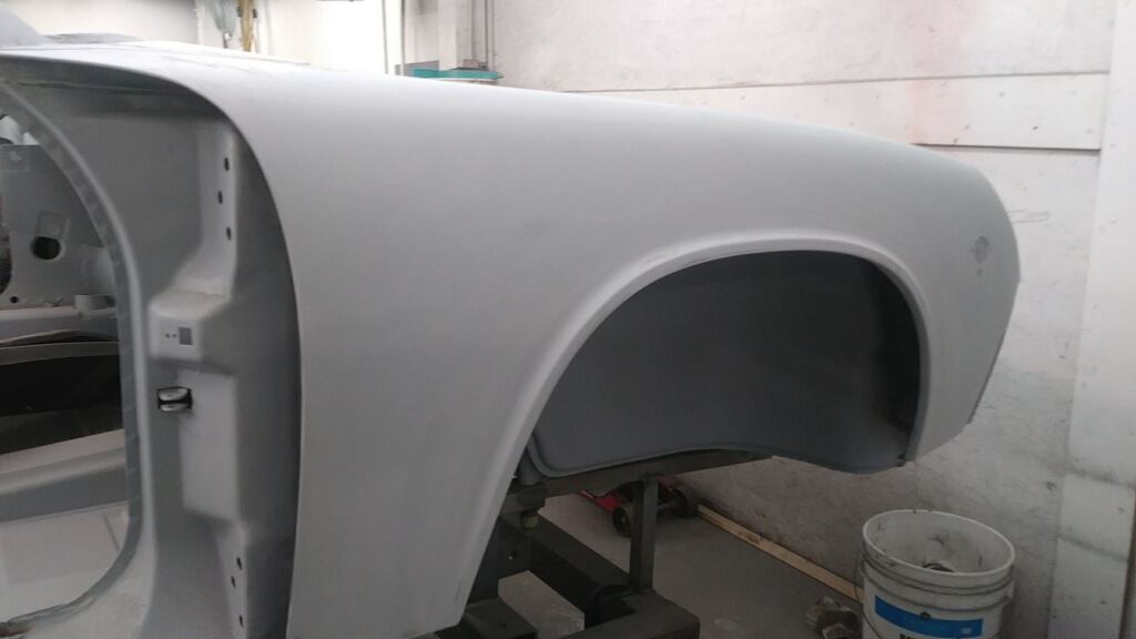

Well we have sourced the NOS nose, left and right front fenders. So we should be seeing some great work soon. Thanks for asking.
Mike located NOS left and right front fenders, they should hopefully show up next week. I've been cleaning up edges and trimming some sections off of a donner car that will be needed. I'll load some pics next week. I got a new phone and pics didn't get transfered. I need to download the pics off of my old phone onto my computer so I can post them.
Oh man.... I can't wait to see those NOS parts, (nose, L&R front fenders) in Kent's shop with my Six.
These NOS fenders were not inexpensive by any means and I was very fortunate to have been contacted by a fellow member who offered them up for sale. Despite the cost, I was very excited to be able to buy them for my car.
The NOS nose was a great deal and I am very appreciative of the seller for that. I also bought a stock deep rear valance (4 cylinder) from him.
Thank you very much to fellow members aturboman (Robert) and Perry Kiehl. Both of you are great guys and great to deal with.
My commitment to my Six is to build it to the highest standard possible. That is what Kent is doing- no doubt at all. I am confident Kent could have worked with the rusted fenders and damaged nose on my car and absolutely metal worked them to be prefect. (Heck, I am pretty sure Kent could take a piece of sheet metal and make a perfect stock 914 fender from scratch for that matter.) But I do not believe that would be in the best interest of my build. We had enough issues with my tub needing to be corrected that I did not want to compound all of that with bad parts. These NOS parts will enable Kent to get my chassis dialed-in better than when it rolled out of the factory.
I am seriously looking forward to next year as all of the fabrication, metal work and repairs are in the rearview mirror.

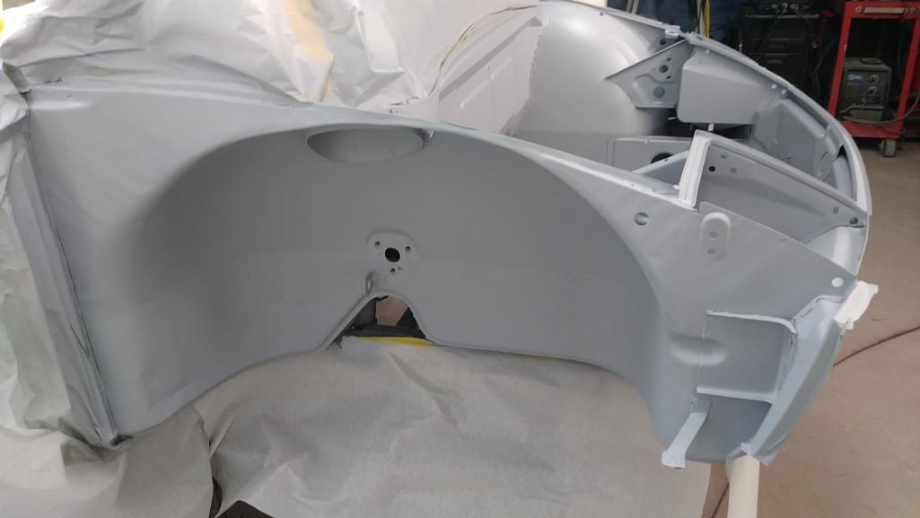

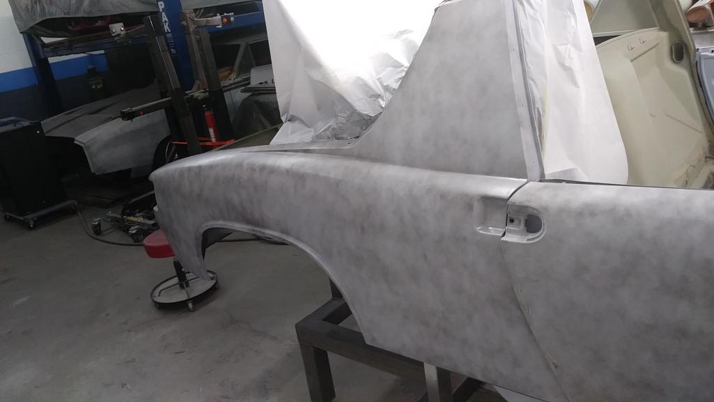

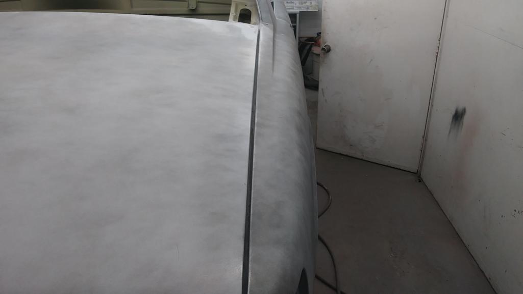

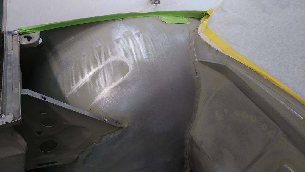

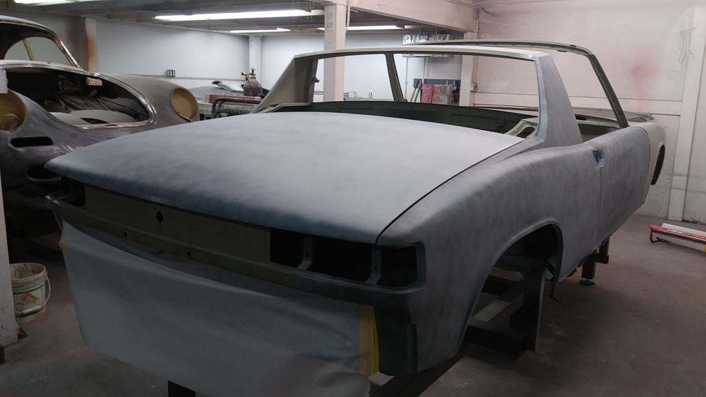

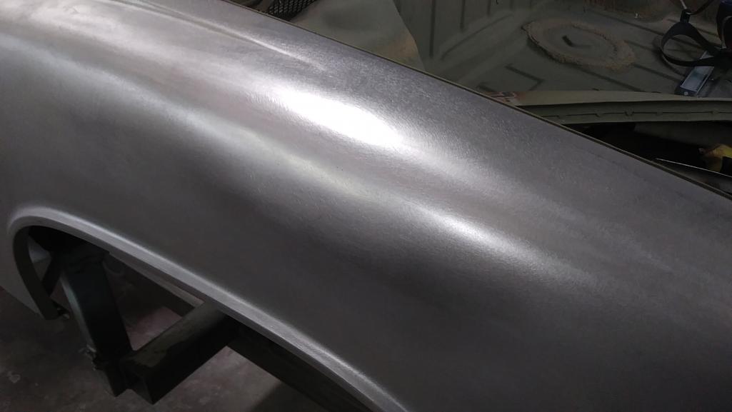

So Kent has been pretty busy by the looks of it.... this is what happens when you wet-sand blast a car. This stuff cakes up like clods of dirt and holds moisture and causes rust. That will not be a problem now. I am lucky that Kent recognized we had an issue and removed this quarter panel. Apparently the other side is OK.
New phone, larger pics. Said no adjustment for pic size when I looked on line... argh!
That looks like the former passenger side quarter. Glad that came off and will be replaced (correctly) with another complete panel to fix that widening we saw of the rear end as well as the length problem.

The fenders shipped separately. One down, one to go.

Trimming edges and removed the old battery tray.
Front fenders that Mike located.
Thank you to Perry Kiehl for letting these go. They will be a great addition to Mikes project.
The brackets on the front will come of, they are for later cars.
Here's a sneak preview of the front nose panel and a hint as to how (with some Tig welding) it will become an early nose as opposed to late.

Hey Kent - Loving the front end pictures! That is so cool. Thanks for doing that.

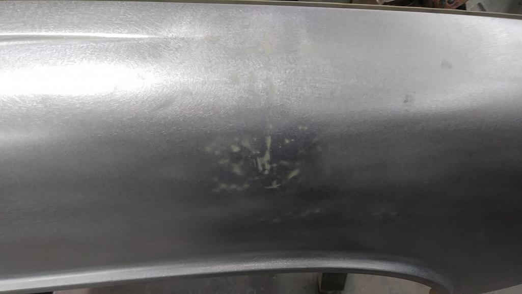

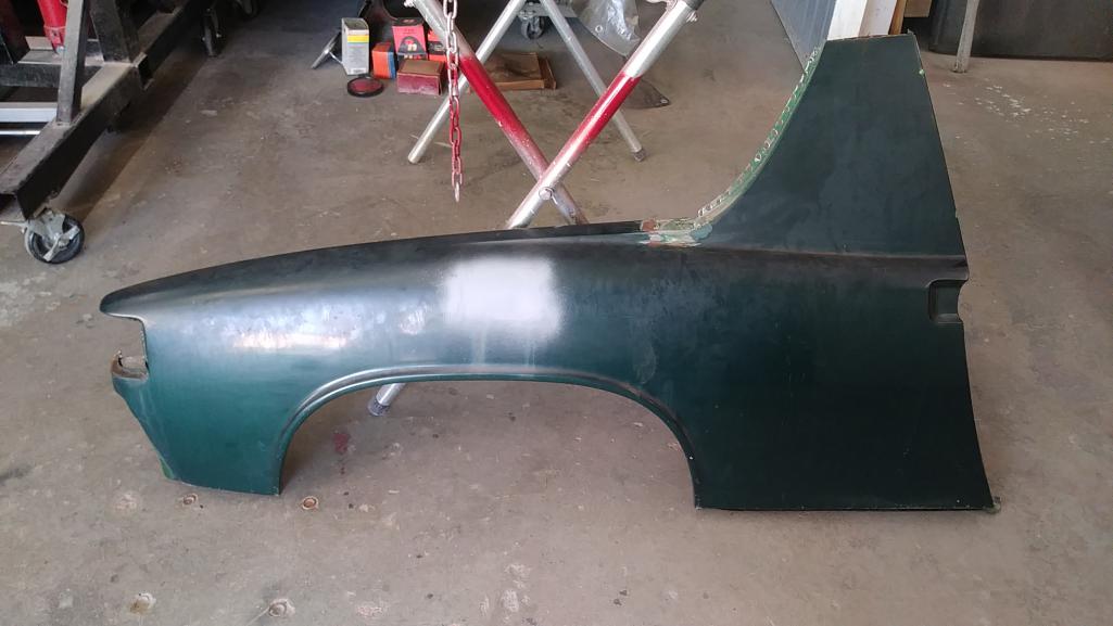

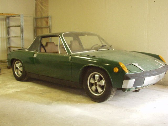

Donor rear fender. Great condition. Got the car in the shop and I'll start removing it tomorrow.
Terrific looking parts. Thanks for posting the pictures Kent.
Wow, you won't even have paint that fender.
Sadly, in the wild, some must die so others may live. Here we have a very nice green car giving its life to help others in need. We offer thanks and bow our heads in prayer.
I wish my car was that clean to start with as the green car..
Nice looking fender Kent. How is the backside?

Oh that looks very nice. We now have an early front panel.
Very nice!
Love that fix. I have to do the same thing.
"Amateur newbie panel welder", that's funny.

What was that hole for that you made the patch panel for?
Just amazing work. I am very impressed and pleased. Thanks and thanks for posting to the thread Kent.

Prepping the reat fender for media blasting. Very clean under the foam in the rear corner. Way cool.
Some pre fitment. I think Mike will enjoy this pic.
OMG! That is such a great picture.
I am so happy to see that quarter is clean and solid and the front end pieces all sitting in place like that. Thanks Kent.

Drilled multiple holes that had been welded up.
Trimming off the old fender and repairing some damaged areas.
Fitting fenders.
Dropped off the rear fender and nose panel for blasting, should have them back this week.

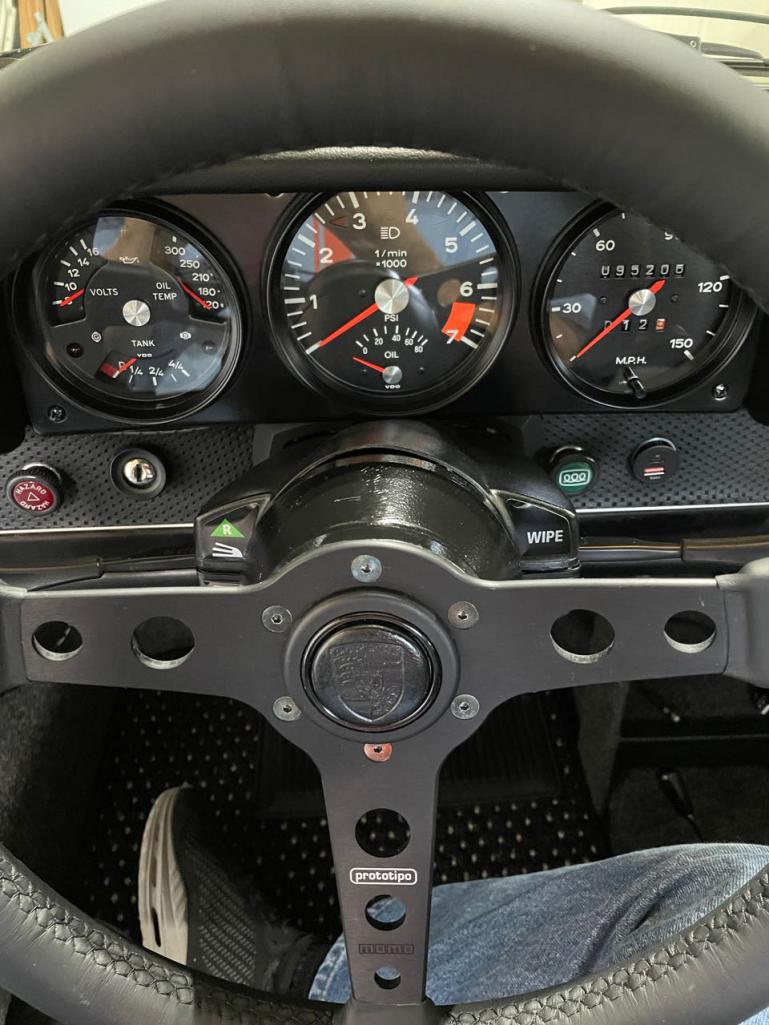

Just saw the gauges you had done that you posted on Pelican.
Those are super nice looking.
You should post here too as well some time.
Continued good luck with your build....
RayneKat - If that was meant for me, I have posted my gauges in this build thread. They may be in Part 1 though. But thanks a lot - I like them too.

Will you go back and solder that jamb seam when you put it together?
I'm also doing a significant amount of metal work on a 6 chassis, including the right rear quarter and jamb.

Ummmmm.....it's on the wrong side of the tach?
It has a reset on the front window?
More 911-ish w/o as many numbers on the face?
Trim ring is split?
Extra digit on odometer.
Yeah - I did not want to lose the original mileage on the speedo and since my car had a logbook with it to document the mileage, I felt it necessary to upgrade to a speedo that had an extra digit. To do that I had to have the reset on the face. I also noted they removed 9 miles in the process. The face otherwise is pretty close to my original speedometer- see below:
Nice gauges. My "typical" 6 conversion gauge set up is standard 911 temp/OP and a fuel gauge where you've got the OP gauge, but I really like that set up too.

I cut open the old fender that was removed from the car to show how they can rust out from the back side.
Yikes!
Is that a spray on paint stripper?
Pretty much, those west coast parts are nice. I’m lucky my car lived much of its live in TX then in garages after that
All the points that connect to the nose panel were in bad shape because the nose has been cut off and replaced multiple times.
Very interested as to what you do to/for the NOS front fenders (in the area that was rusted out of the old ones) Kent. I'm replacing a fender too, so I'm doubly interested to see how/if you get the old factory red primer stripped in that blind area.

Below the headlight buckets prior to welding on the nose panel.
Oh wow! That is a step I have been dying to see. Happy New Year!!!!!

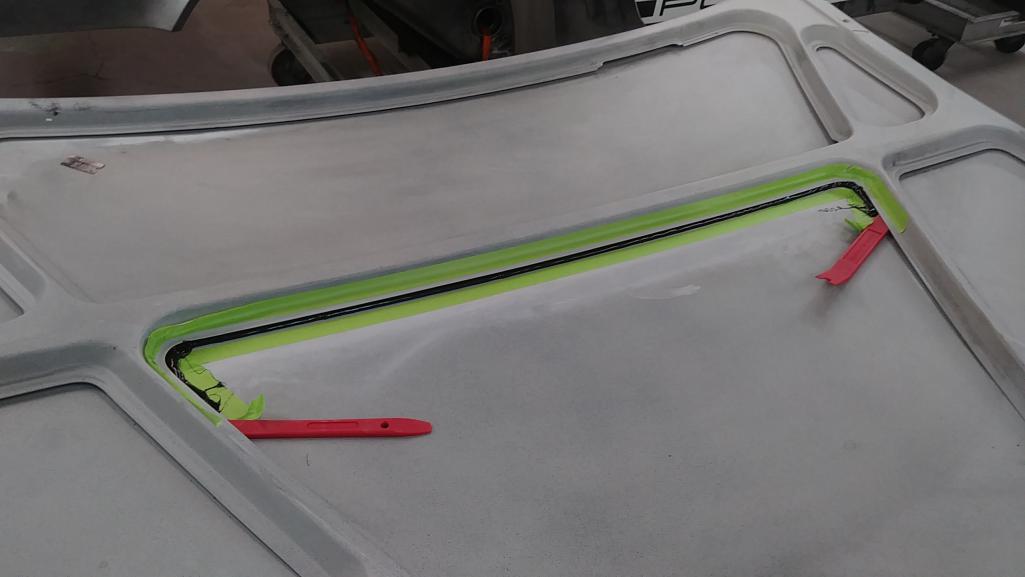

A quick note, I saw mentioned on the 'World once before that the Eastwood spray catches fire when welding on it. I was going to coat my longs with it but I guess I would have finish all the welding on them first. Sorry to thread jack.
Seeing that product going on means we are getting close to welding some panels on.
Hi Kent, just to be extra clear that was in no way intended to suggest you didn't know how to do use it!
I was just trying to confirm for the other member that you don't want this on a surface that you will be welding to. Near? Sure. On a surface to be welded, no because exactly as you wrote it needs to be clean metal.
Getting it into surfaces that will be hard to reach once installed is a smart move, and of course why you are doing it now.
Sorry if I was vague to a point where it read like I was trying to criticize or coach you, that is most certainly NOT the case.
Ditto I was not questioning the master craftmanship going on here. Just warning others.
What a disaster. It looks like the radius is kind of messed up in the middle there. It's going to look horrible once painted. I'd start over.
It looks kinda flimsy with all of those holes all over too.
I'd weld those all up for strength.
I am awaiting a reply from Scotty to see if he has been able to locate my crossmember. I ended up getting one from a 4, not the 6 one. I didn't realize the difference until Jim spotted it. Apparently the 4's are more rounded and the 6's are more squared off. Hopefully Scotty was able to locate it.
Kent, don't start over. Just call me. I'll be there in about an hour and walk you through it. . See ya tomorrow at Bananawennie's

had it at one time 1st thread photo
Is that a picture of my front end parts when it was first removed at Scotty's? If that is the case, that is the correct crossmember for a Six, right? I wish I had a pic of the two; 4 and 6 side by side.
(after comparing photos of a 4 and 6 cross member, one can clearly see the ends of my crossmember, removed from my car, are indeed squared off and correct for a 6.)
yes ,, your parts,, Scotty's pic 1 st thread, the end where the torsion bar adjusters are is squared off ,,4s are round on the end.
Great- I will send him that picture. We got a 4 cylinder crossmember when we picked up my car. I wish all the parts had been marked with my name or something. That would have saved a lot of grief.

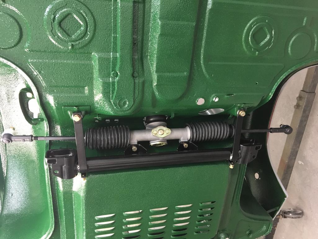

OK, in case anyone wants to know the difference between a 4 cylinder car crossmember and a 6 cylinder car crossmember, here you go:
This is a picture of the stock 4 cylinder crossmember end:
Here is a stock 6 cylinder car crossmember end:
In the above pictures you can clearly see the end of the 6 crossmember is kind of squared off while the 4 crossmember is round. Easy peasy to differentiate.
Here is a close up shot, (sorry it got blurry when I zoomed in on it) of the rack that came off my 6 - it is clearly a correct rack for my car:

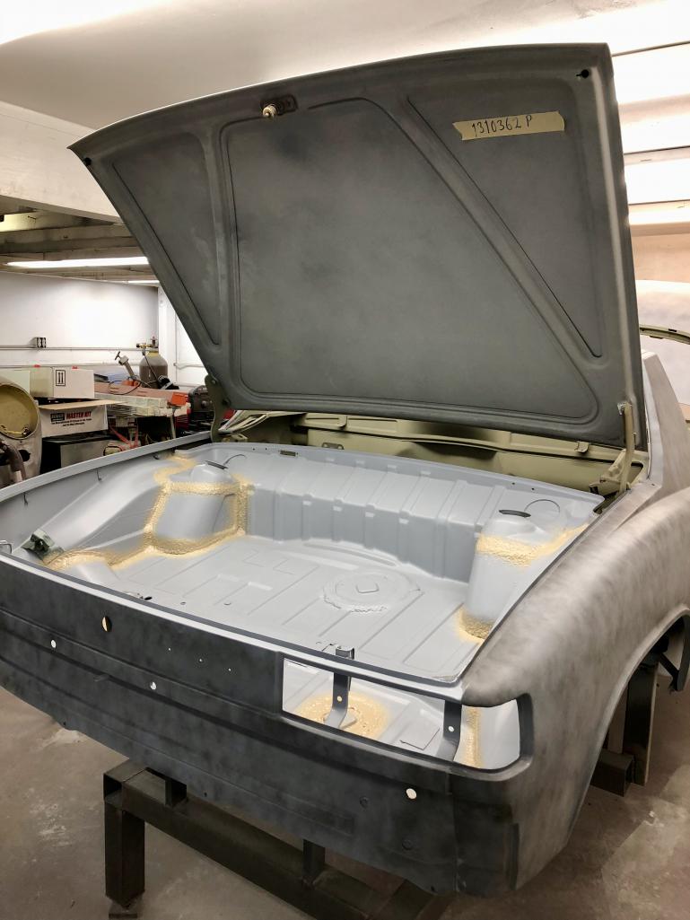

I'm really starting to hate this thread. Just when I feel like I'm doing decent work on my own car, I come over here and realize what an amateur I am. Seriously though, it is really nice to watch this "no compromises" build progress under a true master.

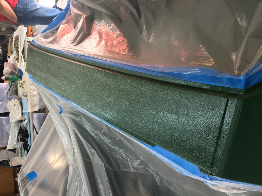

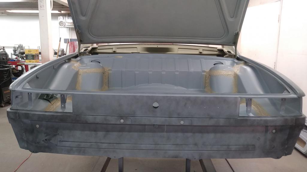

Pics.
Enjoy the pics. Mike. See you on Saturday. .

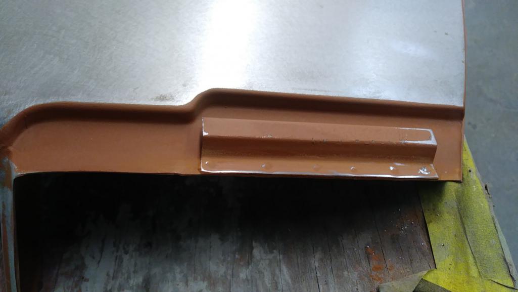

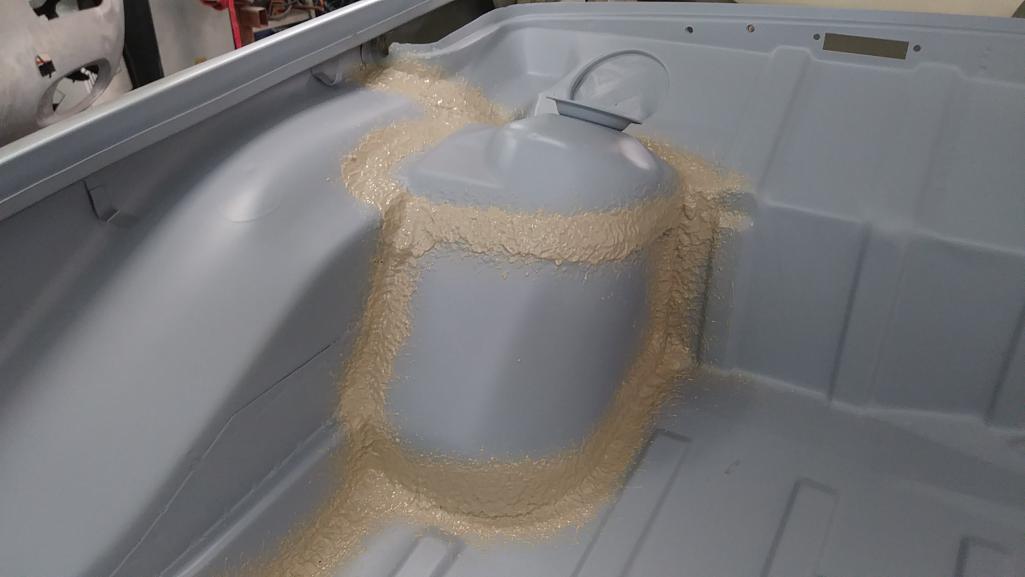

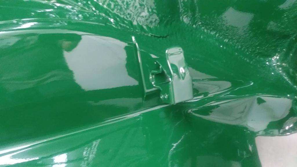

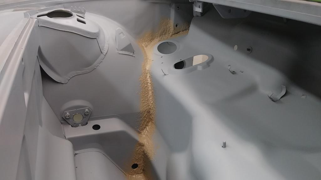

the coagulation looks perfect. what did you use to spray seams?
Heck, I don't know. I am hoping Scotty finds and ships my original crossmember so I never have to worry about it.
Man that underseal flexible rubberized "stuff" looks so nice. I can't wait to touch it in person.
Yeah, I'm printing all these seam sealing pics out and giving them to my paint guy this week.
They are great "go to's" for doing this kind of thing.
Catylised urethane tintable bed liner slightly under reduced and tinted with a beige toner and sprayed at a very low pressure through an undercoating gun.
He'll get these instructions as well.
Beats reinventing the wheel.
That is beautiful thing ................ Perfect
I spent a couple hours with my Lord Fusor seam sealer sprayer last week. I couldn't even get anything close to something that looked right. Can't get it messy enough.
Back to the drawing board .............. With a head start from Kent.
my Six would need a brush stoke around it ..no pebble spay...it
vary's,,,

So I went down to visit with Kent, and Jim and got to meet Dave (BlueSix) and Bob while down there looking at my Six. First off, the work Kent has done left me speechless - my car has jumped forward lightyears in progress. I feel for Kent as he has been undoing a lot of bad work, correcting the chassis and building from there. Everywhere we look we see things that were not right.
Soon enough Kent will be moving on to the body work phase as the metal work will be concluded. Again, the front end is now all straight, true, correct and beautiful. I was so excited looking at the car and talking with them all that I took no pictures. However I believe my brother Bob took some as did my friend Richard. Richard, who is a die hard VW guy was completely blown away by Kent's work and never did stop talking about it on the 6-hour ride home.
As soon as I get some photos I will post them to catch the thread up. I believe we will be returning to L.A. in March for the big swap meet. At least, that's the plan. Stay tuned.
Just a side note, these guys are just top-notch people. Dave, BlueSix, is a great guy. Another serious 914 owner who knows these cars inside-out too. Hope to see him the next time we go down to L.A.

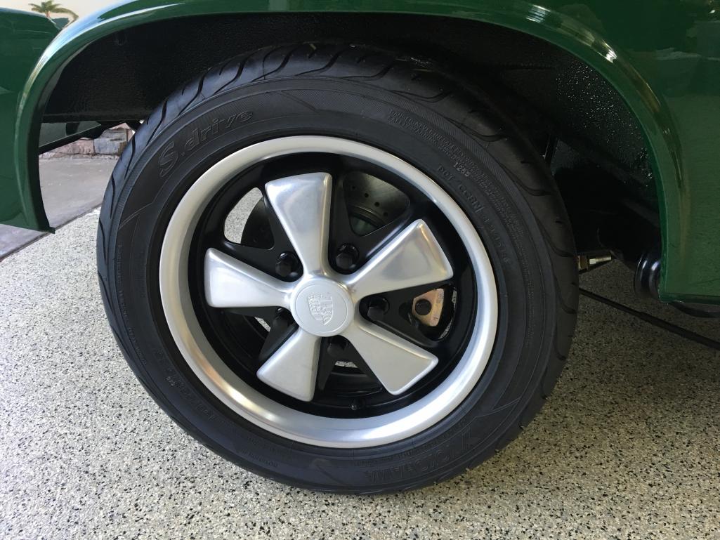

Thanks everyone. That rim is not my rim; it is just a test fit wheel. The finished deep six will go in the trunk- wheel face out.

Mike, all is going well and I'm digging into the trunk at this point. The arms I ordered for my spot welder came in and the fenders will be going on soon.
Terrific. Looking forward to seeing how those long arms weld.
That spare tire hold down bracket is just what the doctor ordered.

Cleaning and rebonding the under webbing structure to the hood skin.
Amazing work as always. I need to do some similar work on my hood. What are you using for bonding agent? The green is liquid masking, I assume?
Edit: I see now that it is just masking tape. Looked too clean!

Very sad that these had been stripped and finished back east and they were already rusting under the material used at that time. Thank God Kent suggested we strip them and make sure they are correct before paint. They had multiple layers of build-up and Kent found areas where the material applied did not have good adhesion on both trunks lids. He believes they would have definitely lifted and created issues once color was applied. Pretty disappointing that everything I paid good money for had to be redone.
I had a lot of the same on my build. My painter had to basically strip down the entire exterior of the car. Had rust under the primer, some primer would scrape off with your thumb nail....WTH. Big waste of time and money. Things can definitely go wrong in a big way if people don't know they are doing. Glad you're finally on the right path. I'm getting there, but it's breaking the bank. ;p
At least you have a glimpse of the finish line now. Endevour to persever.
Really shouldn’t have happened to either of you. Since the cars were stripped down to bare metal, it’s not brain surgery how to prep and prime.
Thanks. Yeah, that's what keeps me going. Also, I am not a quitter. I love my car and want it done right and in my garage.
A gold car will need an especially pristine body!
Mark - I know you had the same issues I had with your car in the same shop..... so I know you feel my pain brother.
It's like getting kicked in the balls every time we find more stuff that was done haphazardly, incorrectly and just sloppily. I paid good money and that is what I got. When you hold yourself out to be an expert, there is no excuse.
Exactly, that is what Kent is working towards- and frankly, has already attained. Lawrence, sorry we did not get to meet at the Swap meet. I did see your car though. Nice-
Does the previous guy (Scotty B) still have a car restoration it seems ,reading this thread and the original one that he wasn’t any good at all
The primer issues is really strange.. I am not an expert but been around body shops my whole life ( my uncle runs a 1 man band since I was little) and have painted (bare metal) 6 cars myself. The epoxy prime is pretty straight foraward..
The one thing I will note is I never had any of the cars blasted but rather da'd. Prior to spraying primer

what is the patchy color on the body? a guide coat for block sanding?
jmitro - Sorry. I have been pretty careful about "bashing" the former shop. I am sorry if occasionally a little, and I mean a very little, bleeds out. If that bothers you, and I understand that, feel free to skip past that stuff and just enjoy the pictures. However, I would feel somewhat responsible if anyone else to fall prey to that situation, there or elsewhere.

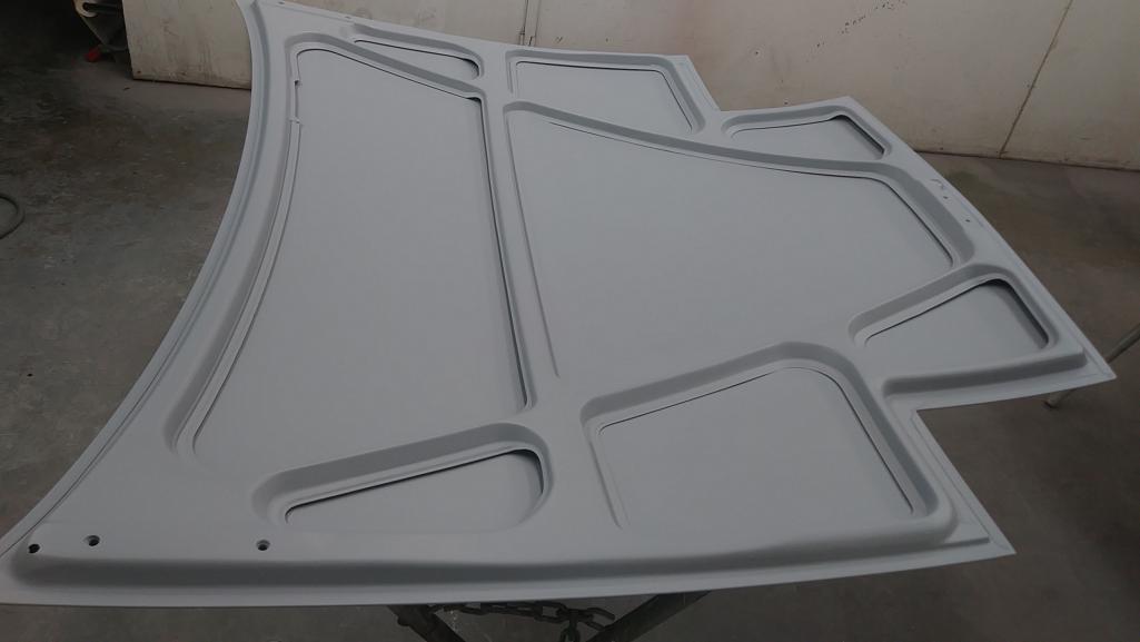

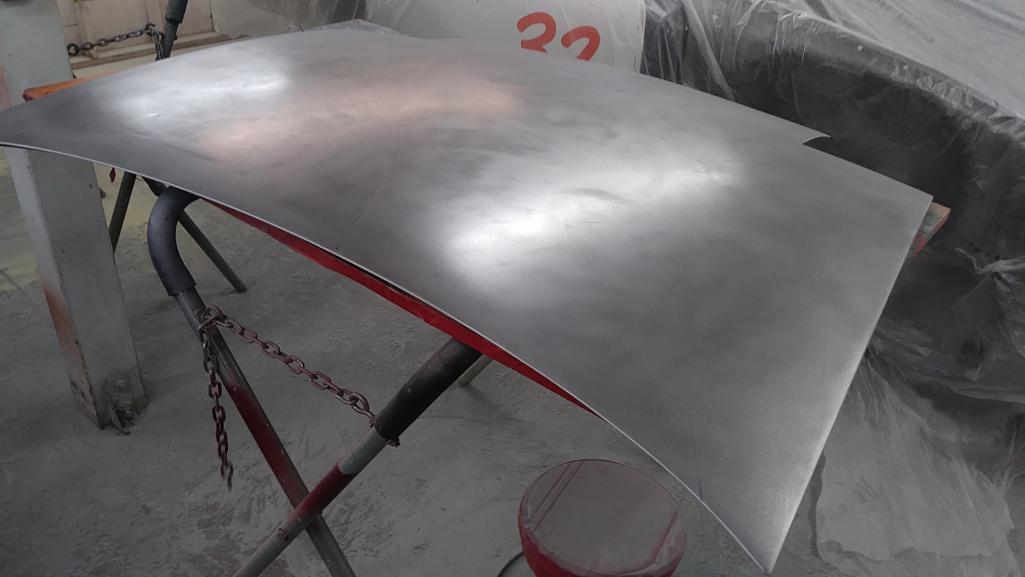

Hood and deck lid are worked and primered.
Kent is IN THE HOOD!
...and the trunk, too, apparently!
What a lucky car that is...
I agree - my Six finally hit the jackpot.
