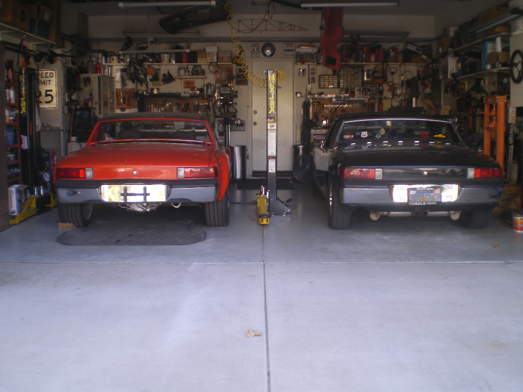

Stable mates!

Where's the white car?

Yea...what happened to it?

I still have the white car and she's under covers for the near future. I up when I bought the car in 2009 by repairing the battery tray, a small area below and adjacent to it with S Glass. My thought at the time was S Glass is 5 times stronger than steel and wouldn't rust. The damage did not extend into the long and was basically surface rust. That non-standard repair put it in the same class as the rust buckets. So after this V8 project is done I'll make the proper repair to that area and get a respray. The car is so cherry everywhere else it will sell quickly. It still has the original dash. Cars like that with proper repairs and good paint are fetching 15-18K. As it sits now about 8K.

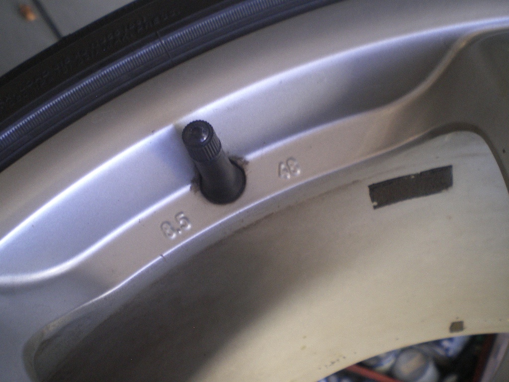

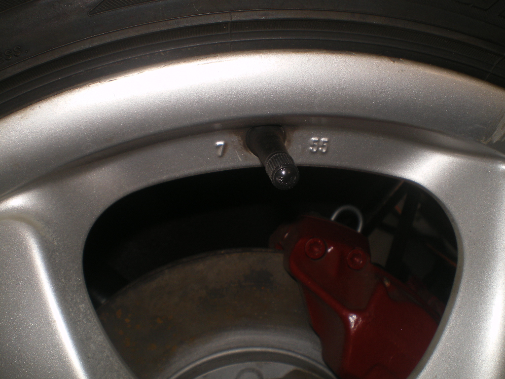

Chris, Here are some pics. Maybe 7" & 8.5"? The tires are 215/40 R17 & 245/40 R17.
and one of the rear tire

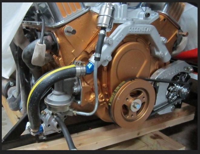

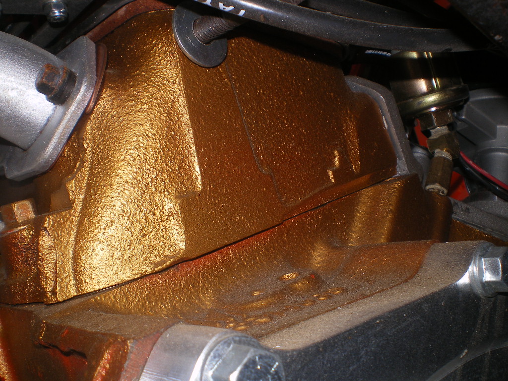

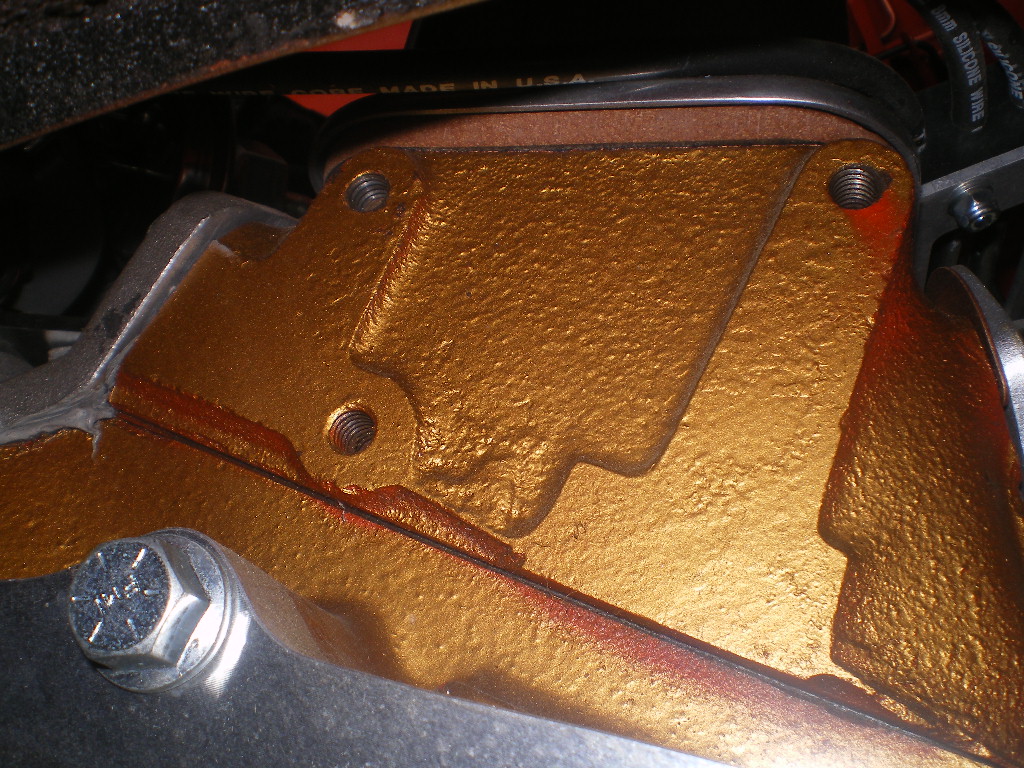

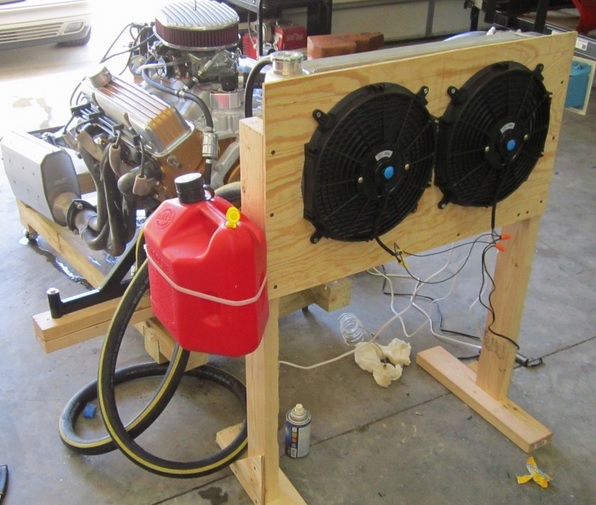

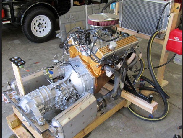

Chris, I'm told it's a 68 327 .30 over (338 ci) flat top's w/ valve reliefs. I haven't ID'd the heads yet but the info I received was 993 heads, 2.02" I & 1.60" E valves, 76cc chambers, estimated cam lift on intake .450". I have nothing on the Ex lift. Compression 9.0. Appx HP 300. What I gleamed from some SBC sites re: torque is maybe 350 ft lbs. I don't yet know if it is a 4 bolt main or not. Moot point for me because IIRC, not much increase in torque after 5000rpm so no need to spool up the RPM's. PO said they did the 20 min break in. It hasn't been fired up since. I won't know Diddley until she fires up. The wiring needs to be sorted out but to answer your question; I need to get 12v to the dizzy/coil, connect fuel lines, fill tank, wire up electric choke and water pump, run and secure radiator lines. Here's a few pic's of the head which I'll need to ID. The last time I worked on an SBC there were only a few heads; Power Pack and FI, IIRC but that was in 1979.
From the break in run:
Some ID marks on the heads
Another
Uno mas

Have you googled the engine casting number ?
It's in your first cylinder head picture but not legible.
At least you'll know what it started life as.

Not yet. I tried to ID the heads from the PO's pics and narrowed it down to 2. I haven't checked since I took some good pic's. Thanks for the tip on the block, Rory. Didn't know that. I'll check this weekend.

Same goes for the cylinder heads.
The casting number is under the valve cover.
Google "Chevy block casting numbers"
More info than you'll ever need.
Written report please.
