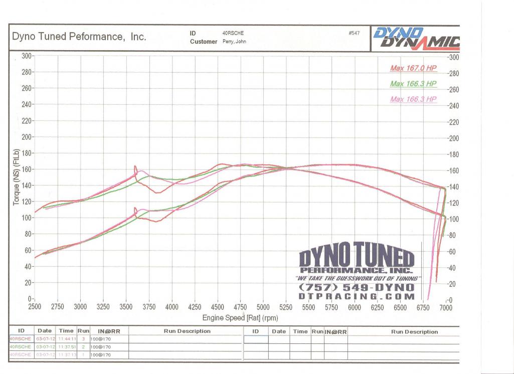

Posted by: wndsrfr Dec 21 2017, 07:51 AM
I had a failed DPR crank on my 2316....cracked where oil passage was too close to the journal/web junction. I then went with FAT who uses new forgings on the 80mm stroker and he also put in 5 dowels to my flywheel & balanced it.....bulletproof! Check them out.....also used forged pistons (JB) as I was using it for DE events.
Using TPS only since the ITB's screw up the MAP signal for the SDS controller. Cruises fine using closed loop, seeks 14:1 at steady state automatically, nice. Still on "old" Raby 9550 cam & dyno's at reasonable HP & torque.

Posted by: Mblizzard Dec 21 2017, 08:16 AM
QUOTE(wndsrfr @ Dec 21 2017, 05:51 AM)
I am looking at numerous options and certainly getting to this point would be a dream! Love that torque curve. Much better than the stock 6!
