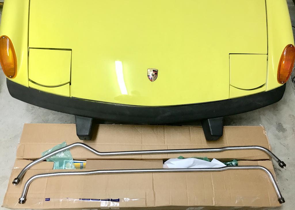

The 2 hardlines that fits up along the longs..
Like this picture I used from mcmark..

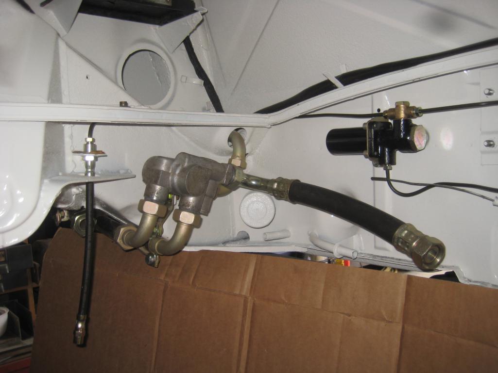

Ben - since you are doing the GT lines, will you also do the GT console and pressure relief valve. They are hard to track down and rather pricey.
Pic stolen from this thread - http://forums.pelicanparts.com/porsche-914-used-parts-sale-wanted/961005-gt-oil-system.html

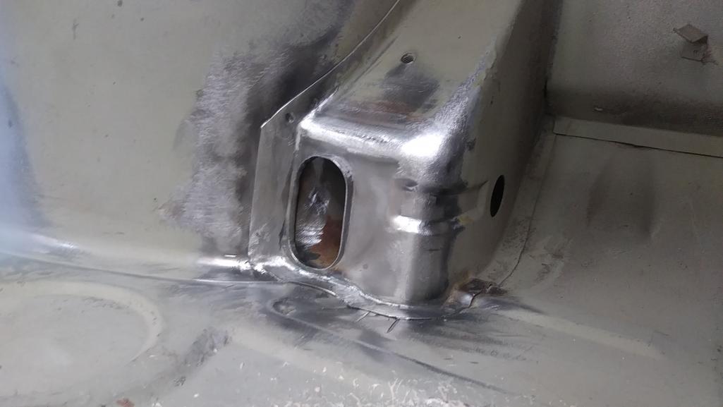

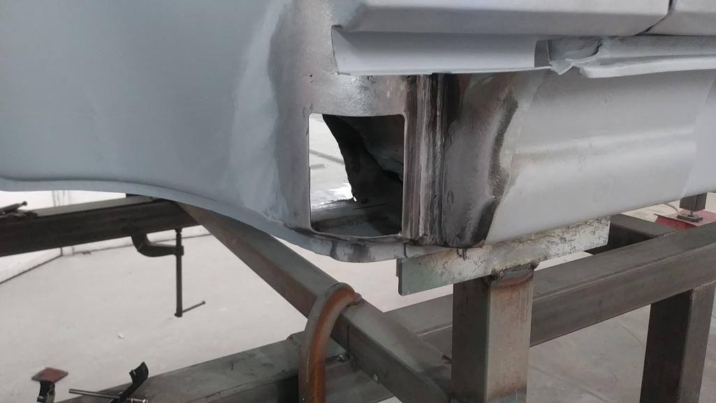

Two questions I had:
It looks like using the cast oil lines will mean that part of the oil line will run through the cabin (on the lower left of pedal board) and into the firewall then into the "frunk"
as is http://www.pbase.com/9146gt/image/134487215 rather than running up through the fenderwell and into the "frunk". Is that right? Or did I get that backward? And brackets to attach to rocker included?
Posted by: mb911 Jan 26 2018, 05:22 PM

Dave,
I am doing the GT hardlines just as the factory did.. The only difference is they are made of stainless steel which can withstand much more abuse then brass..
I will make brackets as well but one step at a time.. This was a hugely expensive undertaking so have to recoup along the way..

As Ben says, install is exactly as per factory and period correct. Hardlines enter through the inner rocker then front soft lines run inside round the wheel well and through to the frunk in the corner
This is a killer deal for the hardlines, I came close to acquiring a brass set and they were kicking on to 2.5x Bens price and that was years back when I started to collect parts. Brackets are cheap and come up on eBay all the time / not expensive new. Just regular 911 oil line brackets that go on the rocker
Pic from a U.K. based GT

And for those looking for pictures here they are after being bent.. Silver soldering the ends on over the next few days after triming to length.

Posted by: mb911 Feb 7 2018, 10:18 AM
Wow suprised no comments.. I think they look awesome..
Posted by: jd74914 Feb 7 2018, 10:34 AM
They really do look nice, especially with the silver soldered metric ends.
Posted by: mepstein Feb 7 2018, 10:43 AM

Posted by: mb911 Feb 9 2018, 03:59 PM
Installation picture.
Posted by: Steve Feb 9 2018, 08:43 PM
I just got mine today. Very nice!!
Posted by: Norskpole Feb 9 2018, 09:33 PM
Received mine today....very nicely done!
Posted by: Steve Feb 9 2018, 10:11 PM
Who’s going to be the first to install them? I am waiting til the next oil change, which will be this summer.

Posted by: buck toenges May 9 2018, 02:46 PM
Does anybody have pics of where the entrance and exit holes are supposed to be for the oil lines? I would love to see where the holes from the front trunk should be, where the holes through the inner rockers are, and where the two holes from the engine compartment to the side rockers are. I would also like to know the dimensions of the holes. Is there any printed information out there?
Thanks,
Buck
Posted by: mb911 May 9 2018, 03:02 PM
QUOTE(buck toenges @ May 9 2018, 12:46 PM)
Thanks,
Buck
Here is what most do
Posted by: SixerJ May 10 2018, 12:07 AM
QUOTE(mb911 @ May 9 2018, 10:02 PM)
Thanks,
Buck
Just to add to Bens pictures, hardlines at the back just hook around and under the rear chassis member as it sweeps upwards. In the frunk they poke out lower right through the vertical tank to storage metal divider
Google pbase 914-6GT and get lost in Armano’s site loads of details there on what you need to find and how to assemble. Also Cairo's current build thread in the garage, Kent is detailing the oil line hole cuts right now
Word of warning though, doing a full blown factory replica GT system is not for the feint hearted and consist of very rare, hard to find parts that get expensive really slowly (because you have to piece the puzzle together as you find the parts)
Bens hardlines are one of the biggest missing parts as totally unique to the GT, many of the other factory parts come from early 911S
Alternatively you can use Bens lines and more modern solutions for the rest of the plumbing. Just depends on what your trying to achieve
Good luck

Yes, the factory 911 thermo is readily available and dirt cheap compared to any single part of an original GT system.
My plumbing came about because a 911 thermo appeared to be a good fit for the
area where all the 'action' takes place in a 914 chassis.
The challenge was to collect and modify many standard 911 plumbing parts
and jig them up with the the thermostat, the engine, oil tank, left side long lines and all interference issues considered.
I then tacked all the parts together.
When satisfied that it would work I had it all mig welded and plated.
It is not quick and easy.
I do like to fabricate.
Rory
